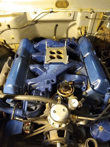

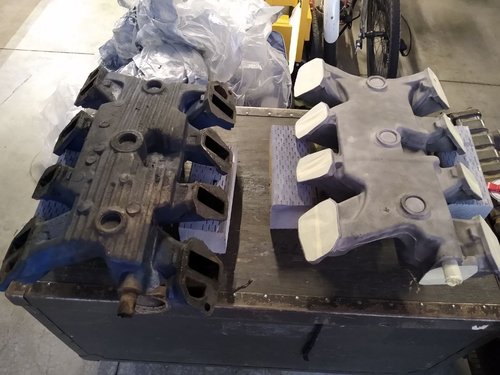

Anyway, I figured there was no time like the present to move forward with swapping my '64 "low-rise" intake with the '58 "high-rise" intake I scored recently. Here it is mid tear-down: Here are a couple pics showing the differences between the two. The later intake sits much lower in the valley of the motor, ports are the same size, but the heater connection and water temp sensor ports are swapped and the threads are different sizes. The highest ports in the '64 intake are about the same height as the lowest ports in the '58 intake. In the lowest ports of the '64, the mixture from the carb has to travel back UP to the intake valves. Crazy. Not shown is how the later manifold moves the carburetor towards the firewall about an inch to center the primary venturis on the engine. According to literature of the day this was supposed to make the engine more efficient but I feel like it was probably more of a packaging consideration with the lower hoodline of the later cars. Here's the intake removed and cleanup underway: Lastly a couple mock-up shots just to see how everything will fit. I'm going to run a 1" open spacer on this manifold (the old setup used a 2" four-hole spacer) because in my experience it should improve low- and mid-range torque vs. no spacer or a four-hole spacer.

- Posts: 210
- Location: Waco, Texas
Re: Early Intake Manifold Score
Look's good. Makes me want to get on mine. I also think it was the hood line. Lincoln dropped the hood line for 61 causing the 61 and up starter movement and the squished intake manifold. Look's like an FE thermostat housing was modified to work.

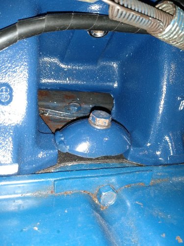

- The manifold spreader thingy's that the bolts pass through to clamp it to the cylinder head are different sizes. I didn't get the ones off the '58 and the '64s are shorter. About three fit well enough to torque to spec, the rest I welded a bead on one end to make them longer. See pic below. Not my favorite solution but functional since I may never come across the correct parts.

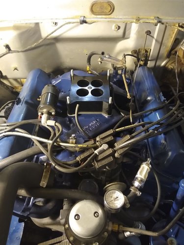

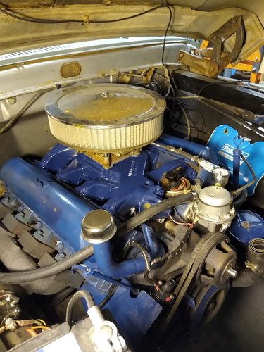

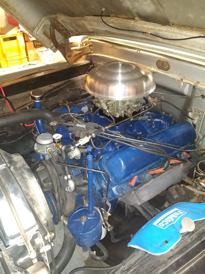

First here's the new intake with the 2" spacer that was on the original manifold. Here it is setup with the 1" open spacer I originally planned on running—still waiting on the new radiator here. The open spacer ended up being all top end power and caused soggy throttle response on the low end. The swanky new air cleaner has a flat base for reference. The crusty old chrome air cleaner was about a 1" drop base. Here it is with the 2" four-hole spacer back on it. This is a tall setup (the air cleaner is about 3" high) so it's getting close to the underside of the hood now. This setup has instantaneous throttle response at any rpm, great power everywhere, and I can loaf it down to about 10 mph in high gear. With the old intake setup, 15-20 mph was about as slow as you could go in high gear before it fell on its face. Not that that's important, but it is indicative of the improved efficiency of this setup in my opinion. It's a blast to drive now, merging is fun but it's very easy to overspeed. I'm sure I've surprised a few people with how quickly this beat up old truck pulls away from them now. Here's the modification I had to make to bolt the early manifold on using later hardware. Finally, one last pic for posterity.
