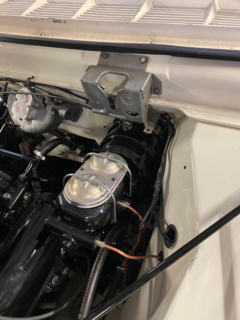

Hi guys.
I’ve converted the brakes off my ‘60 Lincoln in just the same way as described here but have a hard brake pedal and almost no assistance from the booster.
They say the pedal ratio might not be good or to less vacuum.
I have 18 inch vacuum so should be okay!? Did you change anything else?

I have not made any other changes. You may want to check the vacuum reserve tank behind the inner passenger wheel well.... Yes I have heard of fabricating new linkage for the brake pedal to change the ratio. I have not done that...

Thanks for your quick reply.
What make of booster/master did you use? I have a 7" dual diaphragm booster with dual from Tuffstuff but it gives almost no assistance! It's dangerous to drive the car, and won't any more.
Some say a 7" booster won't stop our big and heavy cars, I just think the booster and or master are not working like it should. I've followed it step by step and did the exact same things as you did.
Any advise would be great!

Vacuum reserve is okay. I've not used the car in 2 days and still had a small bit of vacuum in the system, so it air tight enough.
