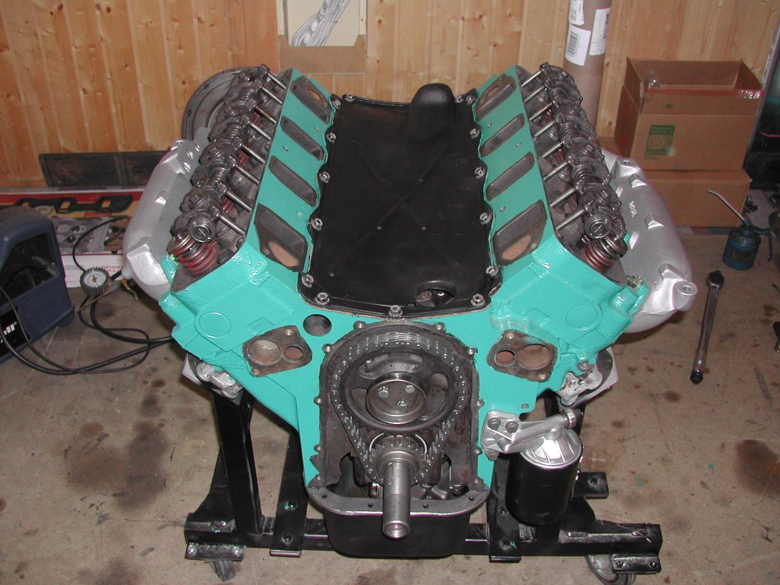

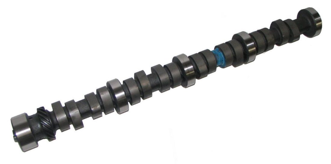

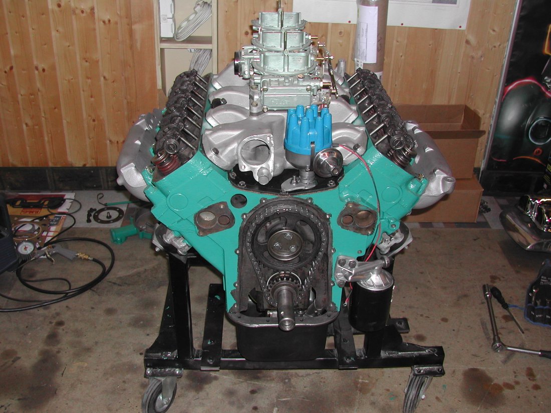

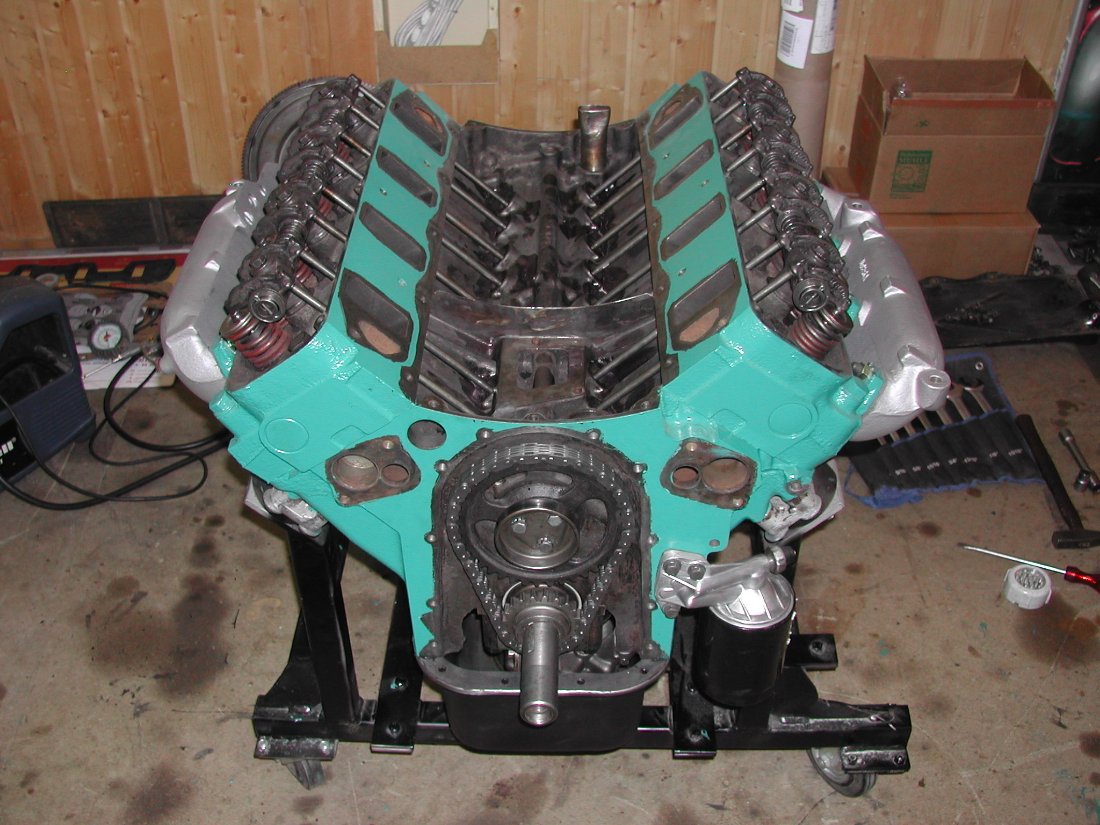

After searching for a good camshaft for a long time, i´ve finally found a good one!
The cam is Falcon Performance #CM-184, a new reproduction of a stock cam, at least they say so. I couldn´t measure its duration, but i measured the valve lift at about 0.440", so its probably a reproduction of the early style stock cam i was looking for.

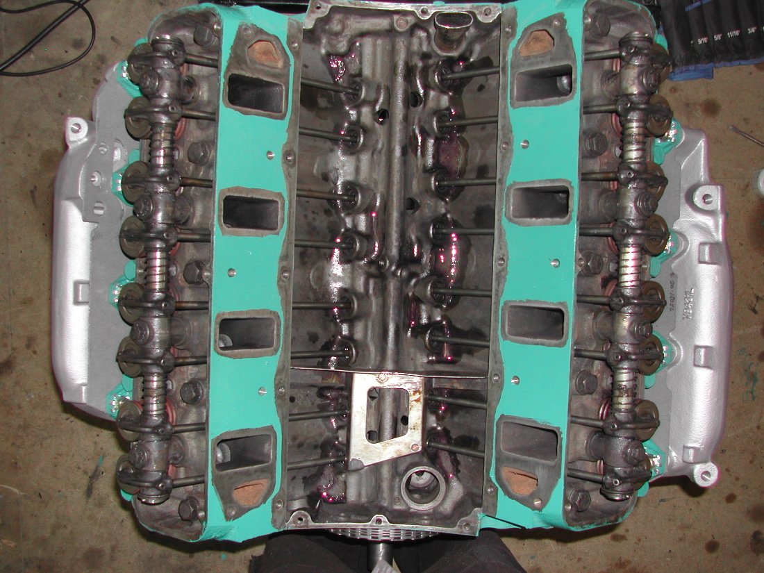

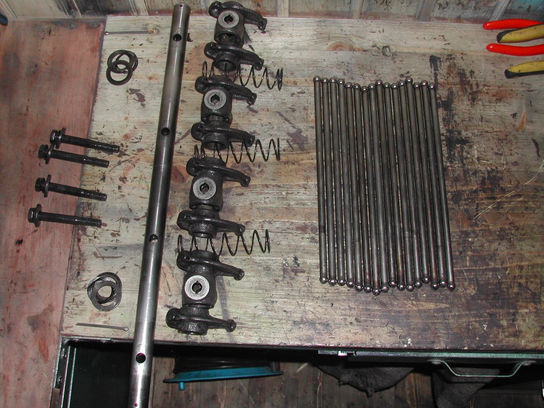

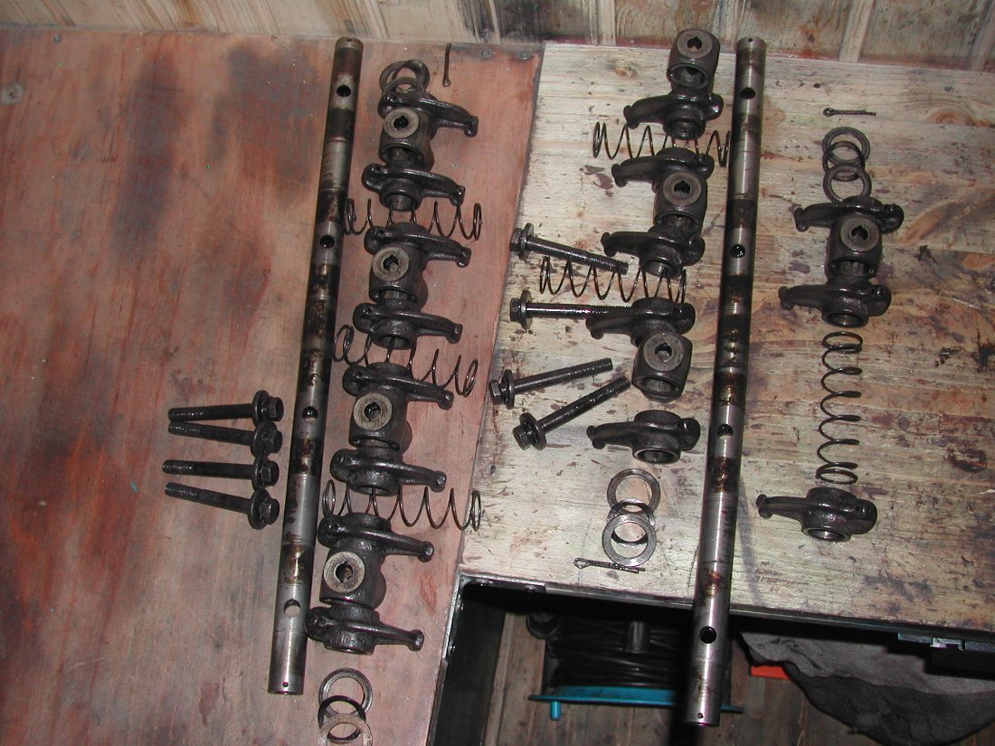

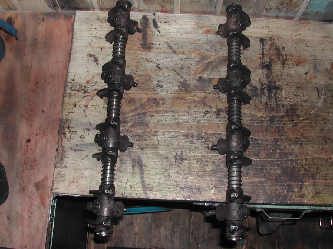

After I installed the new cam, valve lifters and timing chain, I disassembled both rocker shafts. I guess they´ve never been serviced and the dirty, muddy scab on them was 60 years old.
I cleaned and inspected them, wich was a good thing, because some oil passages were almost full of crap. I also cleaned all 16 pushrods.

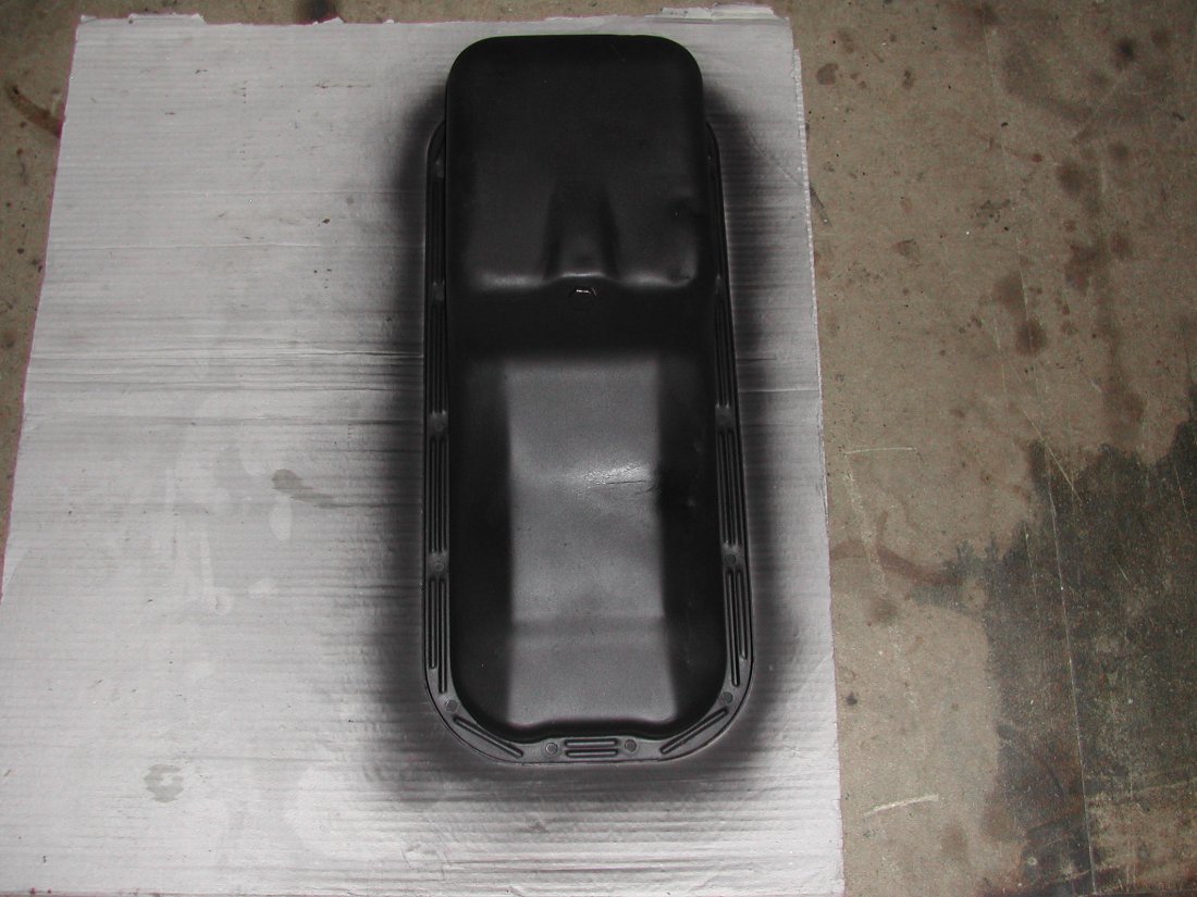

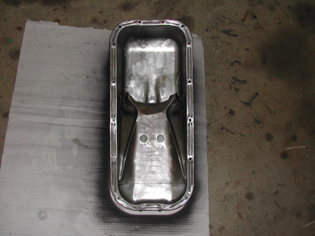

I also cleaned and painted the oil pan and refurbished the oil pump with a rebuild kit.
The valve train and oiling system are complete again.

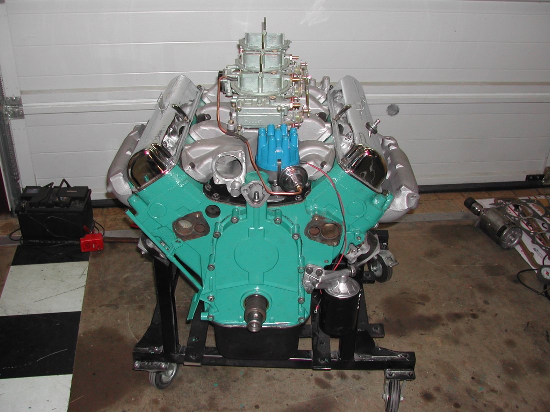

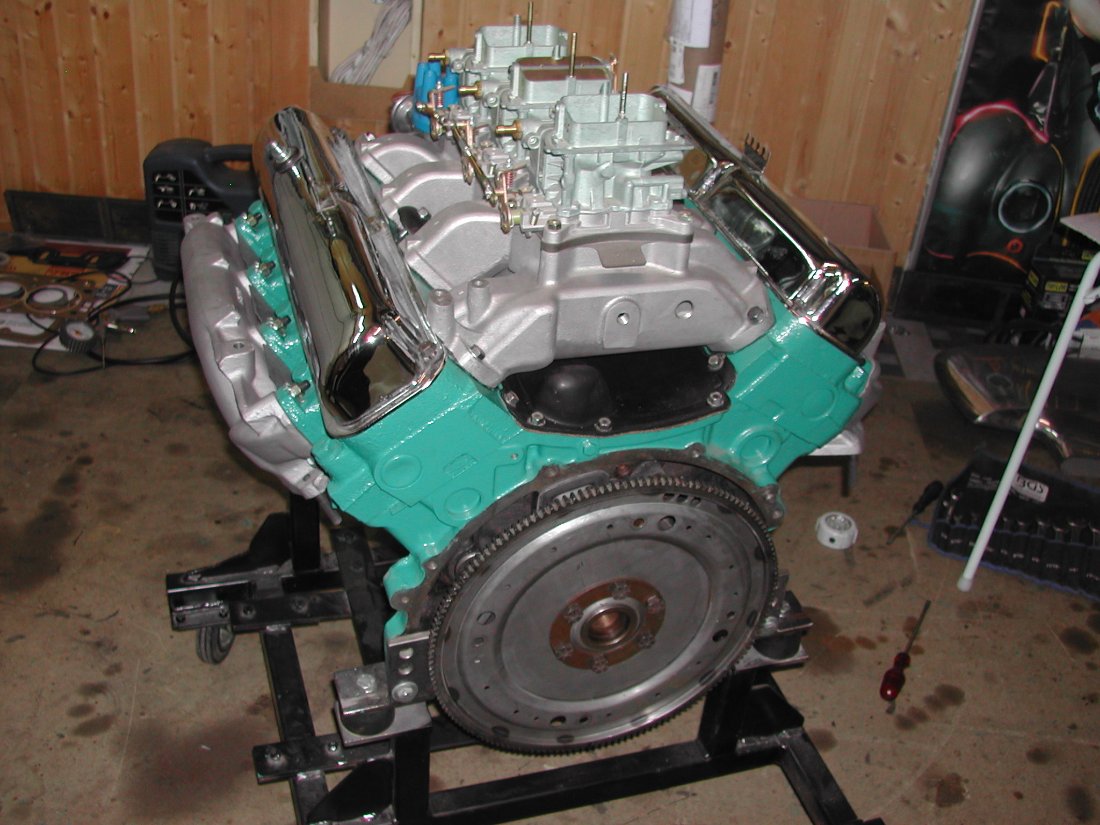

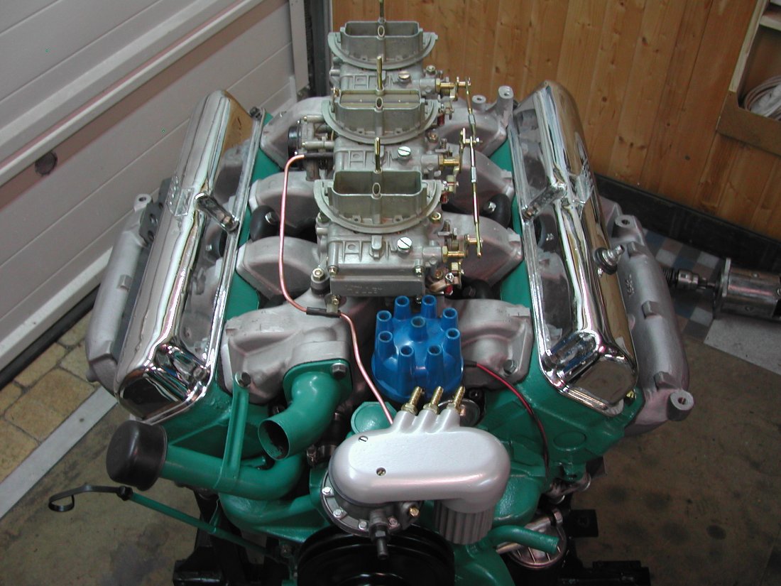

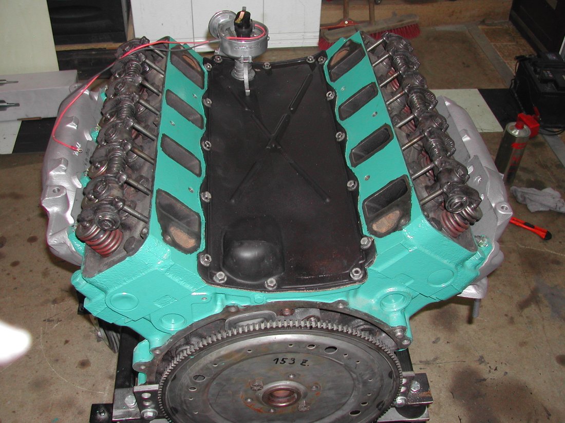

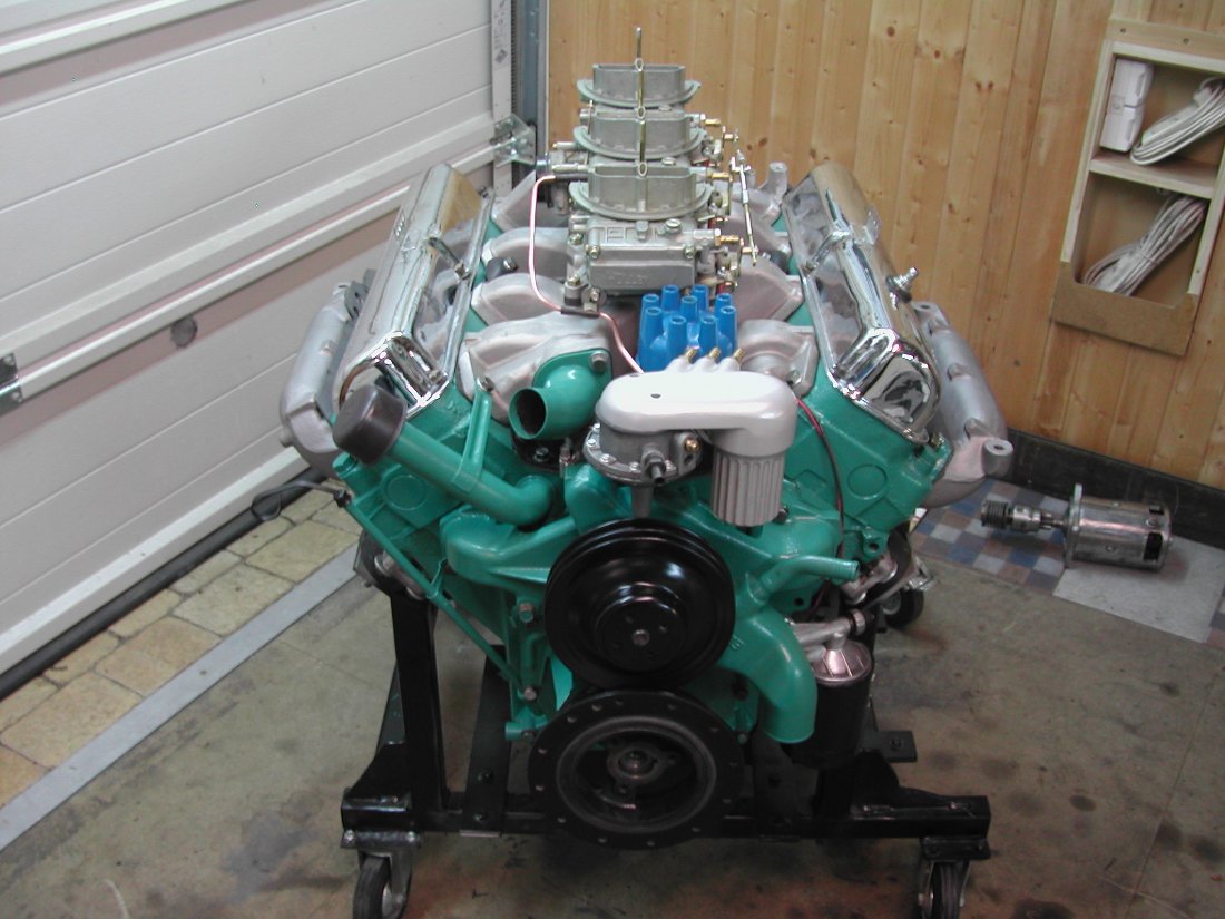

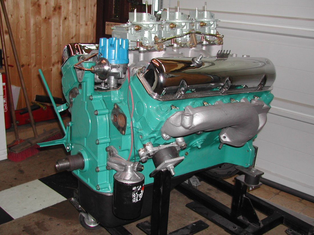

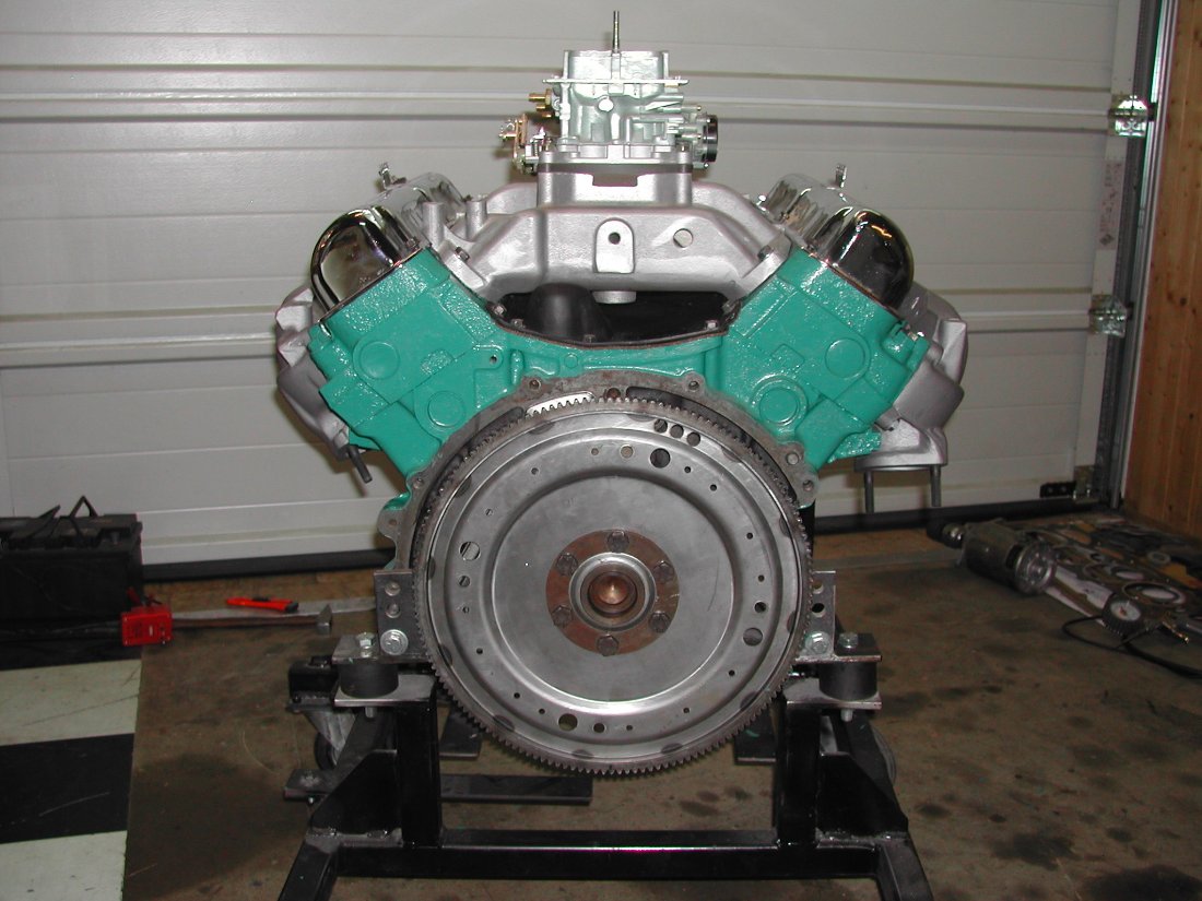

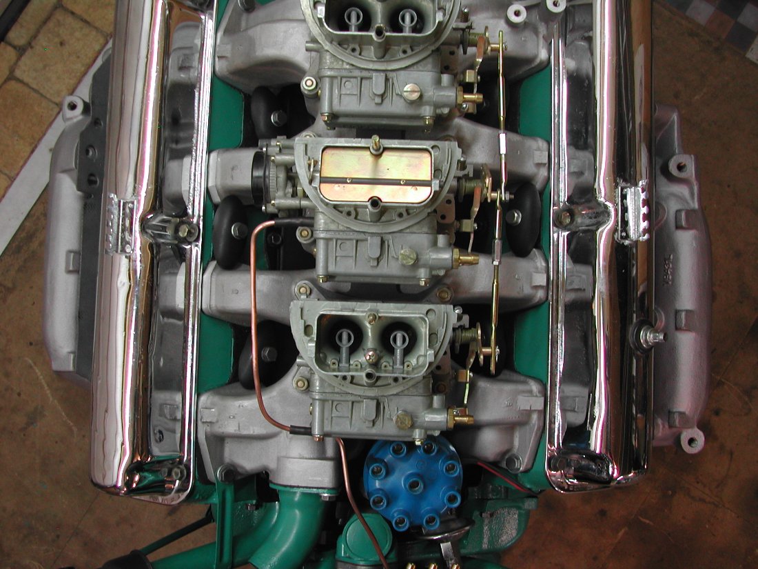

Today I assembled the valley pan, ignition distributor, timing chain cover with fuel pump pushrod, flywheel, valve covers and the Tri Power system. Finally it looks like an engine!
1958 430 MEL V8 without car
RocketdyneF1
Posts: 20
Joined: Thu 8. Aug 2013, 02:29
Early 1958 430 rebuild

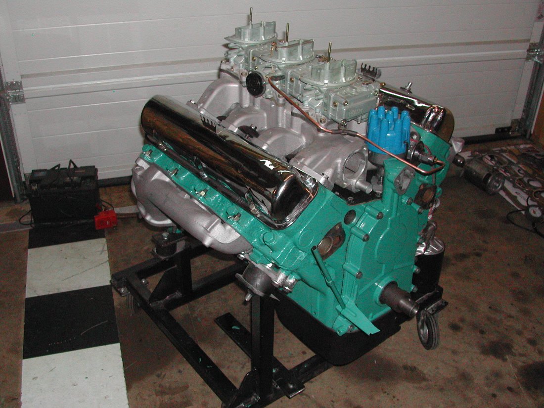

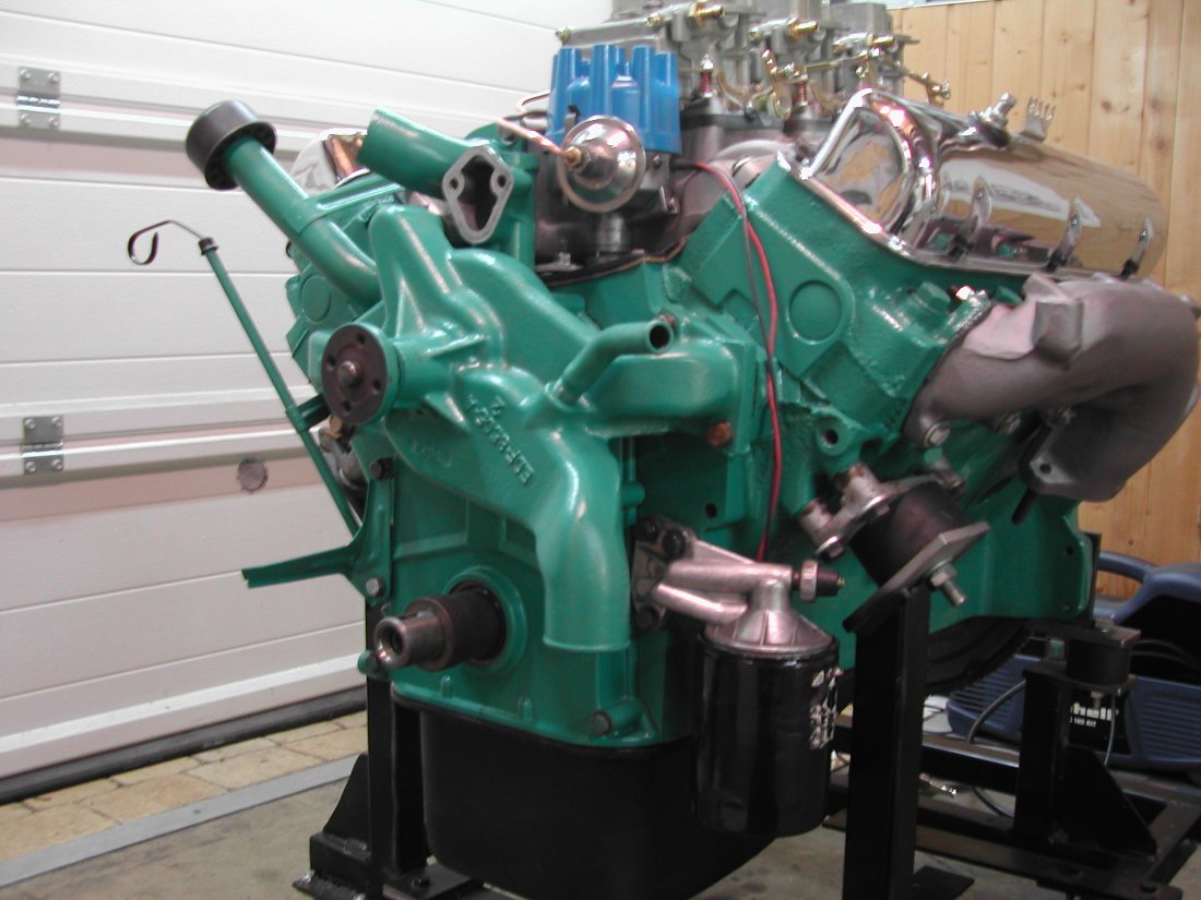

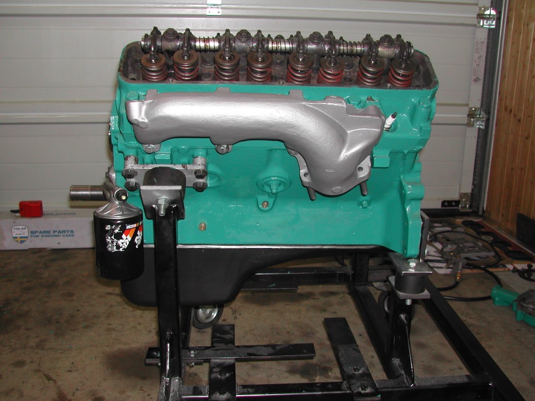

Post by RocketdyneF1 » Sat 24. Mar 2018, 15:08

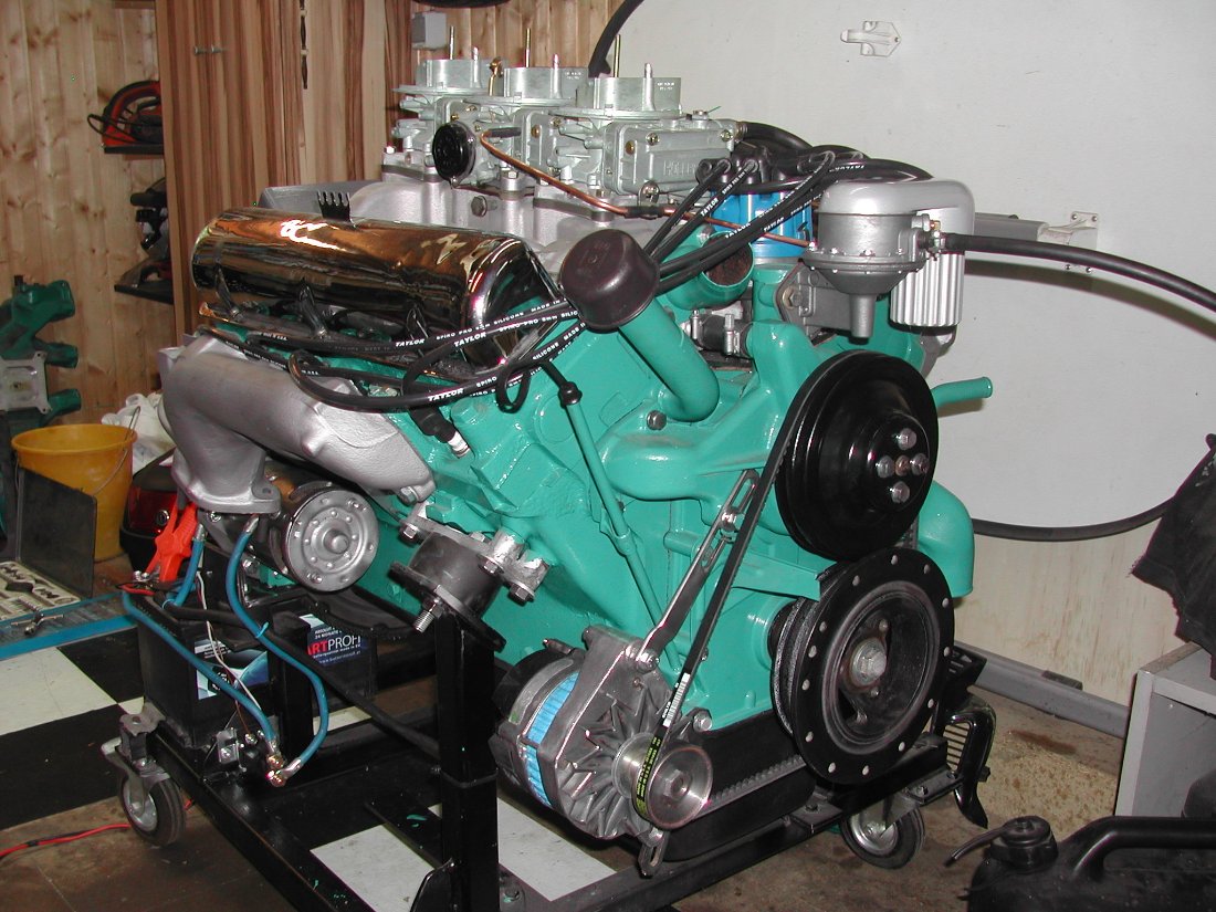

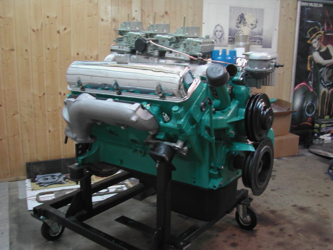

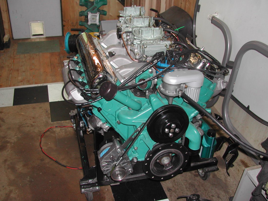

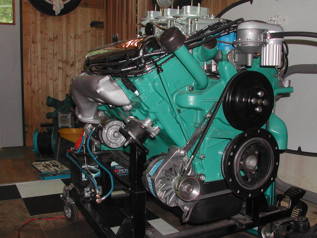

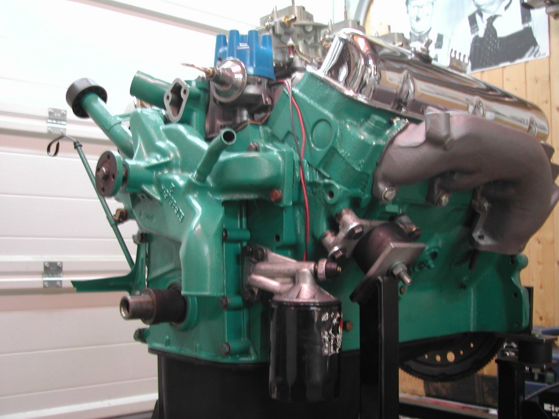

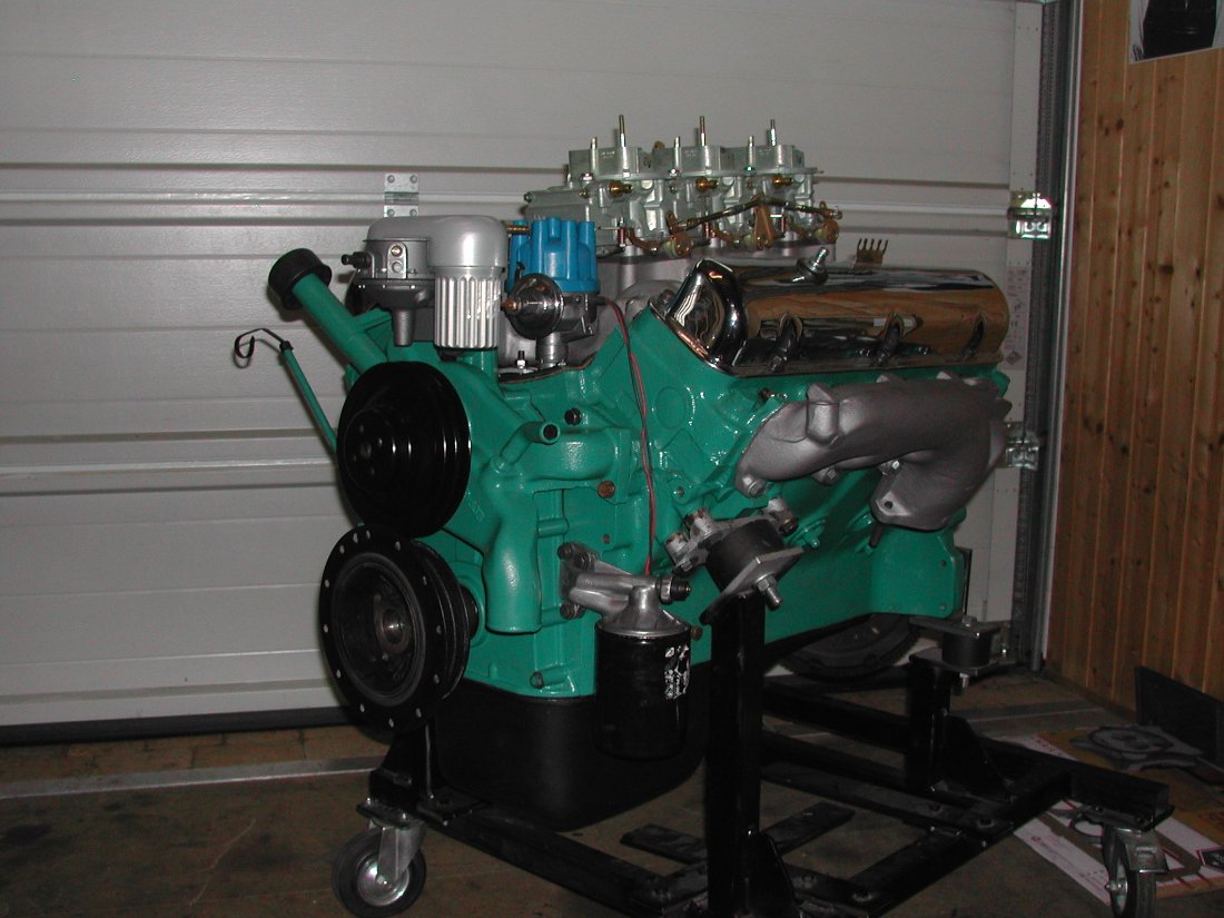

A few more pics of the progress:
I hope I can start it up soon!

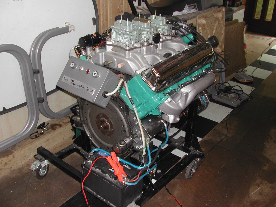

Post by RocketdyneF1 » Thu 17. May 2018, 05:34
Today, I finally started up the engine for the first time in years. It only ran for a few seconds, but damn, it has a really loud and brutal sound! No wonder, it has absolutley no exhaust system on it except for the manifolds. I also havent bought a radiator and cooling fan for it yet, so I cant let it run for longer periods of time. I´ll post a video of it running when I am done tuning the carbs and ignition, and the cooling system is complete.
