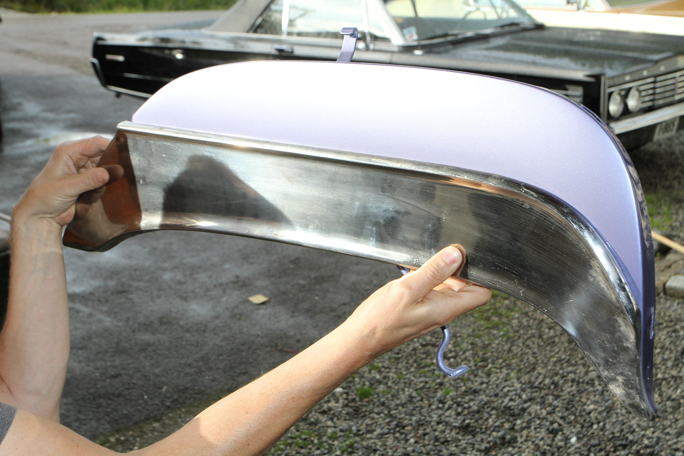

Last year I spent a lot of energy trying to decide what color to put on my car. Since then I began to doubt my own judgment on the color choice I had made and decided to go a new round with the options. I painted a few test sheets with silver, gray metallic and black metallic and put them on the side of the car and walked around it for days and weeks trying to make up my mind. Some days I was wondering if I would ever be able to make up my mind, but finally I decided to just stay with my initial decision and go for the violet metallic color I made last year. So I went to the paint store to have a quart of paint made to paint the inside of the body and firewall. Well, it turned out to be not as easy as I thought as they had deleted the mixing recipe from their files :x So I was basically back on scratch and had to start over again and make a new recipe. Yesterday I had the fender skirts test painted with the new color, and to my satisfaction, it seems like we nailed it. The color is probably a little more lilac than the one I had last year, and that just makes it a little more vibrant, especially in the sun. I love it, hope you do too :)

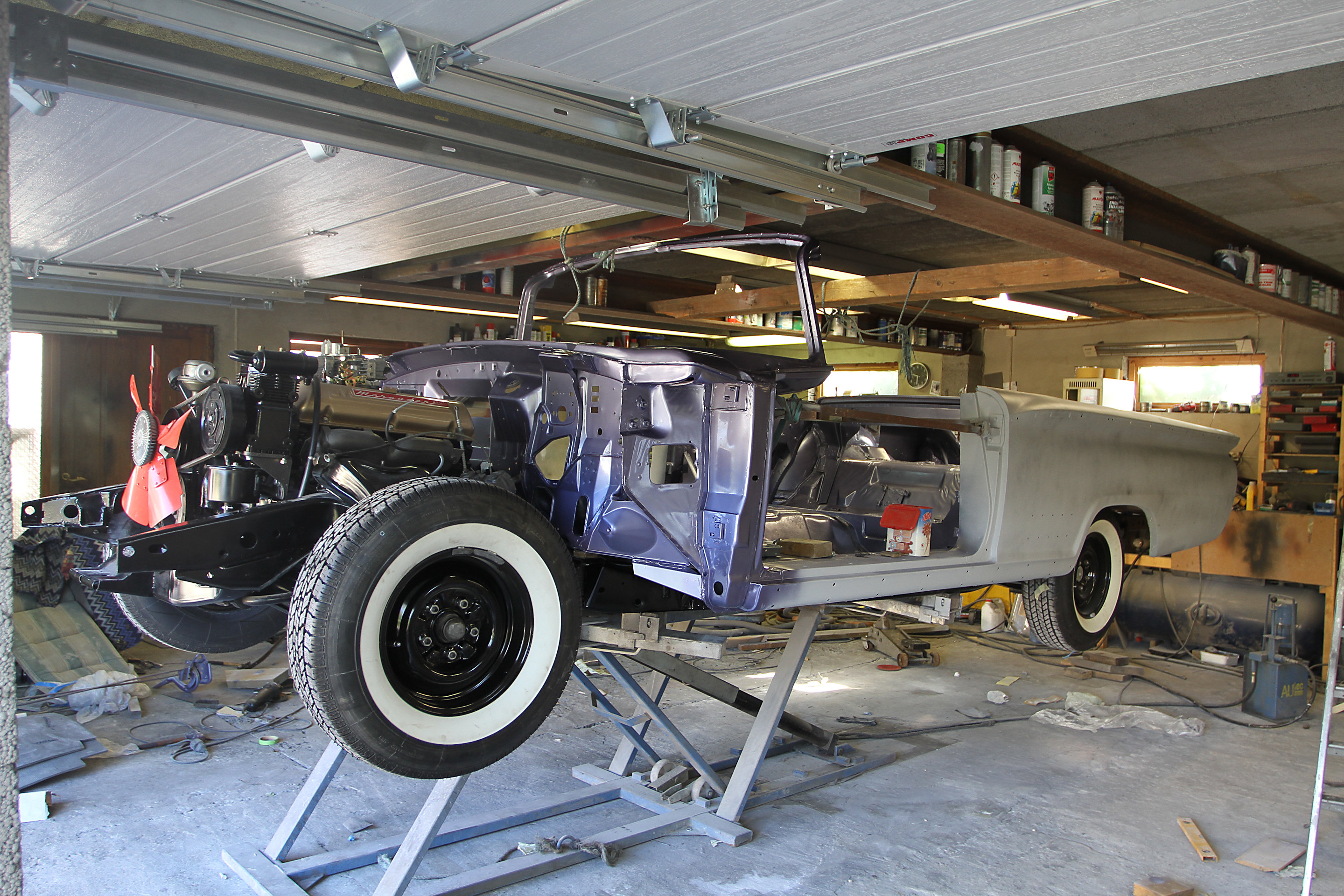

So I got the body back on the frame so I can put the doors on and do some final adjustments to the sheet metal if needed before I start the paint prep work. :)
