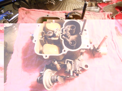

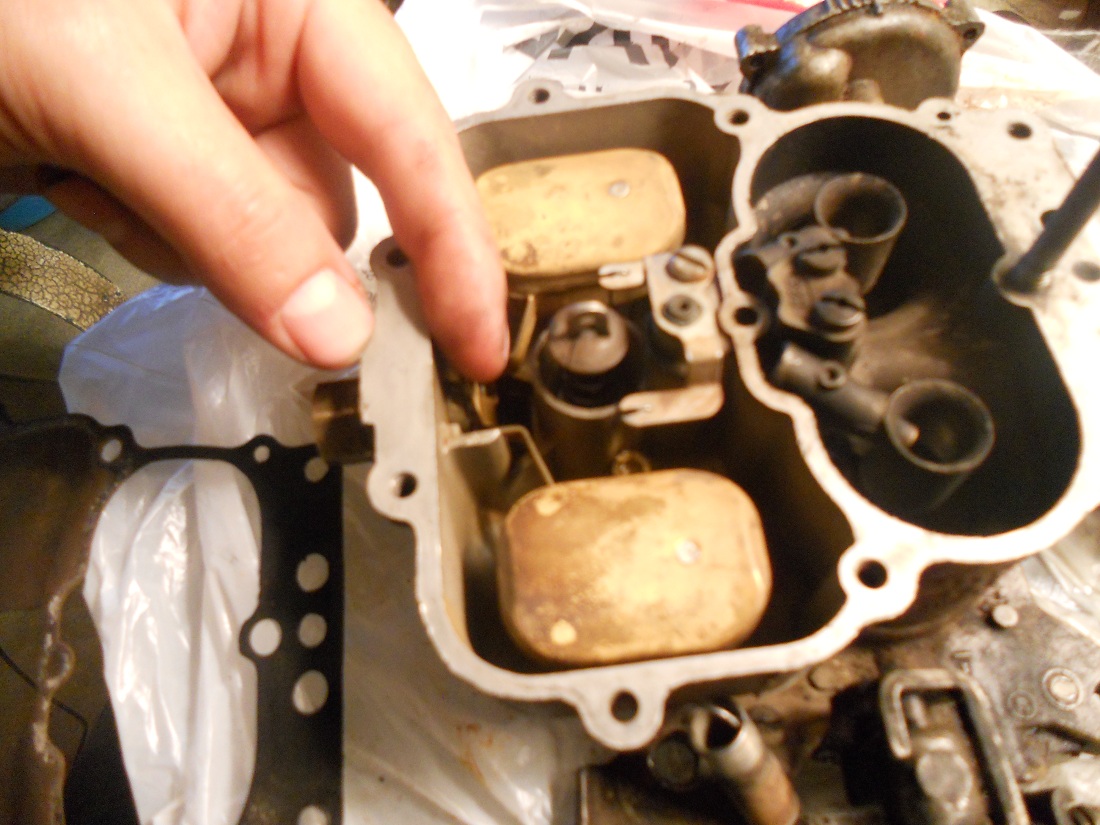

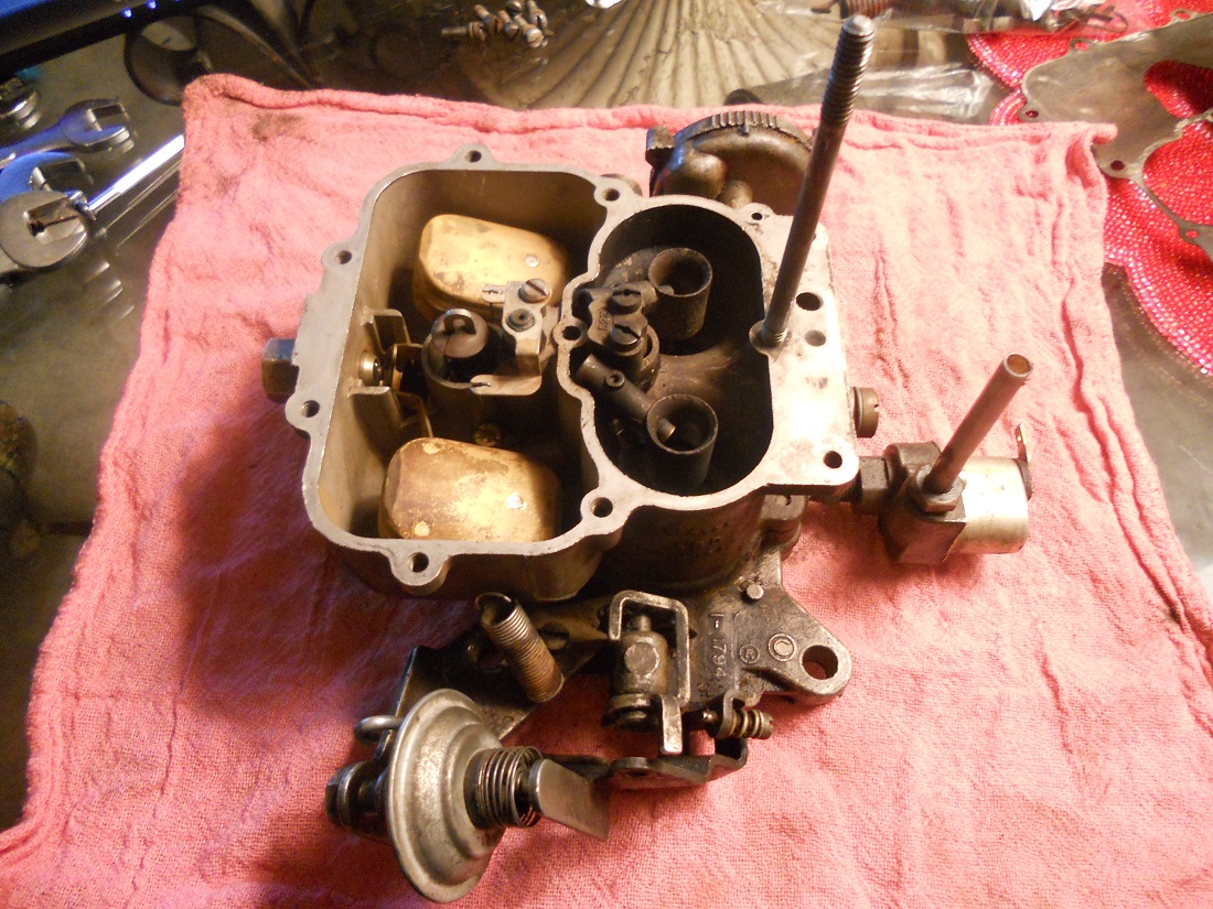

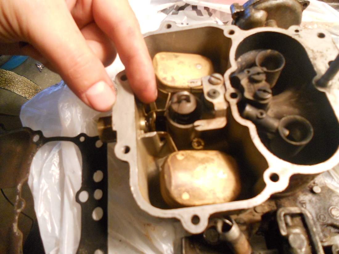

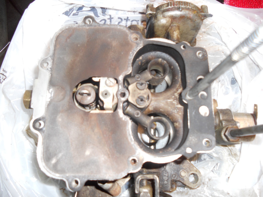

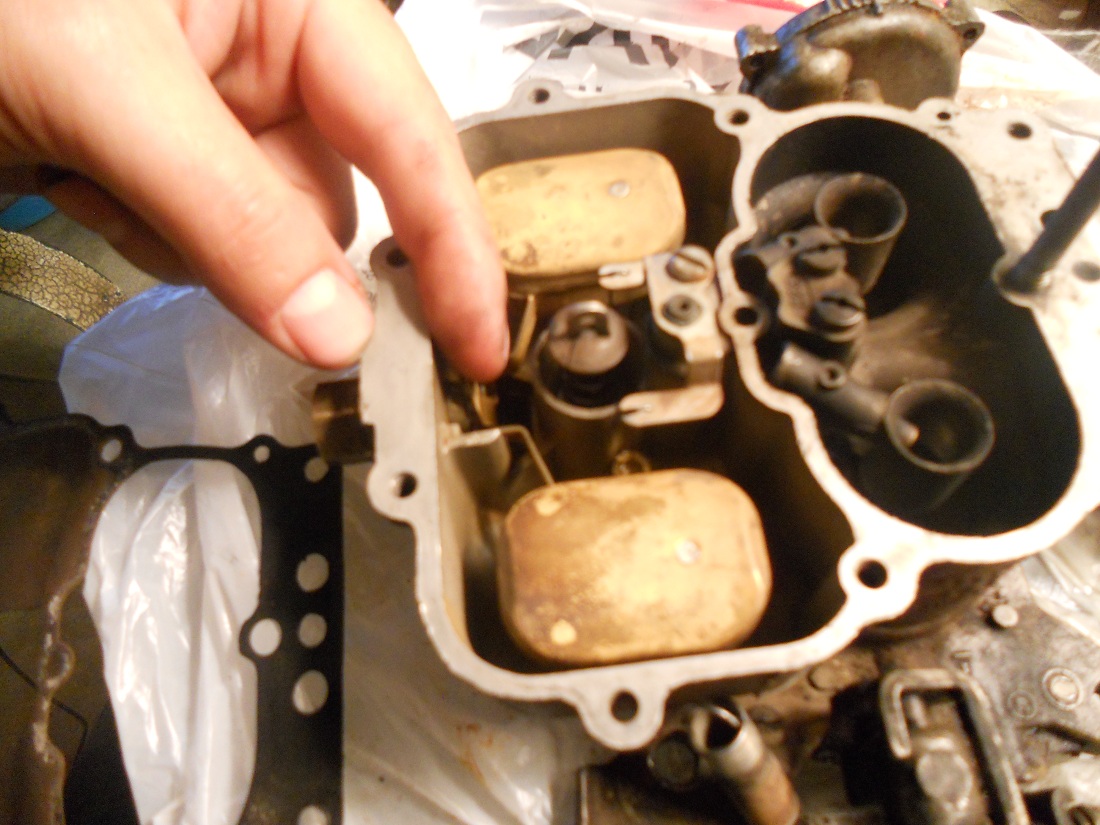

So I pulled the carb today to see if I could find the source of the leak, and to my suprise, I found that the carb has been rebuilt before. As you might be able to tell from the pics, the gasket shown is not correct, although the fit is very similar. I guess it does the trick.
I also found that the lever on the float that pushes the fuel pin shut was bent back and too far from the pin when the float was at the top of the bowl. I bent it back so it pushes the pin shut when the float is at the top, and will try tomorrow to see if the leak has been sealed.

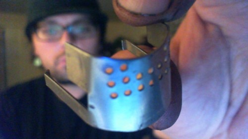

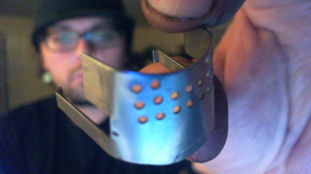

While I was pulling the carb apart, a piece which I can't identify fell from the inside, and doesn't really look like it belongs. Perhaps somebody could help me identify this piece. the best way I can describe it is that it looks like the silver piece on the top of a ligher where the flame comes out, only bigger... Any help in identifying this piece on a Carter ABD 2bbl is appreciated.

The part in question is the hold down for the float hinge pin, it slides in from the top in grooves on both sides . It also acts as a baffle for fuel spray as the needle valve opens. Without it the pivot pin would just slide upward and not apply pressure to the needle valve. Varnish from old gasoline may have stuck it to the fuel bowl cover or the gasket while you were disassembling the carb and pulled it out of place and dropped it in because otherwise it would have flooded like a geyser. As far as the gasket goes , it is badly shrunken and probably fit very well when it was installed.What you really need is a good cleaning and a carb kit . Good luck !

Thank you keithol! After tinkering with it for a while last night, that's the exact place I ended up putting it, although I wasn't certain.
When I installed the carb again today, I was happy to find the leak was fixed, but apparently I bent the lever on the float a bit too much, and gas wasn't filling the float bowl fast enough to keep the engine going. I unscrewed the hose from the fuel pump to the carb, and with a small screw driver, pushed the lever back some. When I reconnected it and gave her a start, I discovered the same problem I had before. Fuel was coming up under the lever on top of the carb, as it was before, but the engine was idling well.
Seems like there's either too much pressure from the pump, or the pin isn't sealing the inflow all the way. Any thoughts on how I can repair this? I imagine it'll have to be a perfect position of the lever that's connected to the float to push the pin back far enough to seal the inflow.
