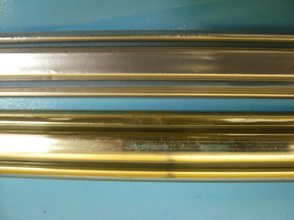

As you know some parts on these older cars are just about impossible to find. So what does a guy do but have new ones made. I am particularly excited about having the headliner bows remade. They were originally acrylic and just crumbled when taking them out. Only one bow came out of the car in one piece, and trying to find one anymore in one piece is near impossible. We know because we tried. ;) Gotta thank my restorers again for going the extra mile!
Here's some of the recent results.....By the way if you know of someone who needs bows, guess who had extras made... :mrgreen:
Headliner Bows (The test strips. Because of the lighting the colors don't look as close as they really are.) We'll have better photo's when the final version is completed.

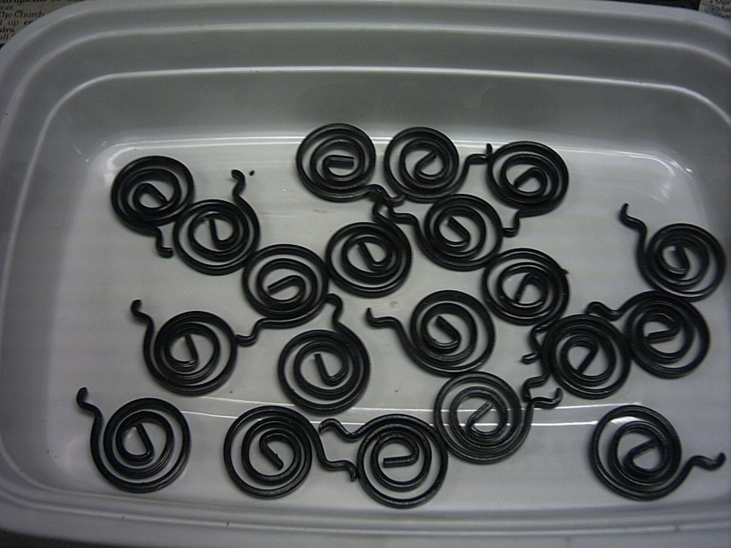

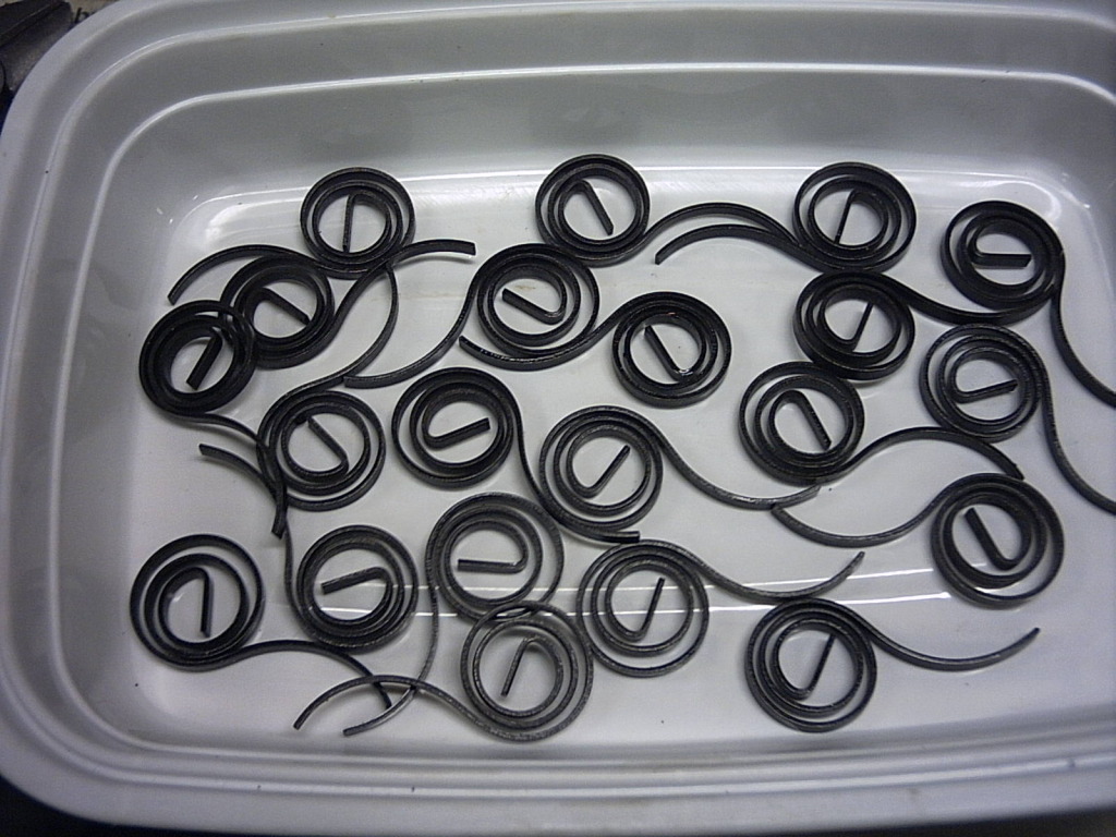

Door Latch Springs
Again extras made, but I have another car going in after this one and I will need some.

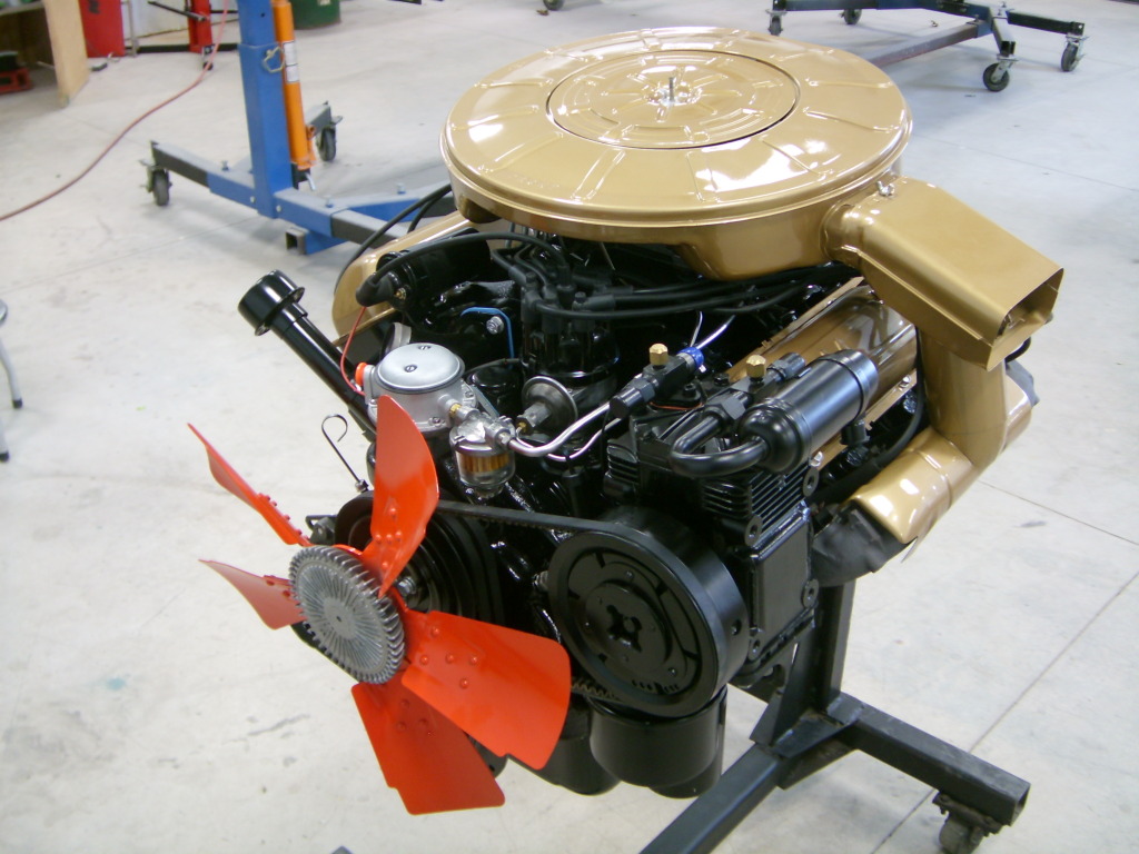

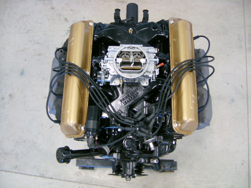

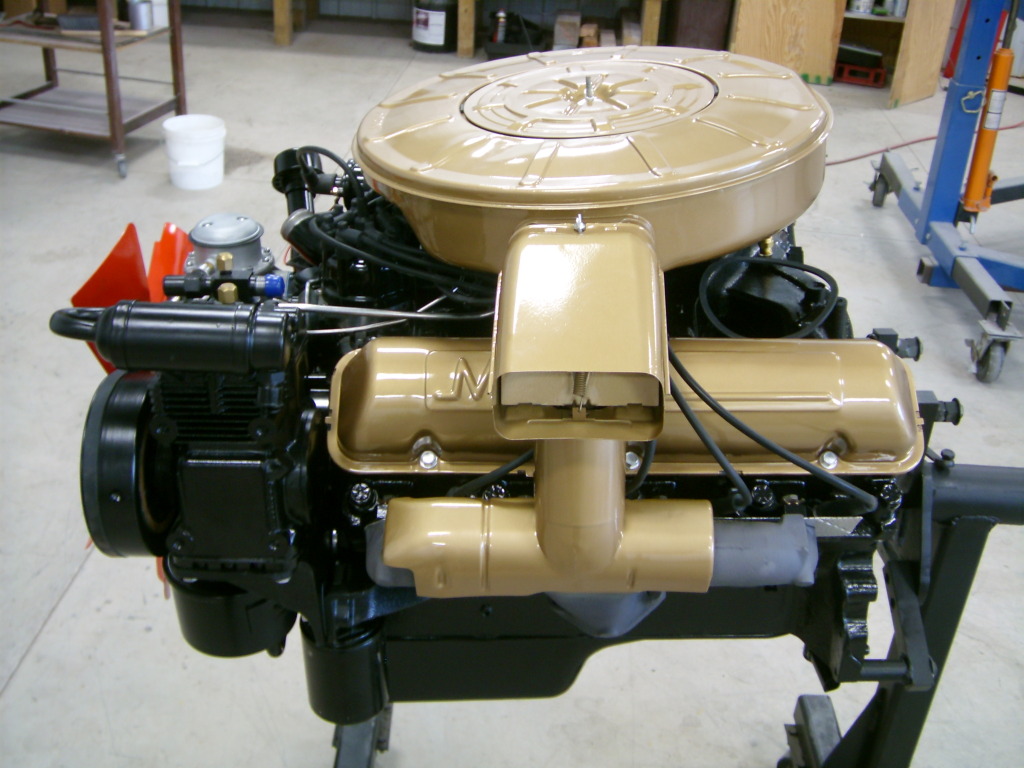

Post by Shelby#18 » Wed 21. Jul 2010, 21:52

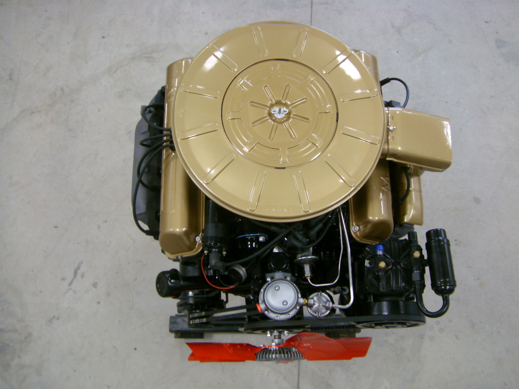

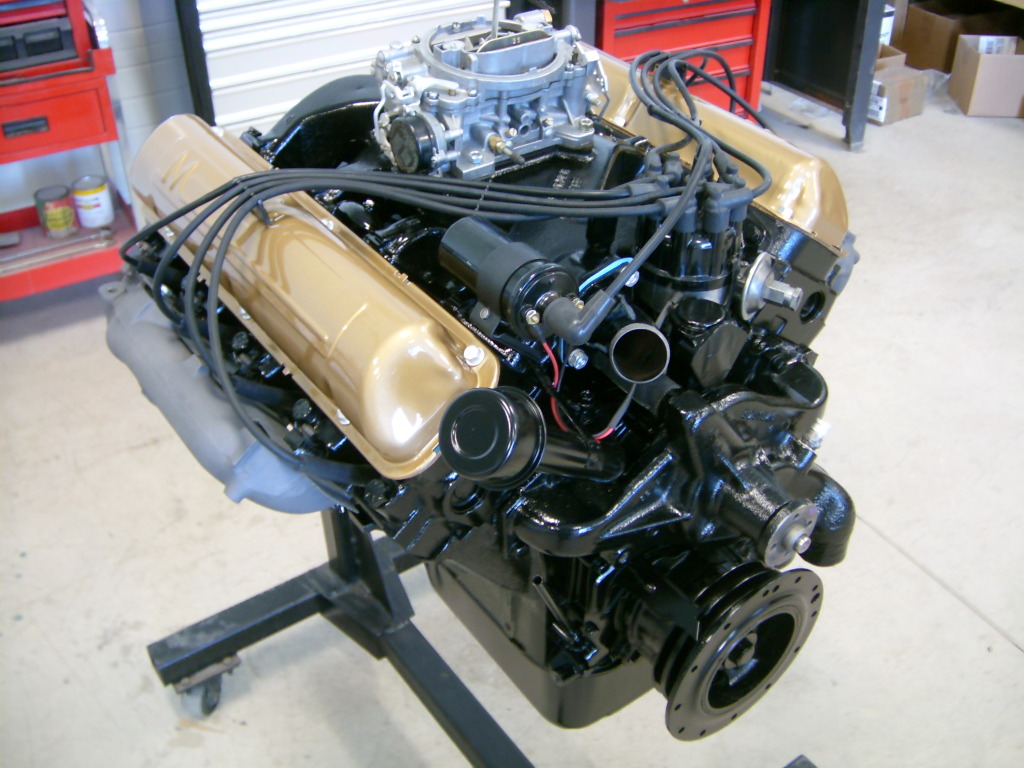

The repainted engine... Comments please if you see mistakes. I do know that the coil should be a "Yellow Top", one is on order.
Post by Shelby#18 » Thu 22. Jul 2010, 23:07

Post by reijerlincoln » Thu 22. Jul 2010, 23:34
Lovely! Almost a shame to start it (almost).
Post by Shelby#18 » Thu 22. Jul 2010, 23:38
Then don't watch this..... :lol:

Post by sidesho_bob1961 » Thu 12. Aug 2010, 10:24
Depending on whether you want your engine to remain "assembly line fresh" or not you may want to investigate a little further as to what colors your exhaust manifolds and heat shields should be. I have some assembly line photos of 410 engine equipped 58 Edsels and to the best of my knowledge the heat shields are black and the exhaust manifolds are cast iron gray. Believe it or not ,if the engine did not have heat shields between the head and exhaust manifold the exhaust manifolds were installed prior to painting (for instance a FE engine), thus they are engine color. I also have pictures to prove this. Both have mating machined surfaces and the only way to insure against exhaust leaks was to paint after assembly. Your restoration is coming along very nicely.....

sidesho_bob1961 wrote:.........Both have mating machined surfaces and the only way to insure against exhaust leaks was to paint after assembly.....
I know this from various FE sources. Best insurance against leaks is no gasket at all w. fresh machined surfaces. I thought that this was an old FE hot rodder trick. It's interesting to hear from you that this was a factory thing.
