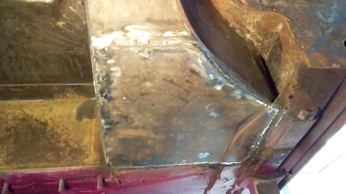

Hi Chris
I have only a few metal fab tools
-Shrink/Stretcher Dies
-Small and Cheaper Beadroller from Eastwood
-Cheap and nasty chinese pan brake
No English wheel yet. I might invest in one or make it from scratch if I find the need for one. I am by no means a master in this craft yet, but just shows a lot can be achieved if you are patient and willing to give it a go.
I do have another project (a Citroen HY van) with lots of rust that will require more than the tools I listed above, but I need to finish this Continental first before starting the other. For that one I will need to replace extensive sections of metal, I am thinking even to roll some of the corrugated panels from scratch...
Cheers
Julio
Cheers
Julio

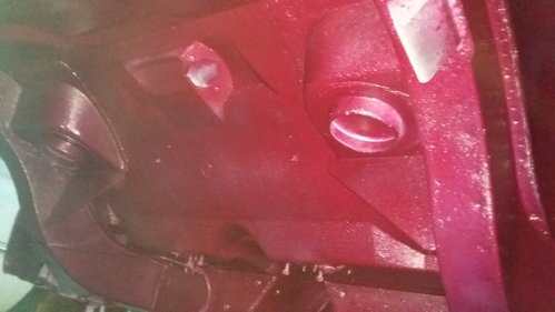

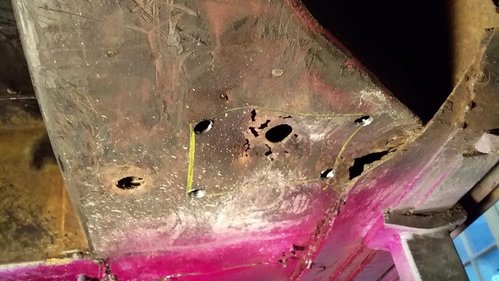

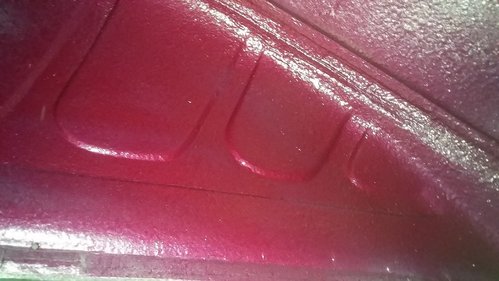

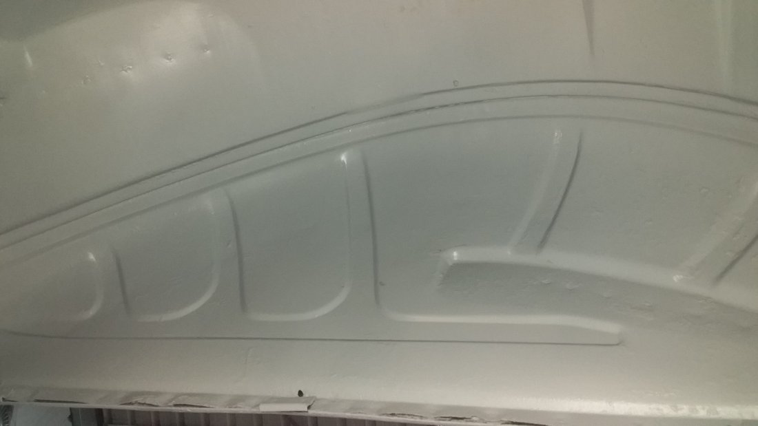

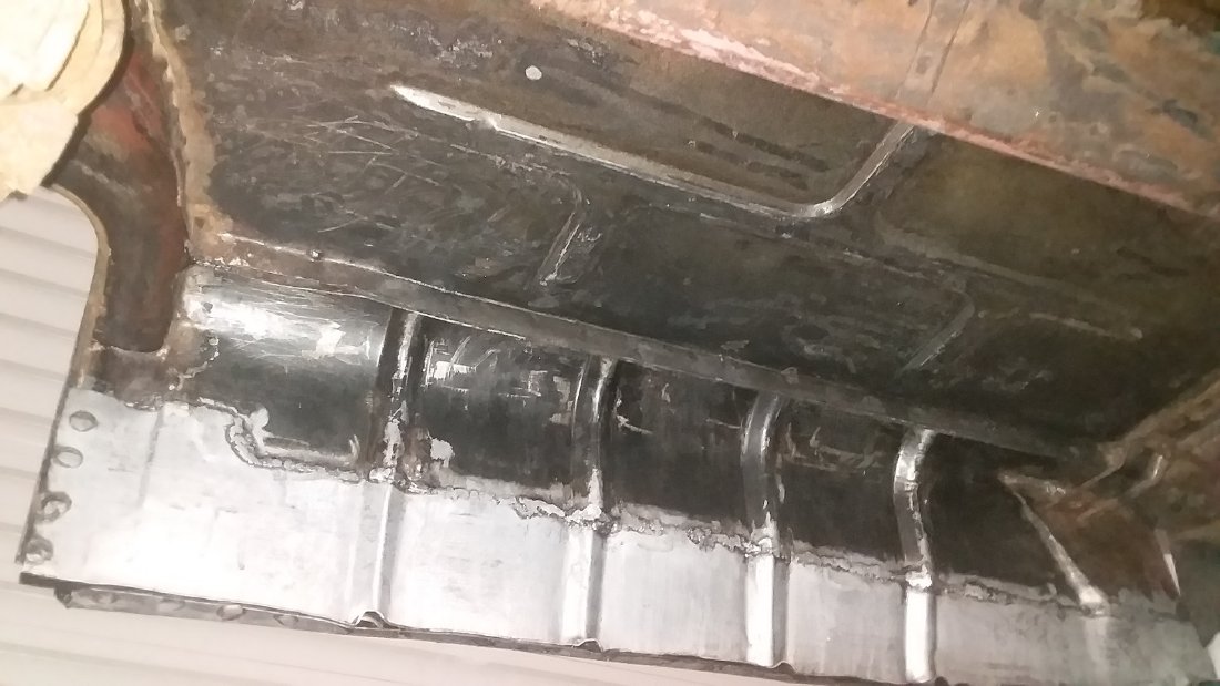

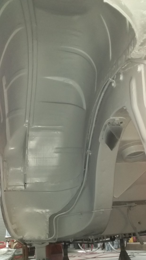

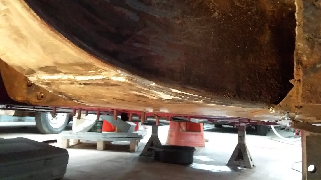

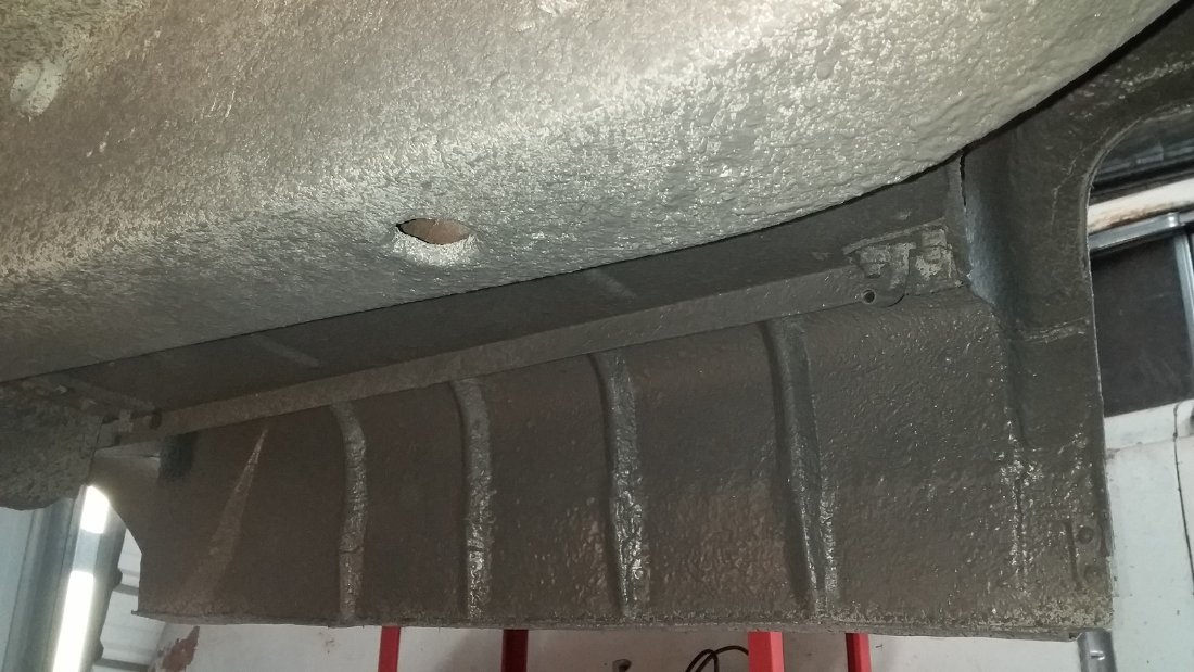

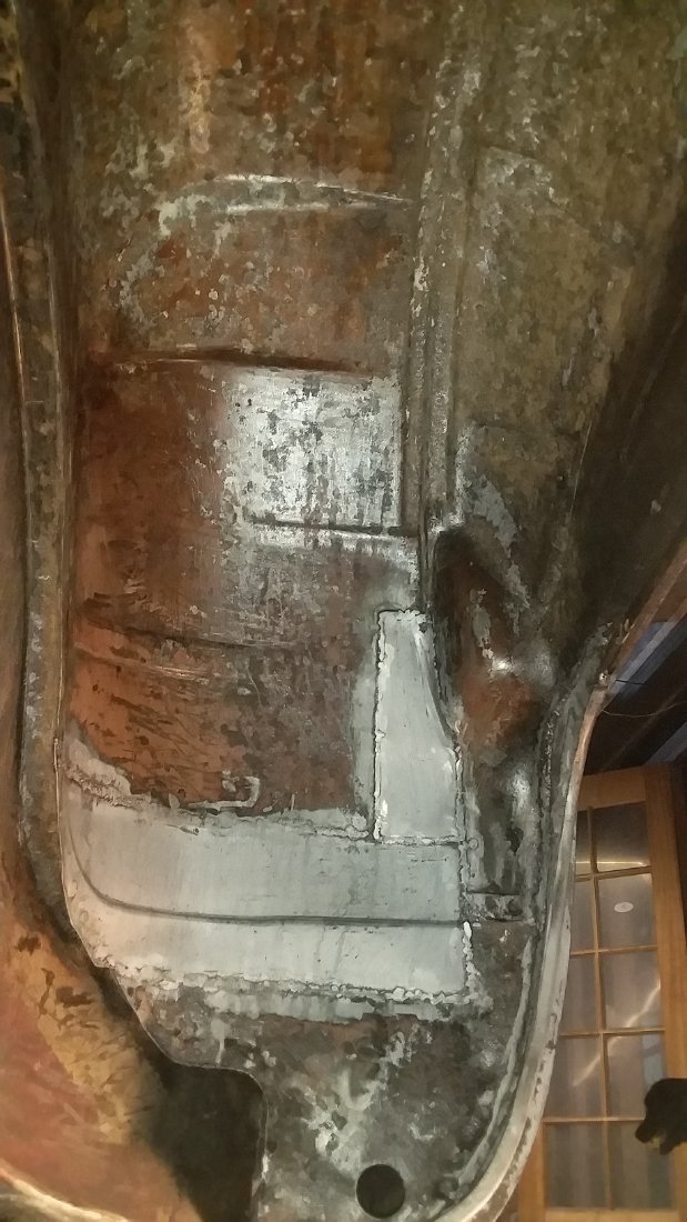

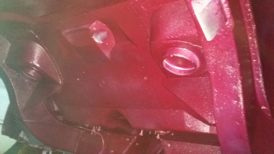

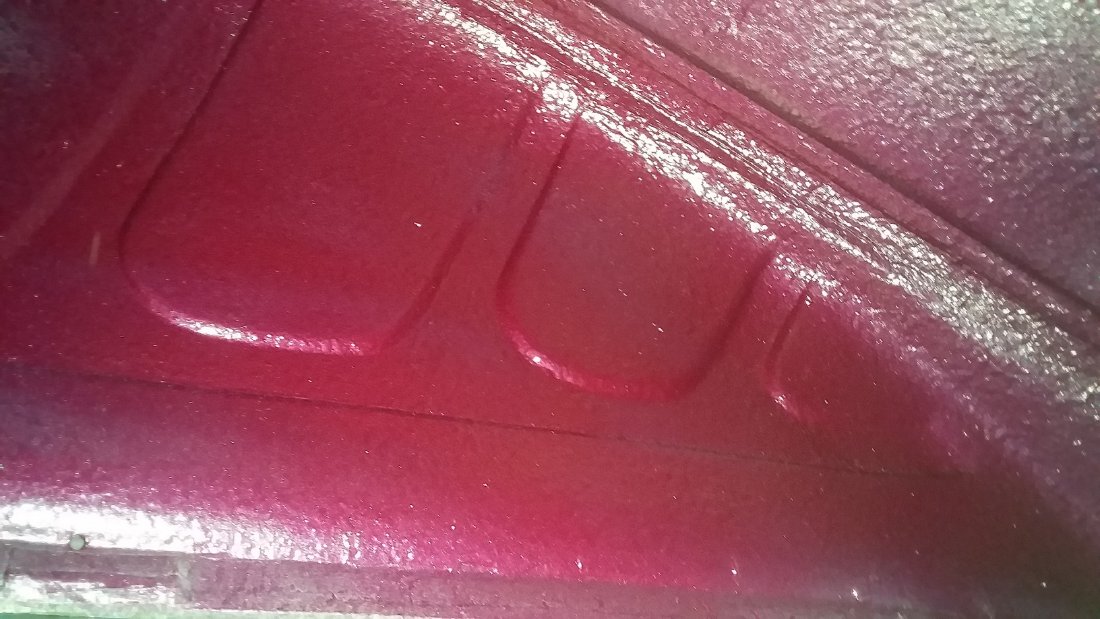

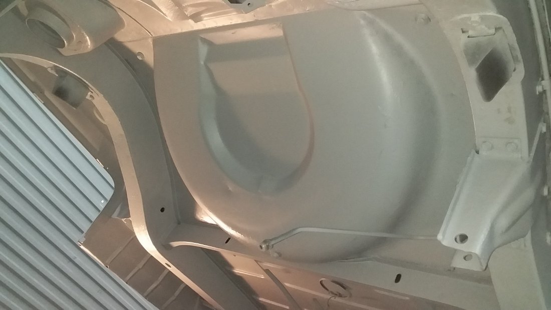

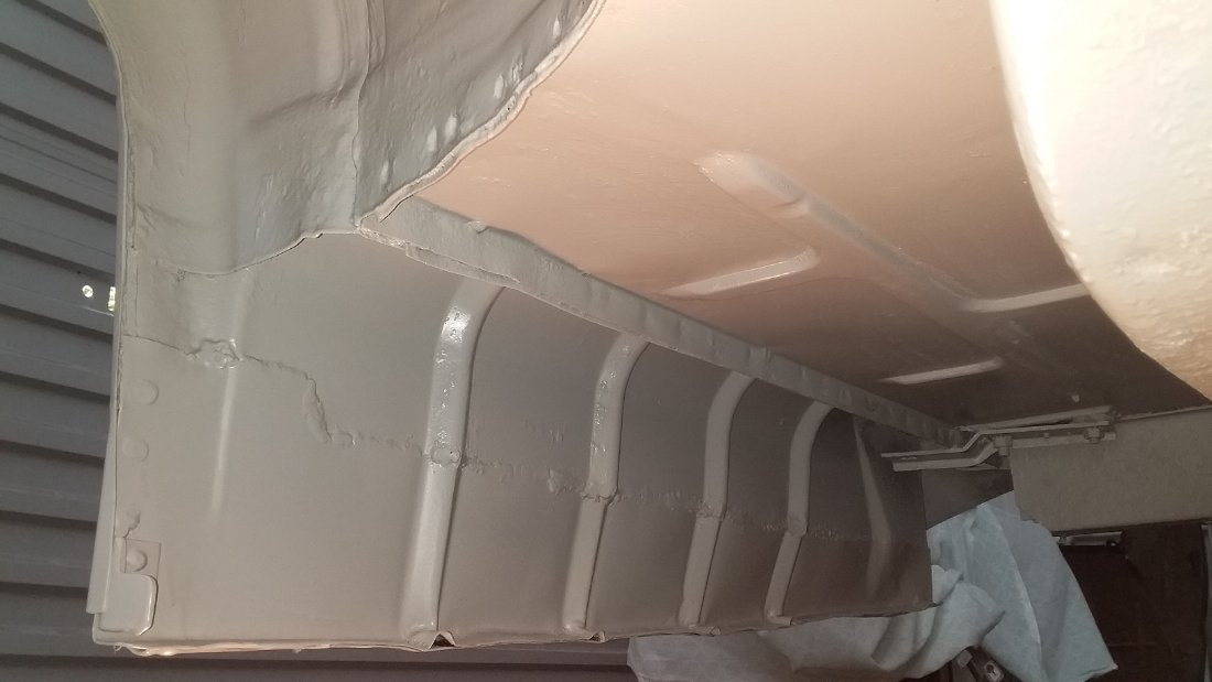

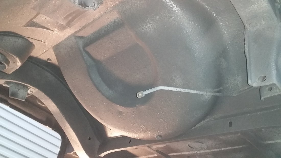

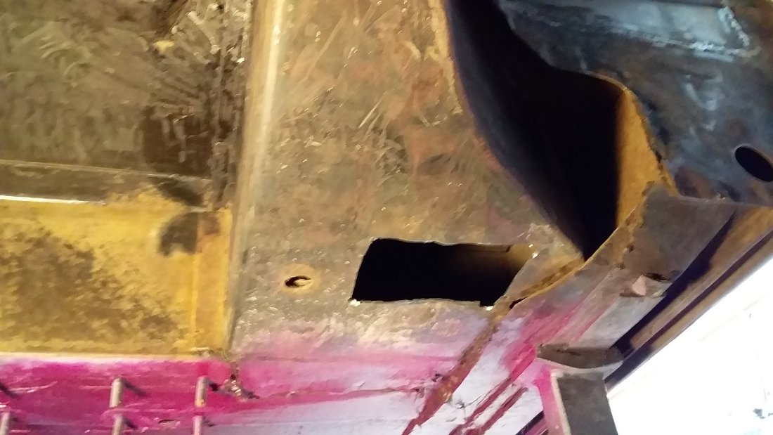

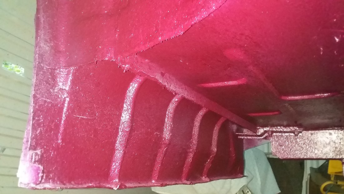

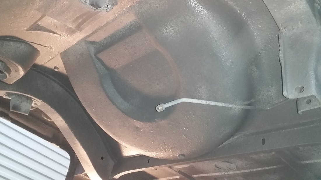

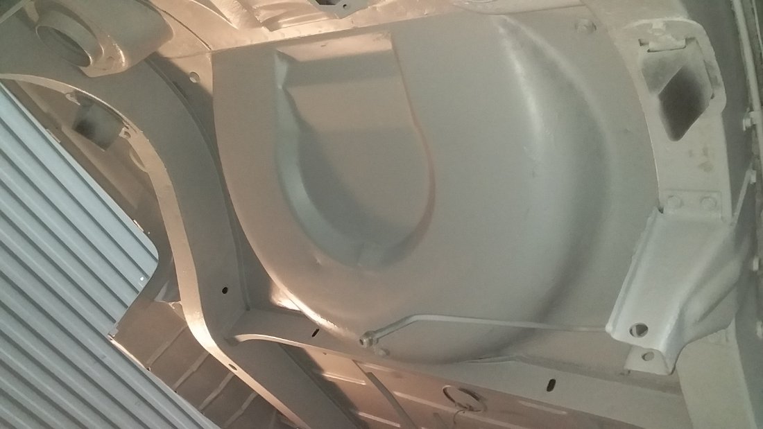

Undercarriage final Treatment of rear section post all metal fab and welds completed.
- Phosphoric Acid
- Primer
- Seam Seal
- Undercoating
- Paint
- Phosphoric Acid
- Primer
- Seam Seal
- Undercoating
- Paint

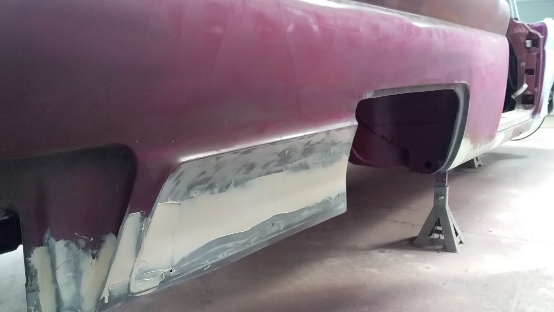

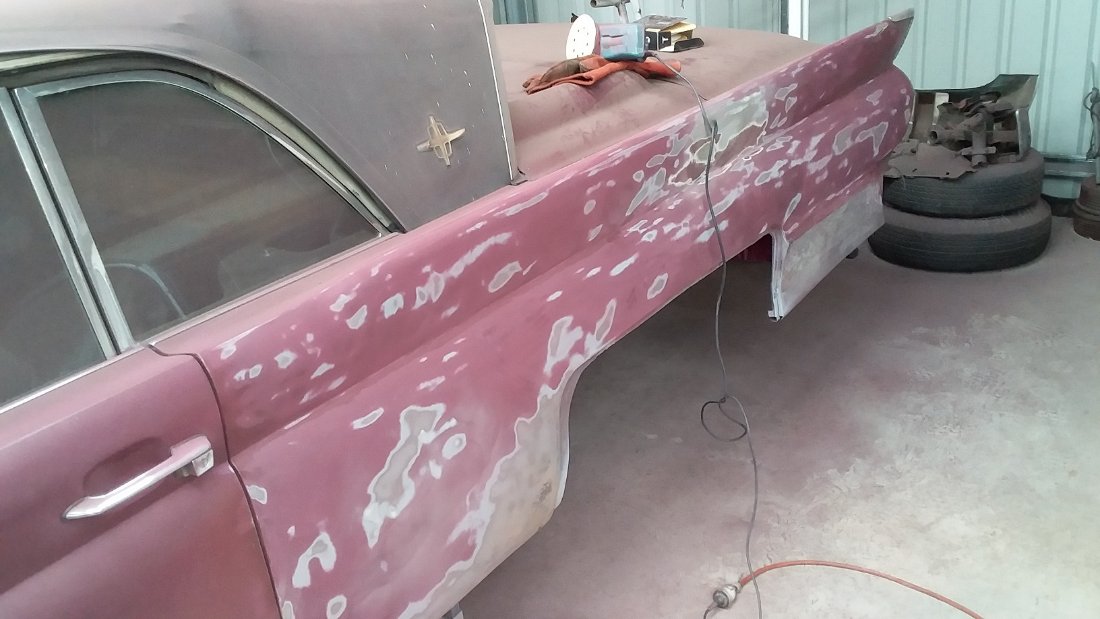

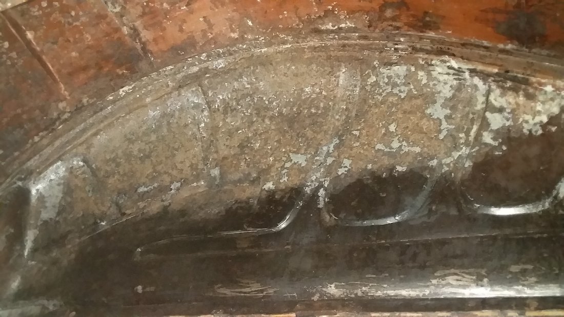

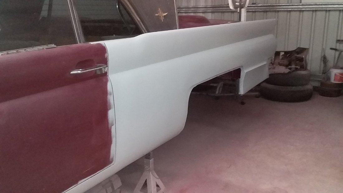

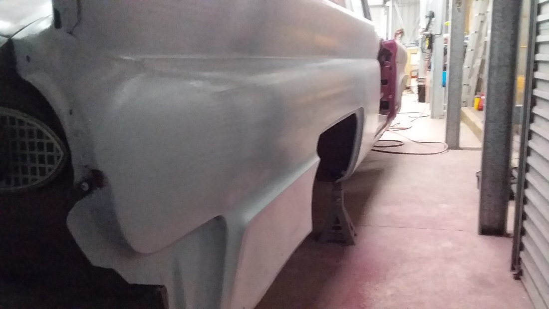

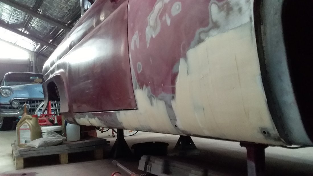

Body Prep - Sanding old coating with #80 / #120 / #180
A lick of body filler in some areas, and Primer applied with a roll. Block sanding and re-prime coming next.

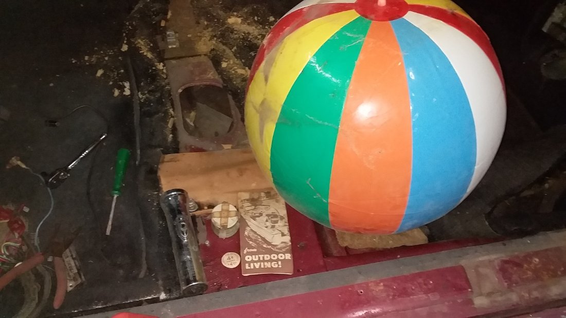

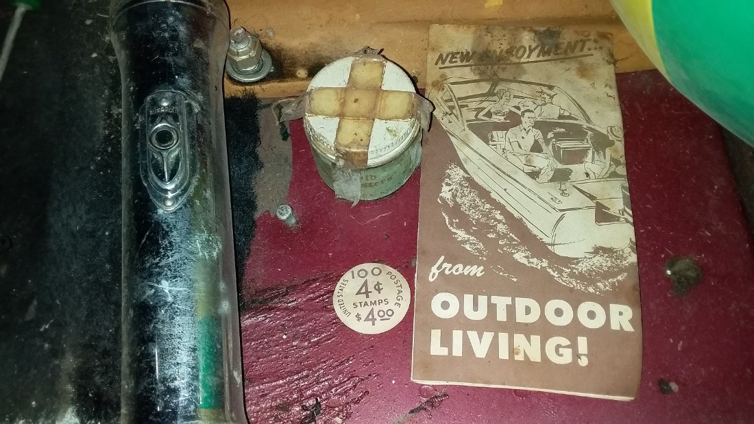

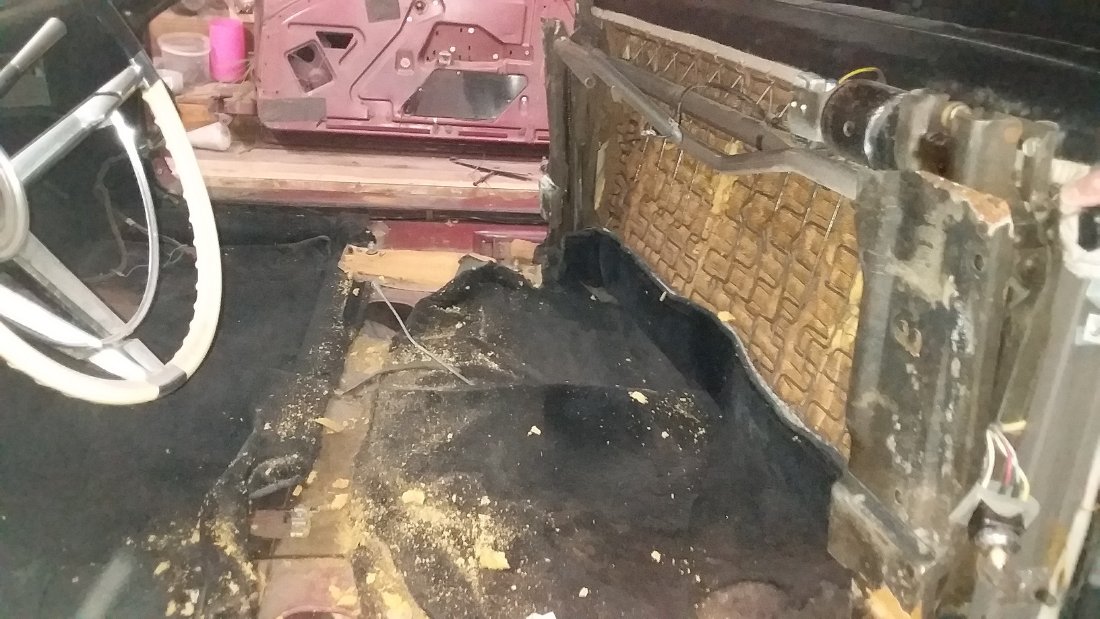

Removing the base of the front seat, found some items hidden in the lower body cavities.
Old Eveready flashlight (made in USA), a small jar with gold paint pigment, a leaflet for a protable cooler and a very cool coloured Inflatable ball.
I guess those items must been there since the 60's....

Like the postage find. I bet it was nice to have the dollar go further back then. I found a shop bill in an old Ford pickup. It was about $100 for parts and 12 hours labor. Were the Lincoln build sheets under the seat back then?

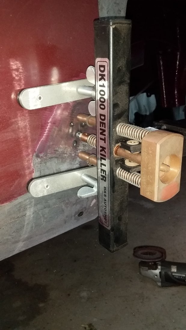

Hi Chris,
Haven't seen the bill sheet yet (if its still there). tonight I will take the seat base out and look for it properly.
Chipping some time on the car everyday (even if just 30 min after work during the week). I want it painted before end of September.

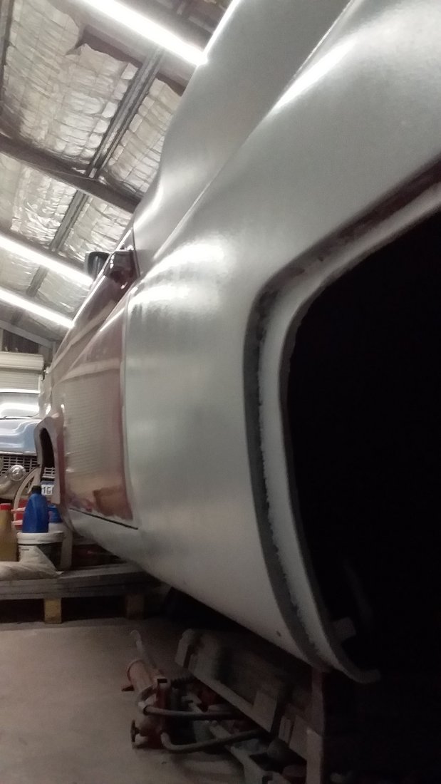

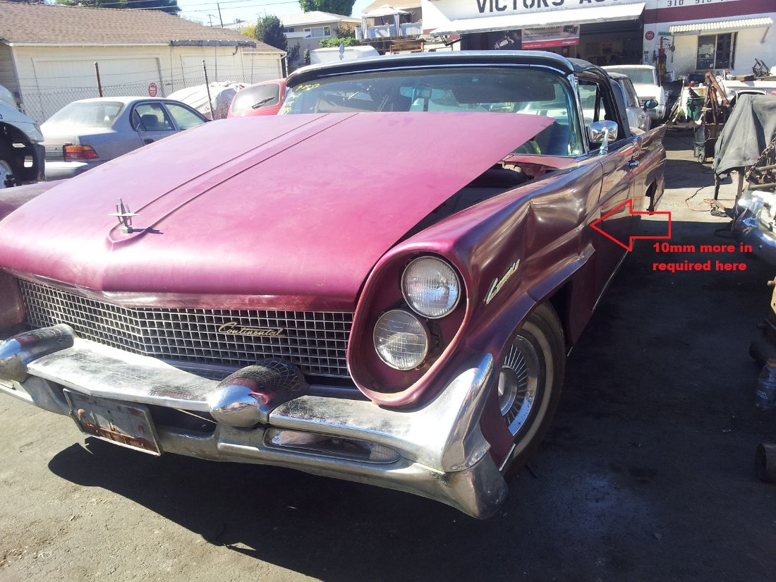

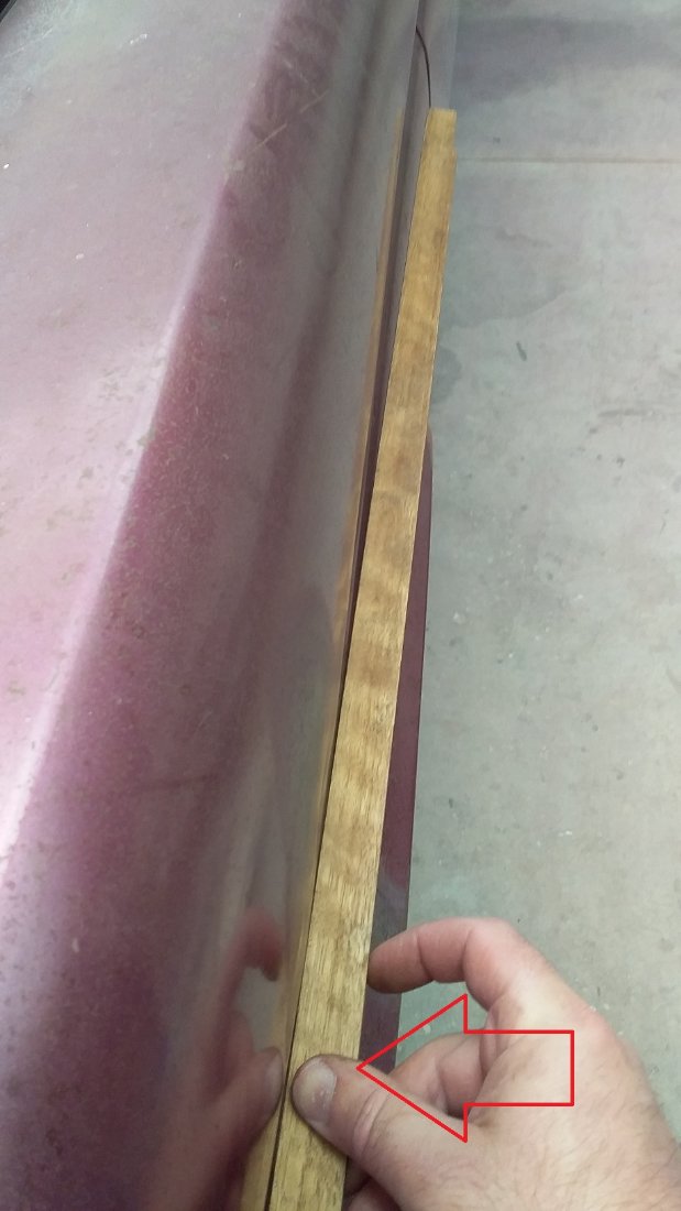

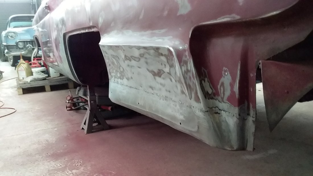

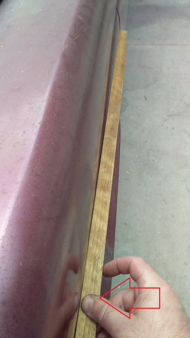

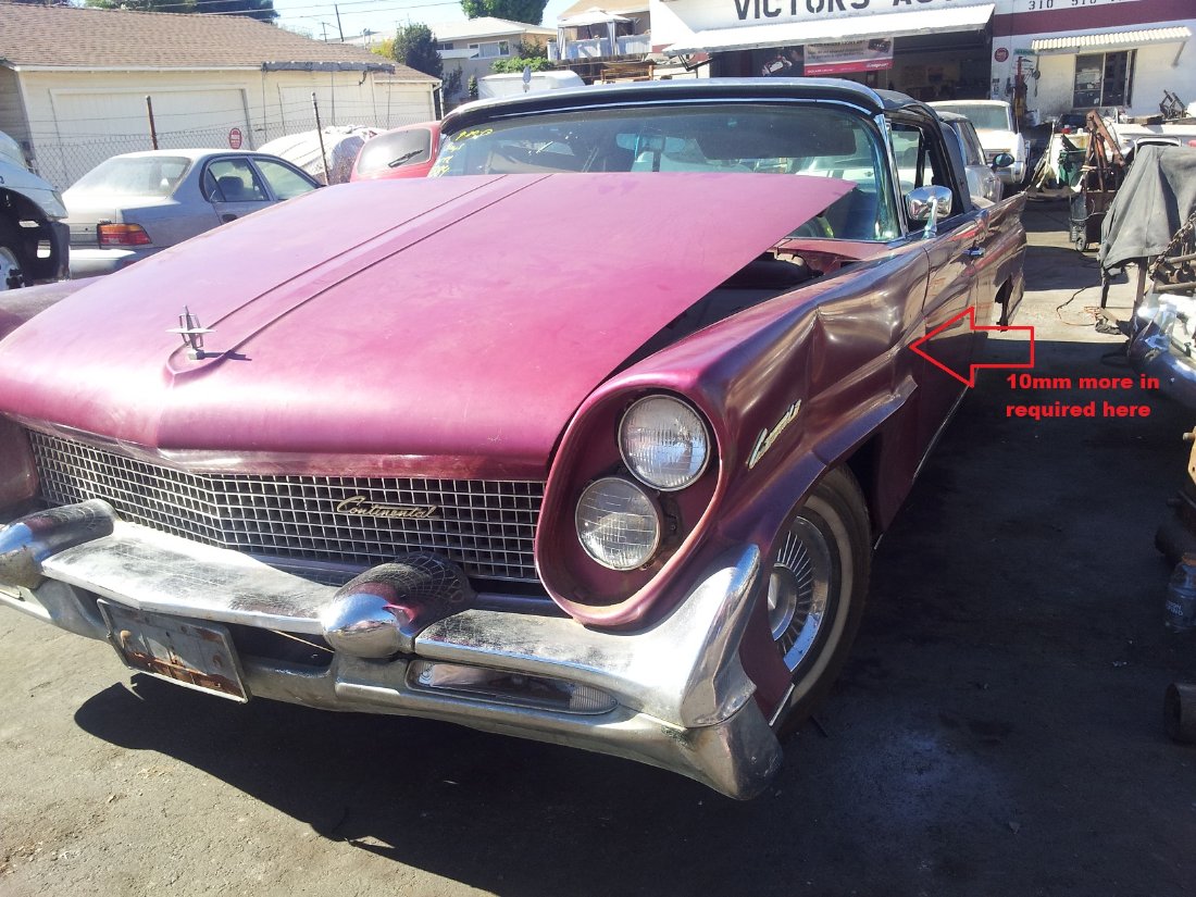

One repair is taking longer to fix is the buckling in the front Left fender due the previous collision. I need to push it in approx 10mm over a large area. Looks like it requires shrinkage etc. The Fender was previously replaced in the past and was poorly welded at the rear where it meets the door.
I Found the sheetmetal at this car is a bit more difficult to repair due the ample straight areas.

Re: 1958 Continental Claret -
Before when I got the car
Now After I fixed most of the dents and distortion
