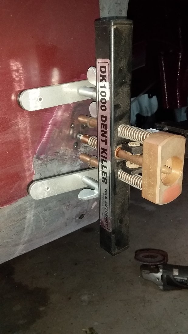

One repair is taking longer to fix is the buckling in the front Left fender due the previous collision. I need to push it in approx 10mm over a large area. Looks like it requires shrinkage etc. The Fender was previously replaced in the past and was poorly welded at the rear where it meets the door.
I Found the sheetmetal at this car is a bit more difficult to repair due the ample straight areas.

Before when I got the car
Now After I fixed most of the dents and distortion
