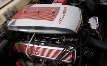

Super Marauder Restoration, Instalation and Tuning.
Preview...

Post by reijerlincoln » Thu 12. Mar 2009, 07:52
That's a cool looking air filter housing. Rare as hen's teeth, I take it?

Post by KULTULZ » Sat 21. Mar 2009, 03:15
This is the correct appearance-
1958 MERCURY SUPER MARAUDER INSTALLATION
1958 MERC Montclair SUPER MARAUDER.jpg (18.13 KiB) Viewed 20376 times
Re: Super Marauder Restoration, Instalation and tuning. DIY
Post by Theo » Sat 21. Mar 2009, 03:20
Yeah, an all time tasteful package. Thanks for the photo.
