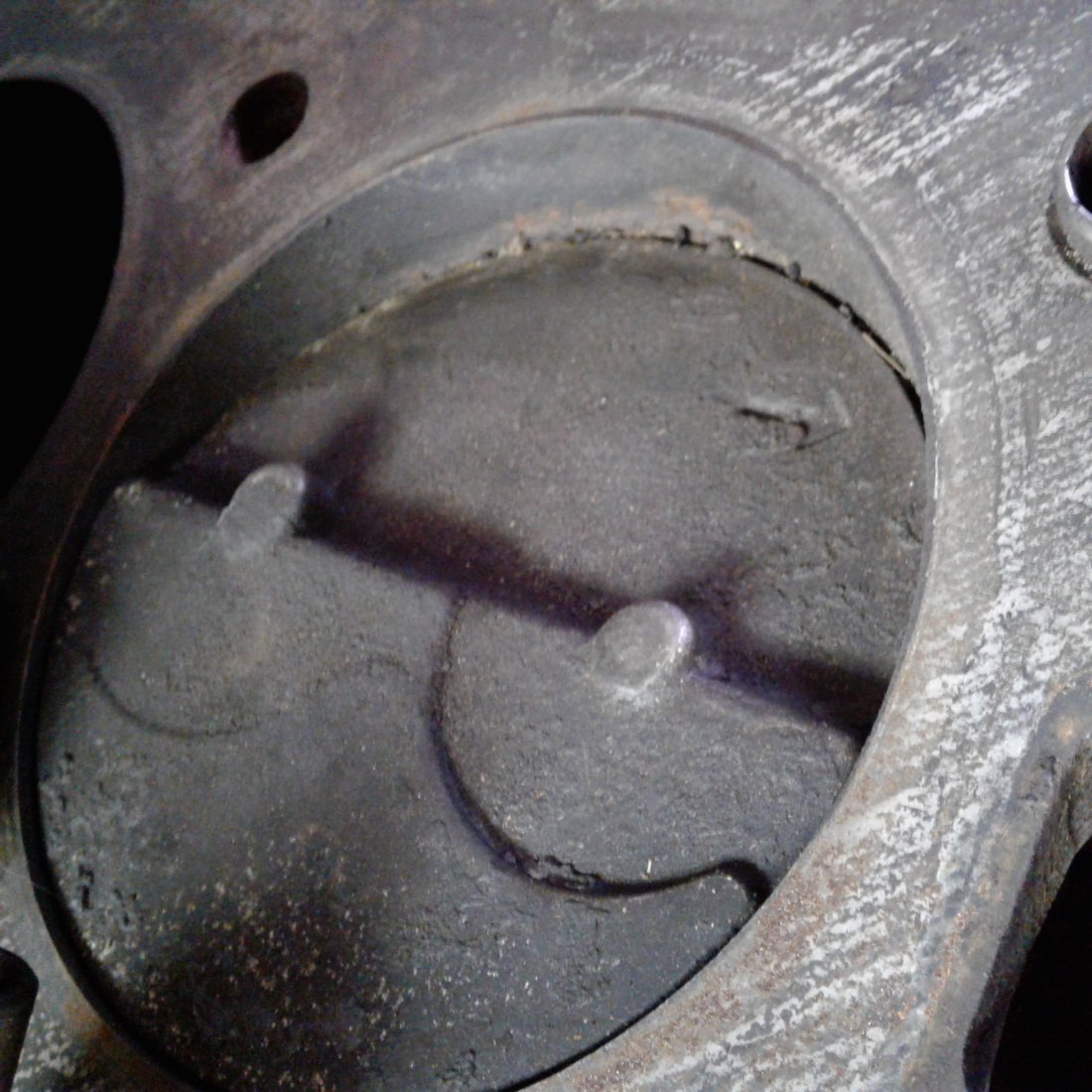

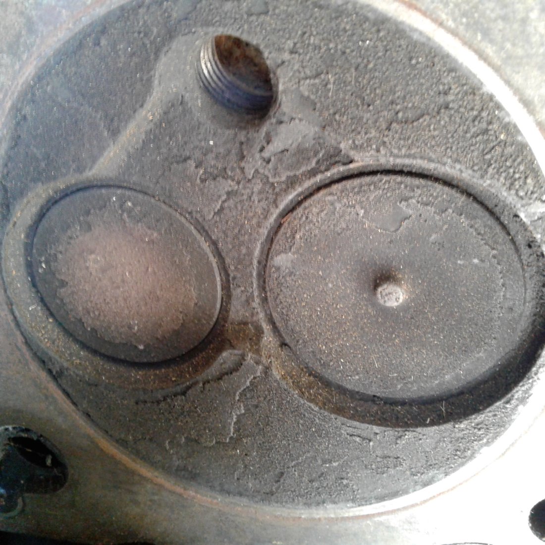

If you have a 1963, 1964 or 1965 430 your original heads will have a small combustion chamber. 1958-62 430's and 1966-March 1968 462's have the smaller step pistons and no combustion chamber in the head. The 430's step will be slightly larger. Pictured is a 1965 430 head and piston.

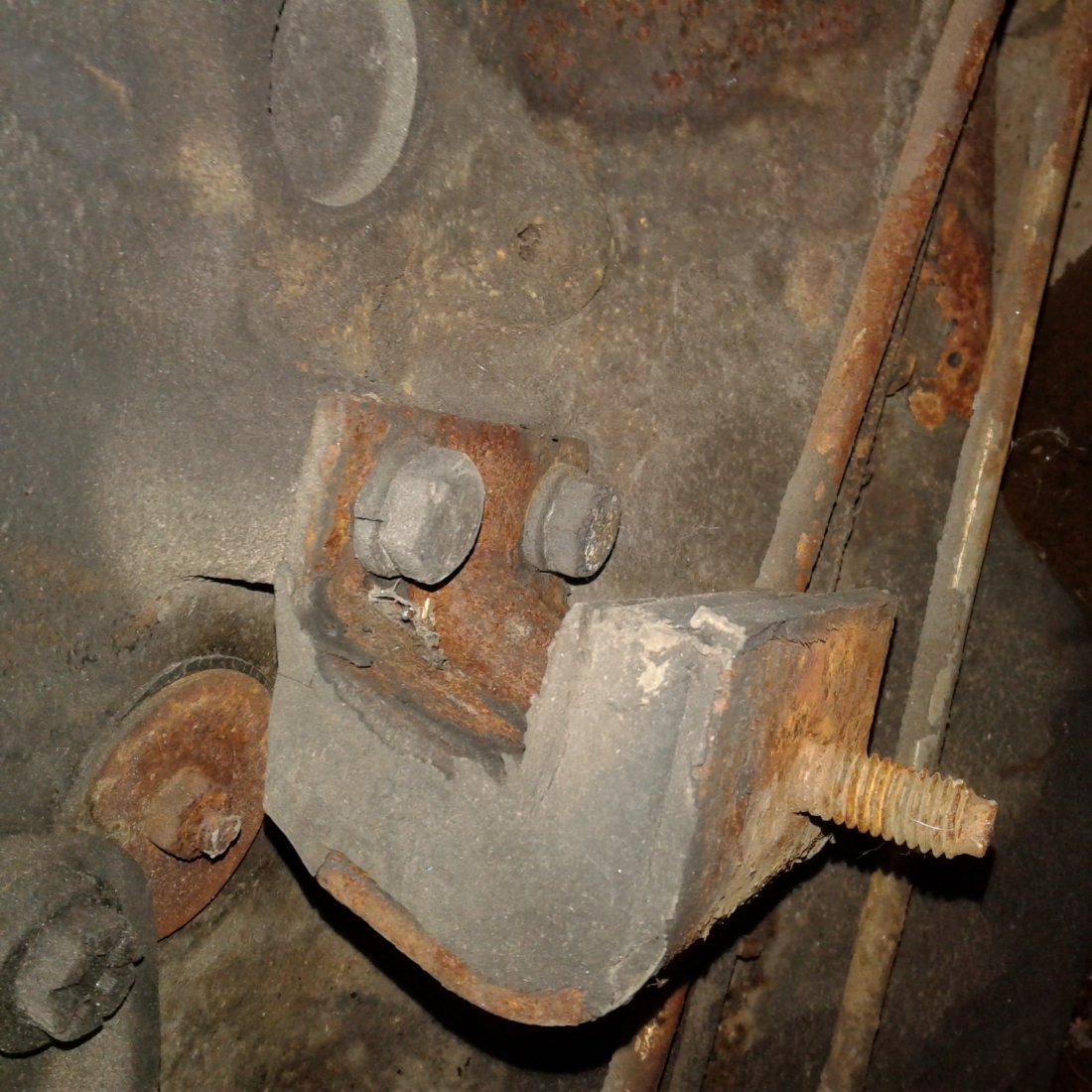

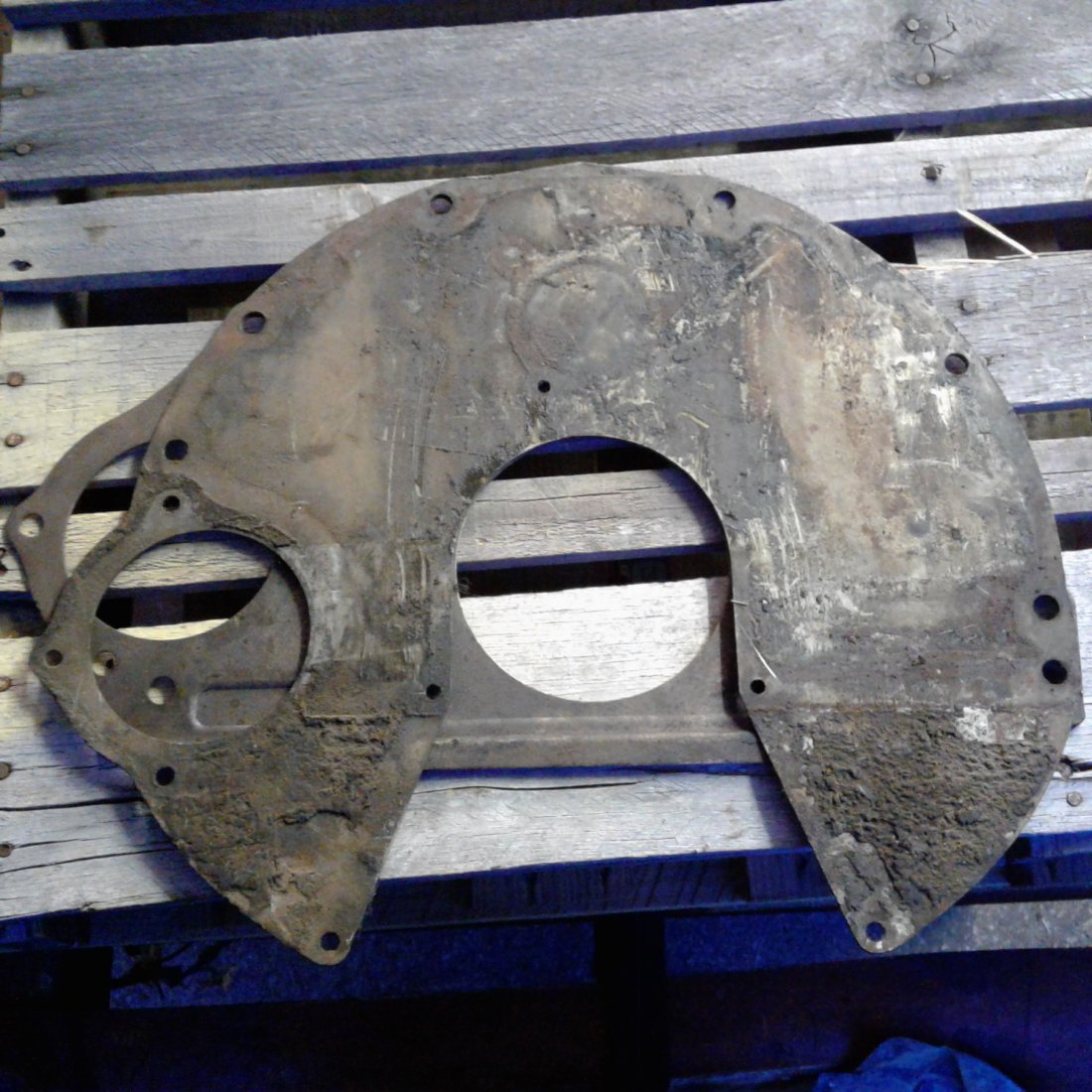

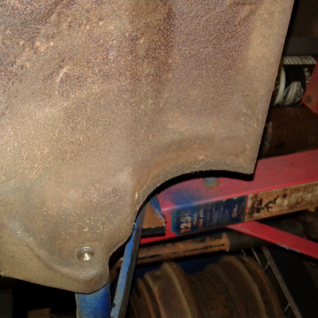

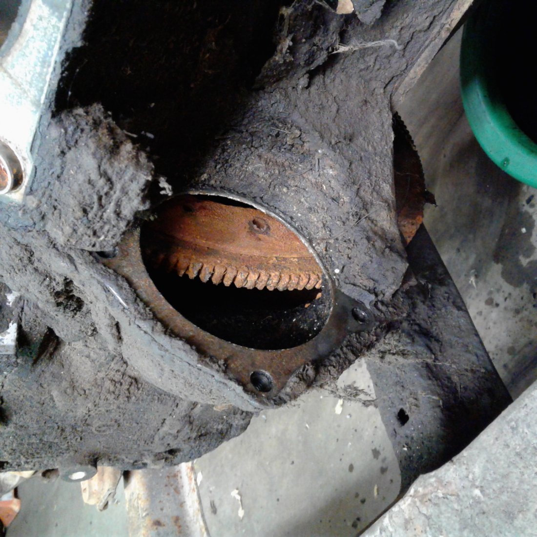

No problem. I am currently working on adapting a 65 MEL to a FE/FT bellhousing. If you have a 58-60 block you will have the FE bellhousing. (See pictures below) If your block is a 1958 it will NOT have the middle side engine mount bosses. 59-68 have these engine mount bosses. 1961-68 blocks have the relocated starter. As pictured 61-68 4 bellhousing bolts and both dowls are shared with the FE. There is no bolt below the starter.

That will make more sense to us when we look at engine.
Was told it is a C6 if that helps but that probably should wait for us to confirm it.
