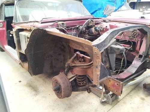

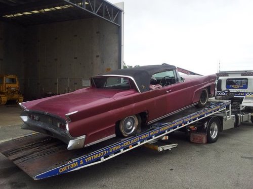

Hi there,
I have been working on this car for around one year now. Got it from a Gentleman in Detroit and sorted the logistical exercise to get shipped down under (Australia, WA) where I am based.
So far I managed to rebuilt the engine and started some bodywork, there will me more to come. I will create a restoration thread and keep it updated with progress as I move forward.
Cheers
Julio

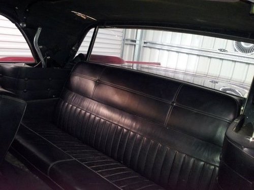

Photos from the day I collected it here after the ''quarantine'' cleaning...
Photos at my garage after I cleaned all the mess quarantine did it.

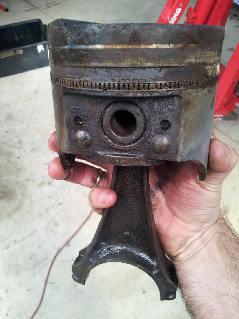

From my findings, the engine seized a long time ago. The gentleman I got it from just kept it for a period but gave up starting the fix (he got from a PO who actually collected some parts and tried to start some work to it).
I guess he thought the engine not turning was due to a fault ignition switch (he replaced a generic one, luckily the original one I found it in the trunk and matches the door keys).
Then he went to the starter motor pinion ( I found remnants of a pinion inside the bell housing area). Also Excessive grinding the flexplate ring gear was present when I pulled apart.

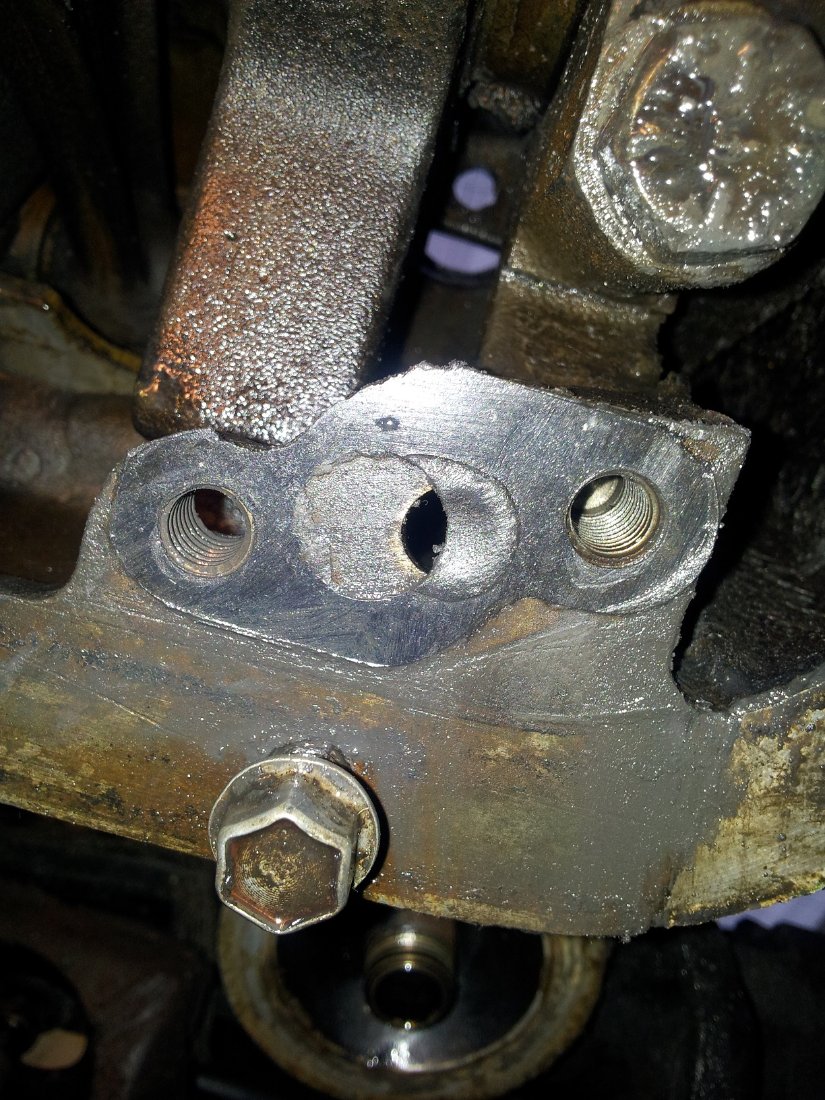

Almost 1.5'' of sludge in the valve train, under the valley pan etc. I also found that someone had replaced the oil pump gasket and aligned it very poorly with the oil feed gallery, blocking 40% of the passage.
I guess the excessive sludge, intermittent use and poor lubrication caused the engine to seize.

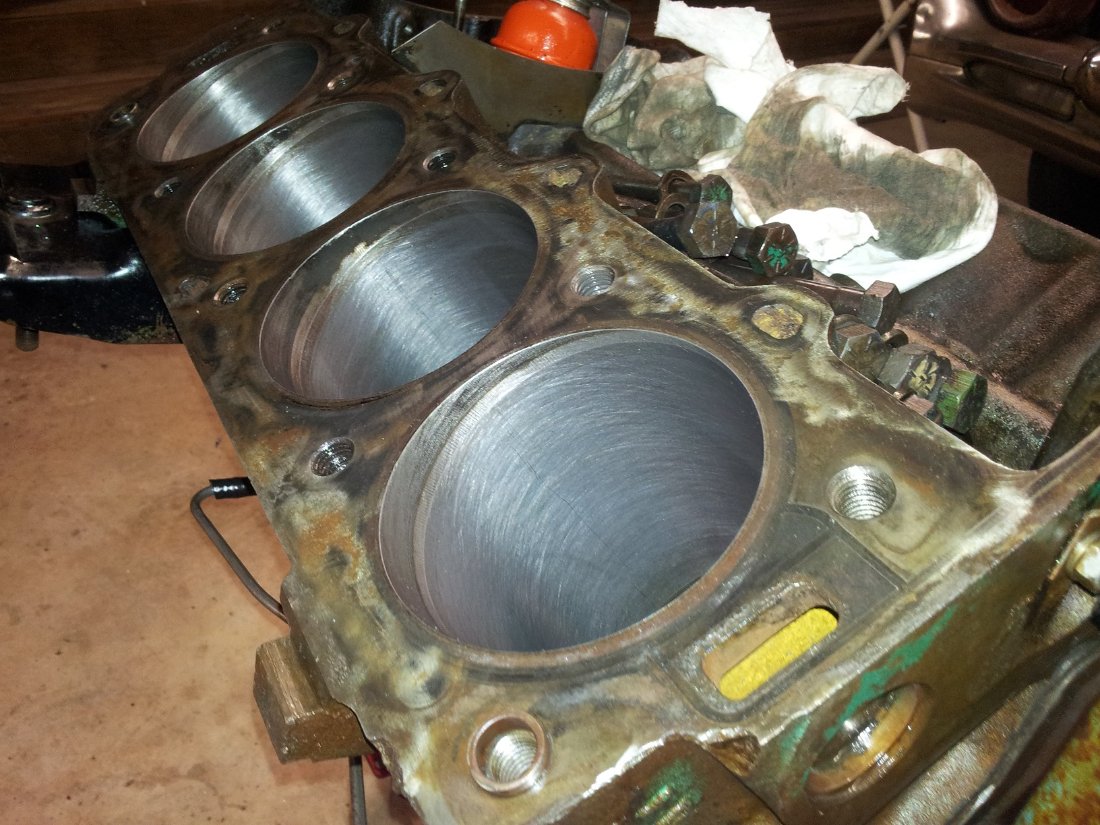

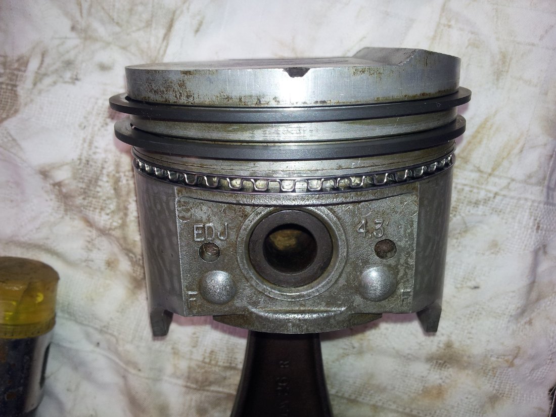

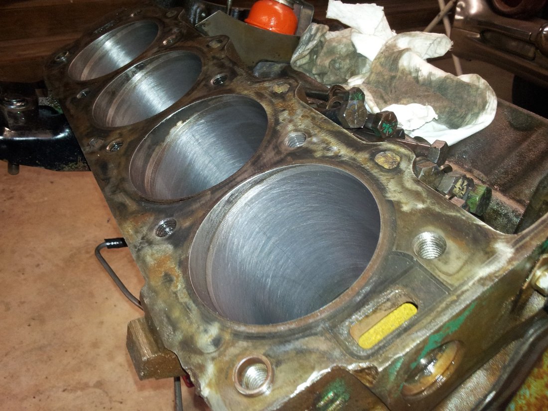

Main bearings were ok (no wear) so I could reuse them. I managed to remove the pistons very carefully without any damage to the pistons and bores. Measured everything and they were still within spec. So I removed carefully the rings and installed new ones, a did a light hone to the bores.

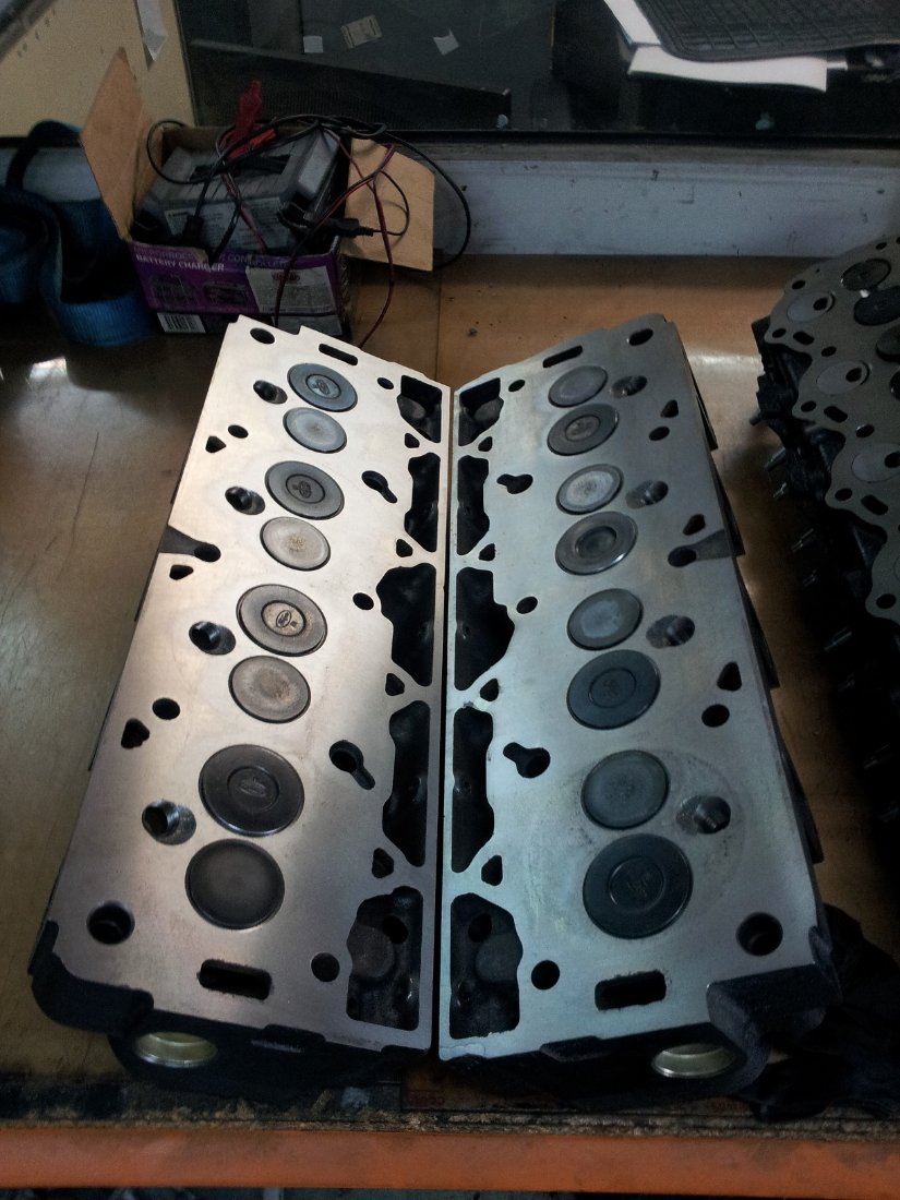

Heads got seats reground, one intake valve needed to be replaced. No cracks present.

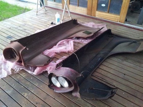

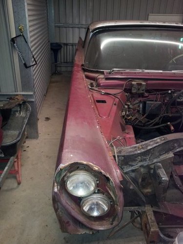

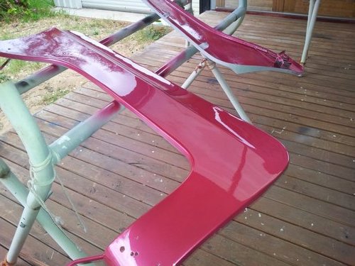

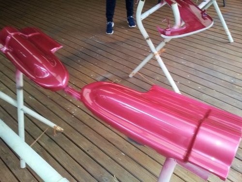

Some progress photos
RH fender replacement
Spray color testing on rear skirts and parade covers

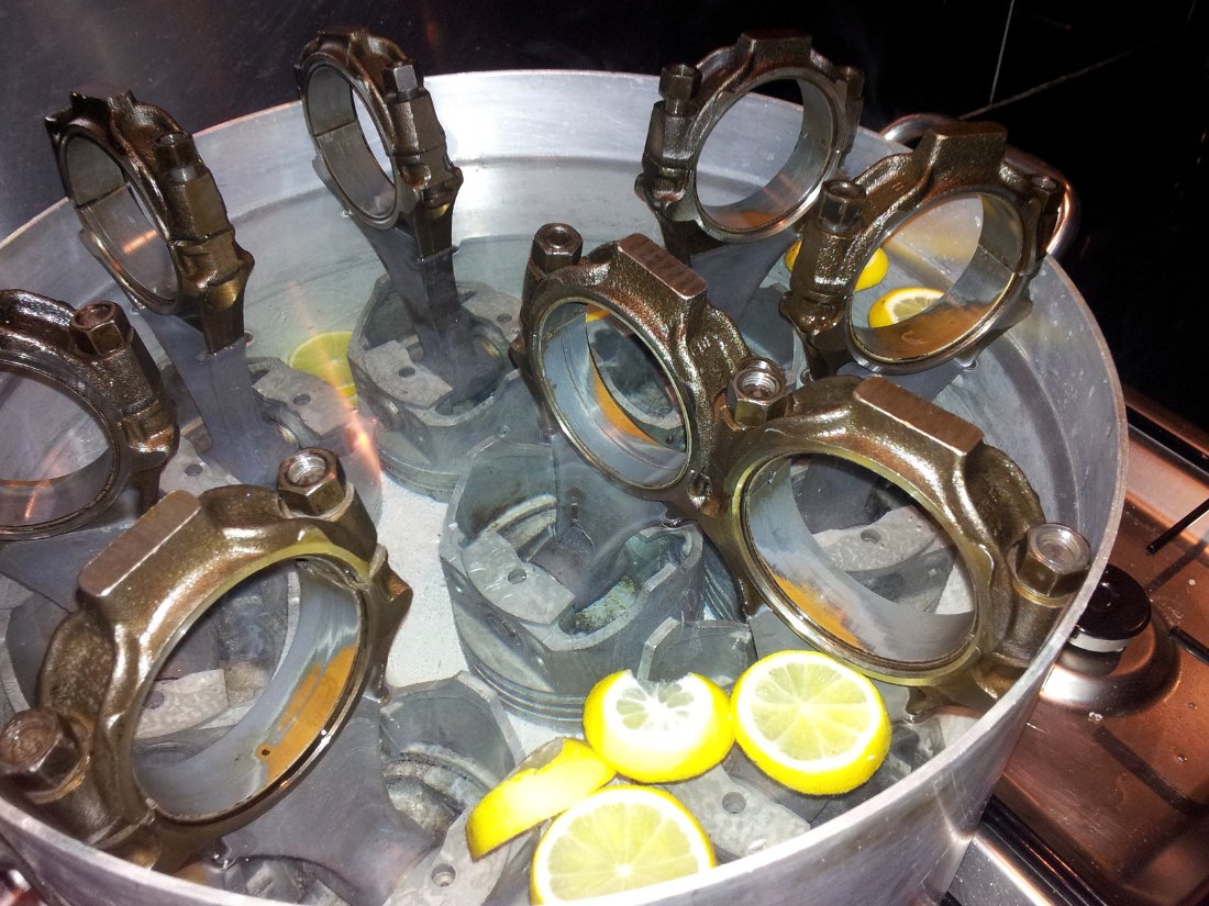

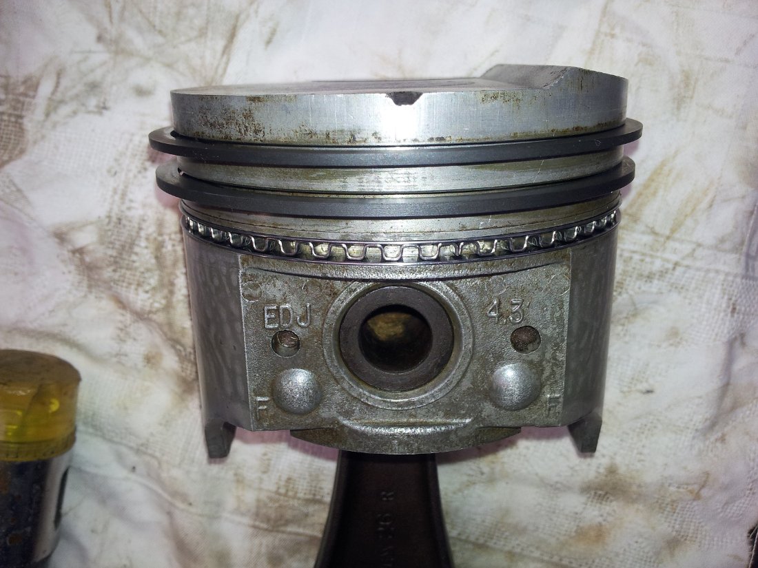

Pistons after removal
Final cocktail Piston punch cleaning
Cleaned with new rings prior reinstall

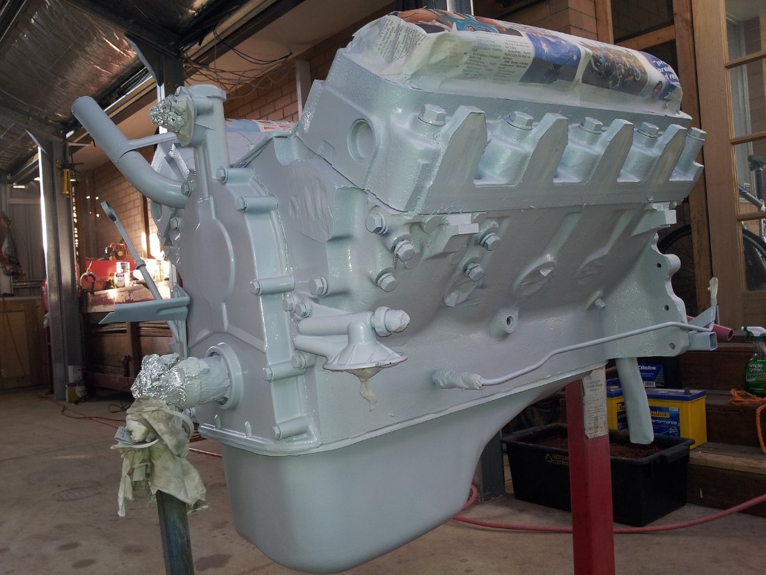

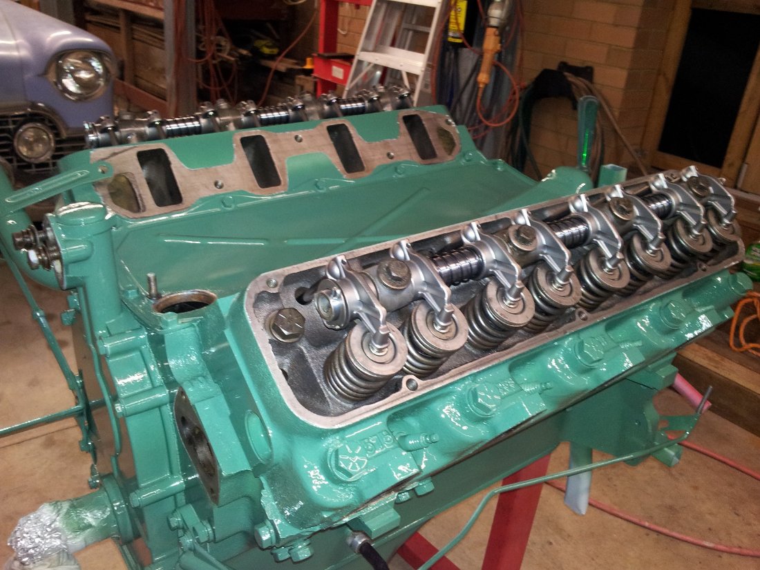

Heads after re machining

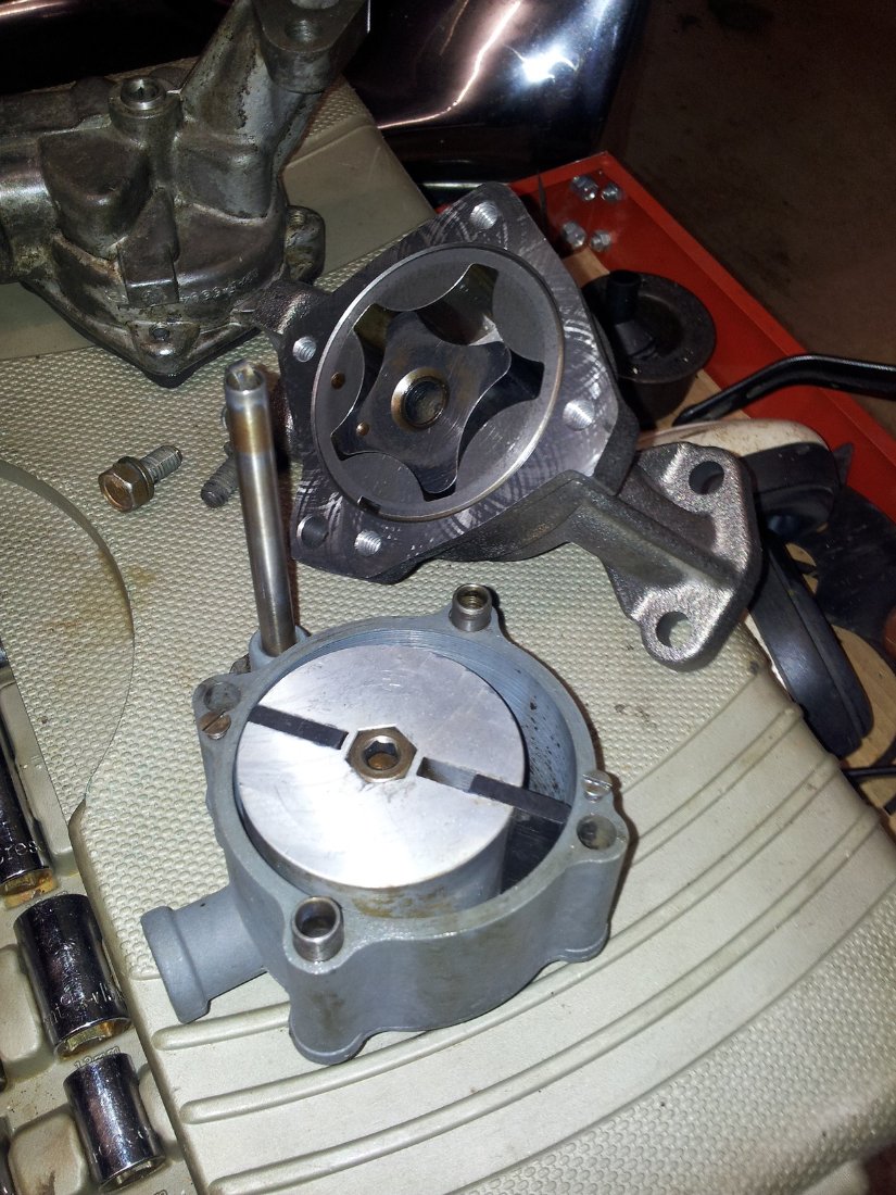

Vacuum pump rebuilt and new oil pump
Bores after brush honing
Primer

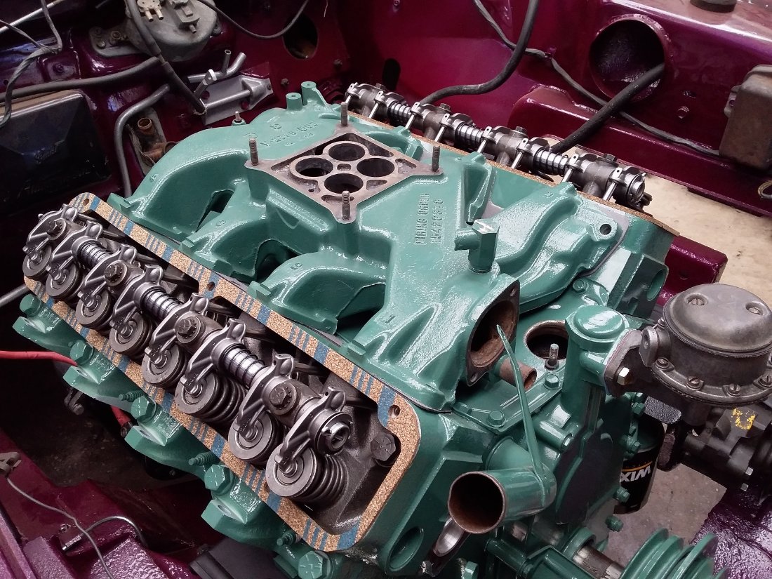

Top end assembly

How I found the Oil Pump gasket :shock:

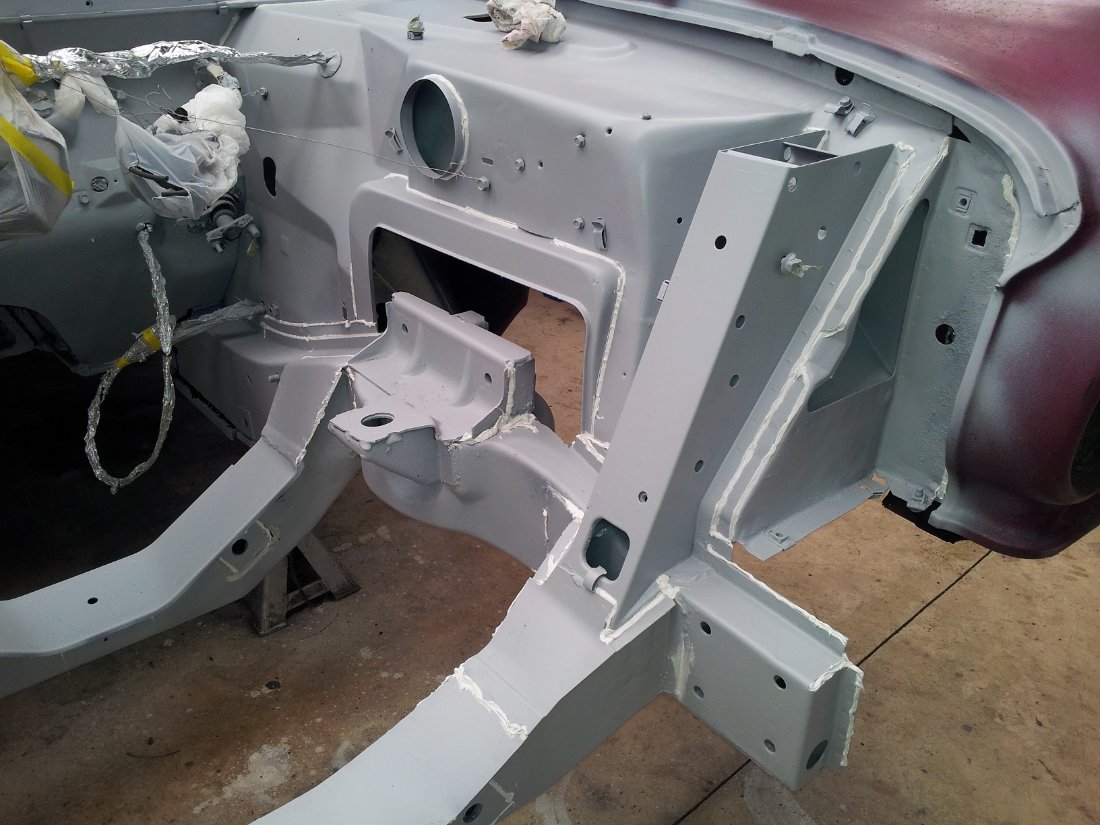

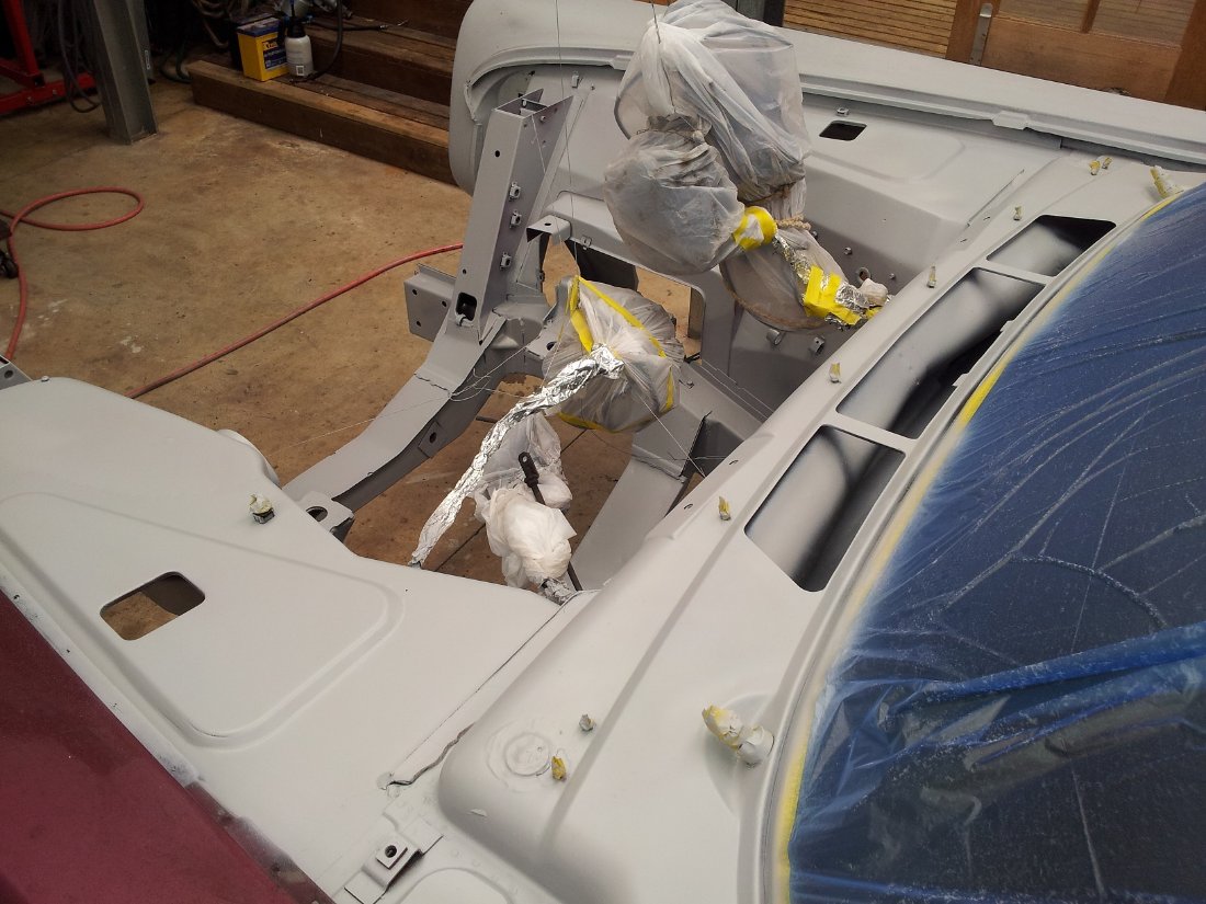

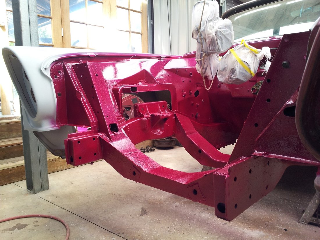

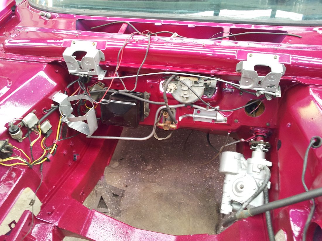

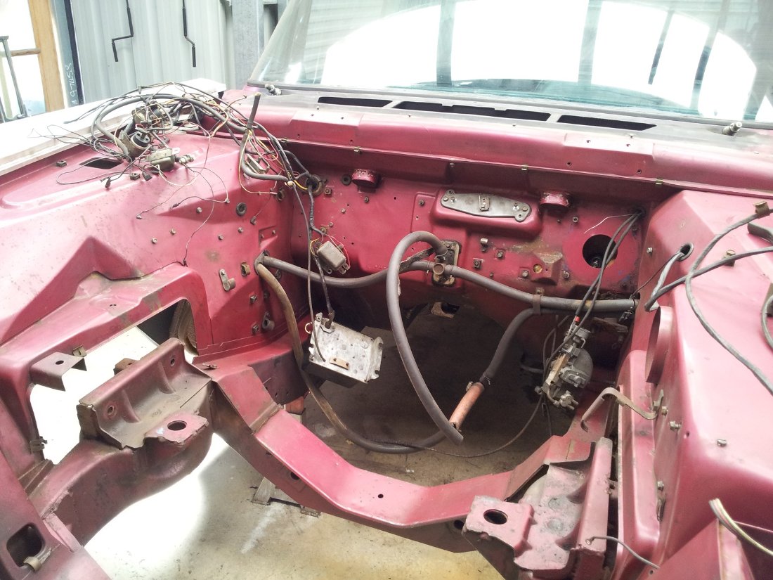

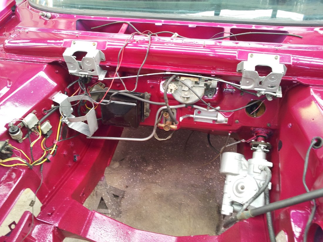

Prepping up Engine bay for fresh paint
Engine Bay Primer
Seam Sealing
Fresh Paint
Riggin up

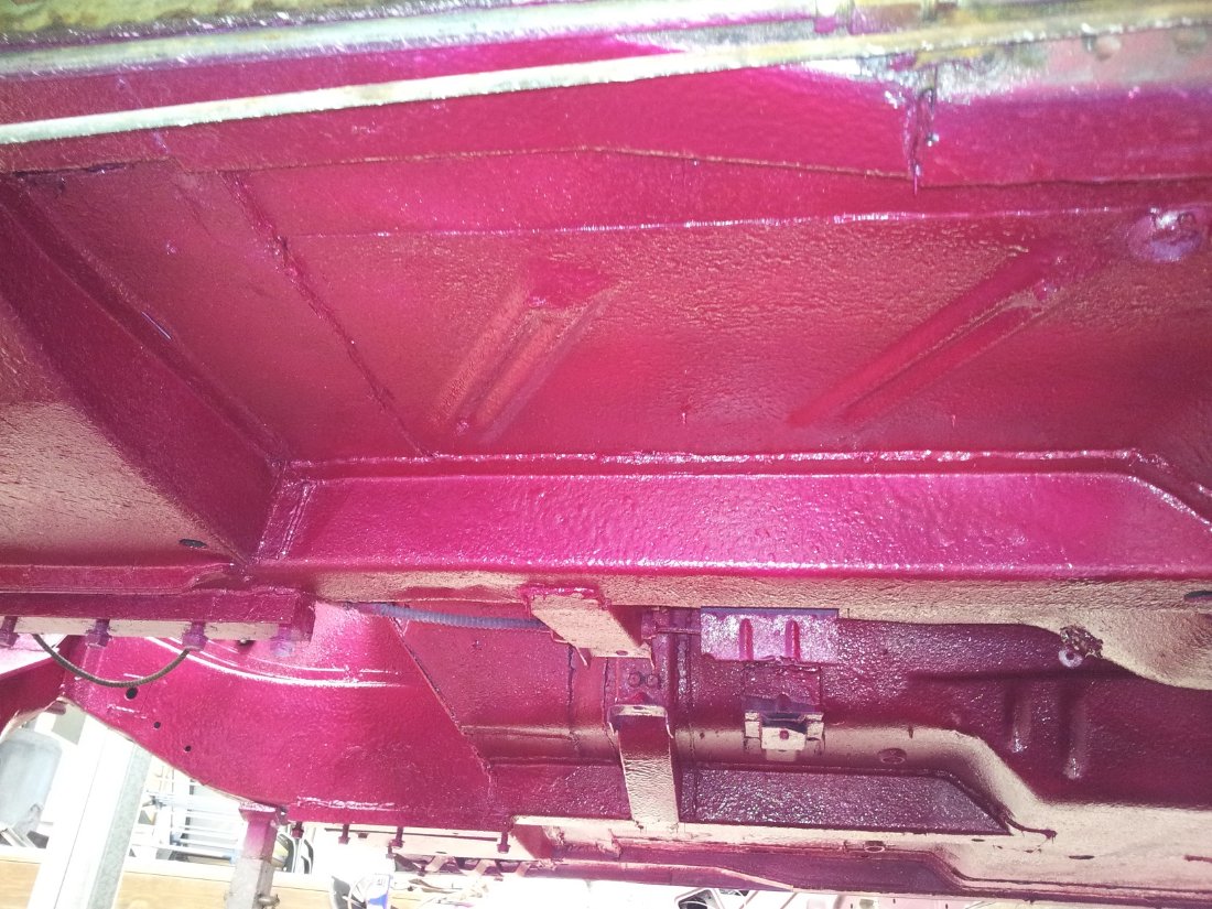

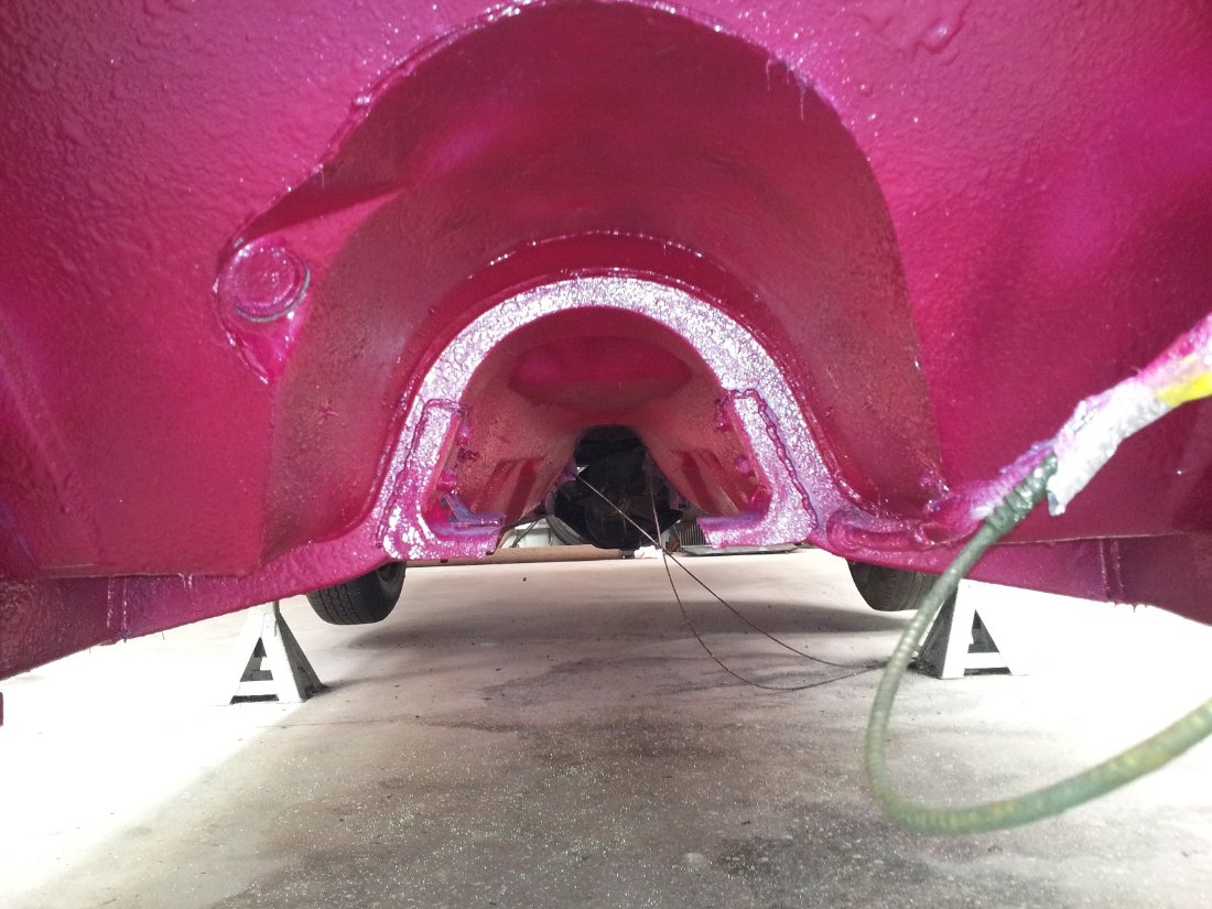

Undercarriage after Hours of scrapping, cleaning, Phosphoric, acid, primer, seam seal, paint

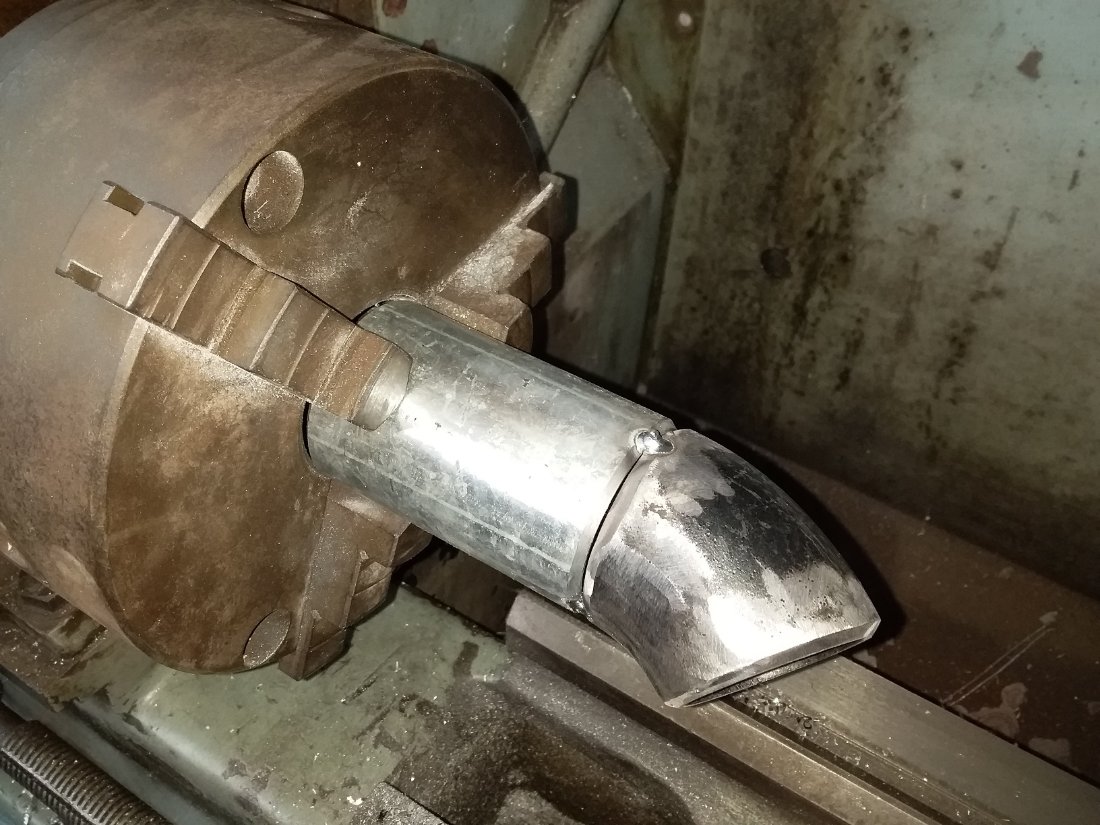

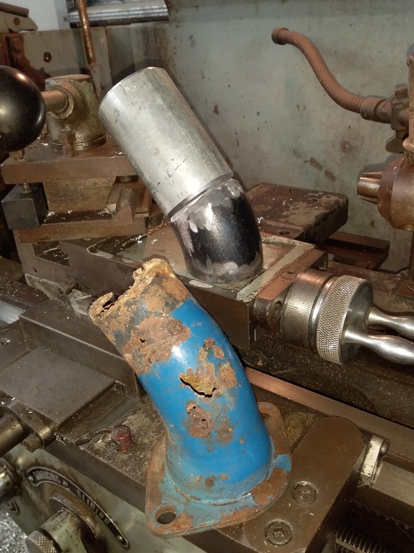

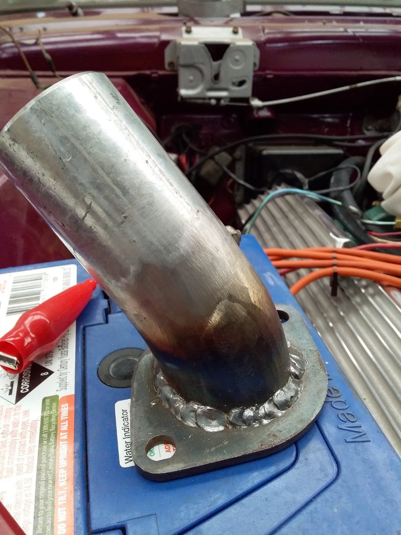

Fabricating new water neck

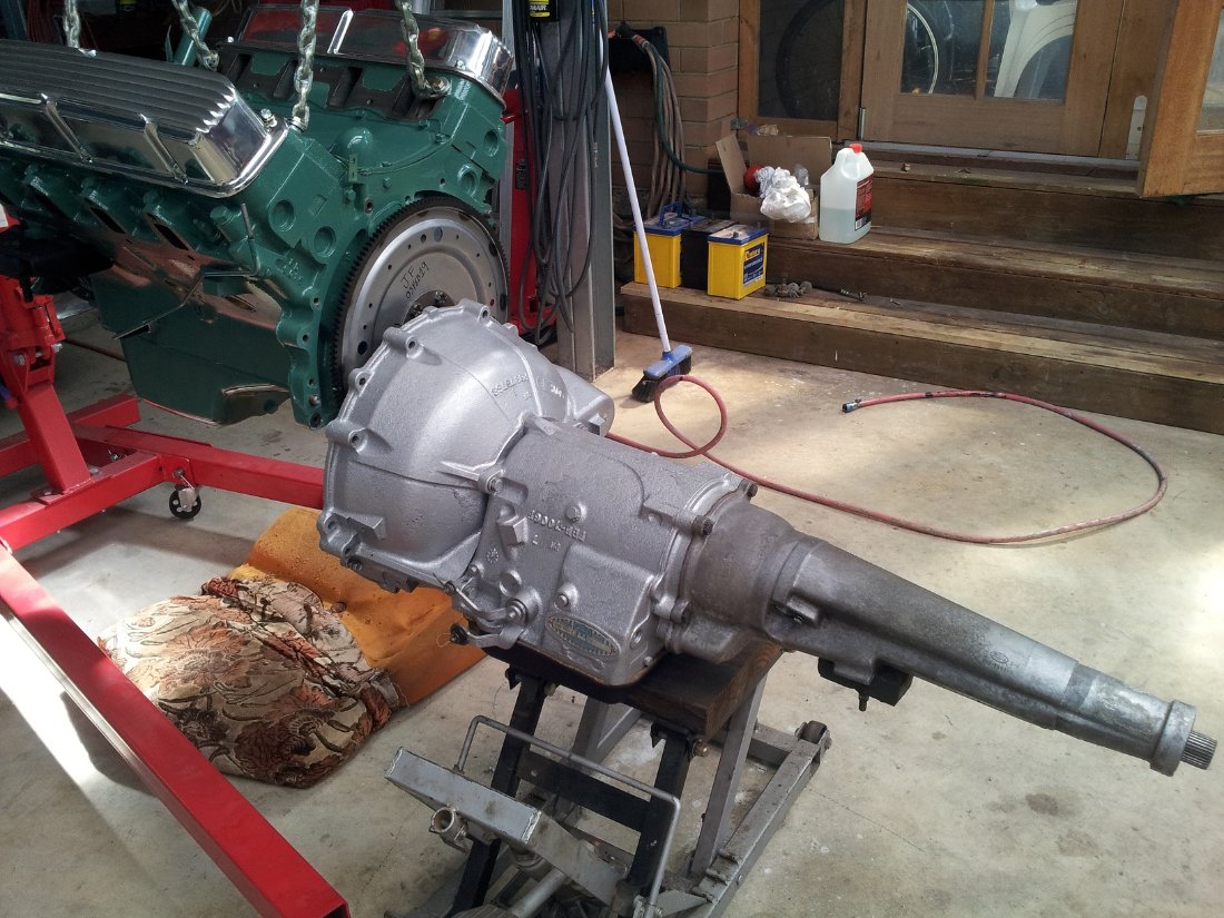

Bolting Transmission to engine prior lift
Engine at bay with manifolds installed
