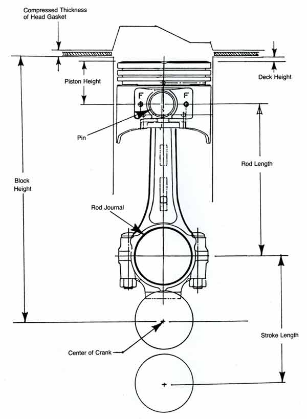

Chris Craft crazy wrote:There are three possible reasons for the compression loss:
The size of the step.
The height of the deck of the piston

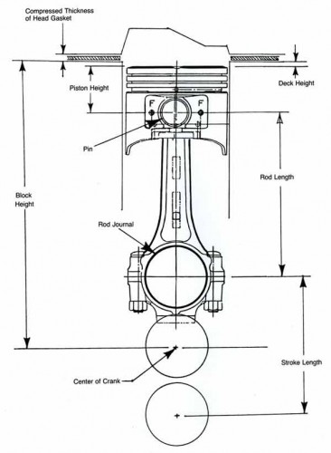

Are you refering to deck height or to piston height. Anyways, both variables must be taken into account (see illustration)
Chris Craft crazy wrote:The size of the combustion chamber in the head, albeit small.
No chamber in the head here. Since they are flatheads only the compressed thickness of the head gasket is a variable to calculate. That's nothing big that could have been messed up to produce such an erratic result like one full step of compression loss.
In Rick's case it's more likely that either the step (dome, pop up) and the piston height or both have been designed wrong.
Since they usually use computer templates to design the pistons my personal sneaking suspicion is that they just clicked the wrong button. Probably the most used popular button by habit.

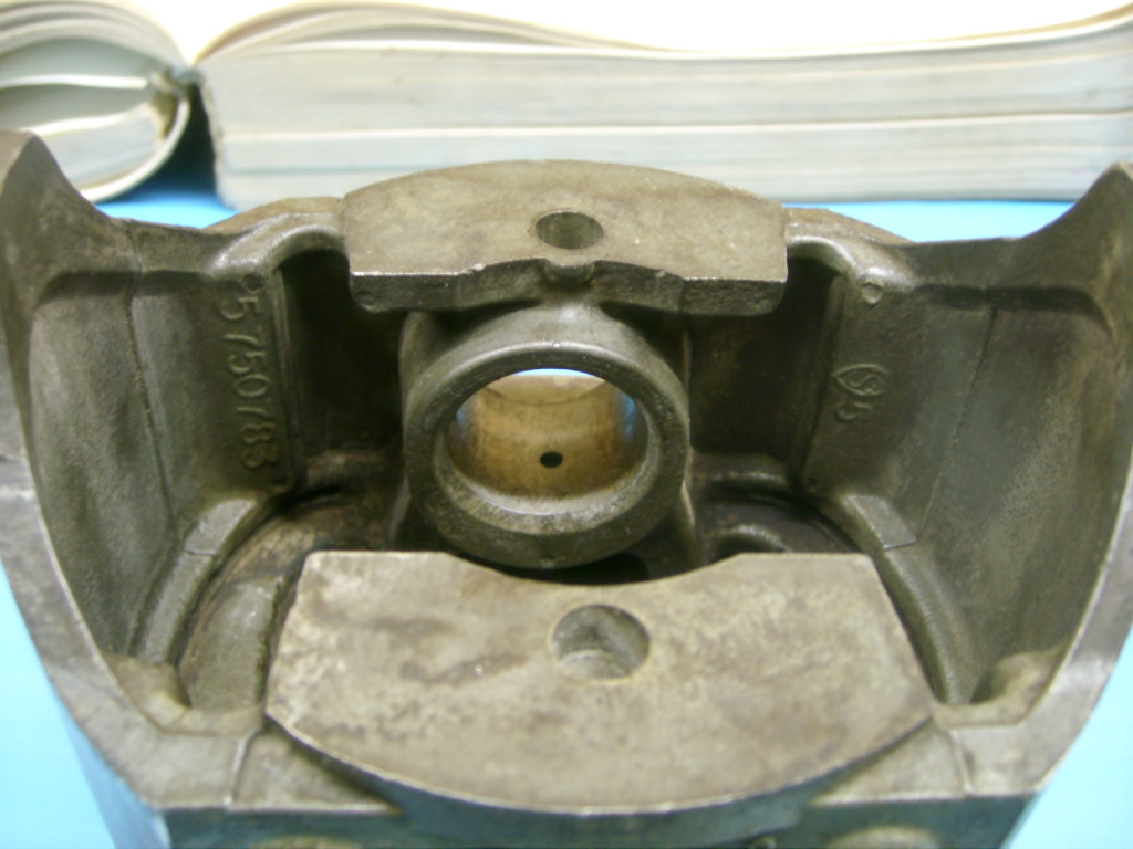

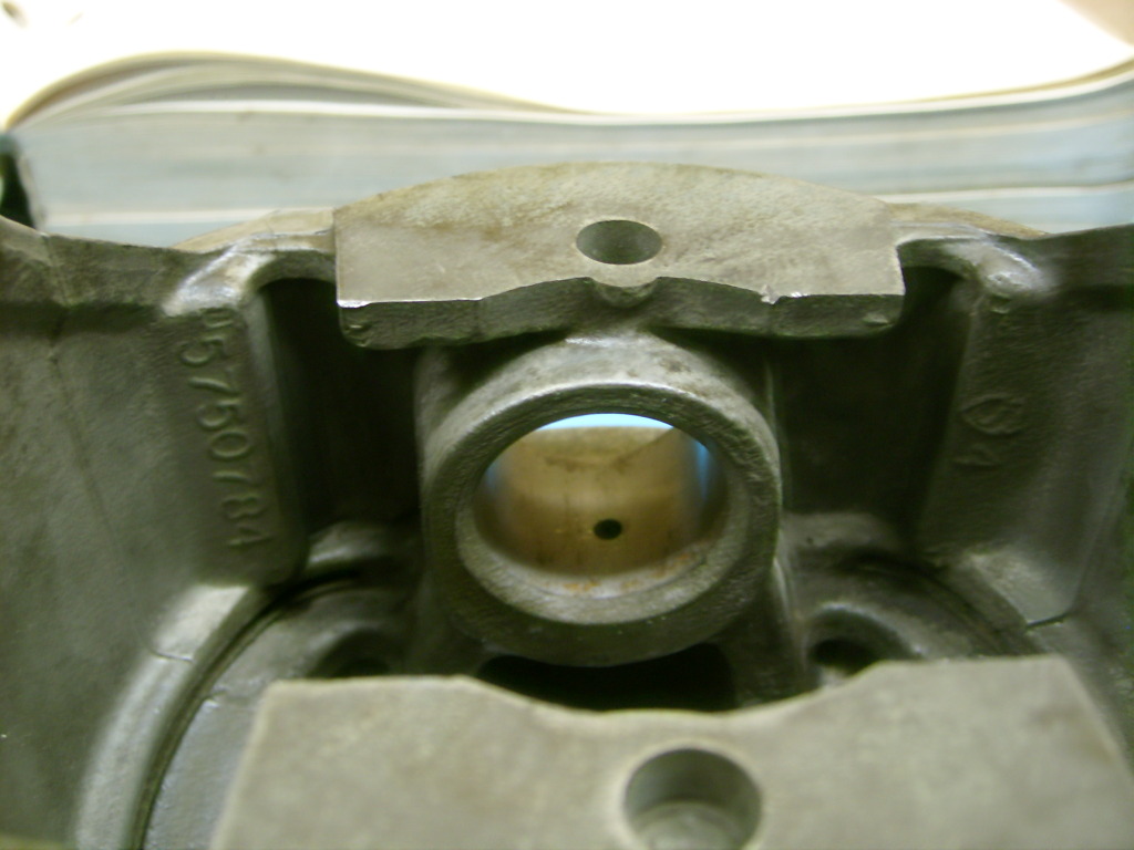

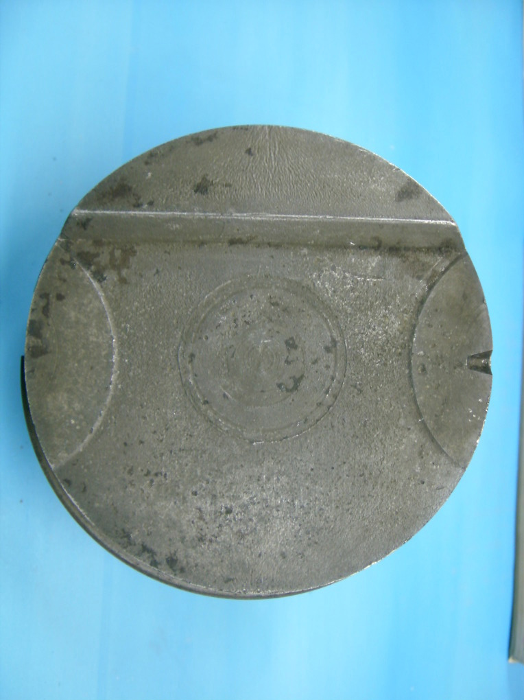

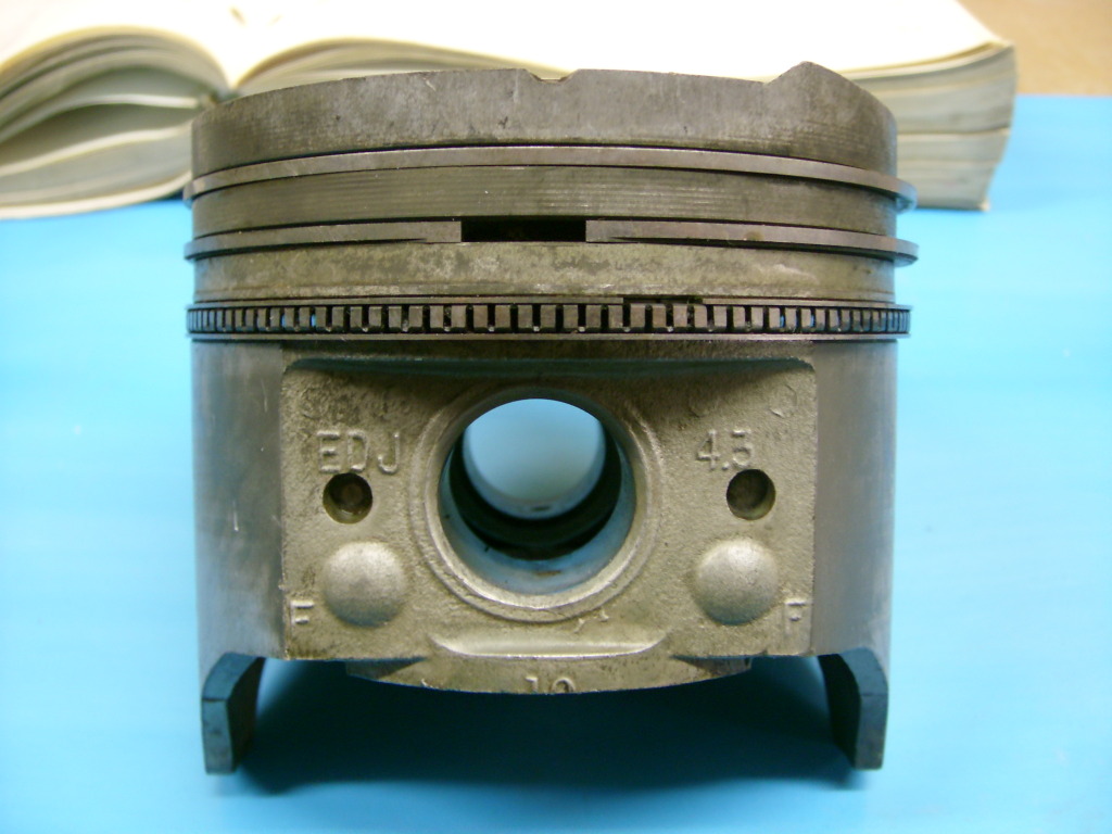

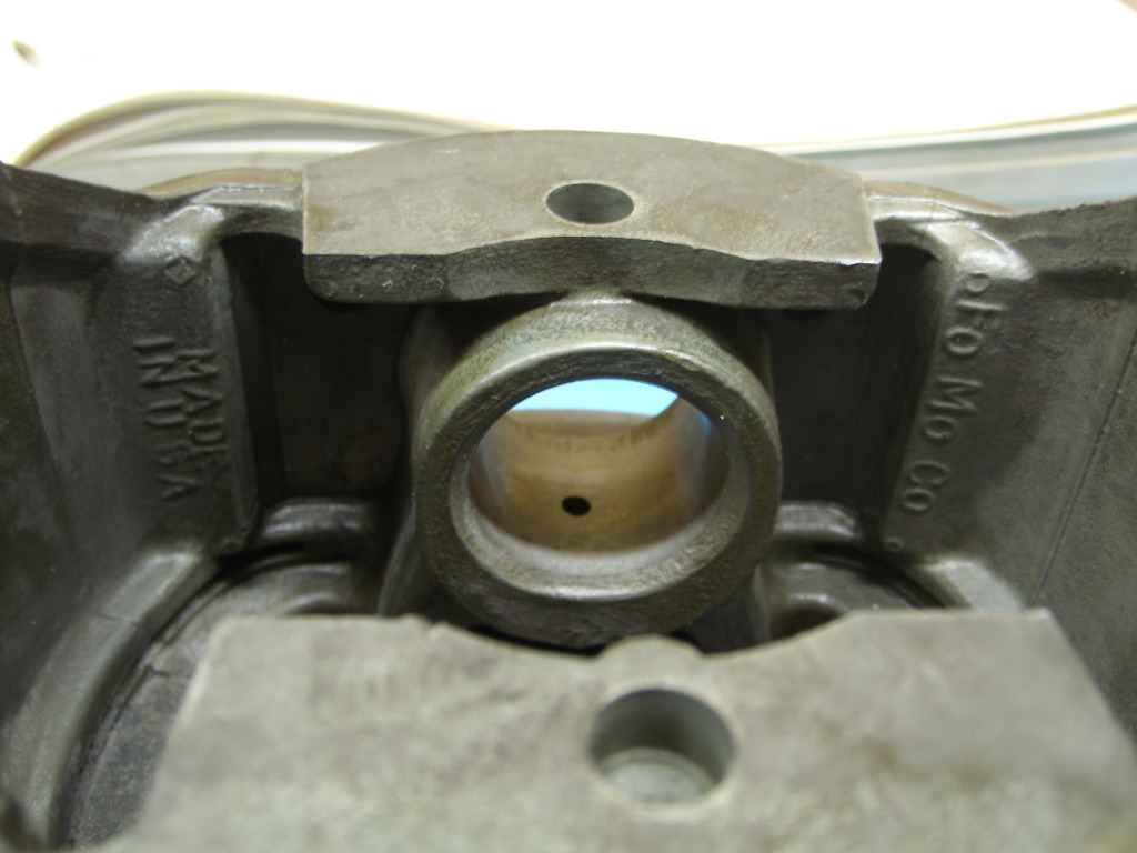

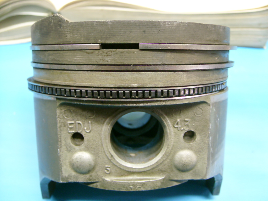

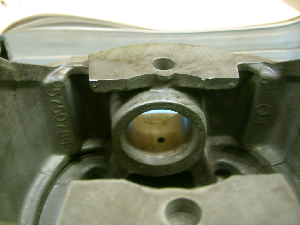

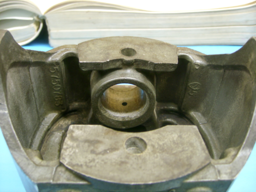

Here they are. Note that one piston has been cut in two for better close up shots.

Awesome Rick, good info.

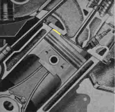

Rick, do you know to which point the machine shop is referring to with their "deck height" numbers? Are they refering to the distance of the top of the piston step to the cylinder head?
If that's the case, the listed clearance numbers would not be satisfying from a racer's standpoint. Best air fuel propagandation and performance is achieved by tight quench areas. Optimum would be zero deck clearance.
I'm talking about this area marked yellow.
If the piston manufacturer knew the exact length of the intake side block height, then he could build a zero deck height piston. If you order it with a slightly wider step area then you would have enough meat to machine off according to the desired compression ratio.
It's always easier and less expensive to machine or grind off ,material from a piston than ending up w. a lesser than optimum compression. Oh, well trial and error.

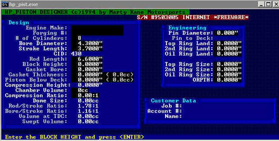

As previously mentioned I could possibly design the piston questioned. Thing is that with the MEL and it's canted deck we have a special situation. If I only had the dimensions of the dimensions listed below, then I could first calculate a few other things by hand and with some work around because of the MEL problematic I could finally feed it all into my little piston design program.
1. block height measured at the cylinder wall exhaust side.
2. block height measured at the cylinder wall intake side.
3. Gasket bore diameter
4. Gasket compressed thickness (this figure is usually listet on the outer packing)
