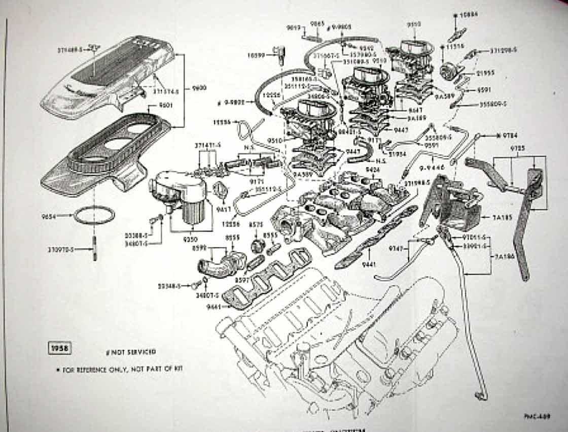

So you think that the additional aluminum spacers will add to cool the carb? I allways thought that the Gsk. Sp. Gsk. stack was good enough in my car. But hey there ain't no too much cooling as allways in this case.

Ok .....Lets "Prep the intake manifold.
I used a spray on paint remover for the first step.
Then a quick bath to nutralize everything.
Next a little Media Blast to get a uniform texture.

Prepping the three Holleys for "gold anodizing"
"Gold anodizing" applied......
Hi=Heat primer and "Aluminim Cast" paint applied ...
MAKE-UP!!!!! a little Red paint to make the letters and numbers POP! (Thank you AnnaMarie)
Klick this photo for an expanded view (edited by Admin)
This is my guide ...
This is the rebuild kit ......http://www.carburetor.ca/ Note the Needle and seat are unique to this old style carb...
Here is the Marauder unit "Mocked-Up" ......Sorting out some form and fit and function problems .....
