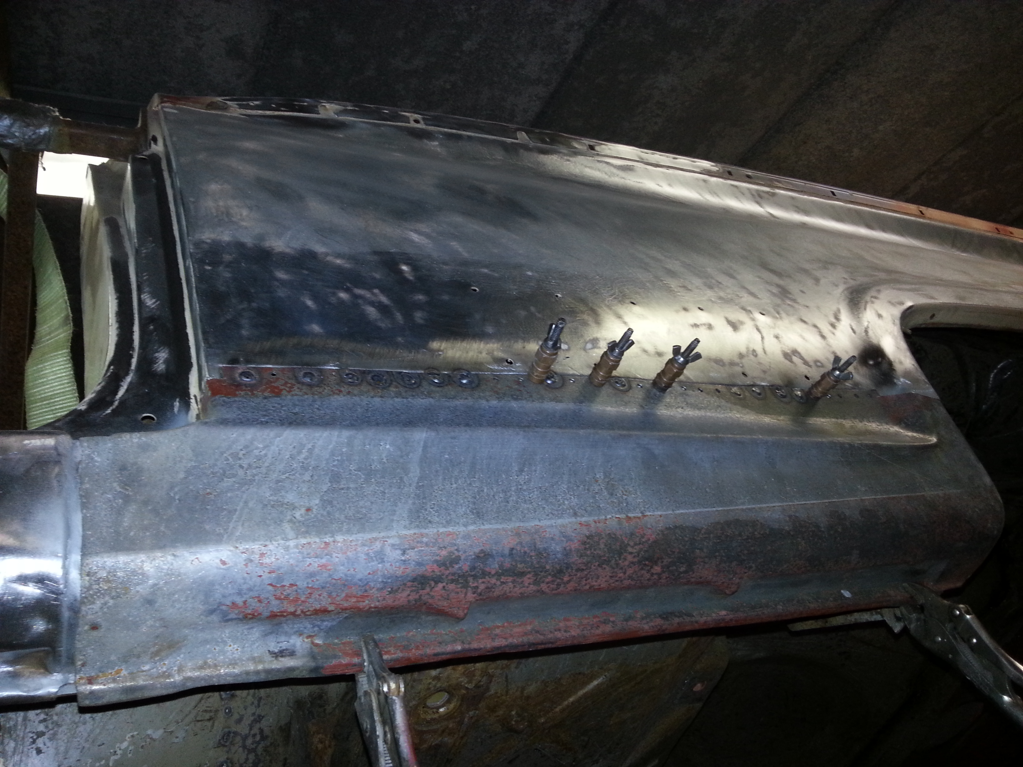

Going down in pieces and becoming a donor car. The lower 8 inches of this car was totally rusted out, but everything above that was in incredible nice condition. Probably caused by the Michigan salty roads?
My hardtop is becoming a convertible. All the convertible parts had been removed from the rusty convertible by drilling out the factory spot welds and then transplanted into the hardtop body so it would be near impossible to see that this car body was a hardtop. Some people would prefer to take the good parts from the hat parts car and transplant them over to the convertible, but in this case I think that would have made a not so good result in the end.
Body conversion almost done
