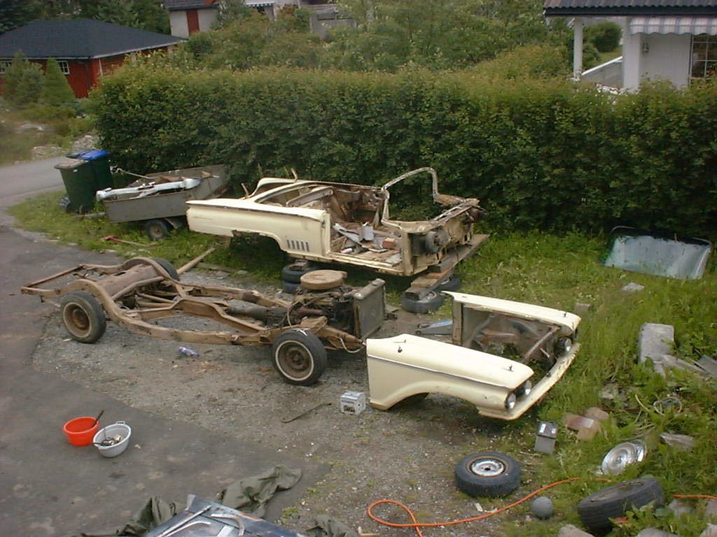

Going down in pieces and becoming a donor car. The lower 8 inches of this car was totally rusted out, but everything above that was in incredible nice condition. Probably caused by the Michigan salty roads?
My hardtop is becoming a convertible. All the convertible parts had been removed from the rusty convertible by drilling out the factory spot welds and then transplanted into the hardtop body so it would be near impossible to see that this car body was a hardtop. Some people would prefer to take the good parts from the hat parts car and transplant them over to the convertible, but in this case I think that would have made a not so good result in the end.

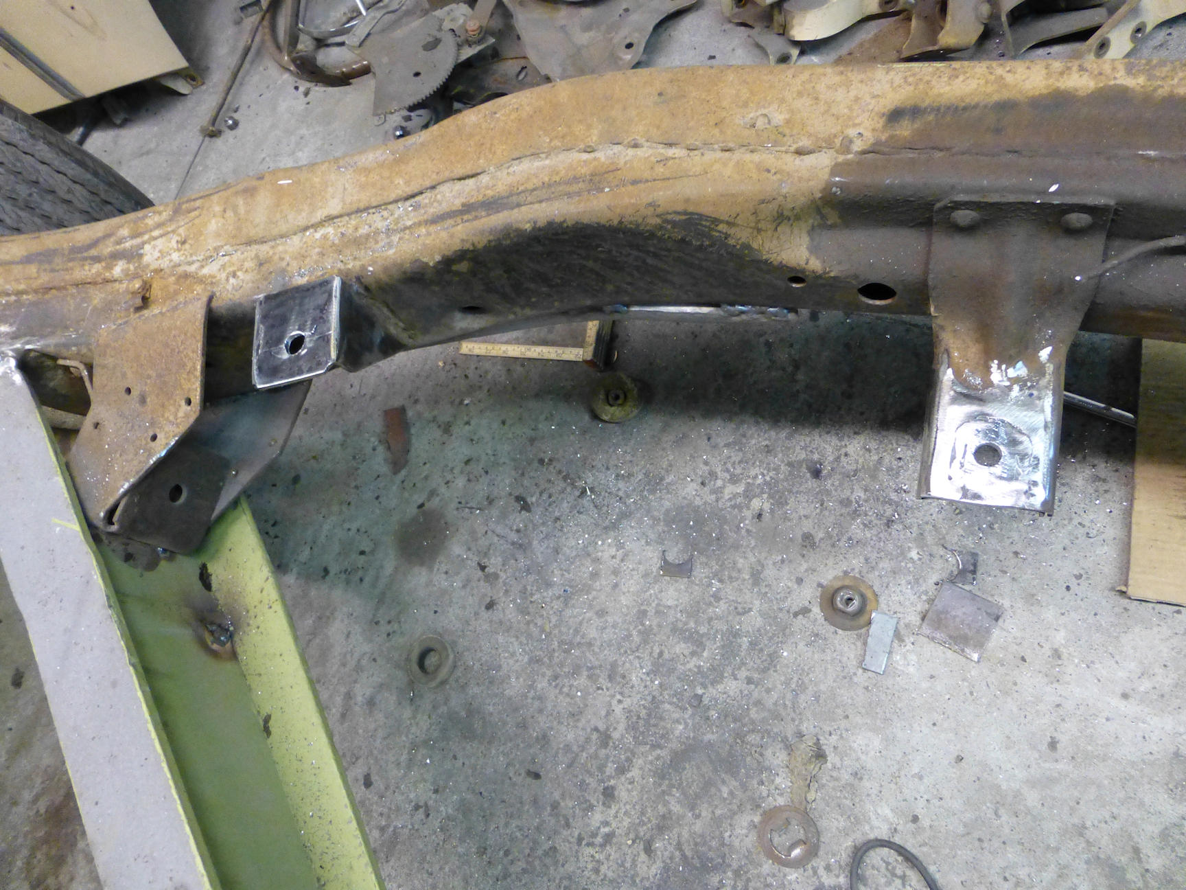

Since the frame I am using originally was for a hardtop it needed to be made into a convertible frame. These frames are basically the same, but the convertible frame have lots of reinforcements and also all the brackets for the body mounts are different and located in different places.
The big X is an obvious extra on the convertible frame. Then there is a tube going across the frame in front of the rear end that needs to be welded in as well. Also the body mount brackets are different due to different body mounts. The ht frame had larger holes that needed to be modified to the smaller holes used on the convertible. In this picture you can see the difference from left to right side.
Solid braces under the frame added. All parts came from the original convertible frame.
Close up of the body mount bracket on the frame. Now the frame is officially declared to be a convertible frame

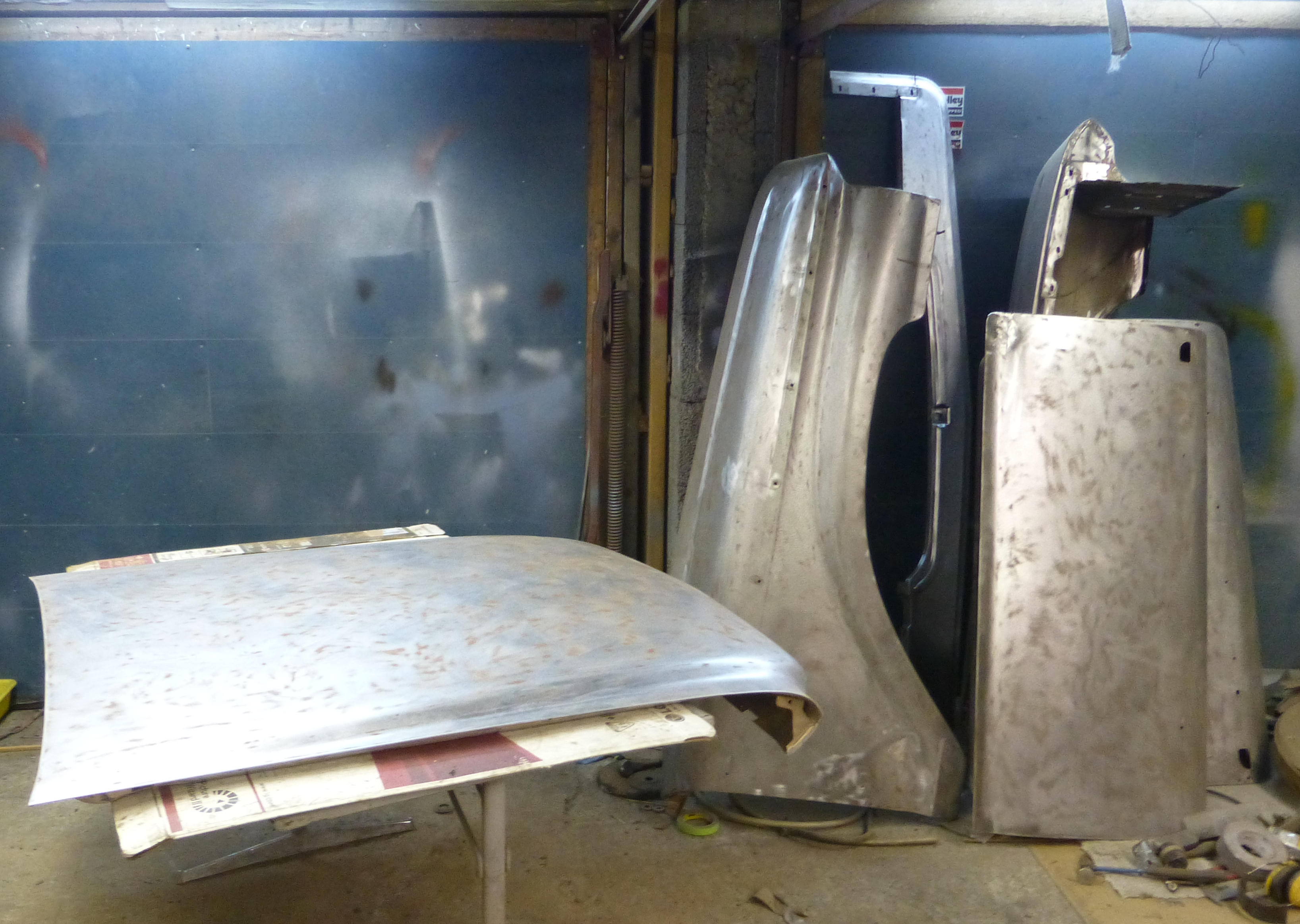

There are different ways to clean a body from old paint and surface rust. I prefer to avoid sand blasting the outside sheet metal if I can avoid it. Unfortunately I had some bad experience and also seen cars totally ruined that way. So instead I prefer to sand old paint off using an eccentric or by using the 3M clean and strip discs on a drill. It takes more time, but it is safe and especially under the hood and trunk lid there is no other option anyway if you want to keep the original asphalt inlay.
Now it is ready to get the underside, cowl and the hard to get to areas sand blasted.Mercury - Built to lead - Built to last

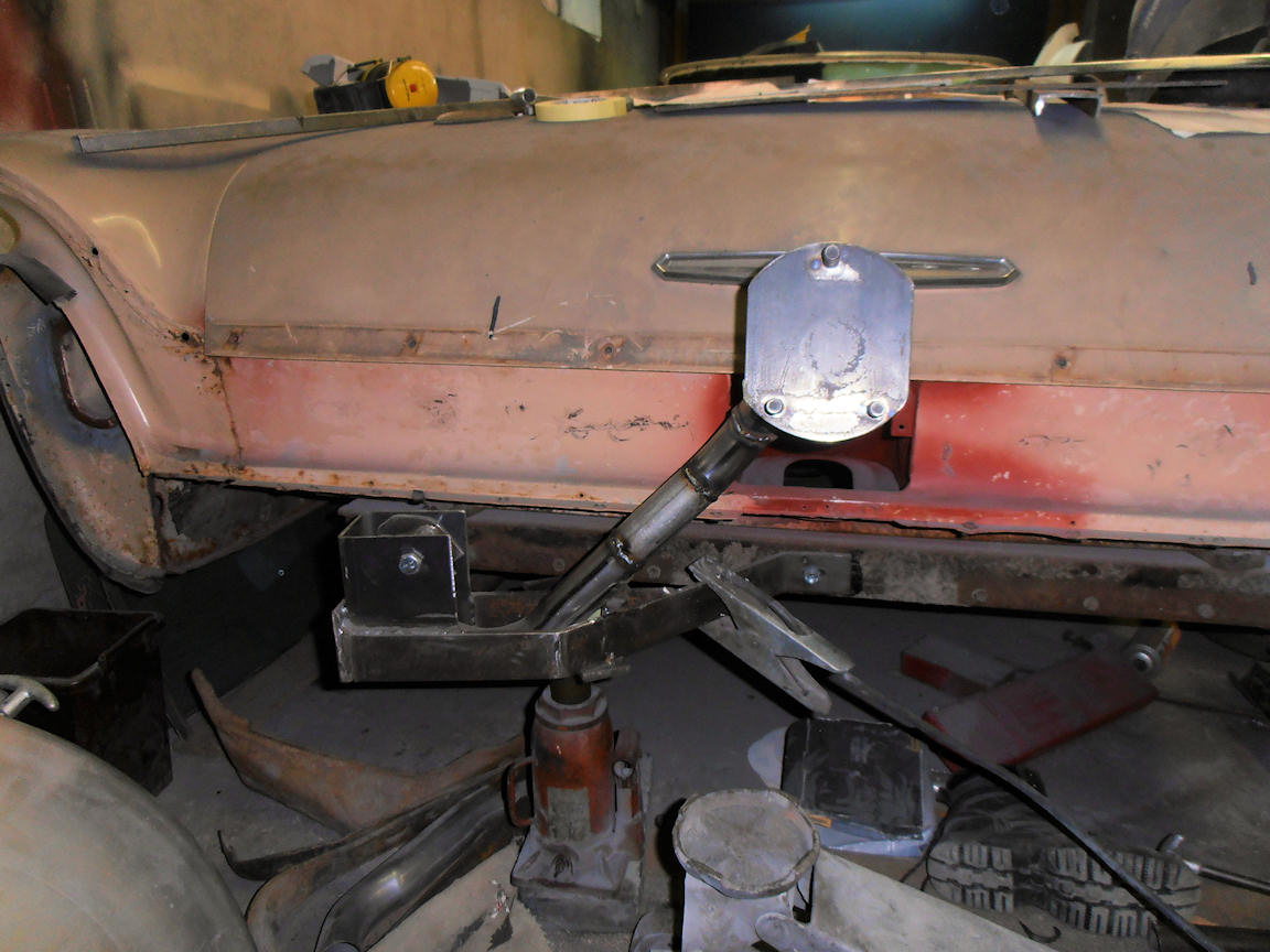

I started with the swing arm mechanism that holds the tire. I studied the function on a few other cars before I started just to find out how it was working. To make it work exactly as it should is kind of hard, as there are lots of elements to take in to consideration as the wheel has not not only swing to the side, it also has to move outward and in a more upright position to clear the trunk lid when it is opened.
Then I had to make the upper surrounding bumper section to fit the wheel.
Cutting the original bumper is kind of a point of no return on this project. But it has to be done. It also took me some time to find the correct angle on the bumper and tire so they would line up nicely to the car.
Starts to look like a continental kit now?
Plates filling the gap between the wheel and the bumper had to be made.
Here is the kit finished and installed on my friends 60 Monterey.
Function is just as it should be. The wheel swings to the side and out of the way to give access to the lid for the gas tank( kind of important on these cars ) and the trunk.
