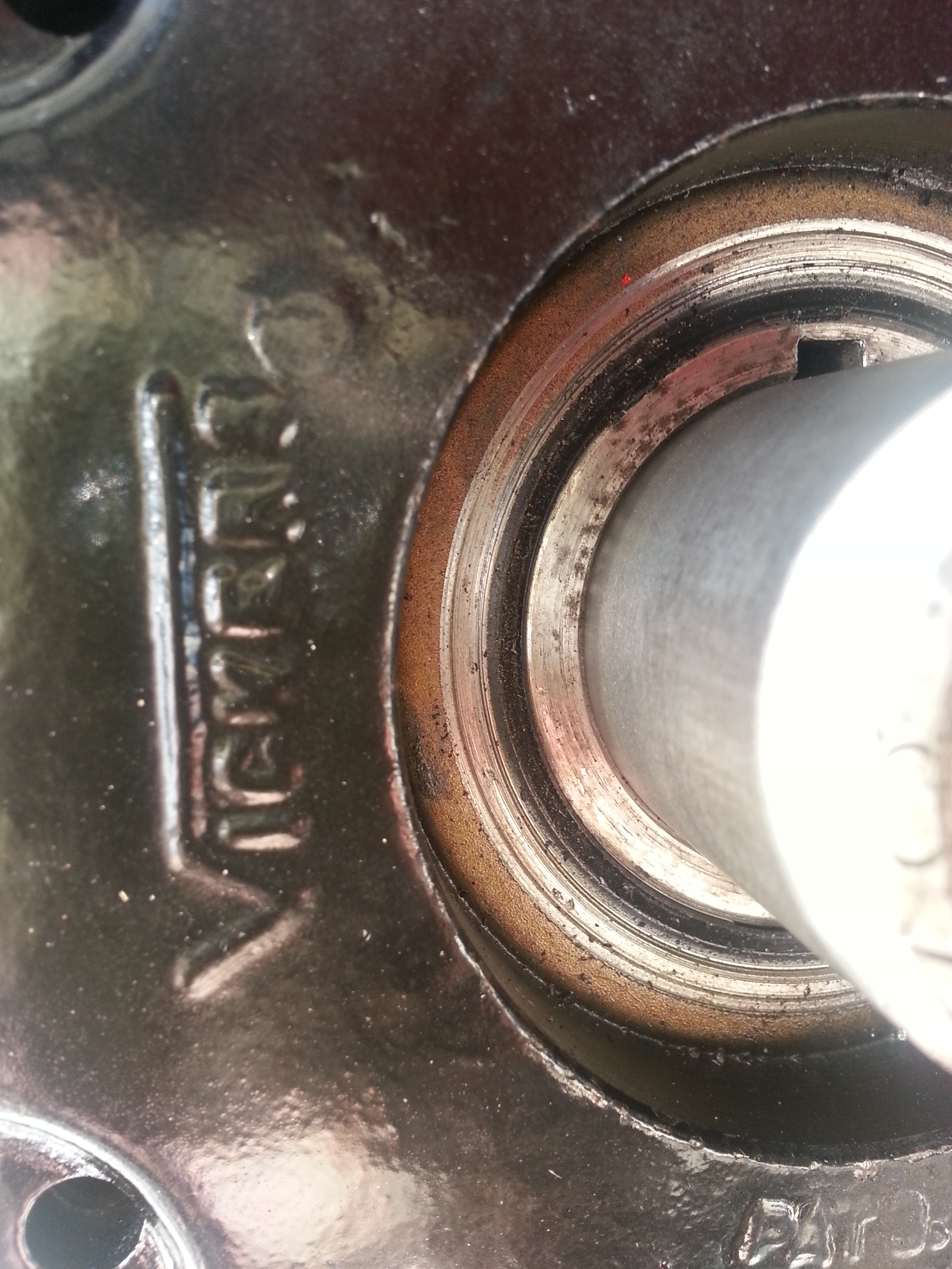

Is the 1 7/8" bolt length the total length including the thickness of the head or is that from under the head and just the length of the thread? I never had the PS rebuilt but I did replace the front and rear seals as well as the main rubber gasket. At first I didn't have the front seal all the way in which was causing the balancer to slightly rub against that metal seal but I got a new seal and was doubly sure to press it all the way in that way that floating shaft would not leave any gaps on either end. You can see from the picture below what happens if you don't press the seal all the way in to the front of the PS pump. Keep in mind this is from just two hand rotations of the crankshaft...

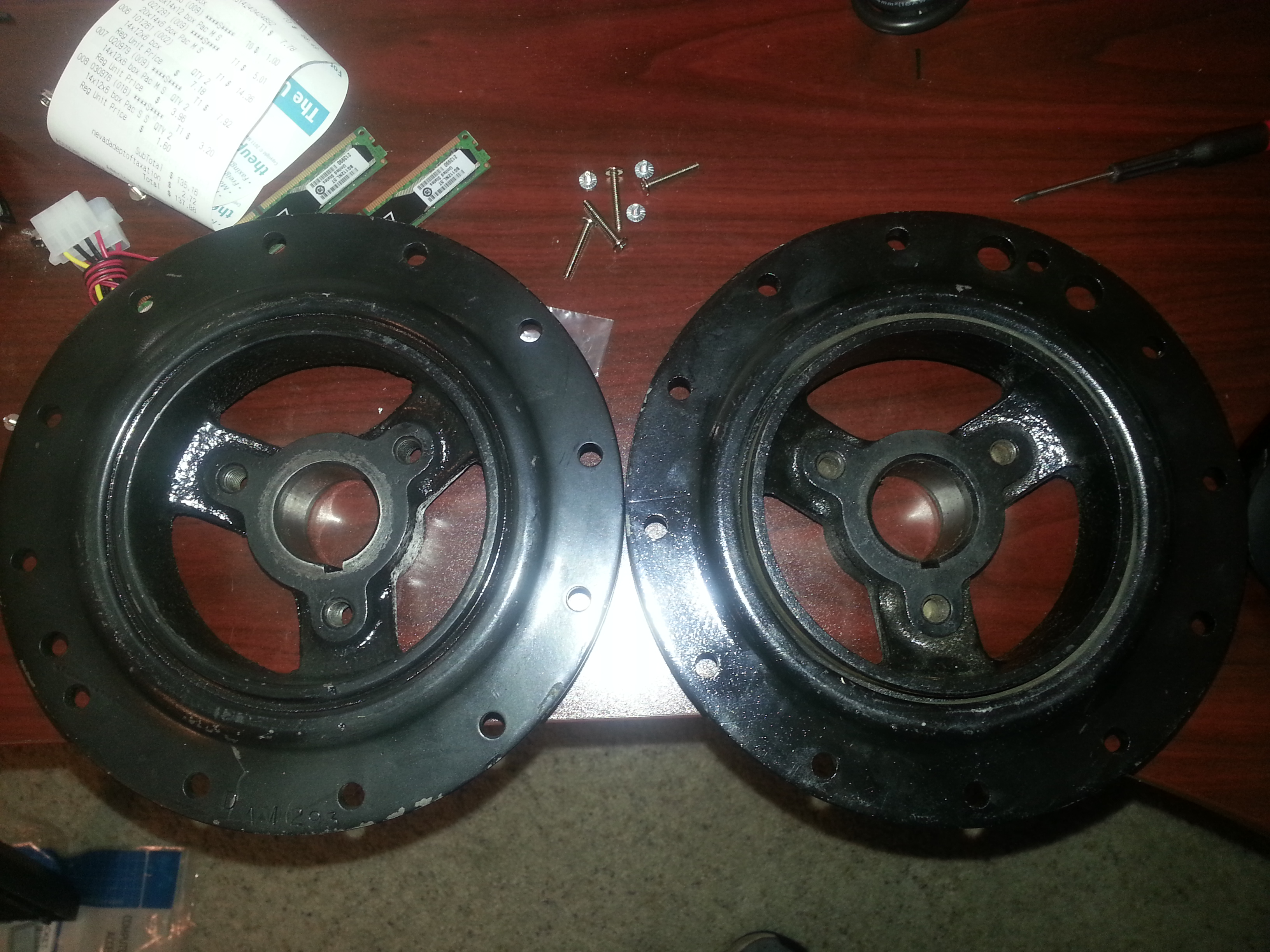

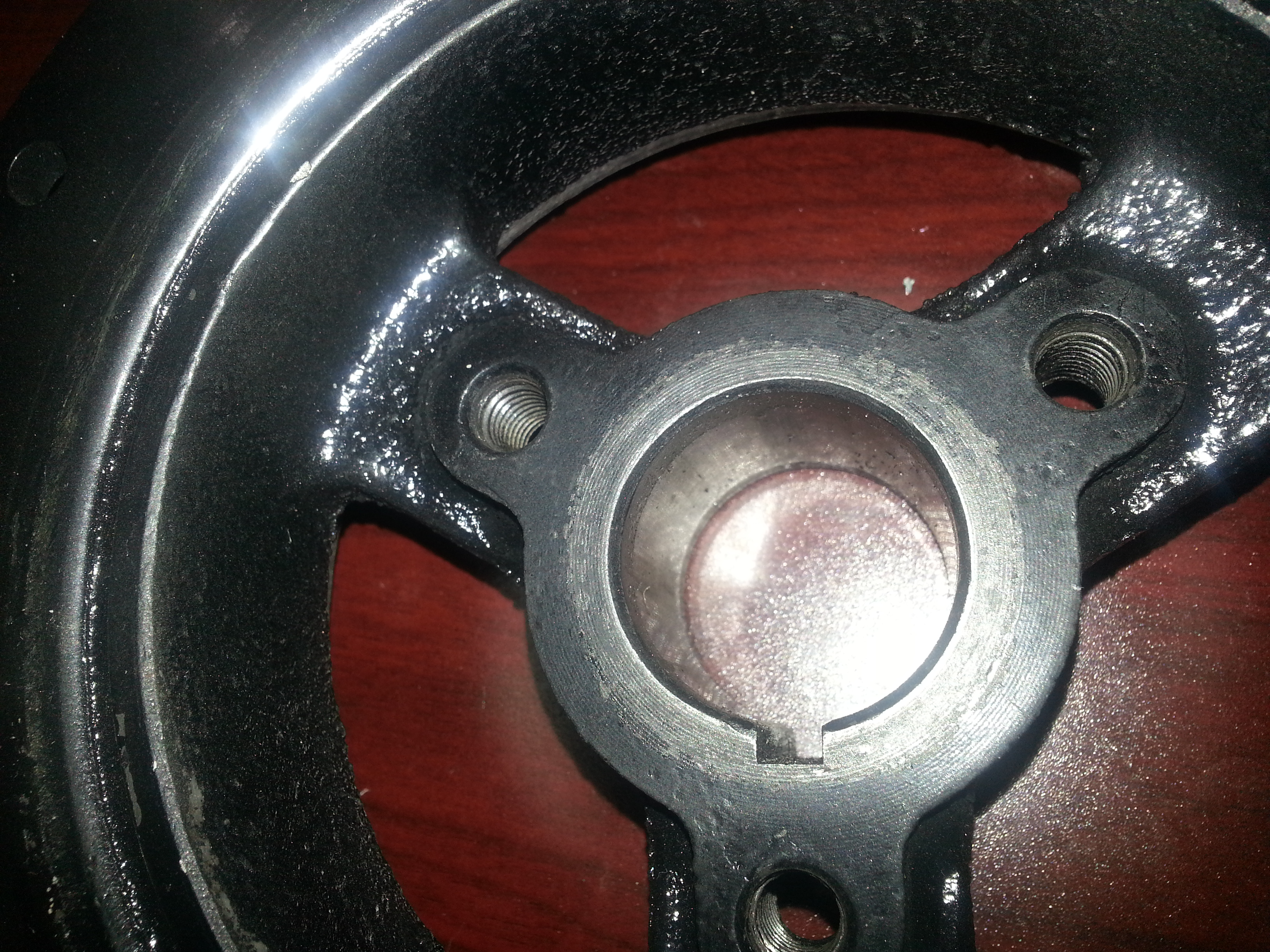

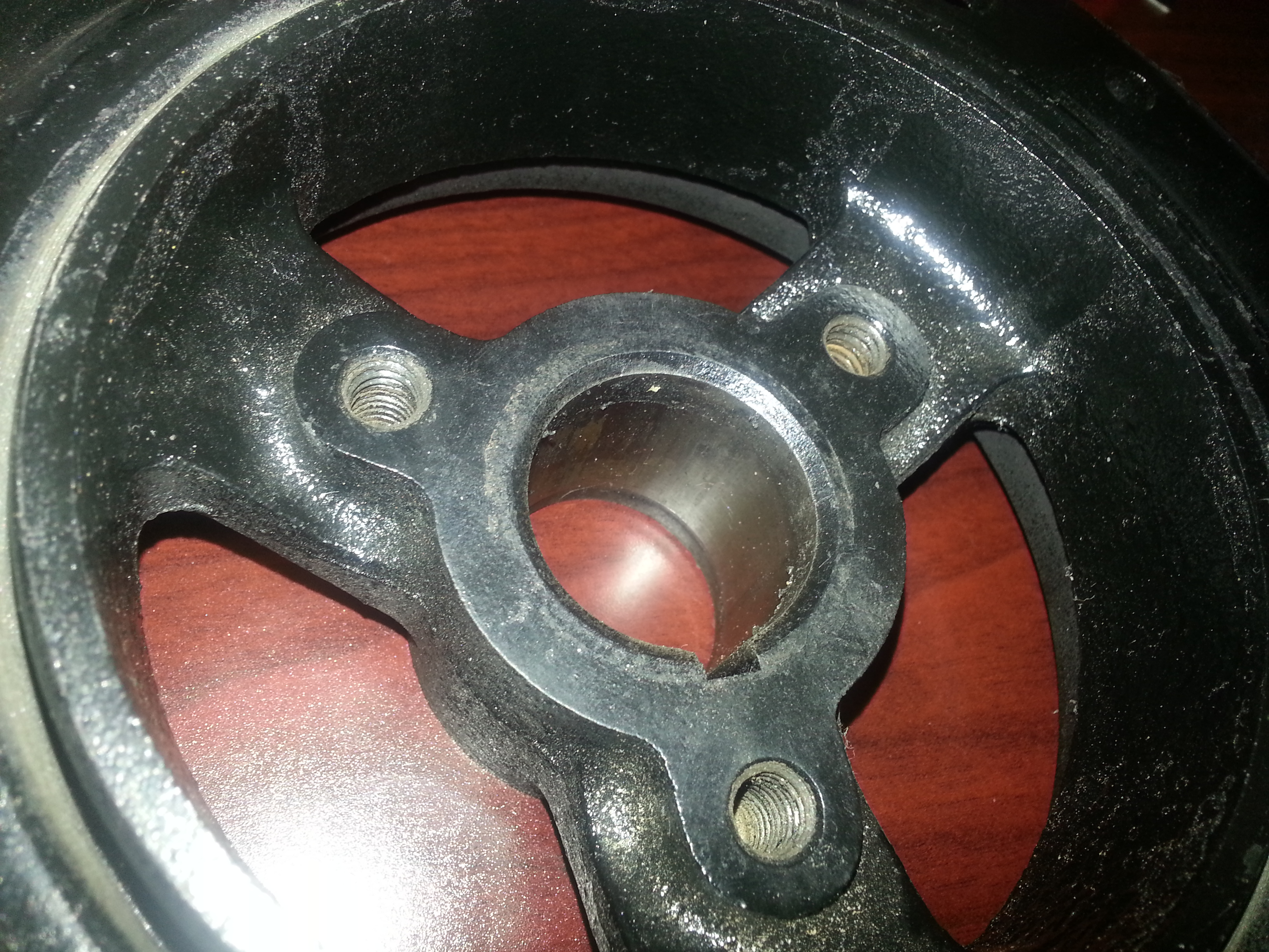

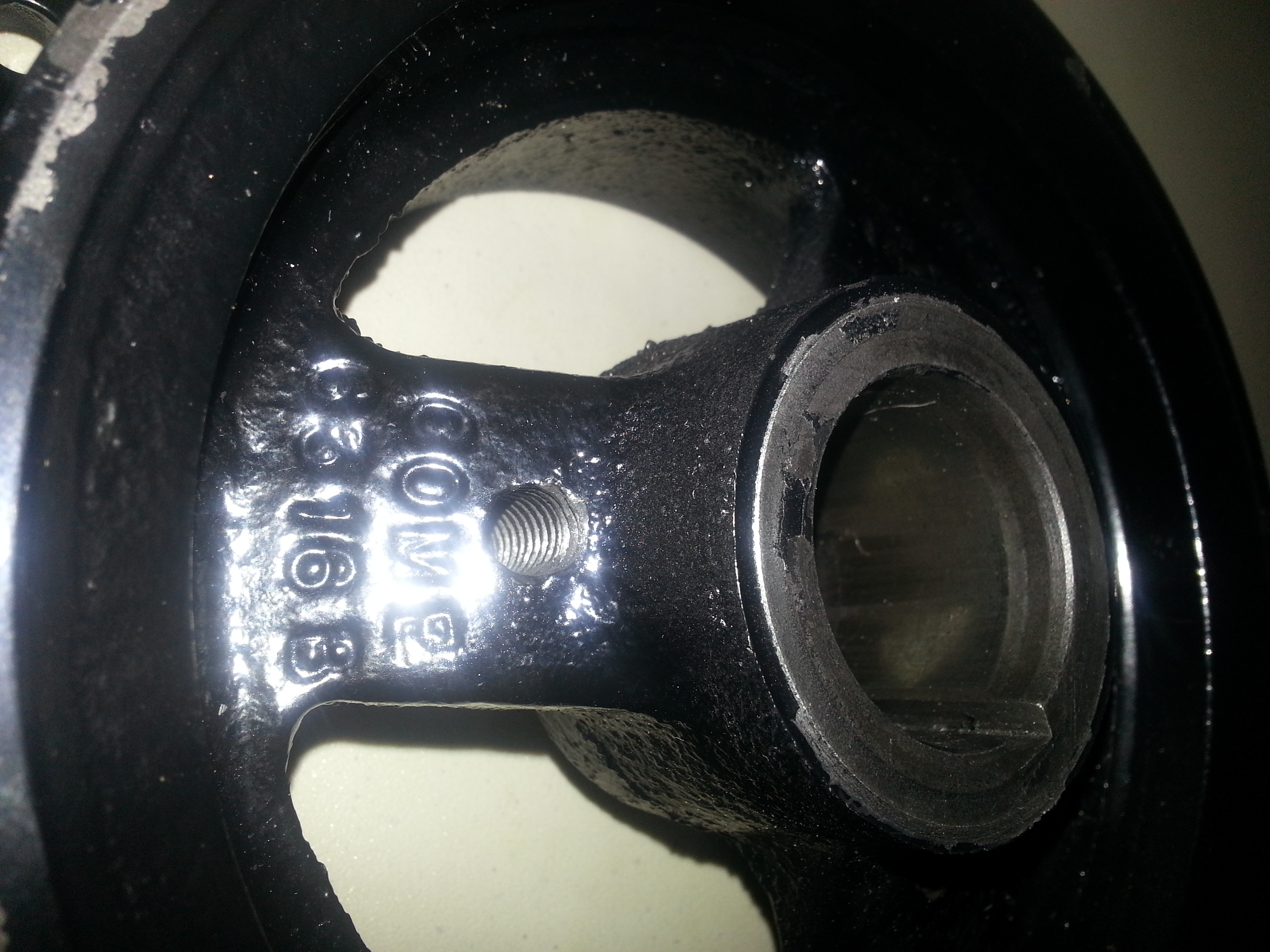

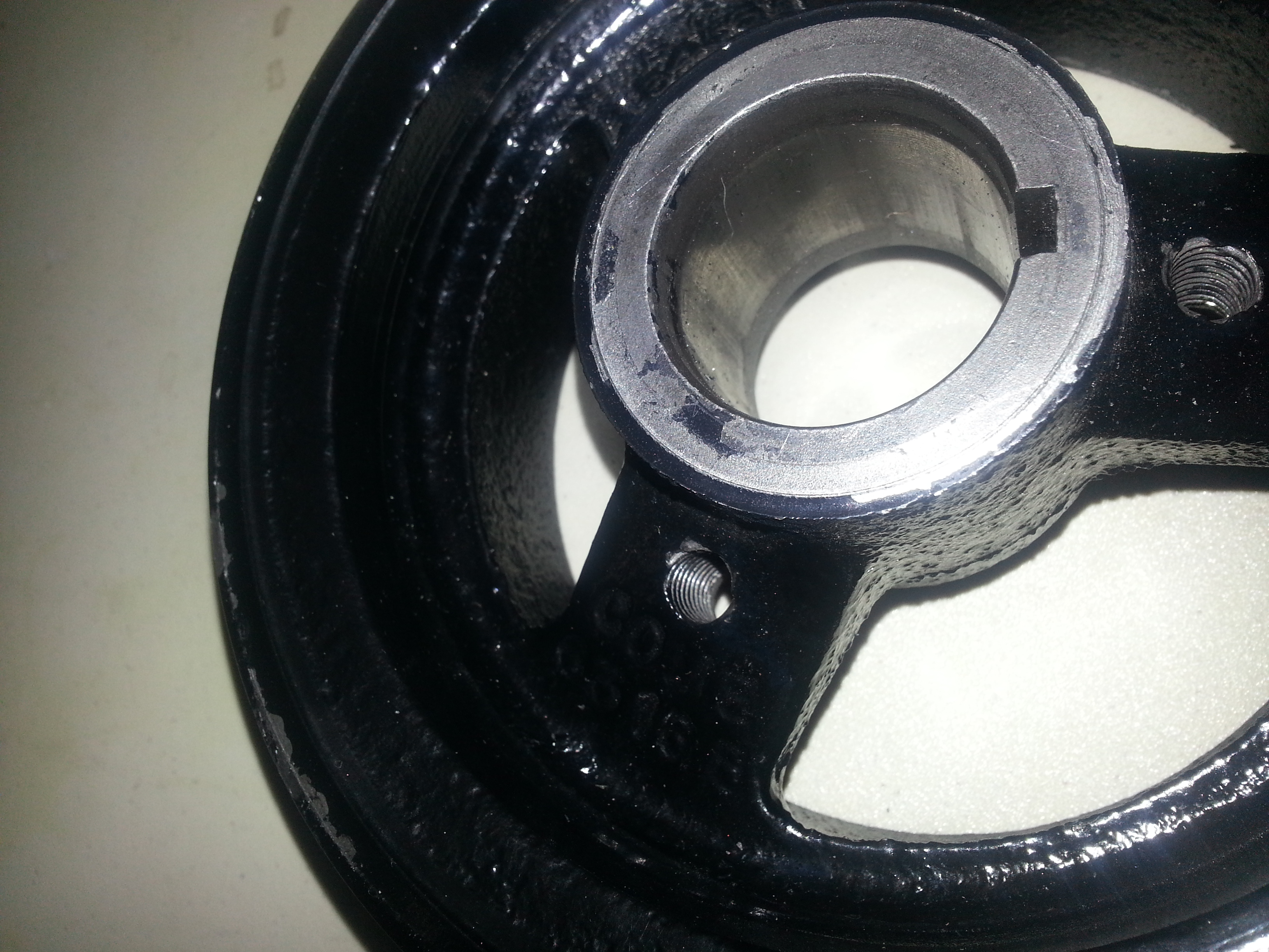

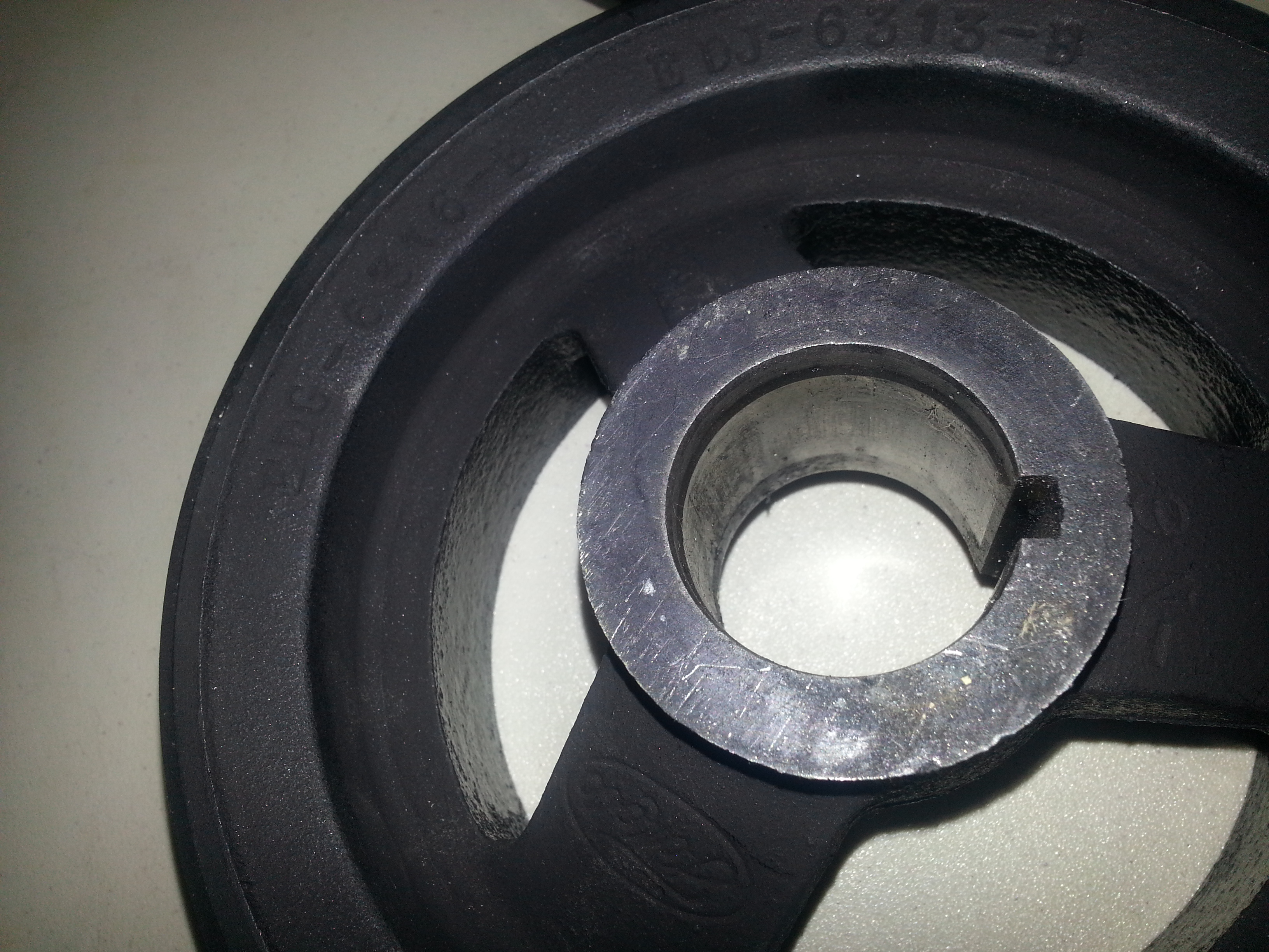

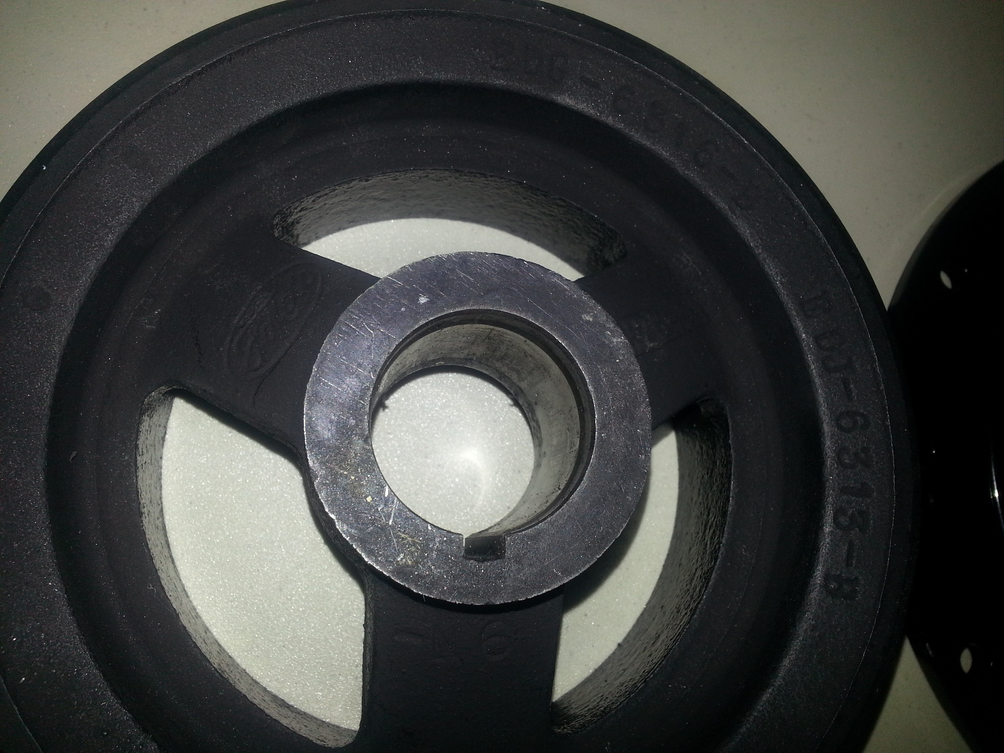

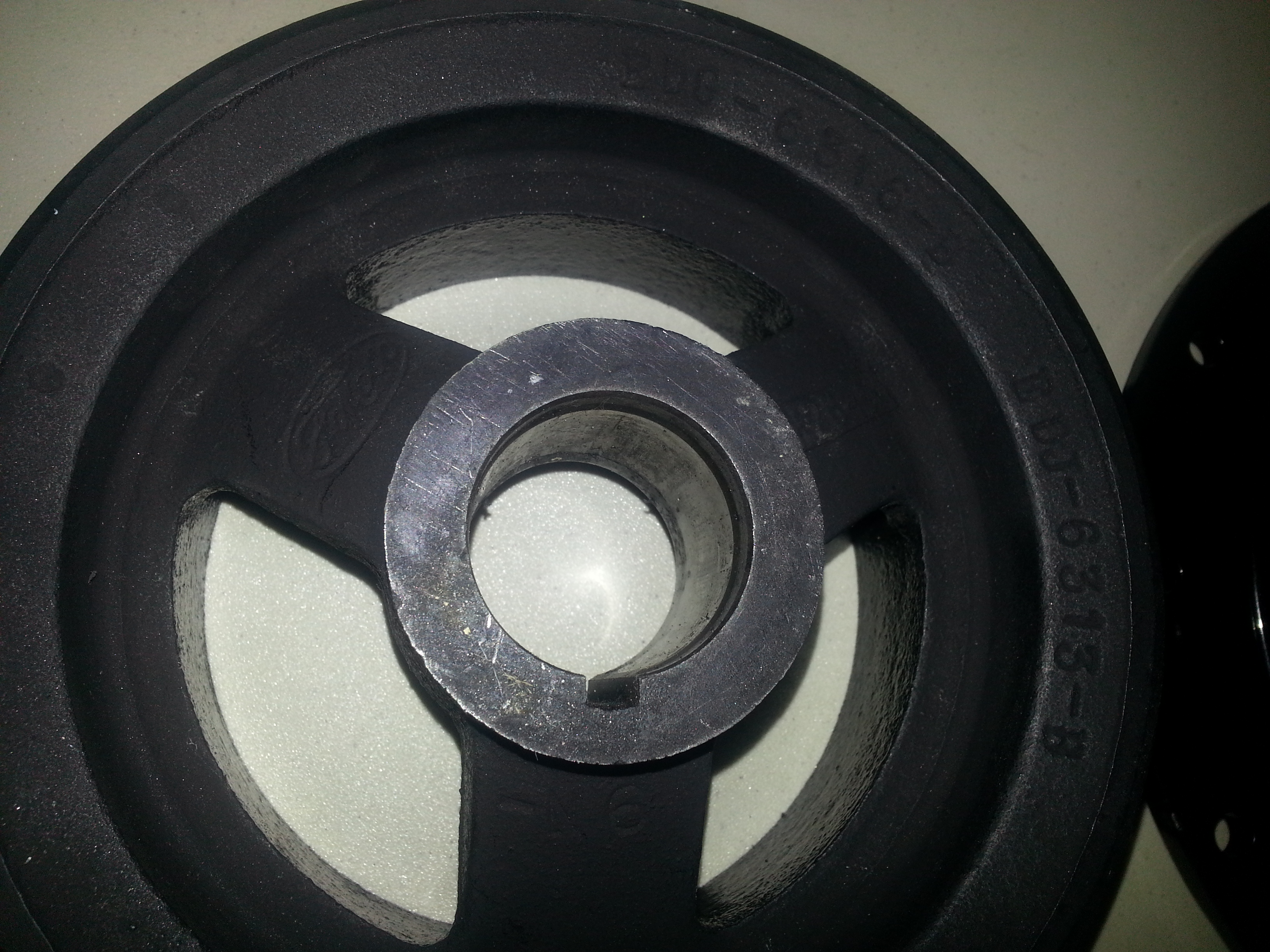

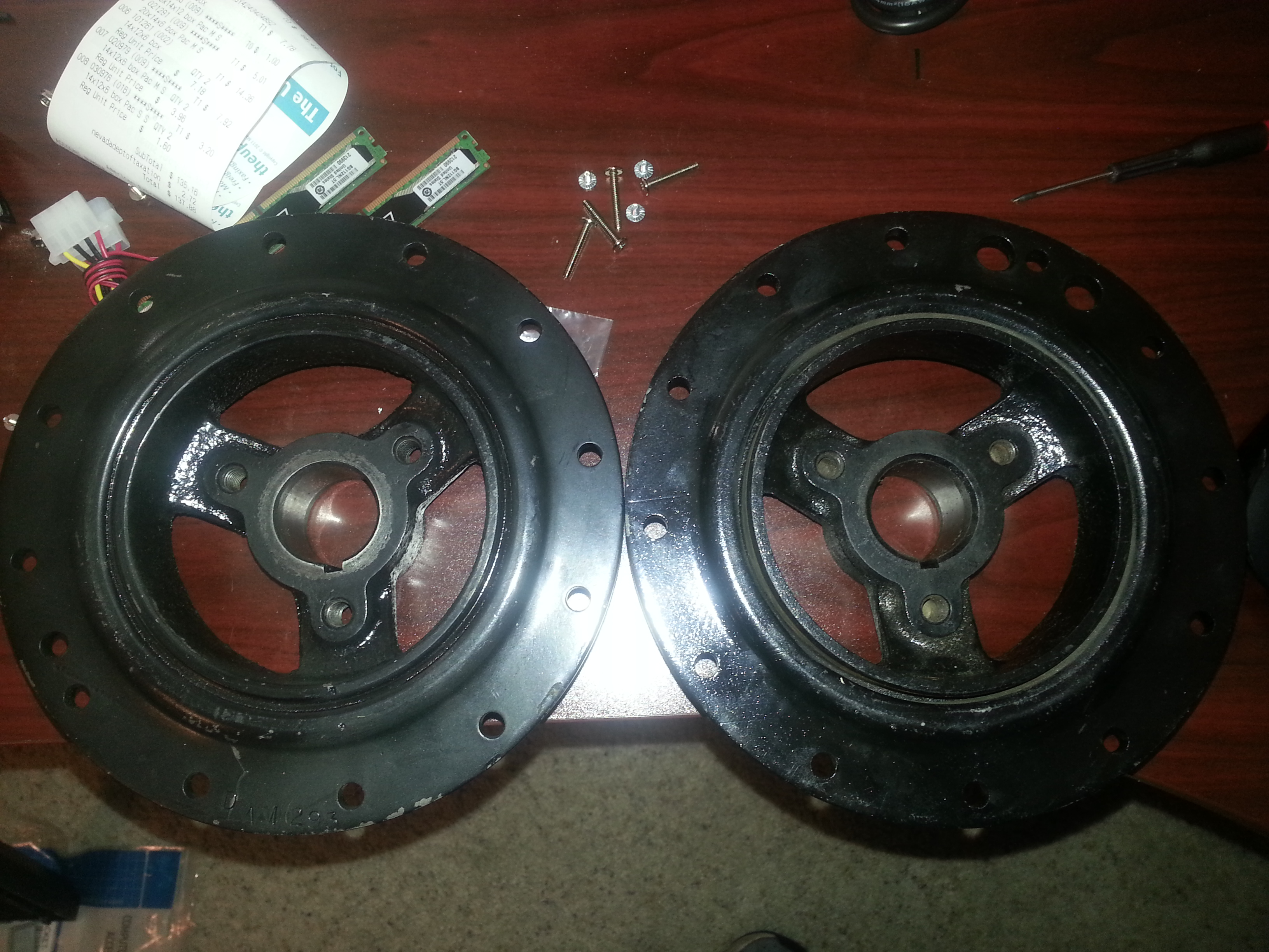

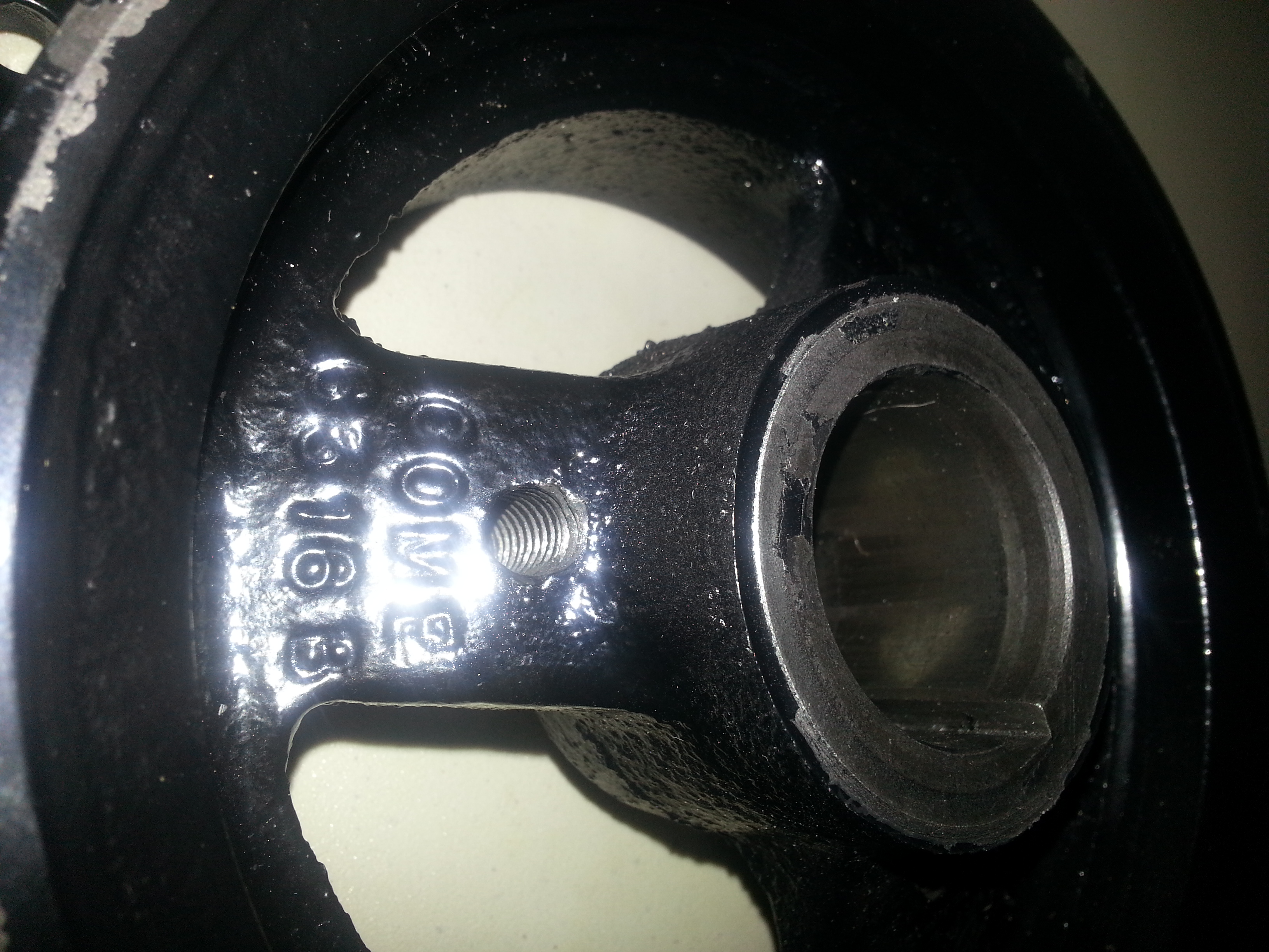

Well after much research I need someone to tell me what's wrong here. I was sent a harmonic balancer from the damper doctor and the inside shaft length is almost 3/32" shorter than my original damper which came off the car. The damper I received has an inside shaft length of 1.5660" while my original damper has an inside shaft length of 1.6550". This is what I believe is causing my issue with belt alignment. The new damper has a COME-6316B stamped on it while my original damper has an EDJ/EDG-6316B stamped on it. Attached are some pictures of my damper next to the damper I received. My damper has a slight taper in the front while the original is completely flat. The rear of my damper is flat while the one I received has a slight ridge around it.
This is the new damper on left next to my original damper on right.
This is the front of the new damper.
This is the front of my original damper off the car. As you can see it has a slight taper.
This is the rear of the new damper.
Another shot of the rear of the new damper.
This is the back of my original damper off the car.
Another shot of the rear of the stock damper

EDG-6316-B is the Engineering No. for B9SZ-6312-A which was used before 2-1-60, and C0ME-6316-B is the Engineering No. for C0SZ-6312-A used from 2-1-60.

Thank you so much for this information that helps out a whole bunch! I do know my block is a 1959 engine so that's probably why there are some discrepancies between the crank pulleys. I sent both pulleys back to Lincoln Land to get the issue remedied and this information will help me inform Al as to what and why there is a difference in the damper. Thanks so much again!
