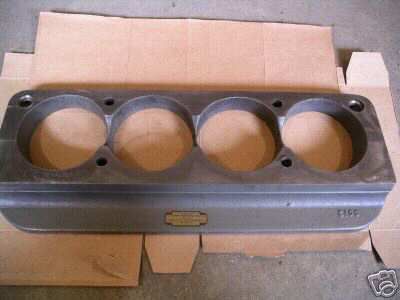

Due to the MEL engine's unique design in deck surface and bore design engine builders have allways been faced with extra work to get the boring bar set up correctly to the MEL's block bore.
A few years ago I have purchased a torque plate that was especially designed for the MEL block. They are in Kultultz garage at this time. Maybe Kultultz can shoot us a few pics and post them below with a brief explanation on how they are designed.

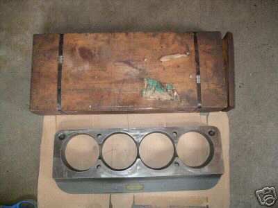

MEL Cyl Boring Fixture_1.jpg (16.97 KiB) Viewed 269611 times
MEL Cyl Boring Fixture_2.jpg (16.16 KiB) Viewed 269611 times
MEL Cyl Boring Fixture_3.jpg (2.31 KiB) Viewed 269610 times
MEL Cyl Boring Fixture_4.jpg (14.57 KiB) Viewed 269615 times
MEL Cyl Boring Fixture_5.jpg (2.27 KiB) Viewed 269614 times
Re: Torque Plate for the MEL Engine
Post by Theo » Sun 11. Jan 2009, 19:39
Thanx, these are good shots. They show how te plates compensate for the 10°angle. The perfect round holes make it easier for the boring bar to register to the center of the bore.
