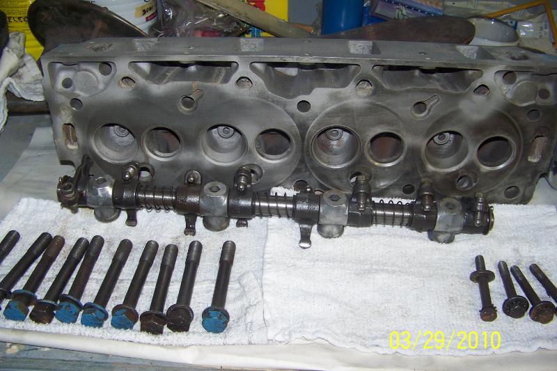

Heads have been bead blasted, disassembled, rockers cleaned and reassembled, ready for machine work. New guides, new intake seats, new stem seals, springs will be checked.

Peter, may I askj for the rocker shaft length before they get assembled?

Theo wrote:Peter, may I askj for the rocker shaft length before they get assembled?
Rocker shaft length is 18 5/8 inches overall, and diameter is .845 inches
