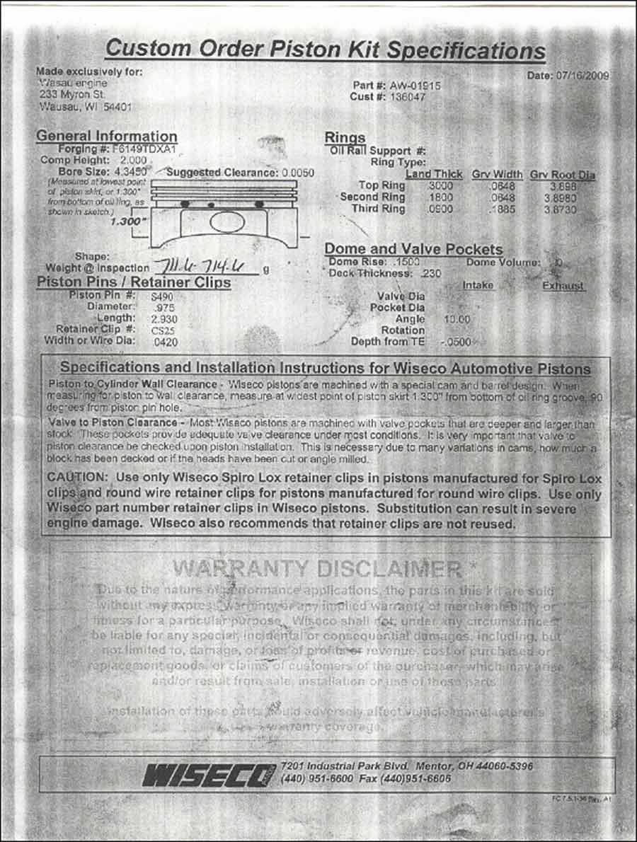

Here is the Piston order form for my 1959 Colony Park 430 cu. in. motor.
$1339.24 pistons & rings.
Please klick photo to enlarge (edited by admin)

Awesome post Rick... really helpful.

Thanks! That should prove helpful to others.
