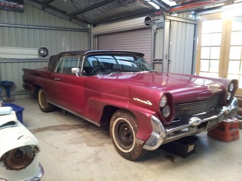

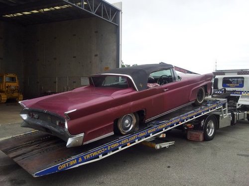

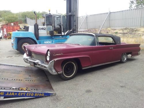

Photos from the day I collected it here after the ''quarantine'' cleaning...
Photos at my garage after I cleaned all the mess quarantine did it.
