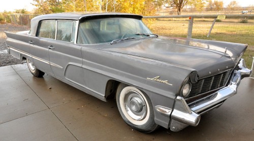

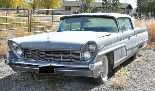

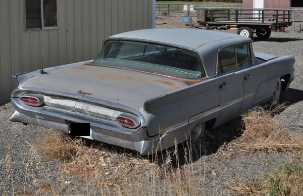

I was at a yard sale two months ago that had advertised "1959 Lincoln Town Car." I inquired about it and was led to where it had been parked for twelve years, since the previous (and second) owner's death. I fell in love with the car and could see that it was basically straight, rust-free (this is a very dry desert climate), original and mostly complete. It was a glorious land yacht begging for restoration, so I bought it from the widow and had it towed two miles to my place.
The car as found:
The car as found:

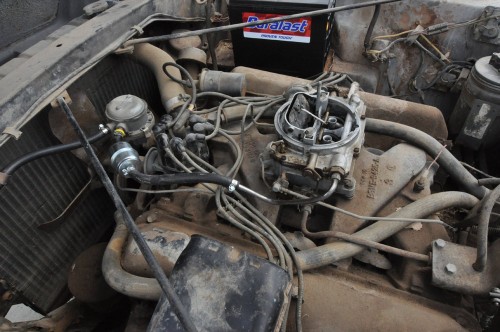

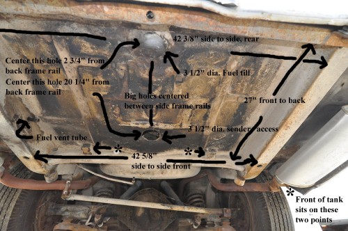

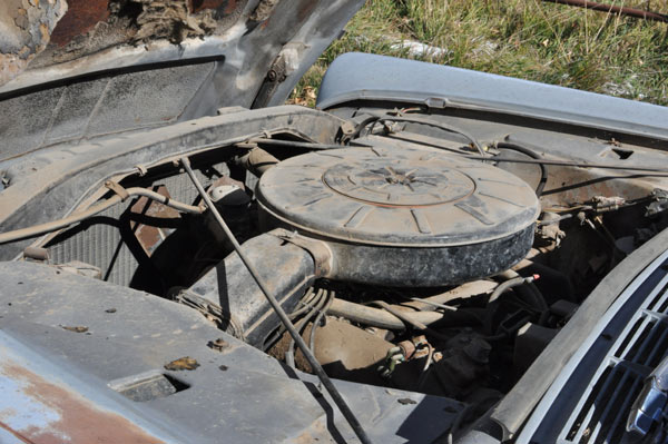

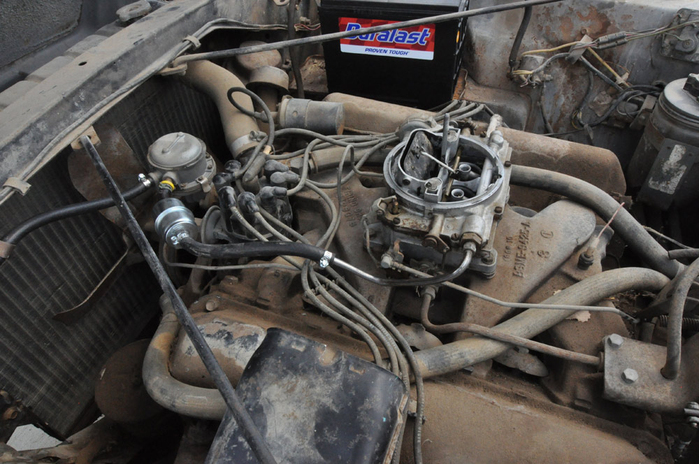

It did not take much to get the car started and running. However, the fuel tank was filled with rust and varnish-sludge. I located a well respected fabricator in S. Montana and took the old fuel tank to him for reference. He is fabricating a stainless steel replacement.

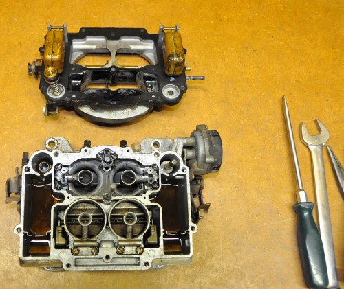

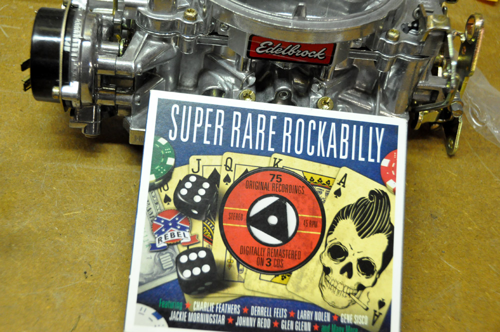

I hooked up a six gallon marine fuel tank and got the engine running. It ran poorly with obvious vacuum leaks from bad & rotted hoses and likely carburetor issues. I pulled the Carter AFB to disassemble and rebuild. Excessive wear on the primary and secondary throttle shafts led me to abandon the rebuild. I bought a new Edelbrock 1406 as a replacement.
Here's a few more photos. One snapped as a reference for the fabricator in making a new fuel tank.

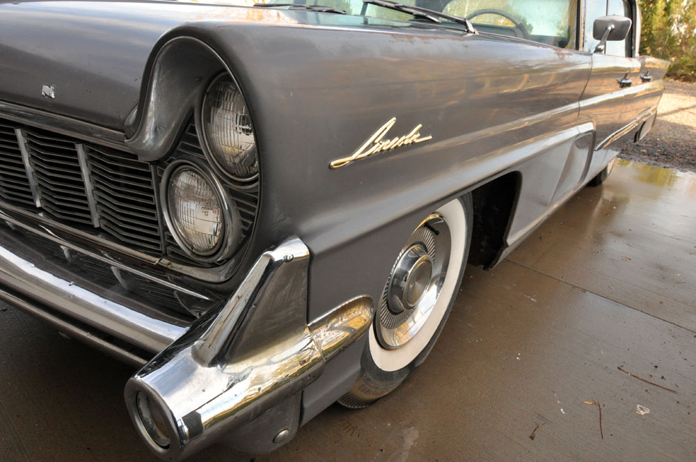

The car has the original Warwick Gray paint. Although worn through to primer in some places, it cleaned up nicely with an afternoon of polishing compound and elbow grease. It's a nice looking "survivor."

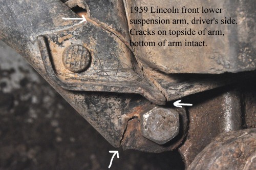

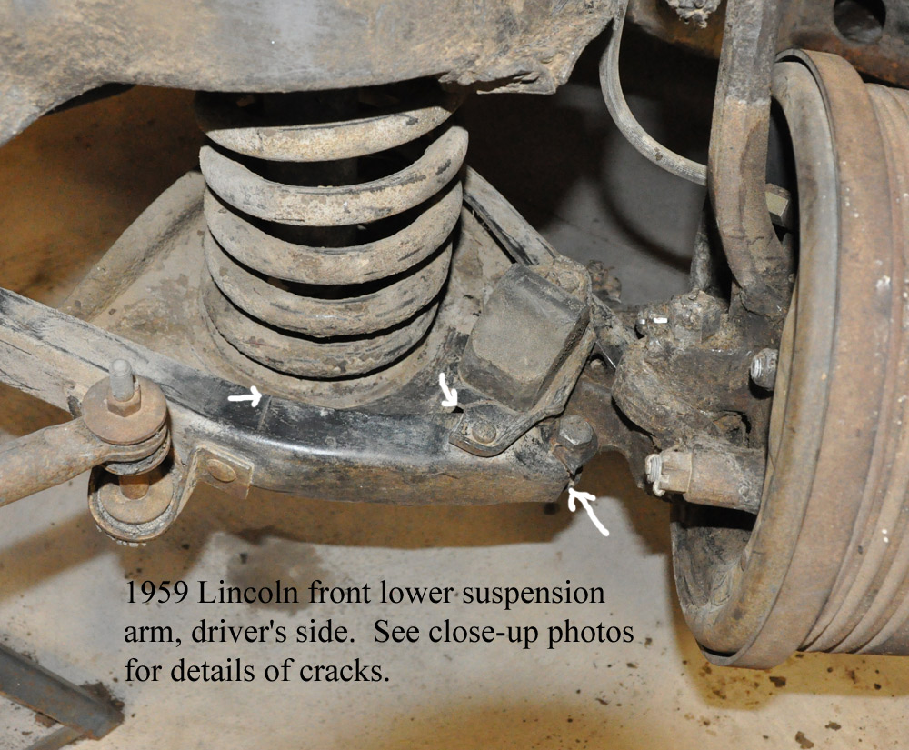

One thing leads to another... In scraping decades of hardened grease, oil and dirt off suspension components, I discover cracks in the lower front suspension arms, near the spot where the lower ball joint is attached.
I'm going to disassemble the front suspension and rebuild it with new bushings and ball joints if needed. I'll have a local machine shop fix the cracked arms and reinforce them.

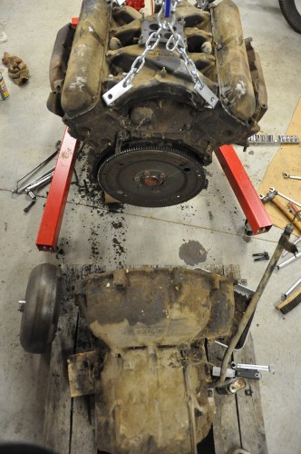

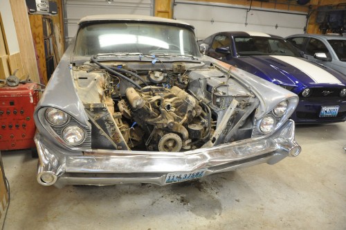

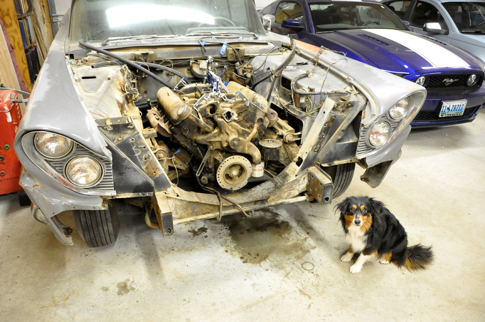

I've got the engine and trans ready to be hoisted out. Naturally, I hit another setback. The car is so big that I'll need to remove the front bumper and splash pan in order to get the hoist close enough to pull the engine at a proper angle.
- Posts: 11
- Joined: Wed 19. Aug 2015, 12:37
- Location: Powell, Wyoming
Re: 1959 Lincoln Capri Landau
The bumper is off, ready to pull engine & trans:
- Posts: 11
Engine removed from transmission:
