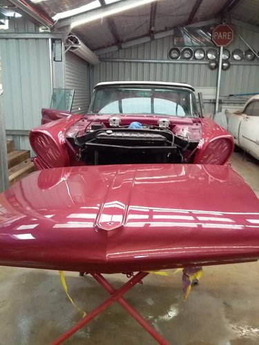

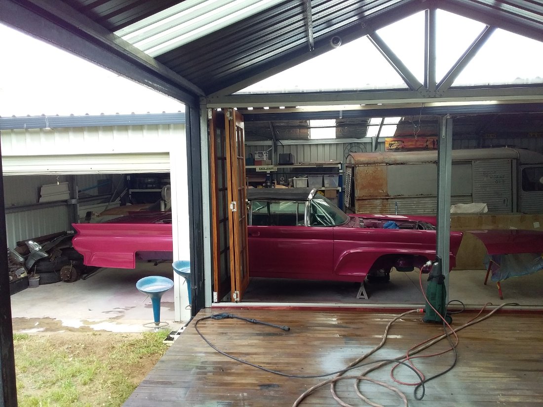

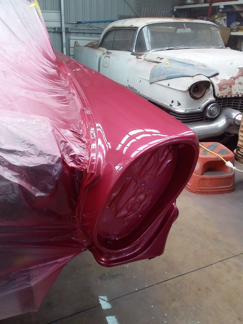

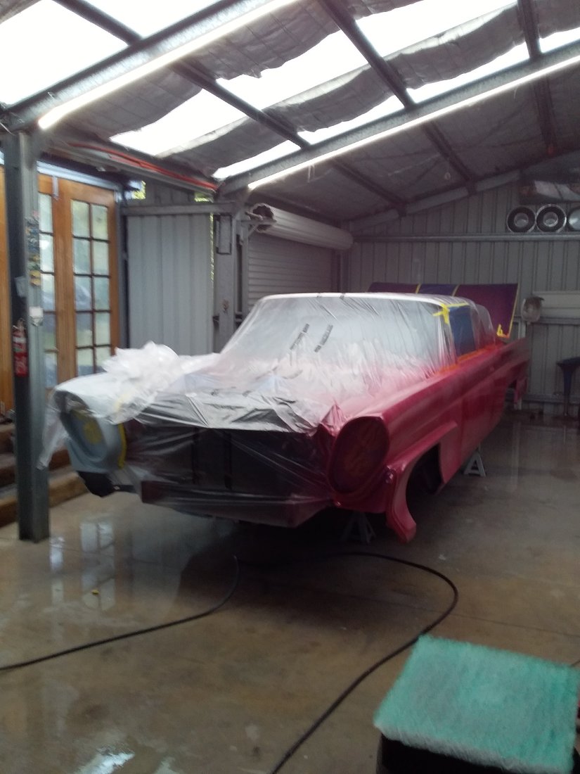

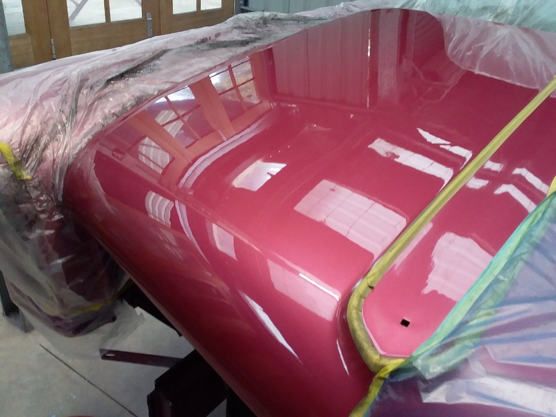

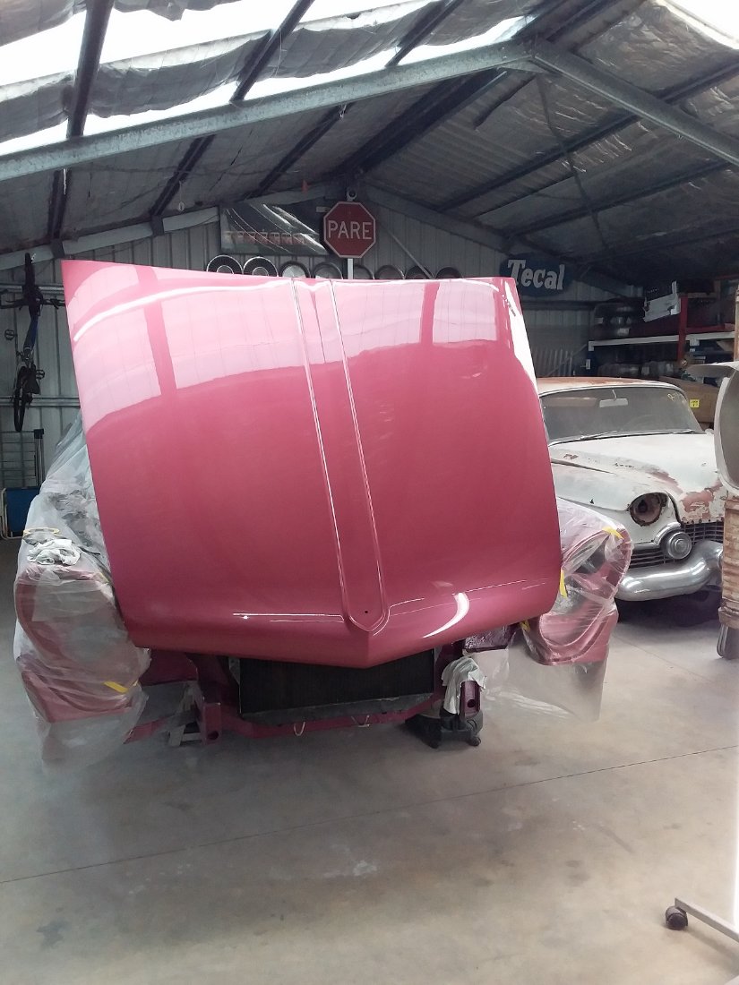

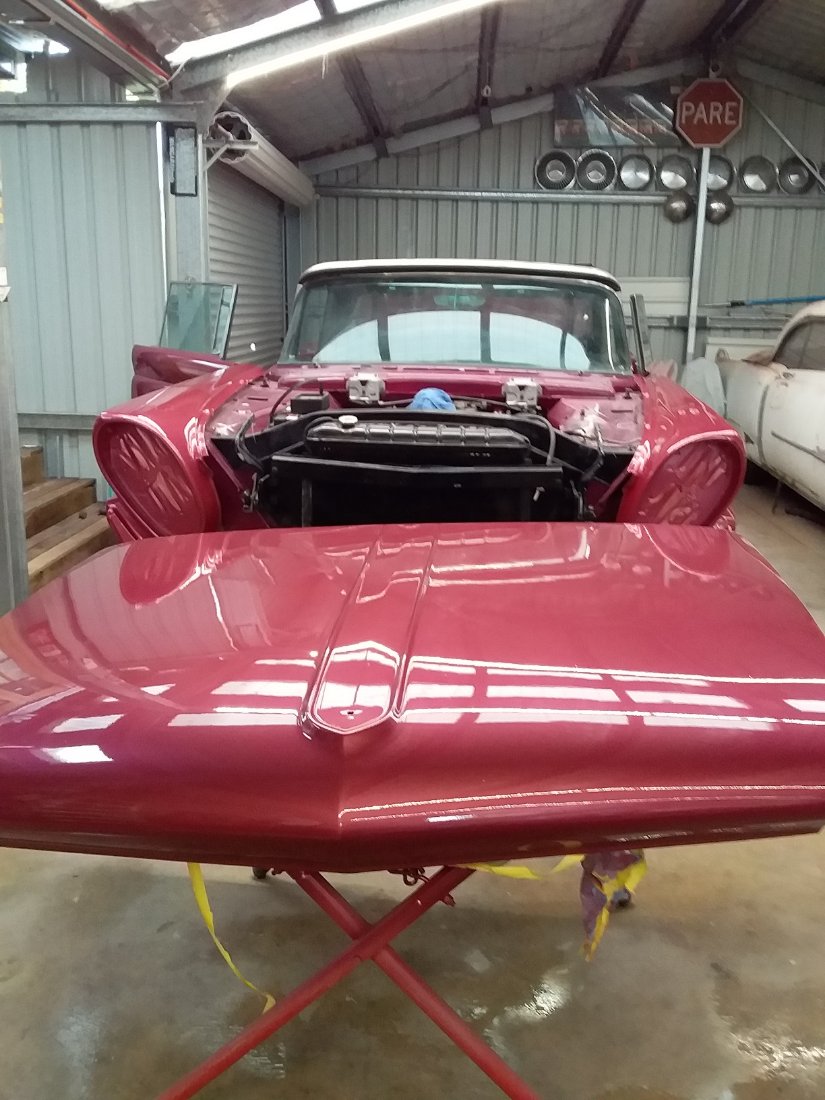

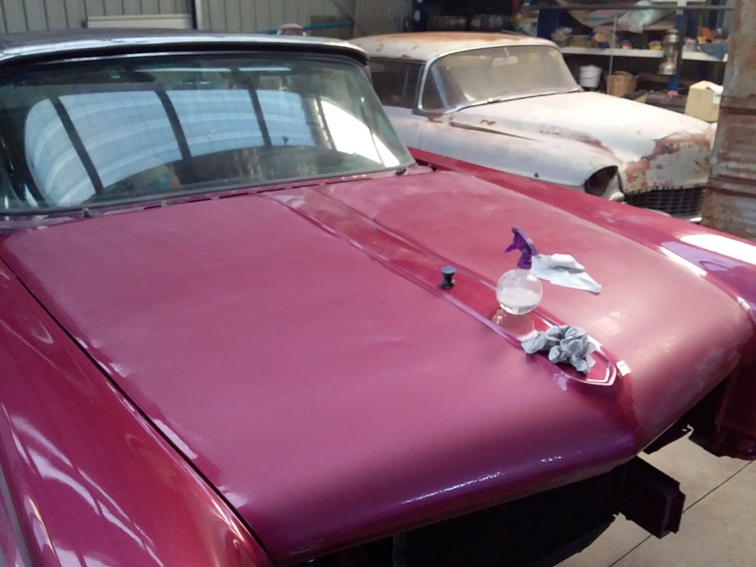

Last Sunday got both long sides painted.
It was a long day. And very tiring.
Got a few nasty runs in the right side (tight space against the garage wall and difficult to see the wet edge as I was spraying).
Hopefully should be able to fix that with careful cut and polish the clear when its hard enough.
To paint only have a few small bits remaining, one rear skirt, two small windshield wings and the paint windshield grill.

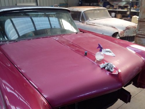

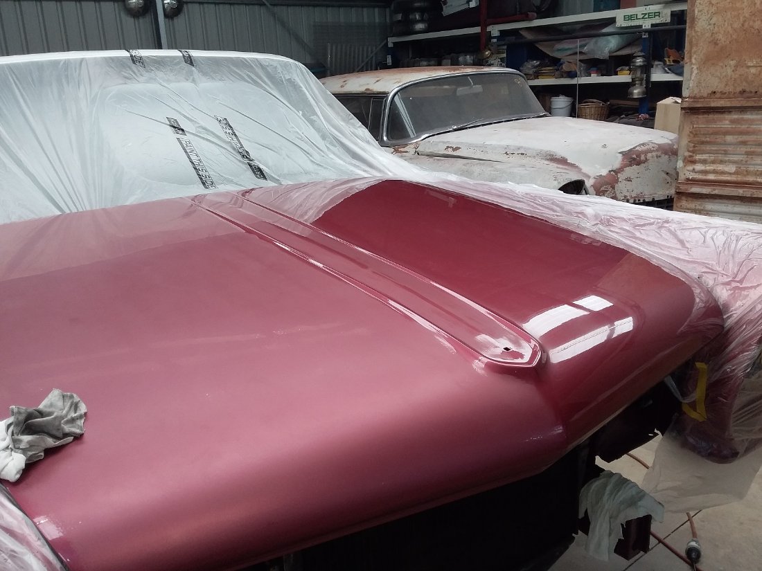

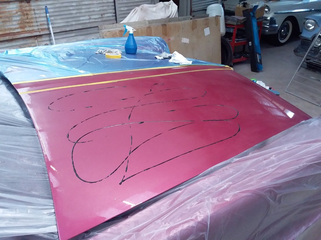

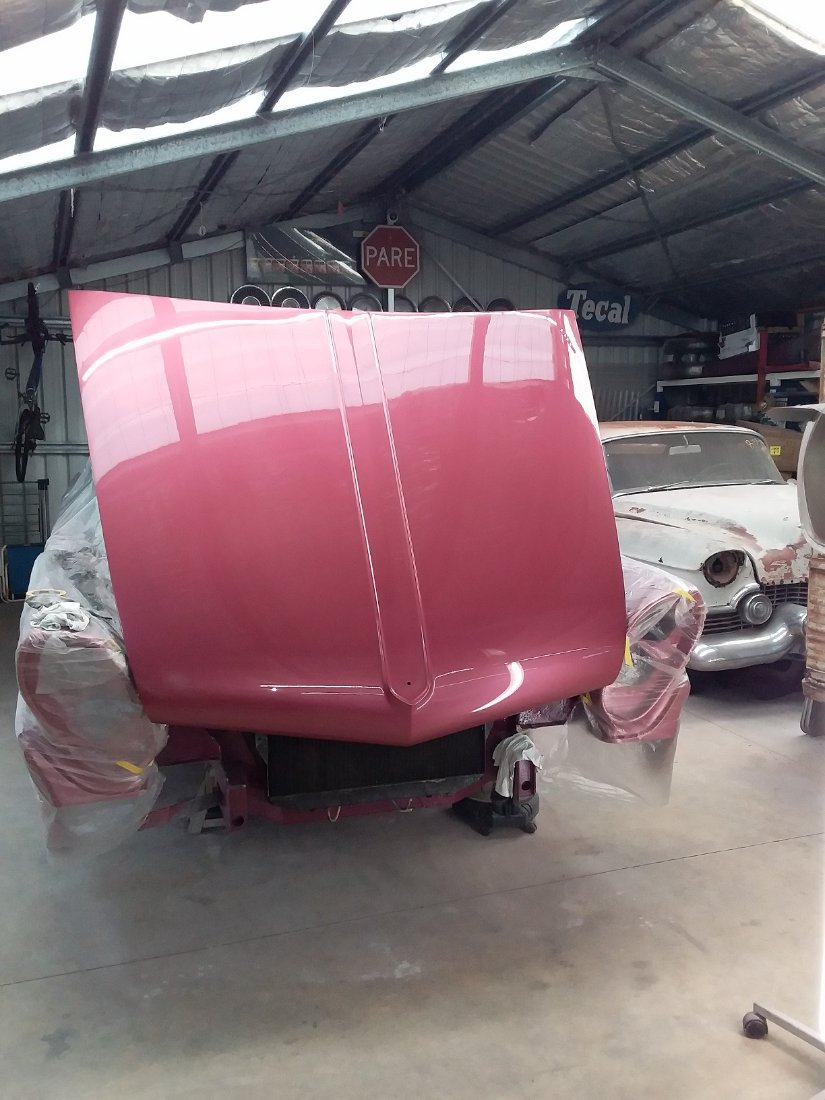

Fine Gentleman and LADIES
Nib and runs removal (Tungsten file)
P1200 - Get rid of Orange peel - P1500 - P2000
Wool Pad cutting compound....
Not Perfect BUT enough for this fella here
PEACE
Jules

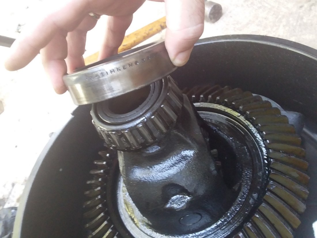

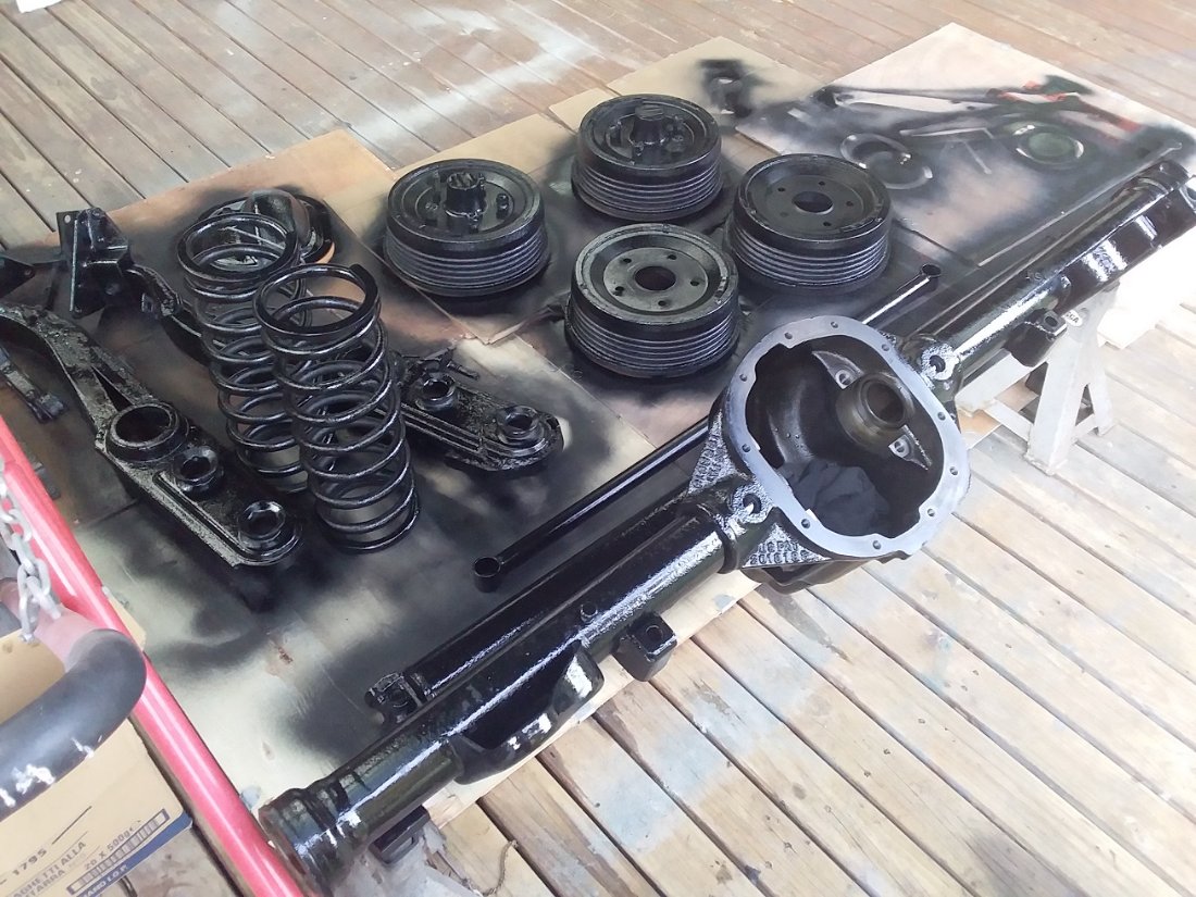

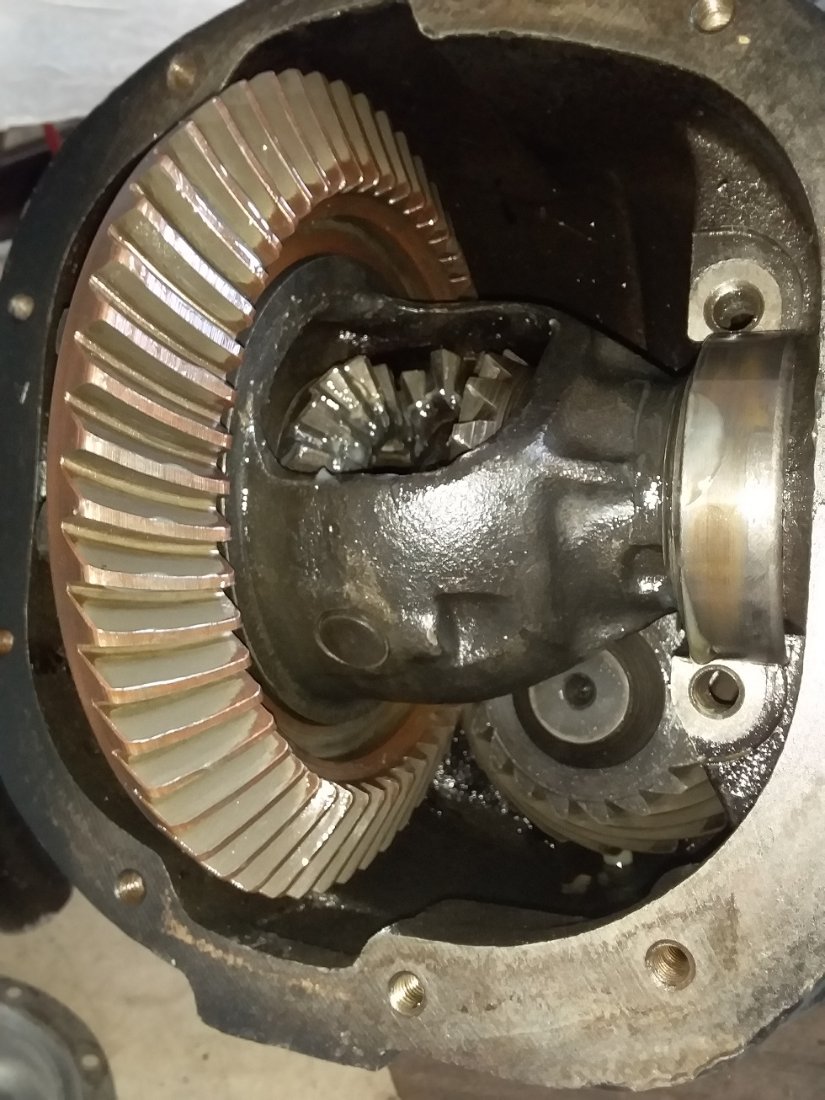

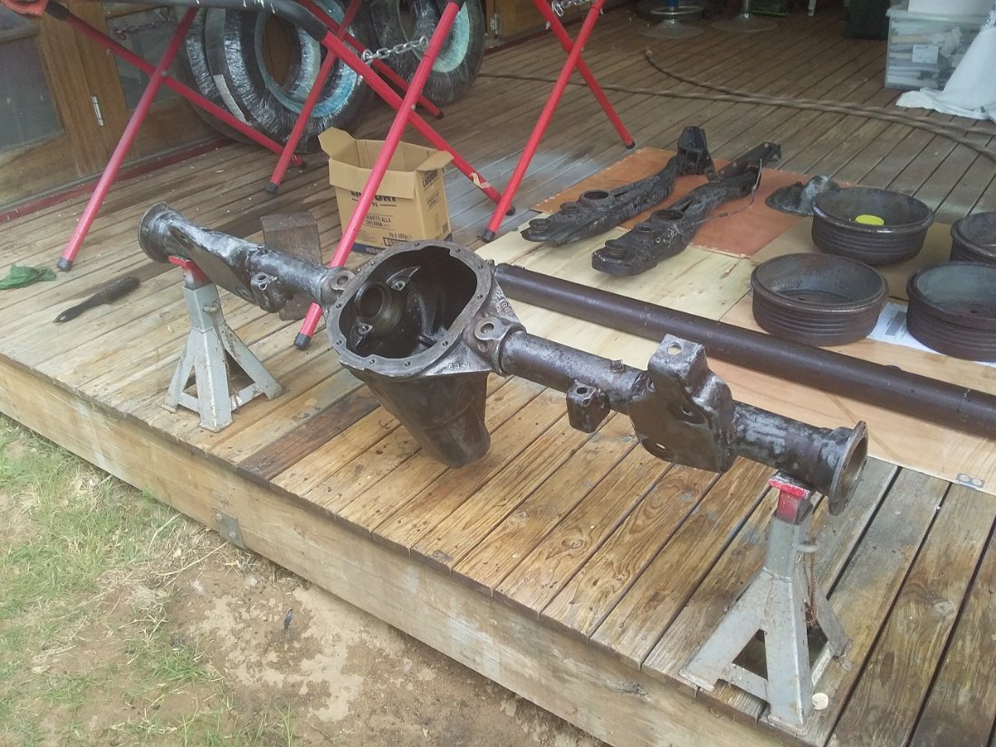

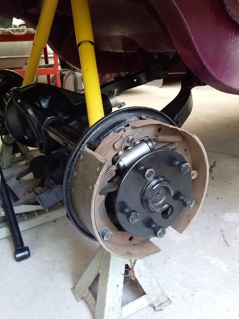

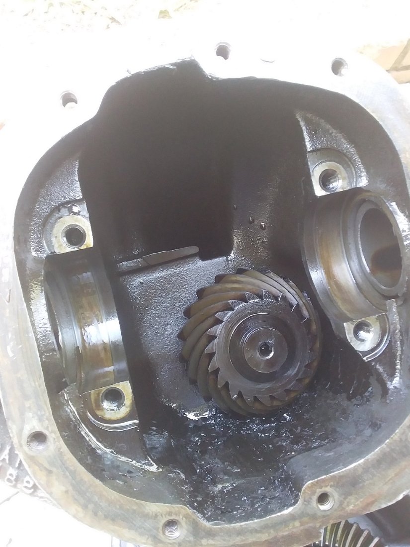

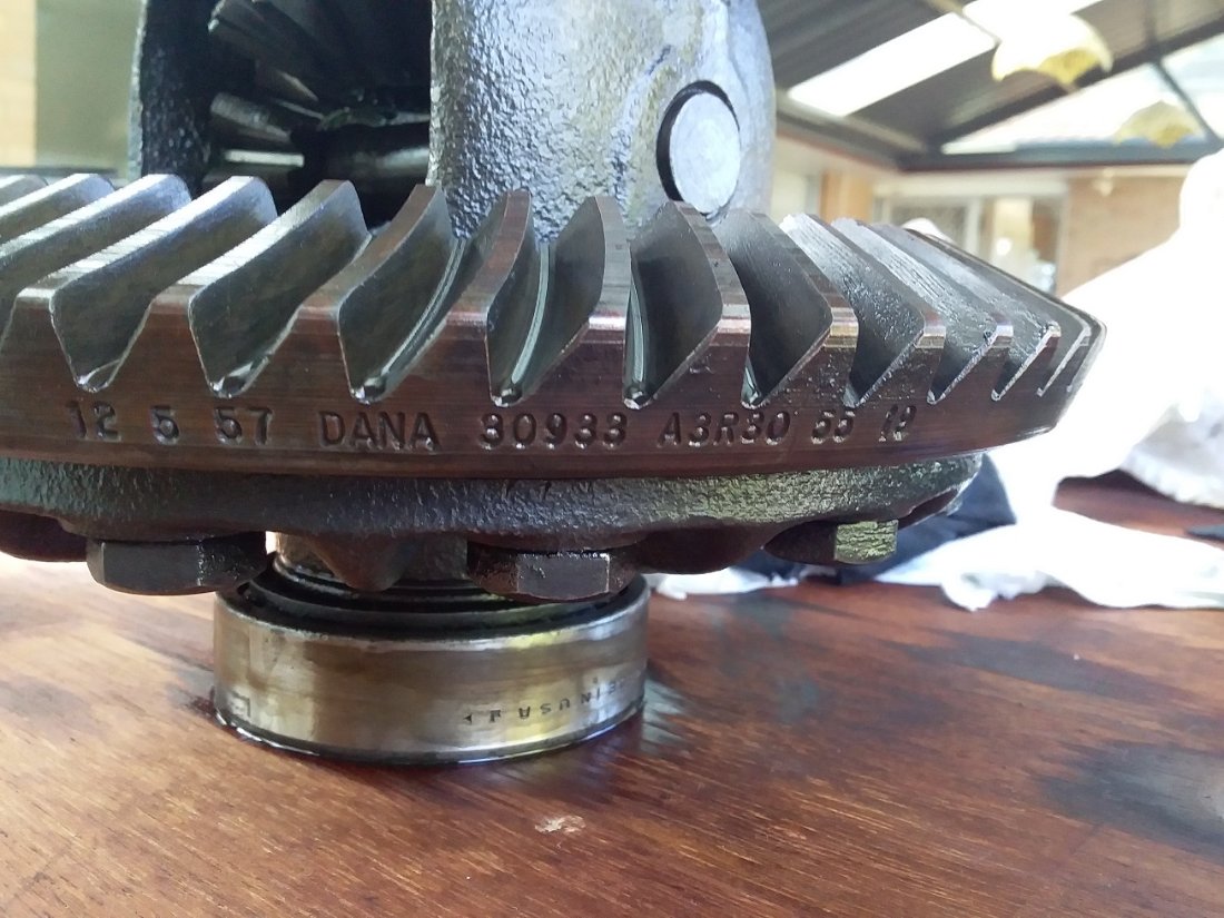

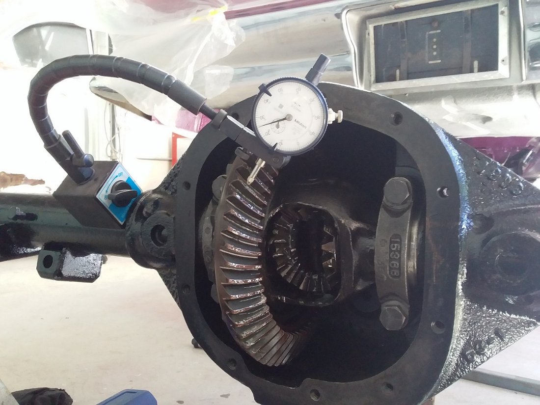

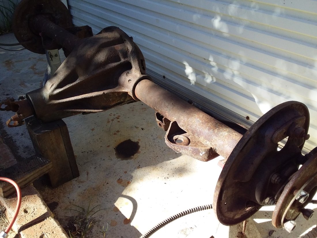

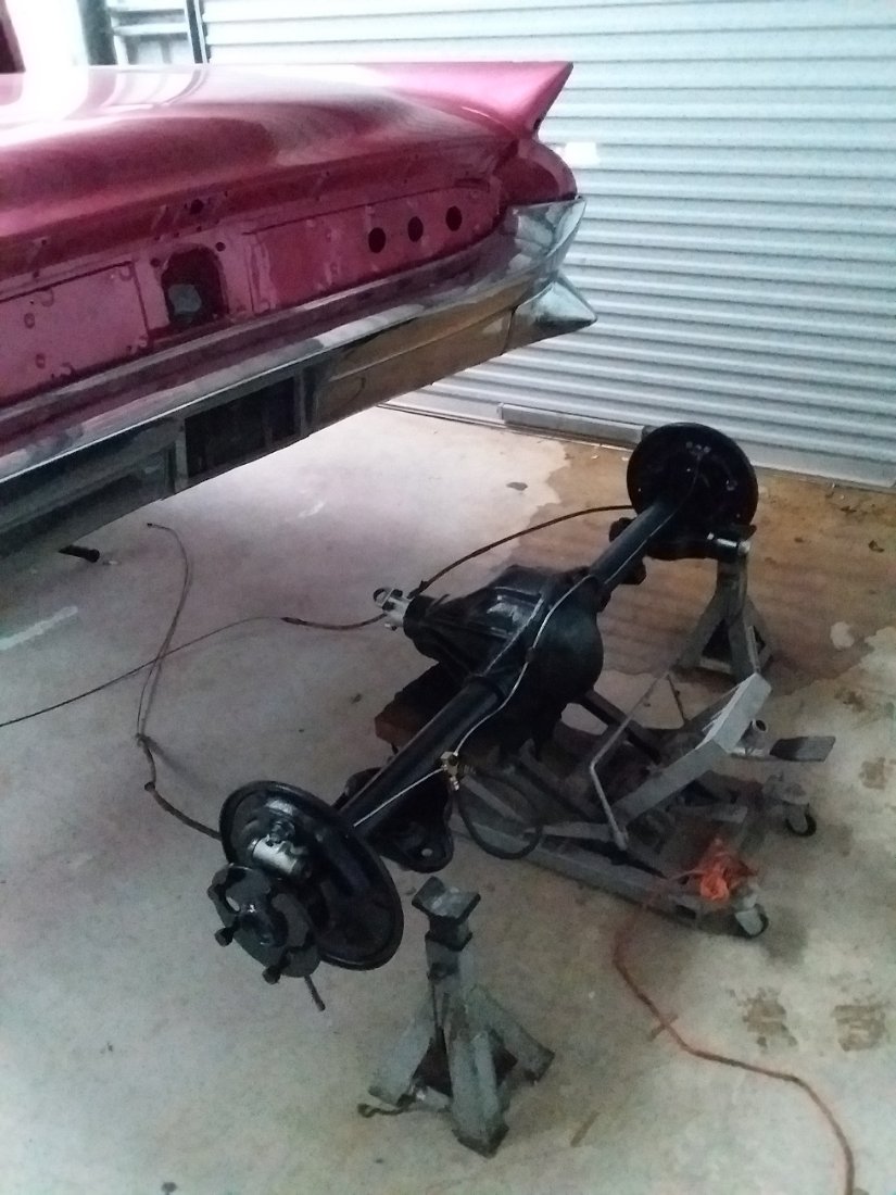

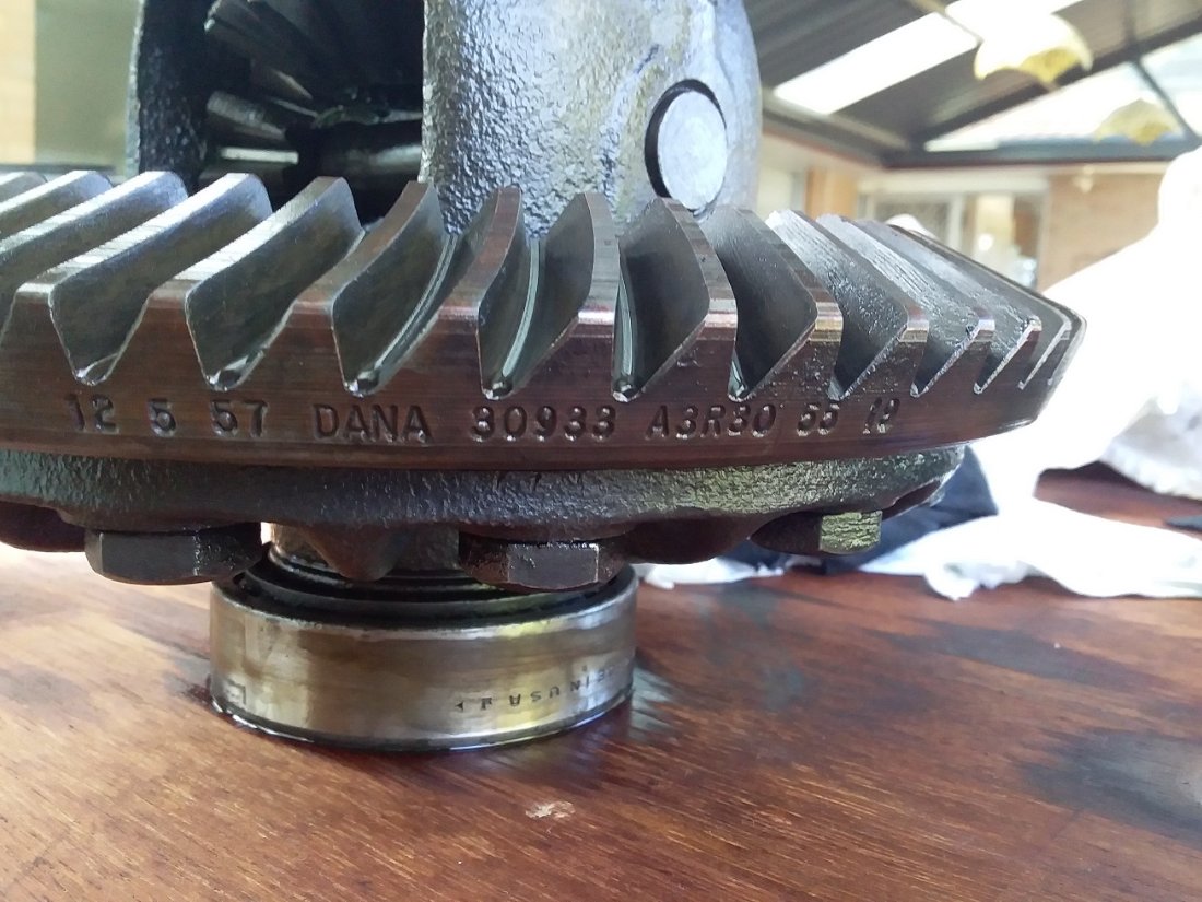

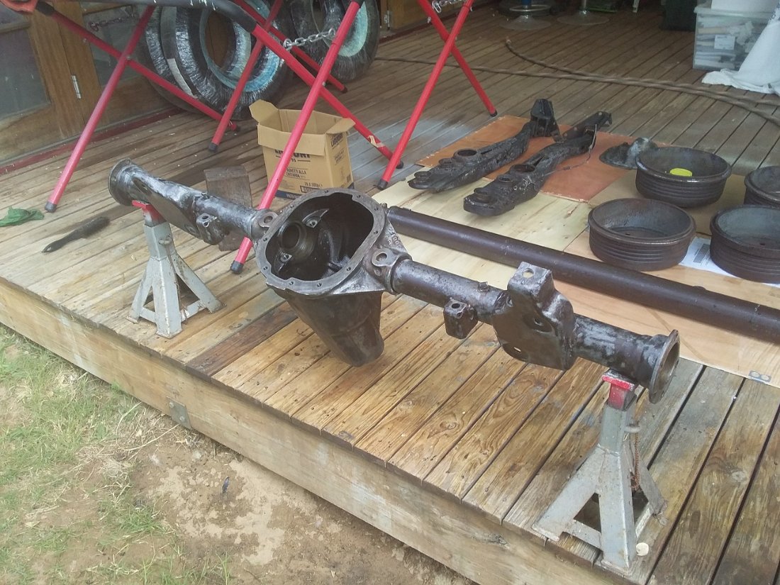

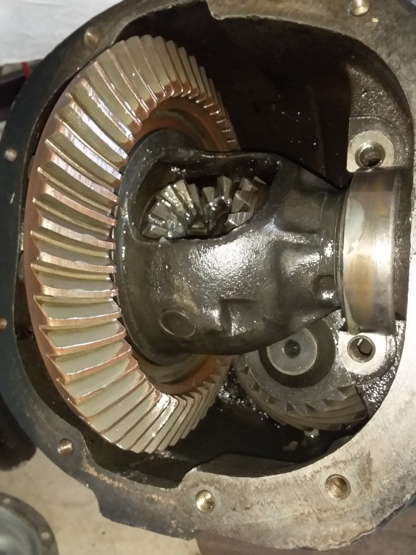

Rear Differential Rebuild.
Gears were OK
Main Bearings OK
Replaced Axle Bearings and All Seals

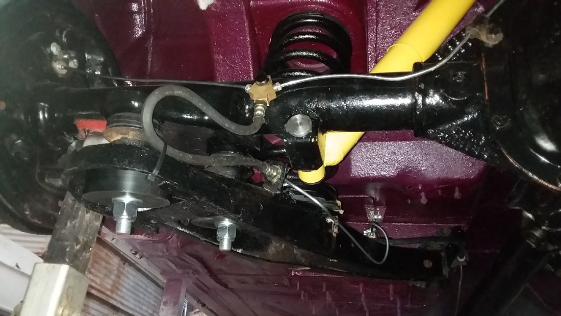

novetti
Posts: 46
Re: 1958 Continental Claret -
Post by novetti » Tue 10. Aug 2021, 05:06

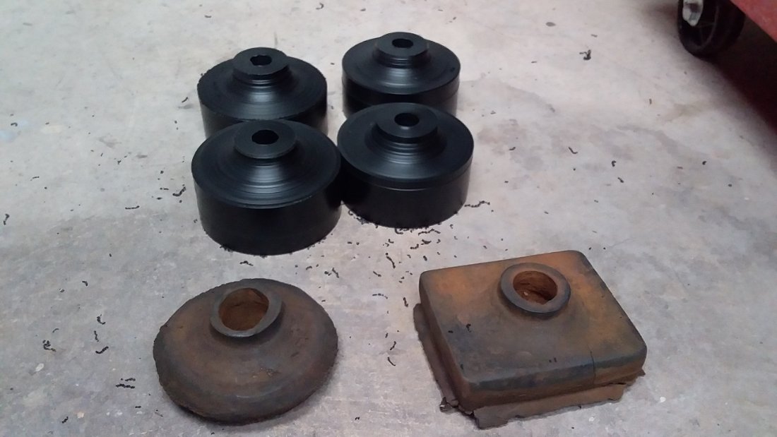

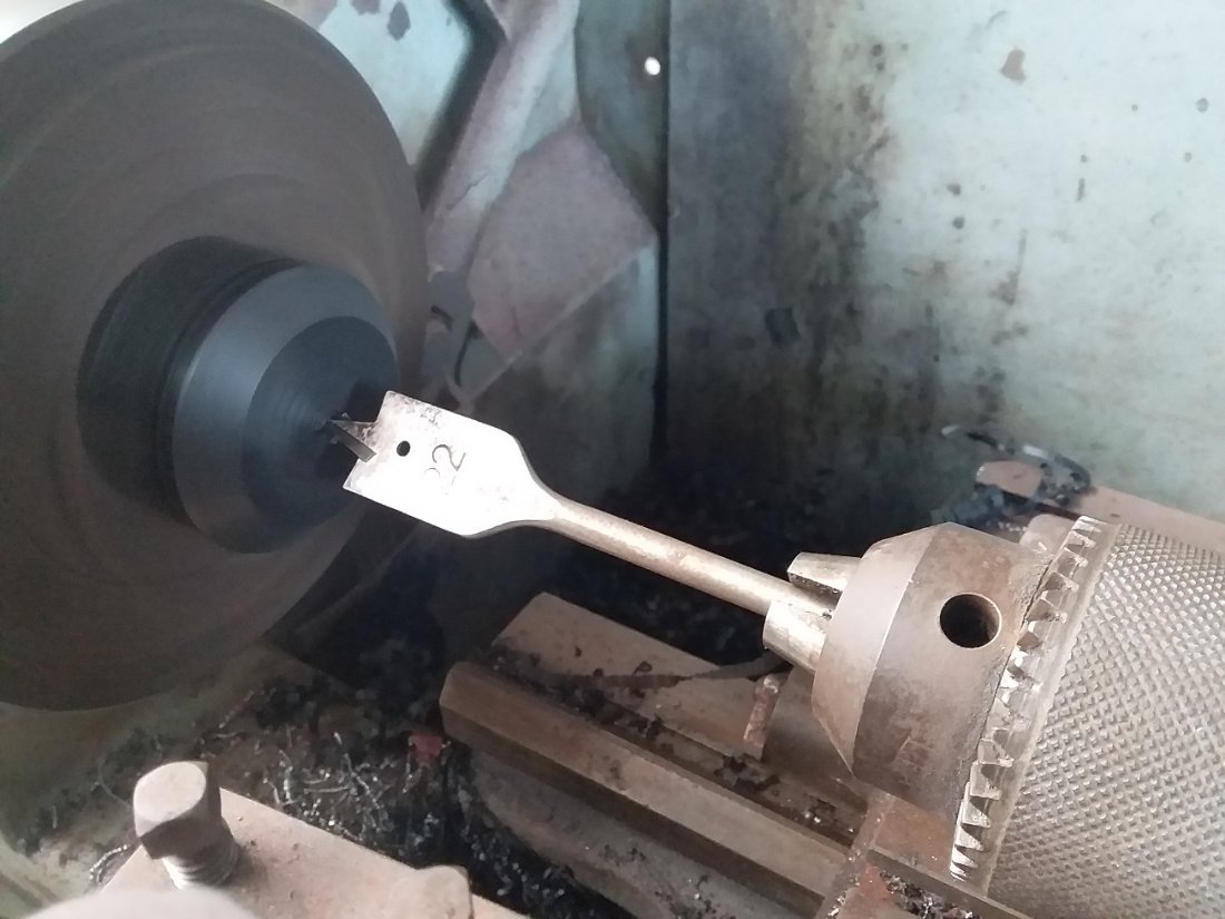

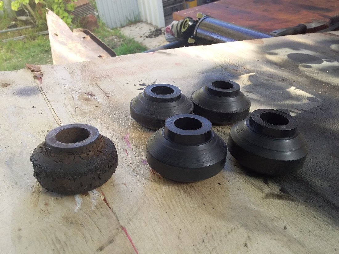

Machining new Rear Suspension Arm bushes from Delrin
since these are no longer available

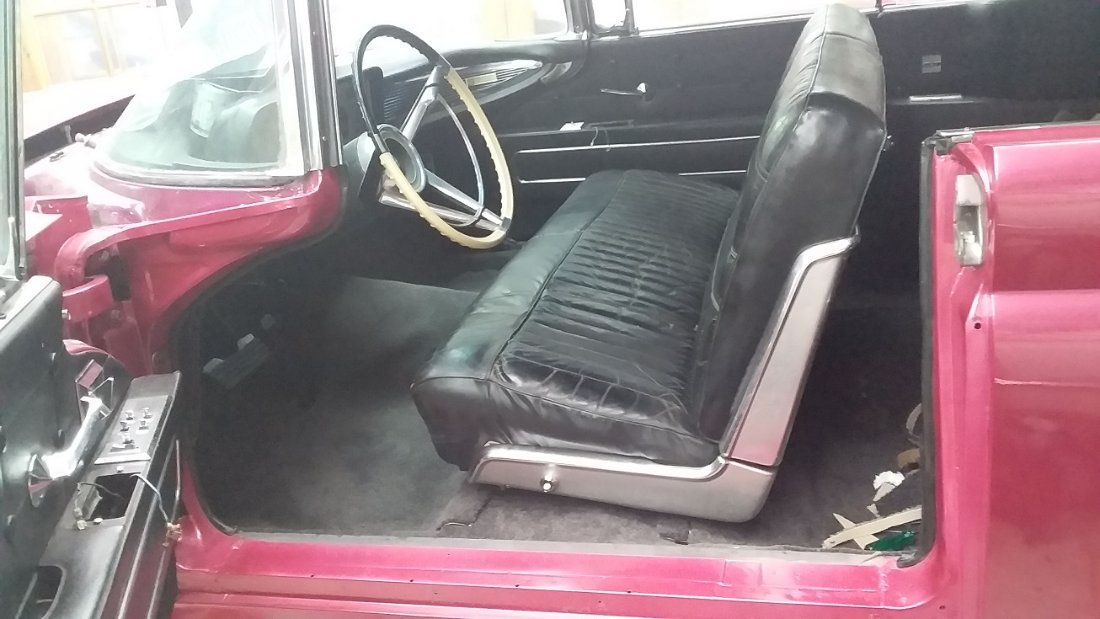

Post by novetti » Tue 10. Aug 2021, 05:07

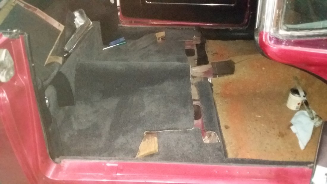

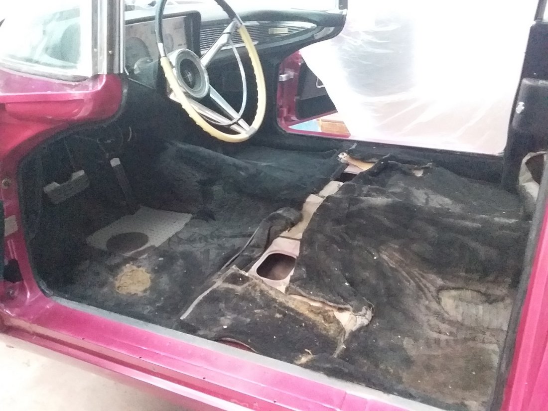

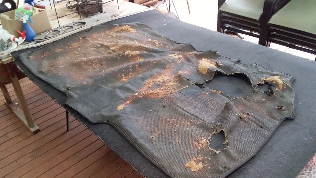

Making carpets from shop bought carpet.
contact glue
Trimming etc

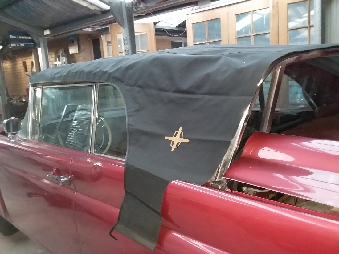

Post by novetti » Tue 10. Aug 2021, 05:09

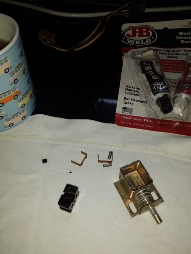

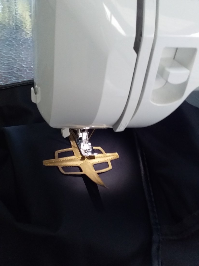

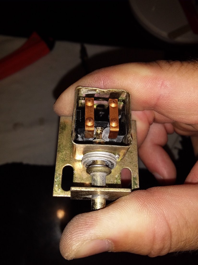

Top had faulty switches
Rebuilt switches with JB weld - Bakelite was broken in a few places

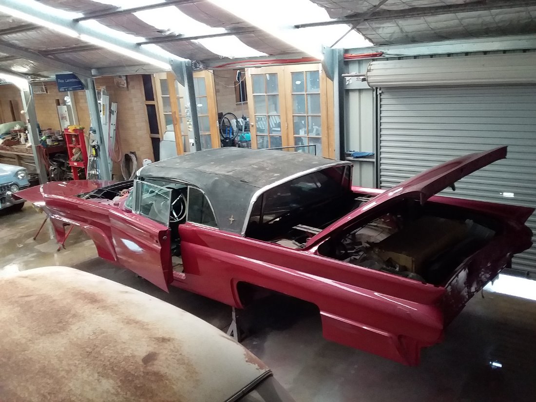

Sewing 4 point logo to new top material (logo scavenged from the original top).

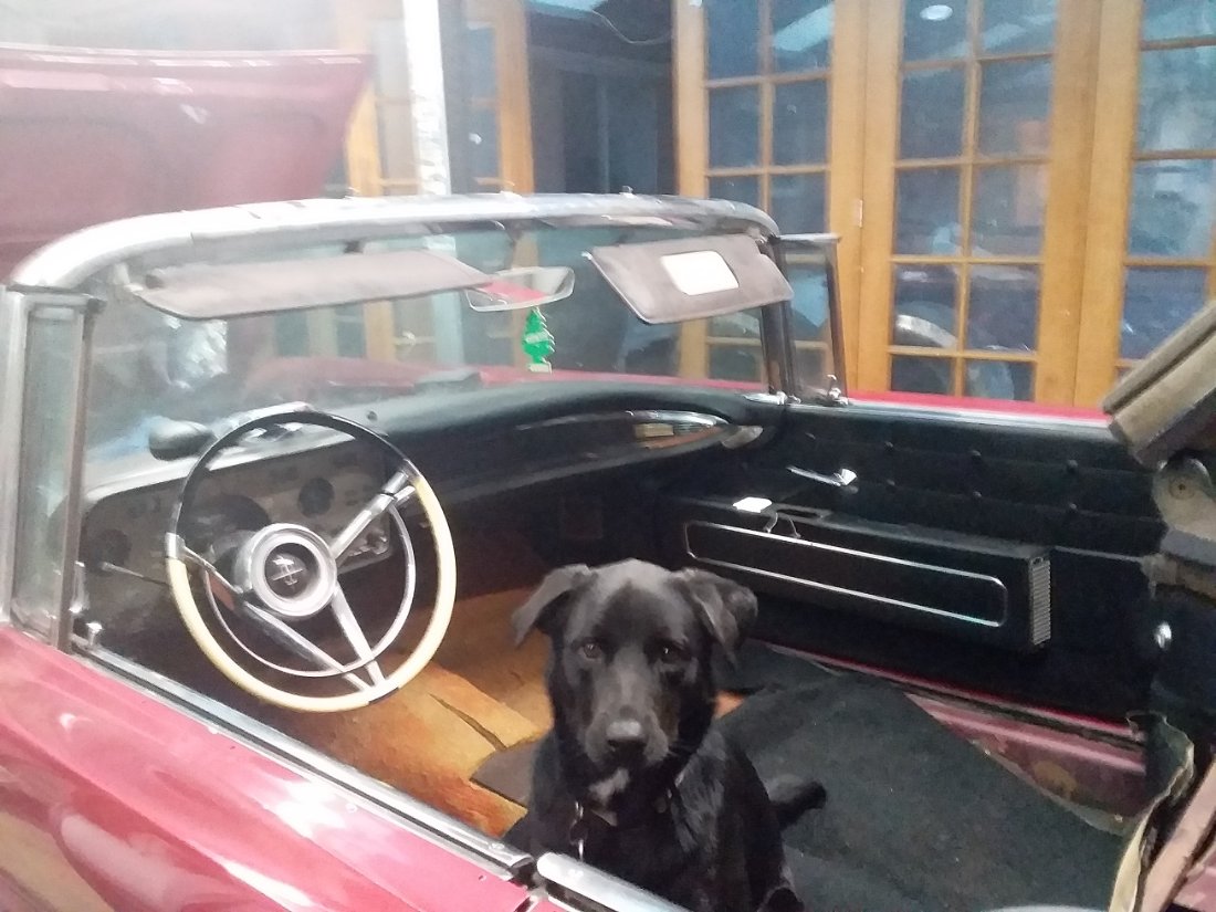

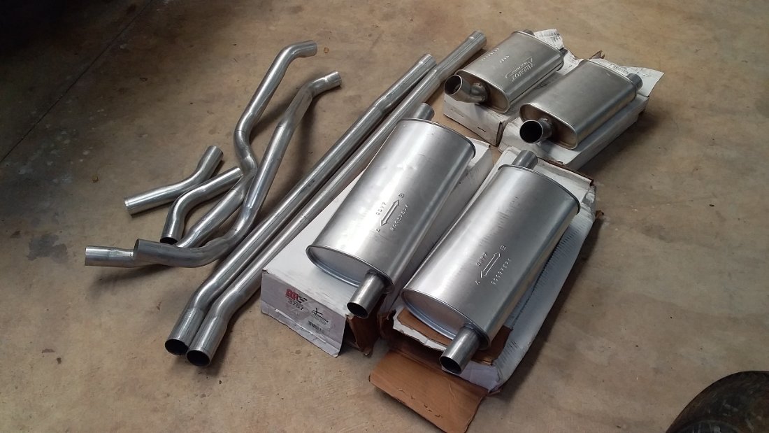

Miscelaneous photos
New muffler system quieted the beast very well
Vehicle is on the ground on its wheels, need to bleed brakes
Waiting on new bling (Replaced bumpers) coming from the USA
Stay tuned for more. Sorry for the long delay posting updates.
Hope all of you guys are hanging there well.
Cheers
