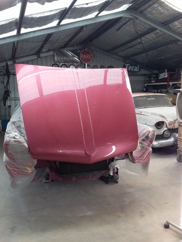

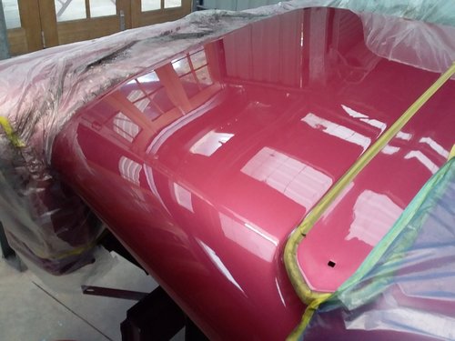

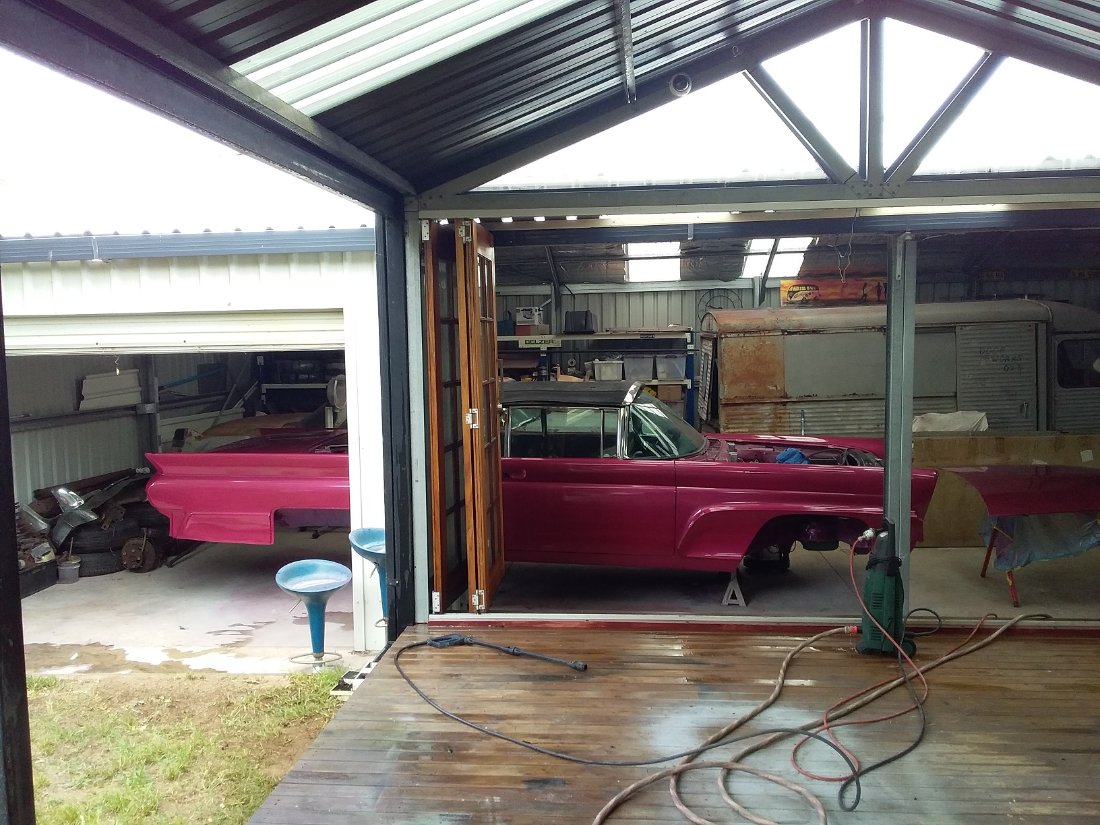

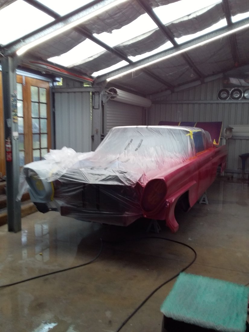

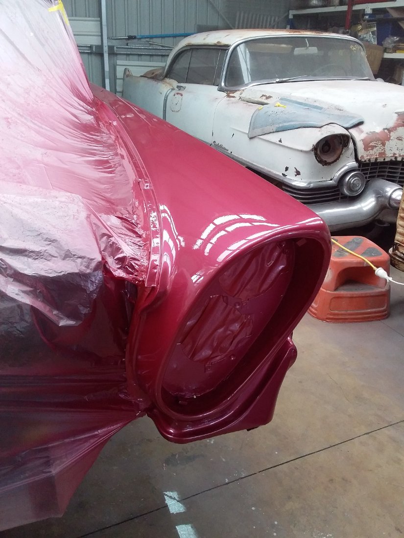

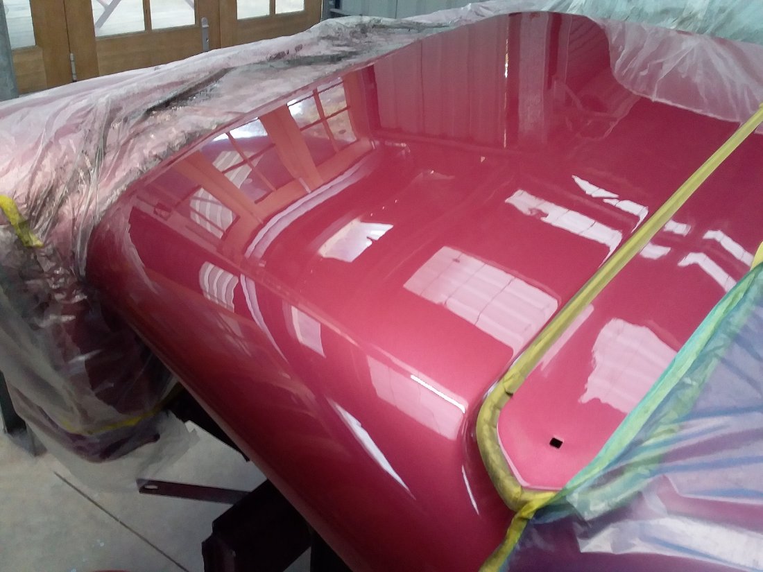

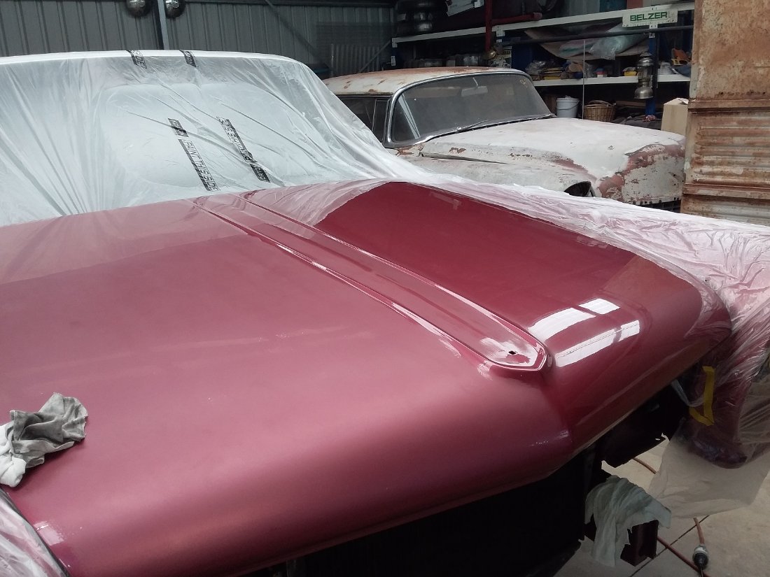

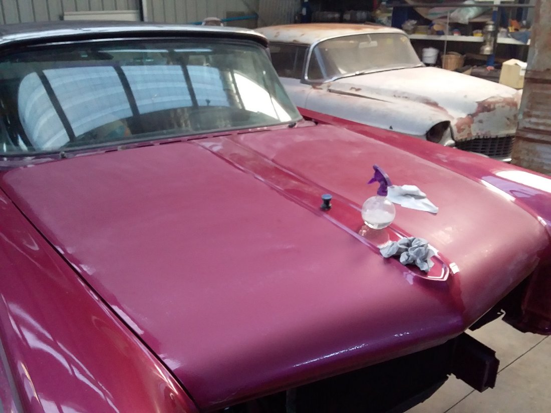

Last Sunday got both long sides painted.
It was a long day. And very tiring.
Got a few nasty runs in the right side (tight space against the garage wall and difficult to see the wet edge as I was spraying).
Hopefully should be able to fix that with careful cut and polish the clear when its hard enough.
To paint only have a few small bits remaining, one rear skirt, two small windshield wings and the paint windshield grill.

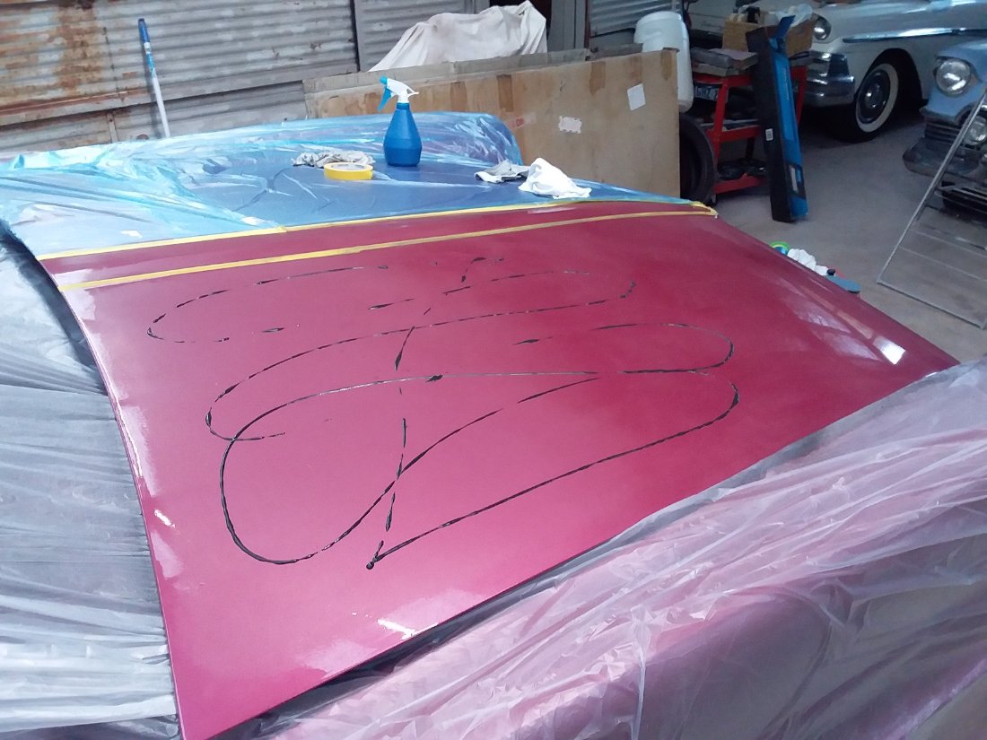

Fine Gentleman and LADIES
Nib and runs removal (Tungsten file)
P1200 - Get rid of Orange peel - P1500 - P2000
Wool Pad cutting compound....
Not Perfect BUT enough for this fella here
PEACE
Jules
PEACE
Jules

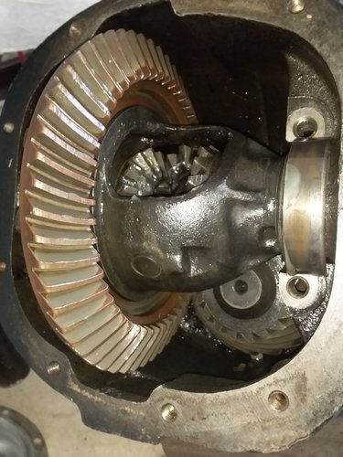

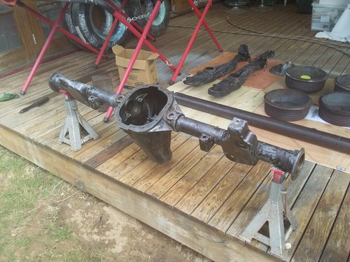

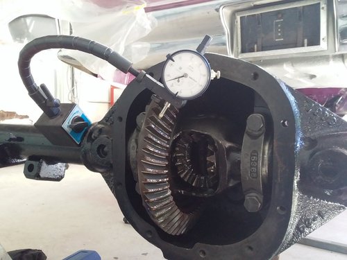

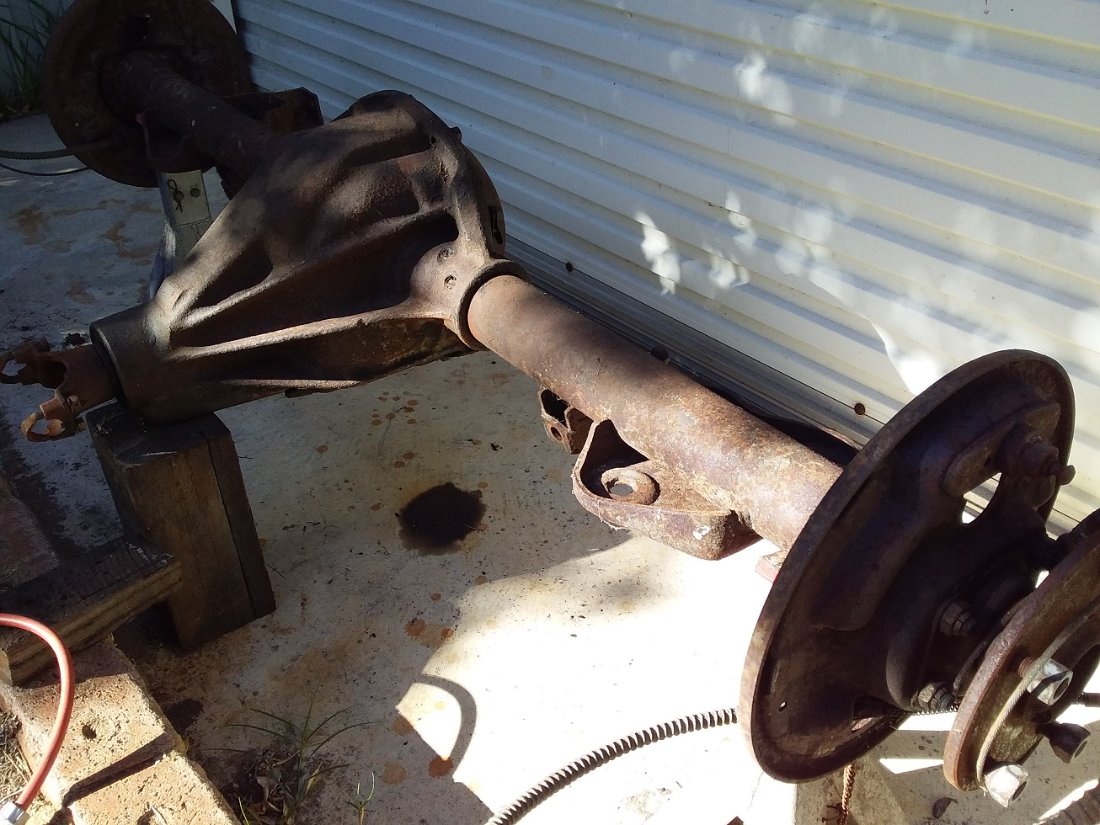

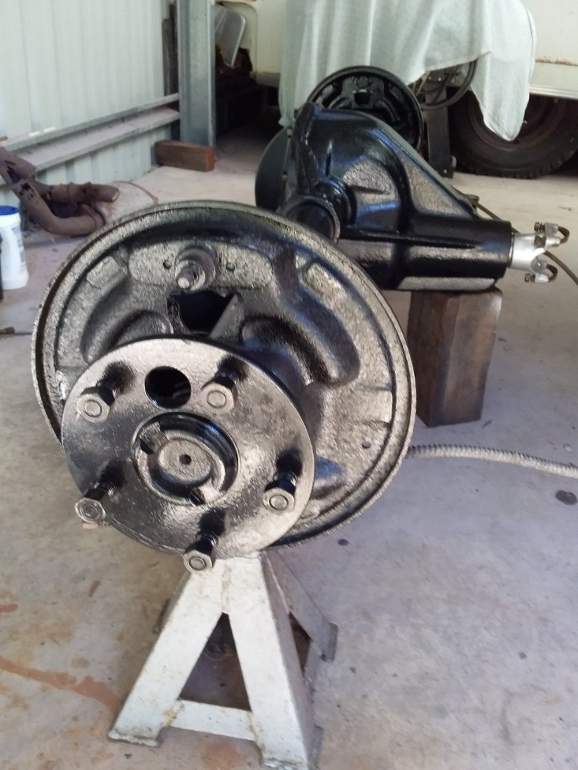

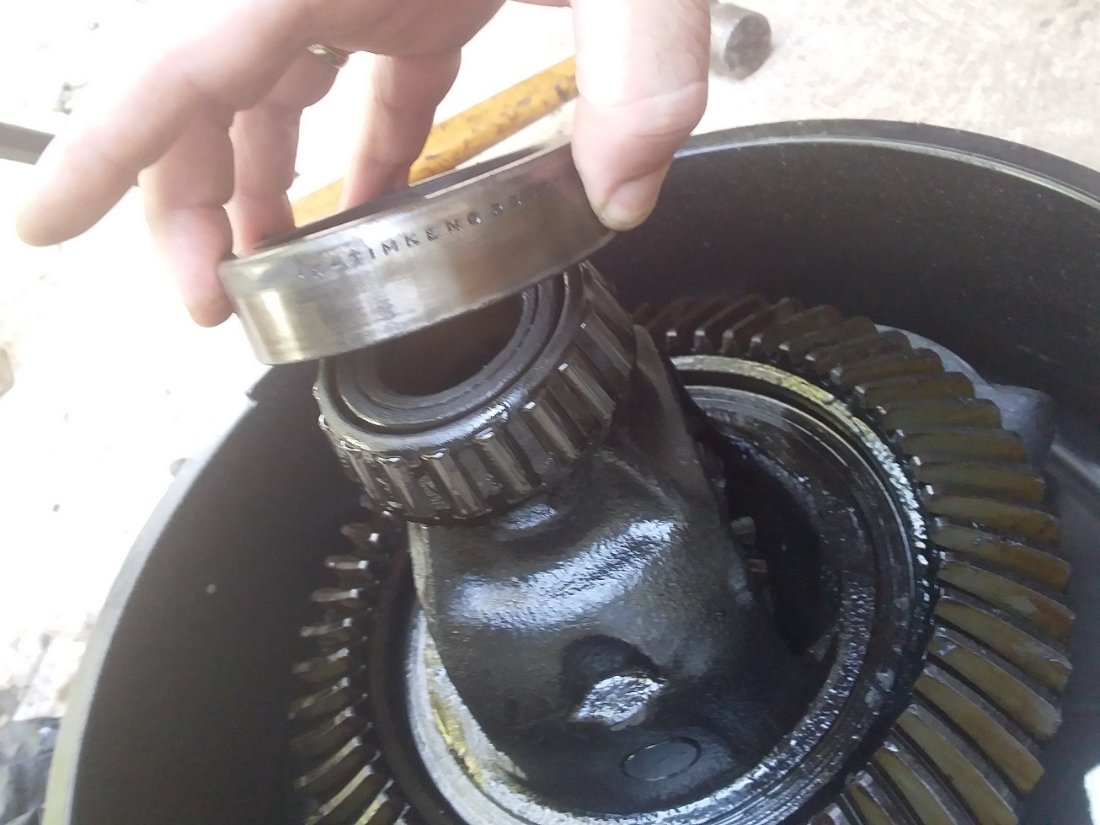

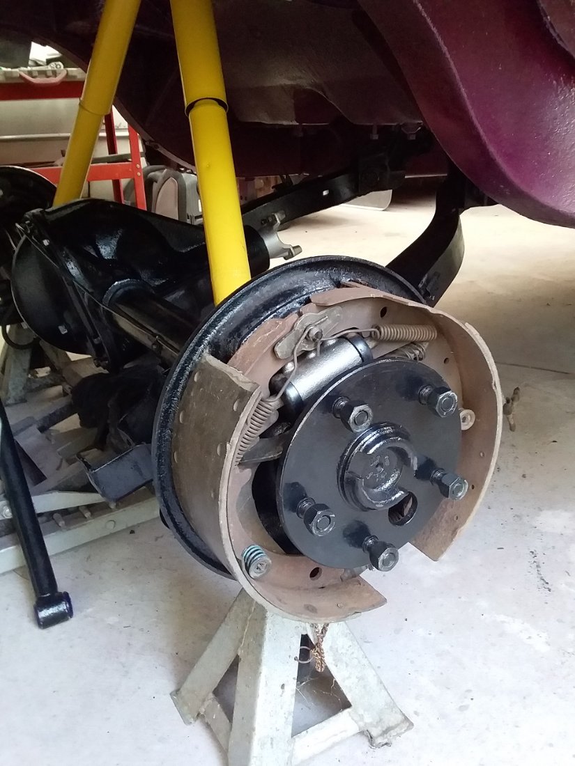

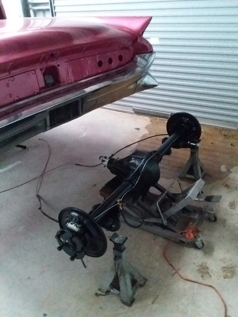

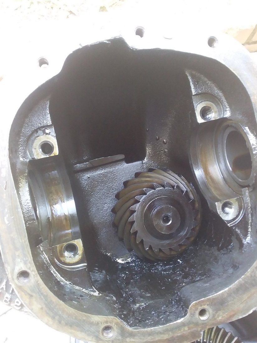

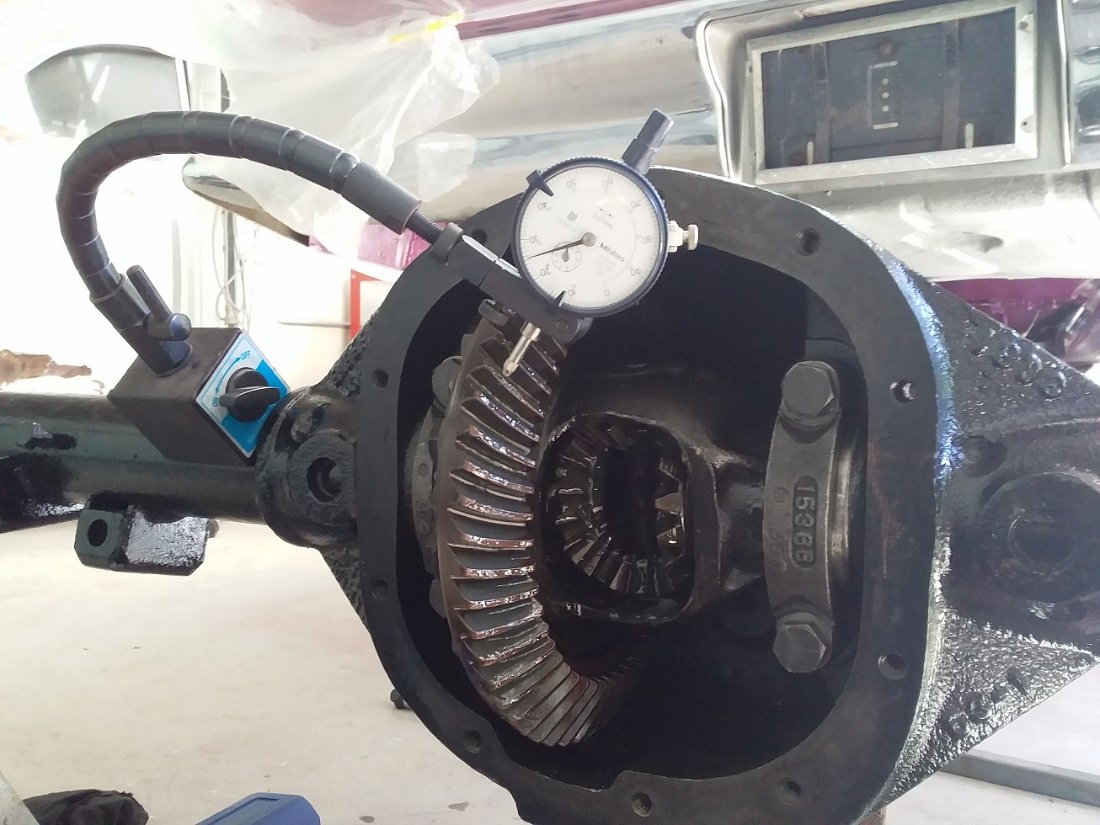

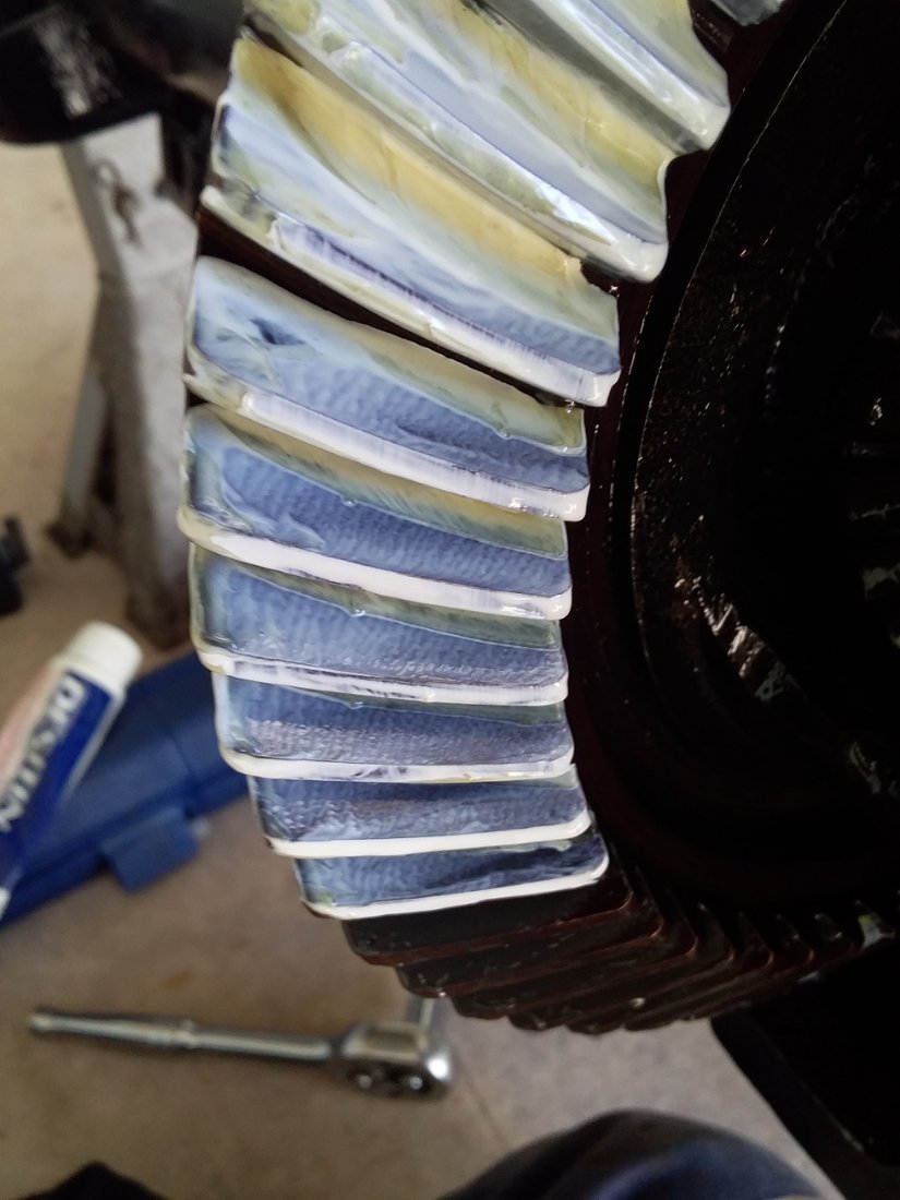

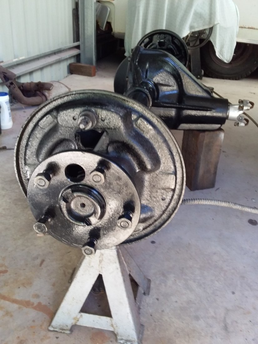

Rear Differential Rebuild.
Gears were OK
Main Bearings OK
Replaced Axle Bearings and All Seals
						Gears were OK
Main Bearings OK

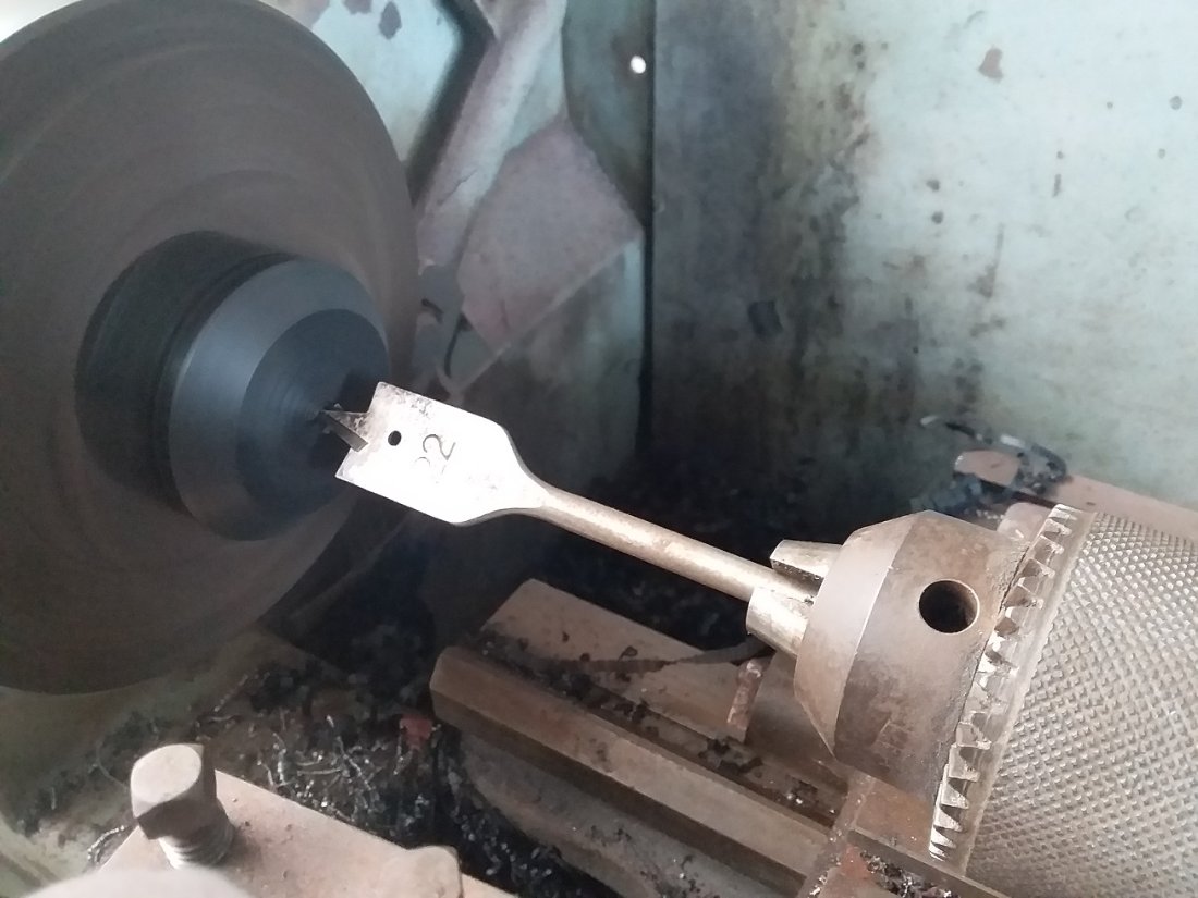

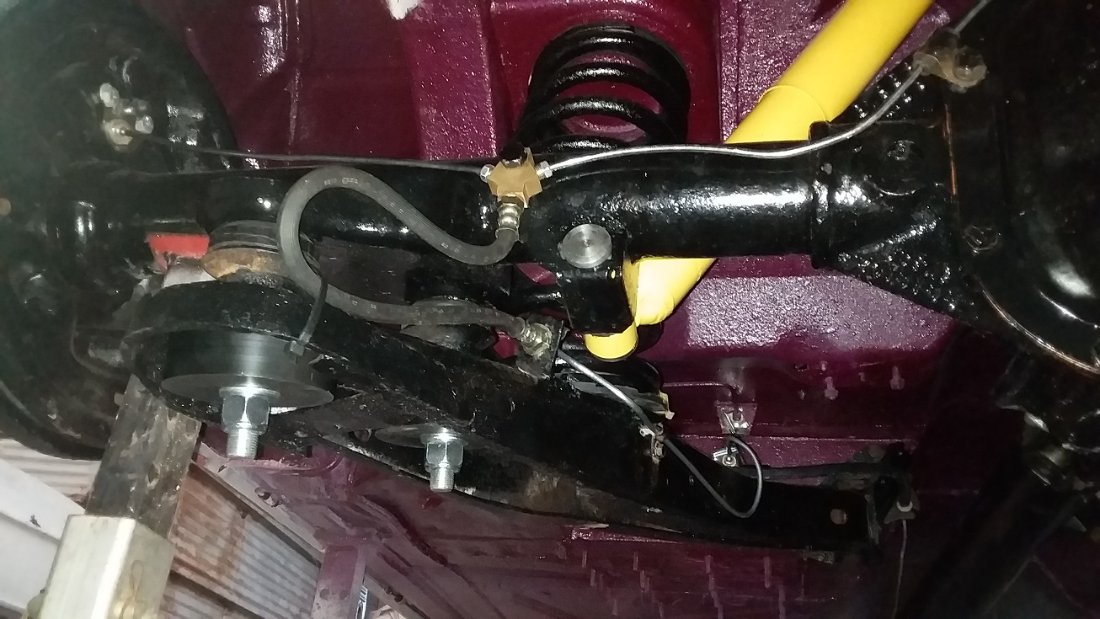

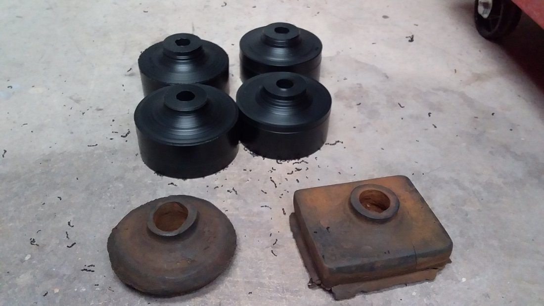

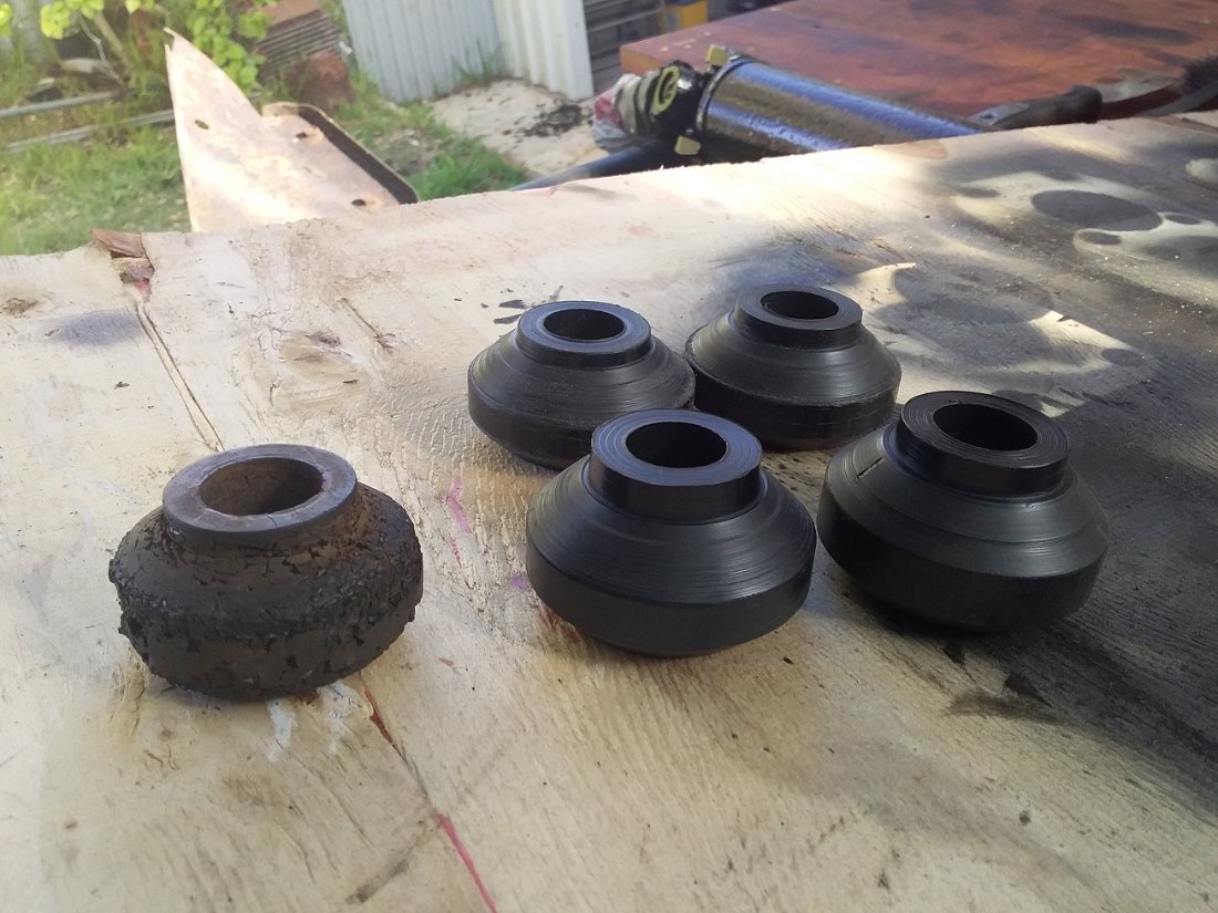

Machining new Rear Suspension Arm bushes from Delrin
since these are no longer available

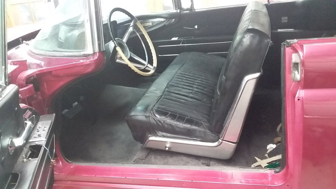

Re: 1958 Continental Claret -

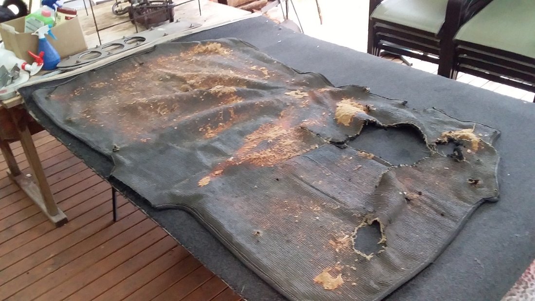

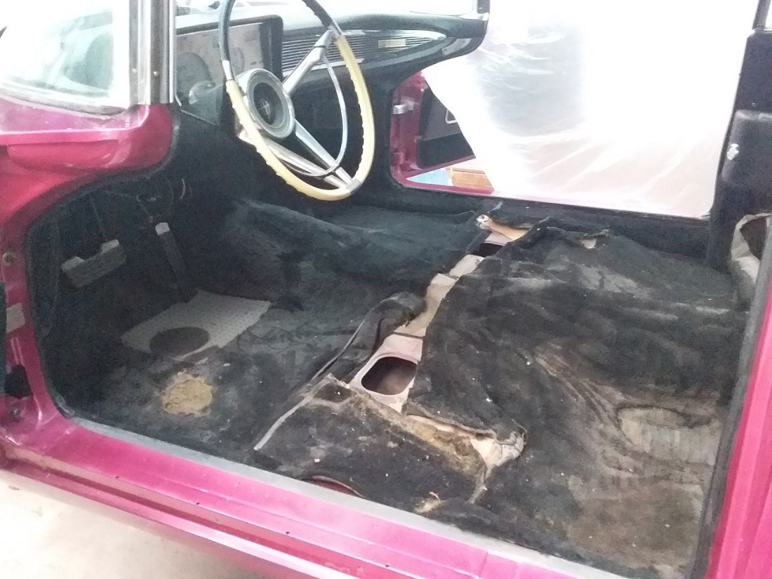

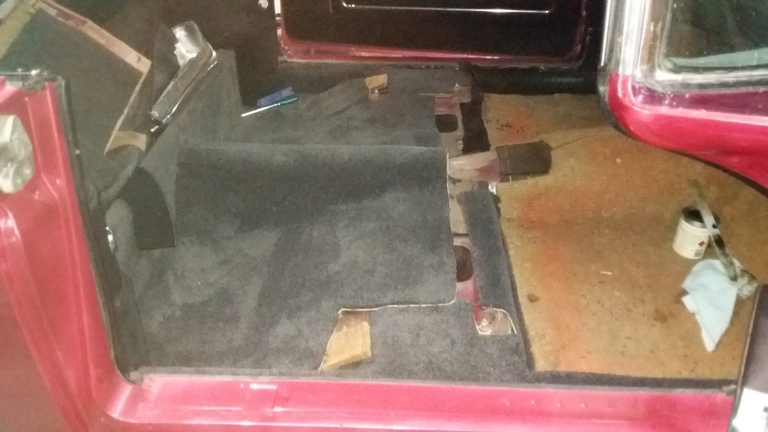

Making carpets from shop bought carpet.
contact glue
Trimming etc
						contact glue
Trimming etc

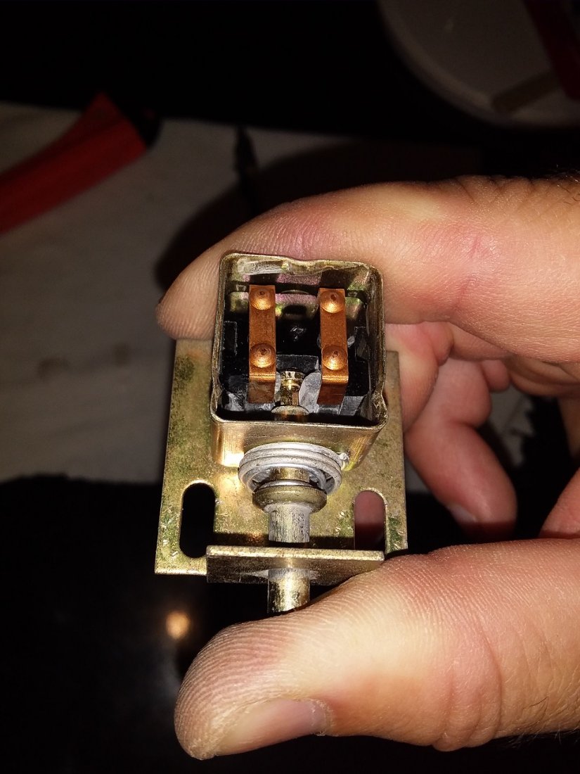

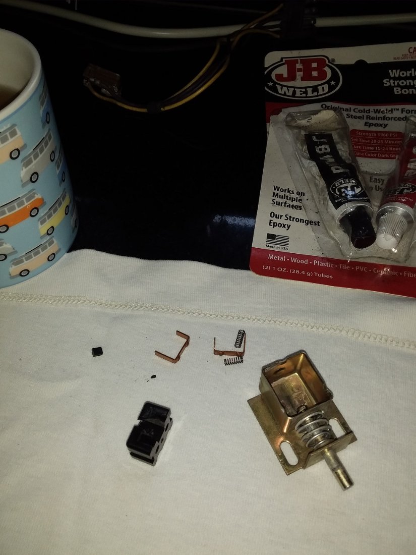

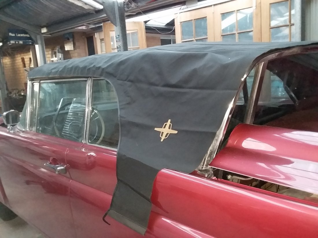

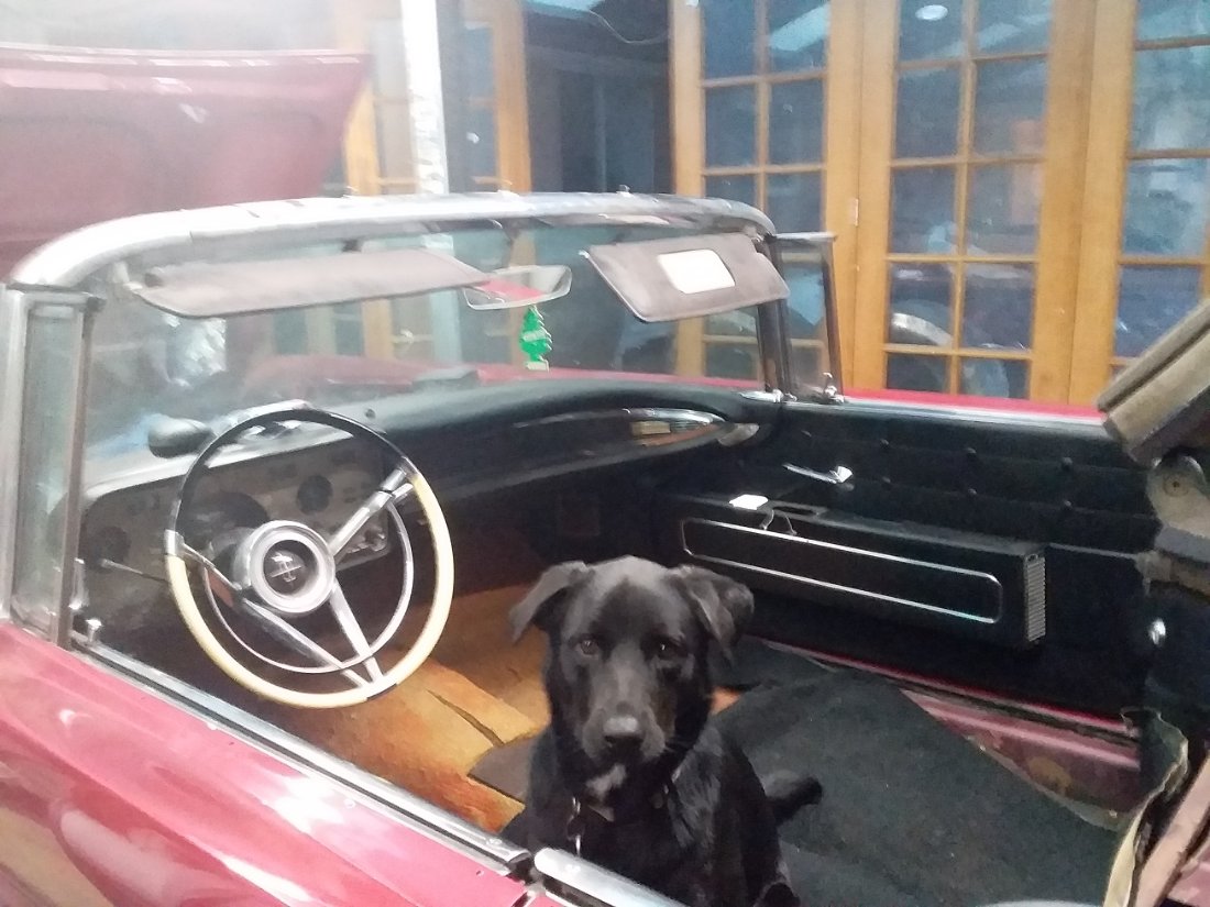

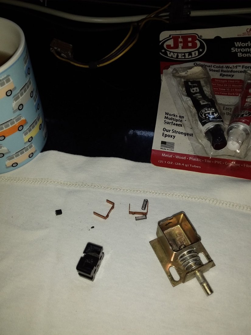

Top had faulty switches
Rebuilt switches with JB weld - Bakelite was broken in a few places

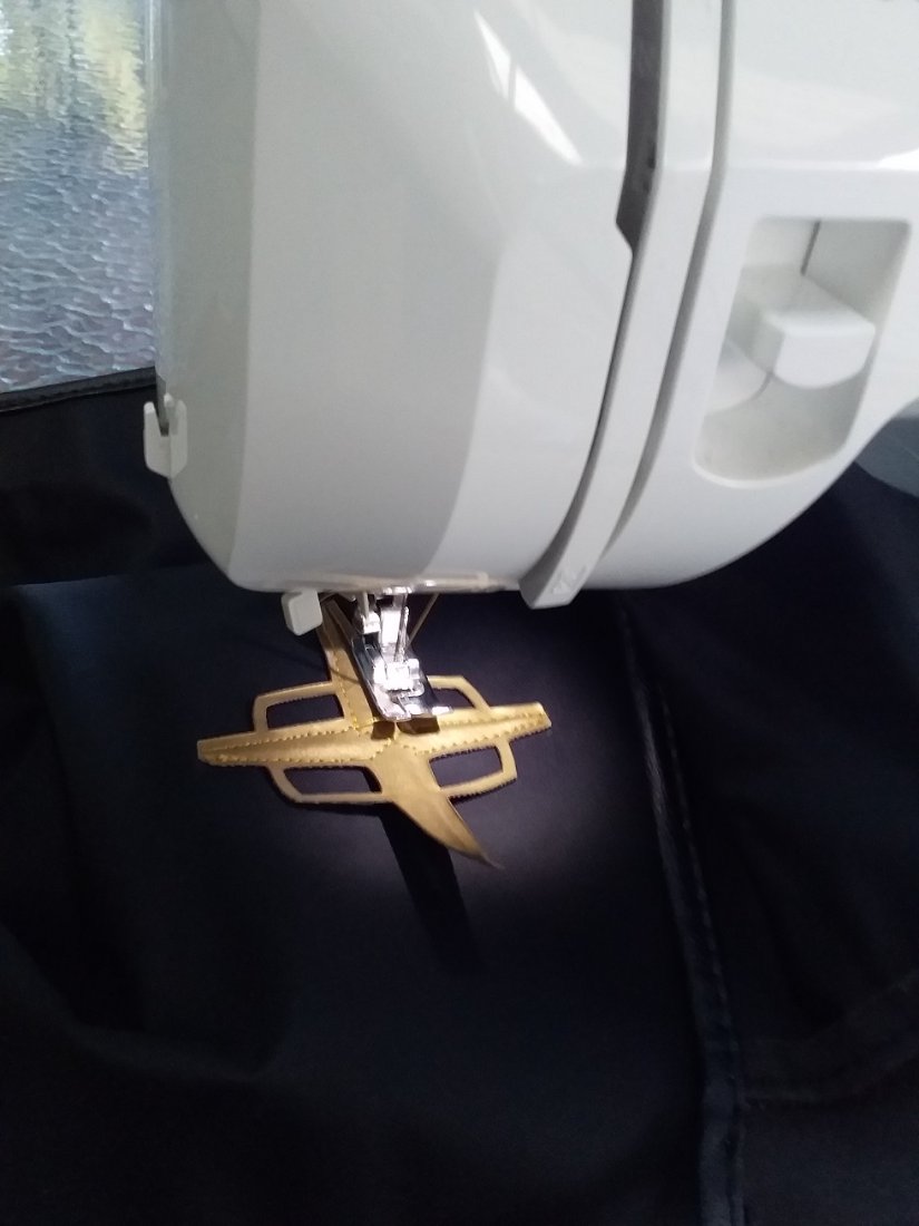

Sewing 4 point logo to new top material (logo scavenged from the original top).

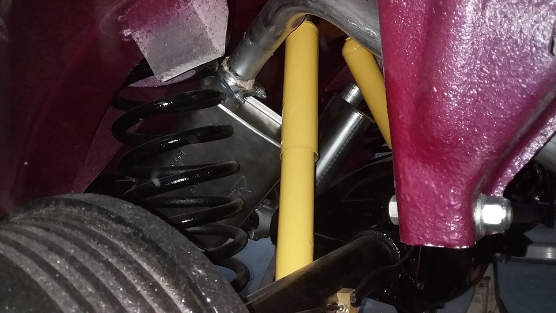

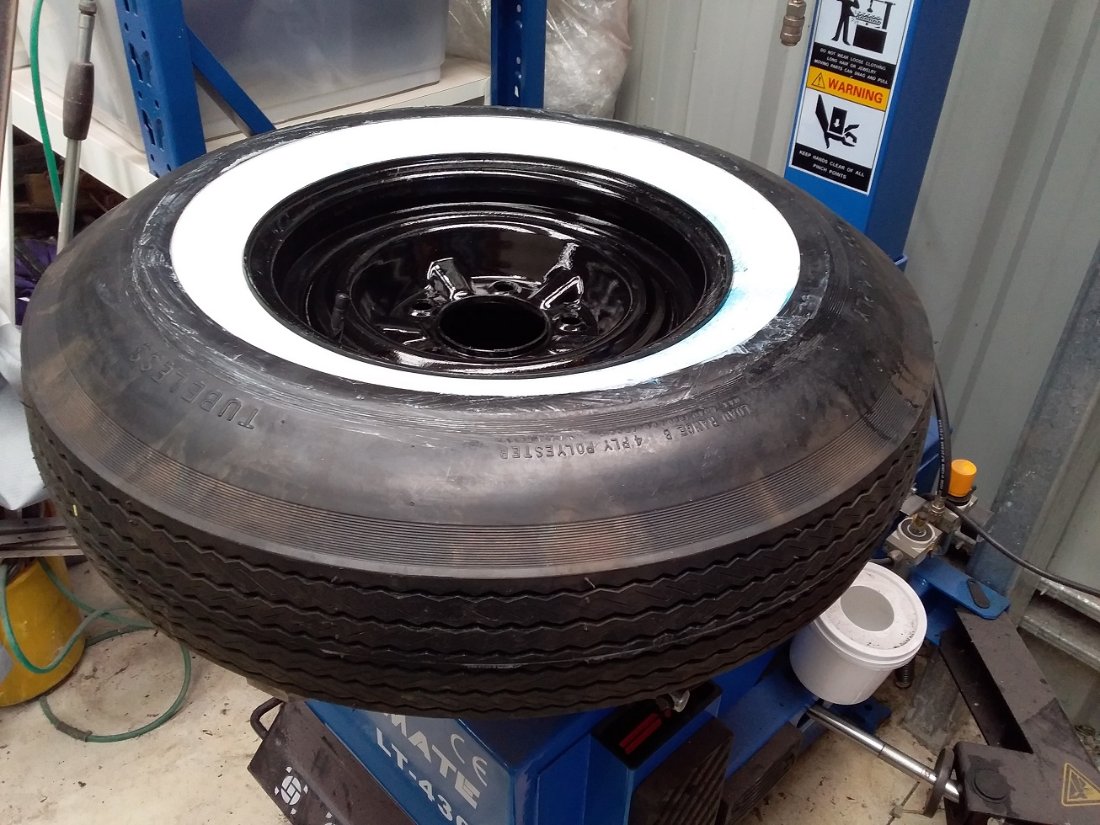

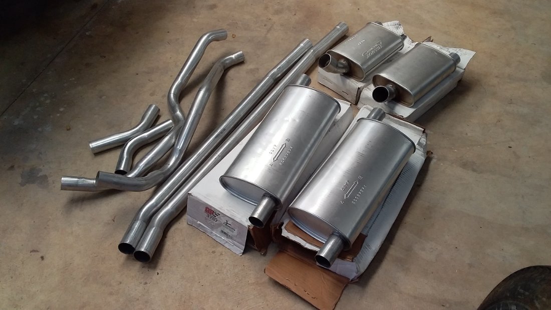

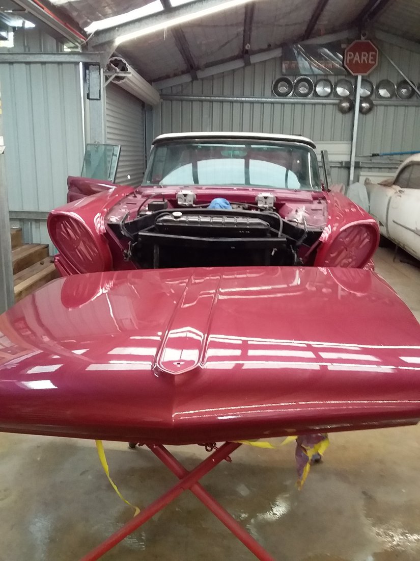

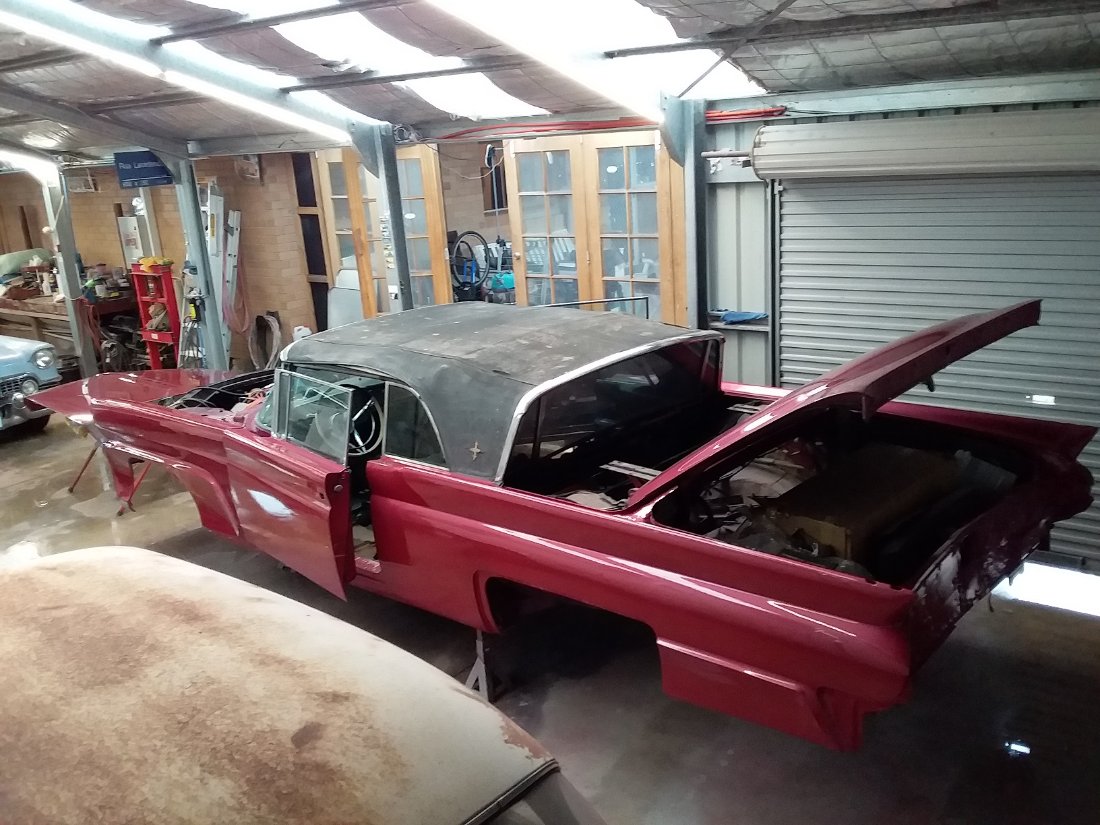

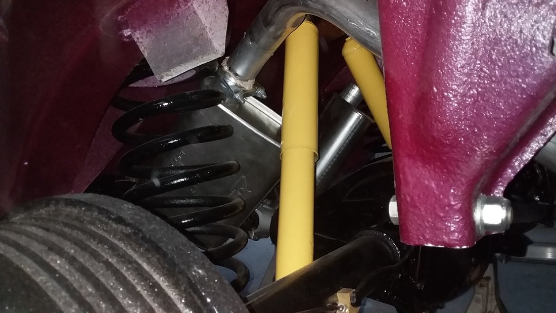

Miscelaneous photos
New muffler system quieted the beast very well
Vehicle is on the ground on its wheels, need to bleed brakes
Waiting on new bling (Replaced bumpers) coming from the USA
Stay tuned for more. Sorry for the long delay posting updates.
Hope all of you guys are hanging there well.
Cheers
Jules
Cheers
Jules
