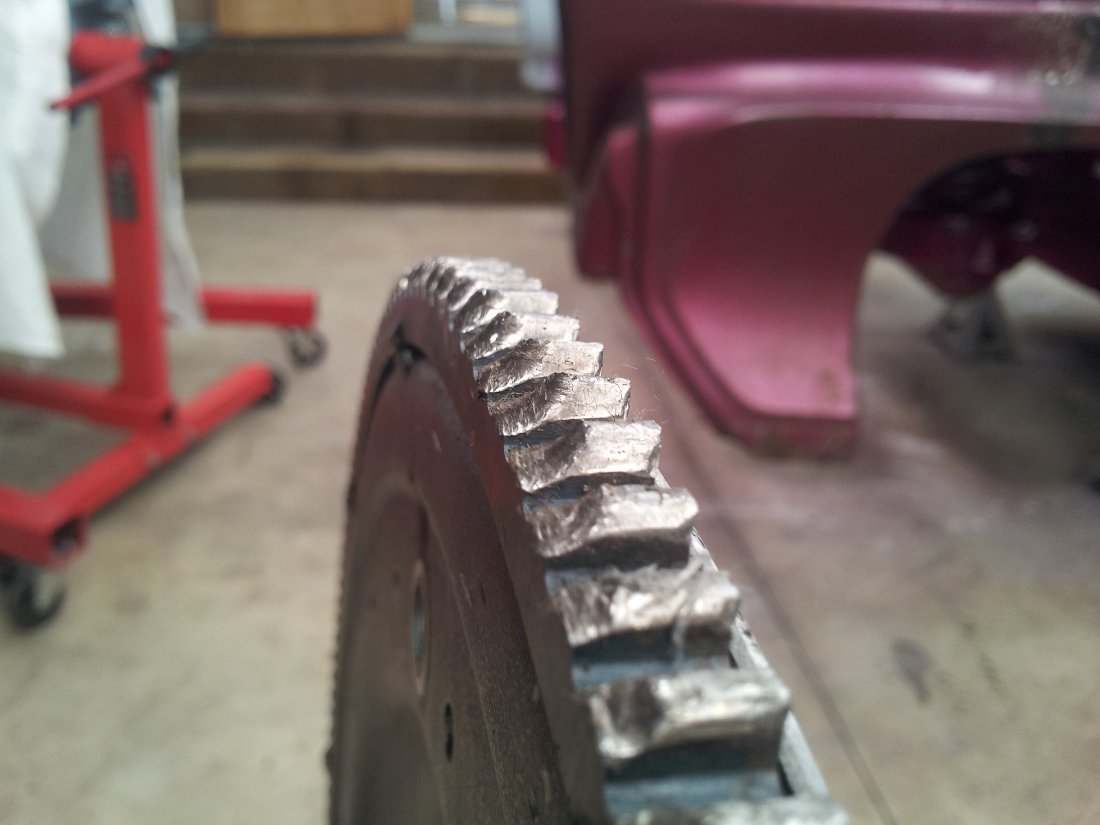

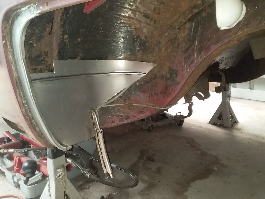

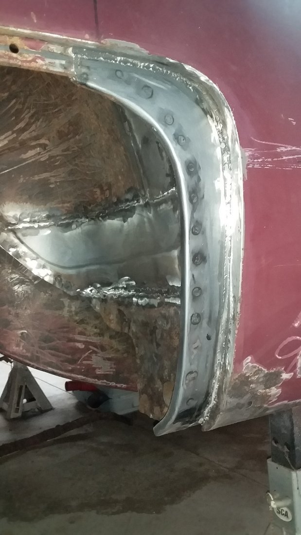

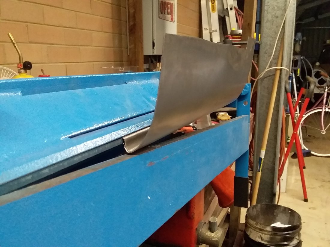

Some more photos from tasks I did in the last months.
Flexplate tooth with teeth very worn - most like from trying exceesively to crank the seized engine.

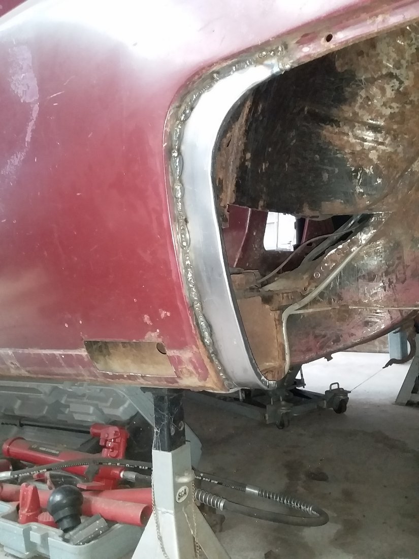

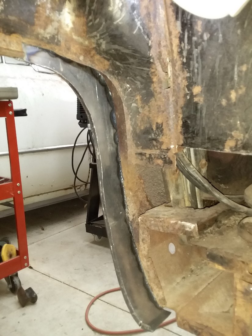

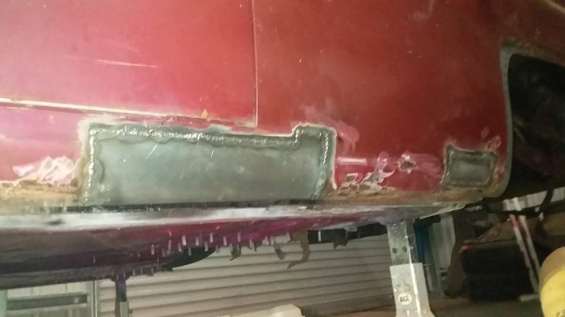

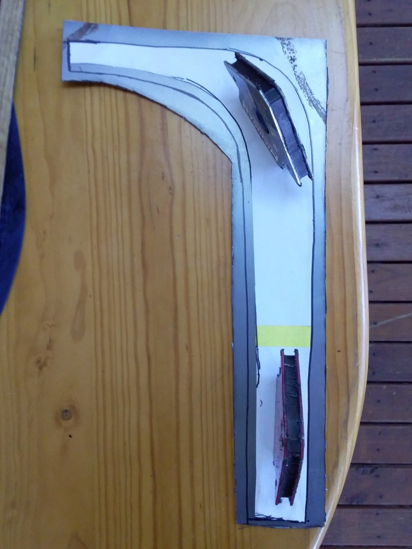

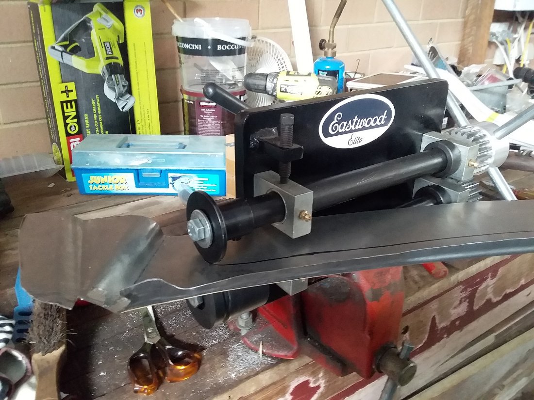

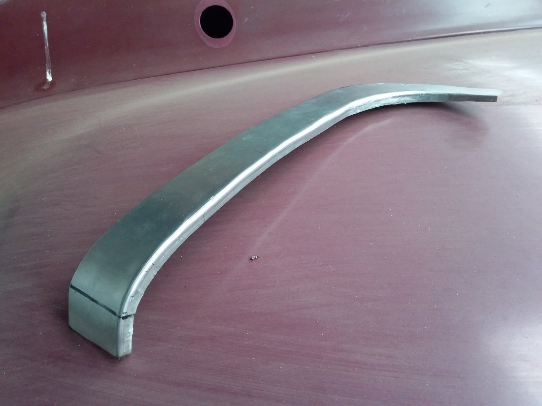

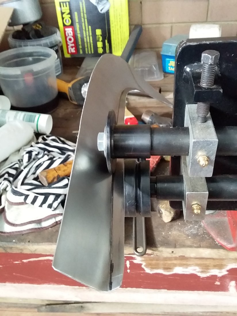

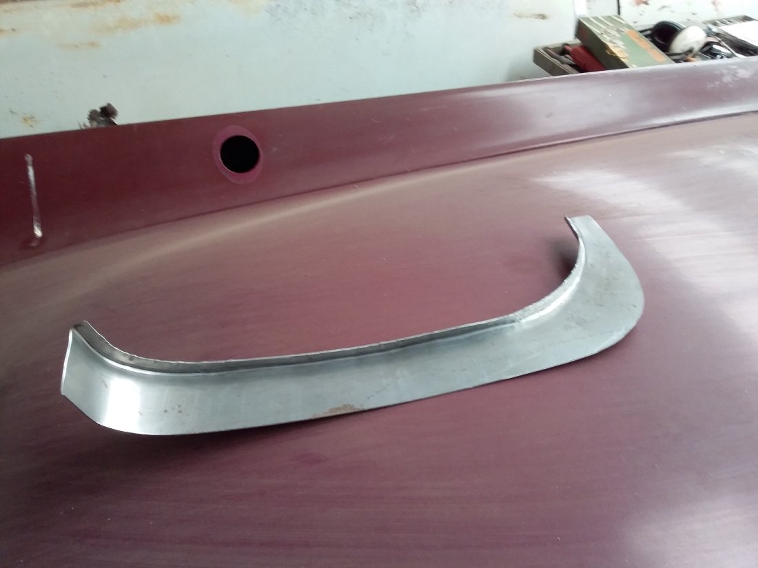

Fabricating from scratch rear wheel well panel sections.

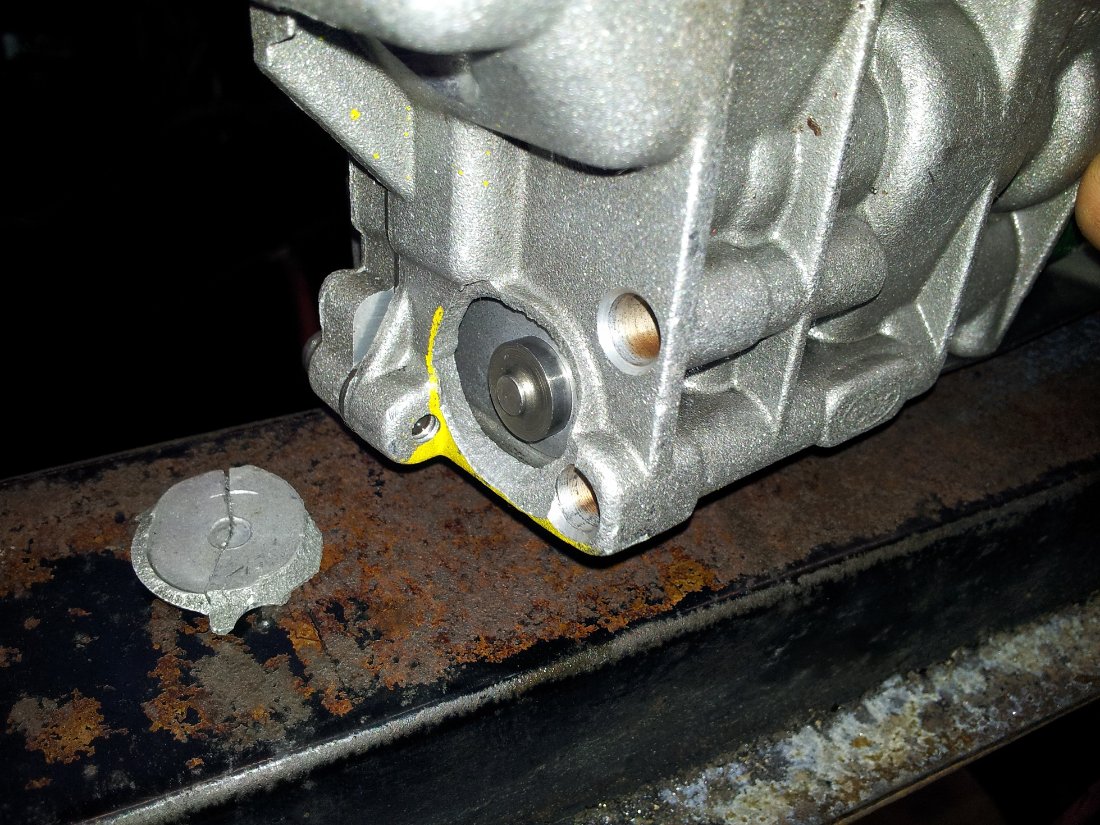

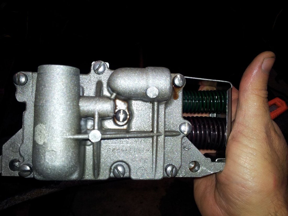

Pressure regulator had a blown part from one of the valves. I sourced a replacement body for that.
What have you guys been doing?

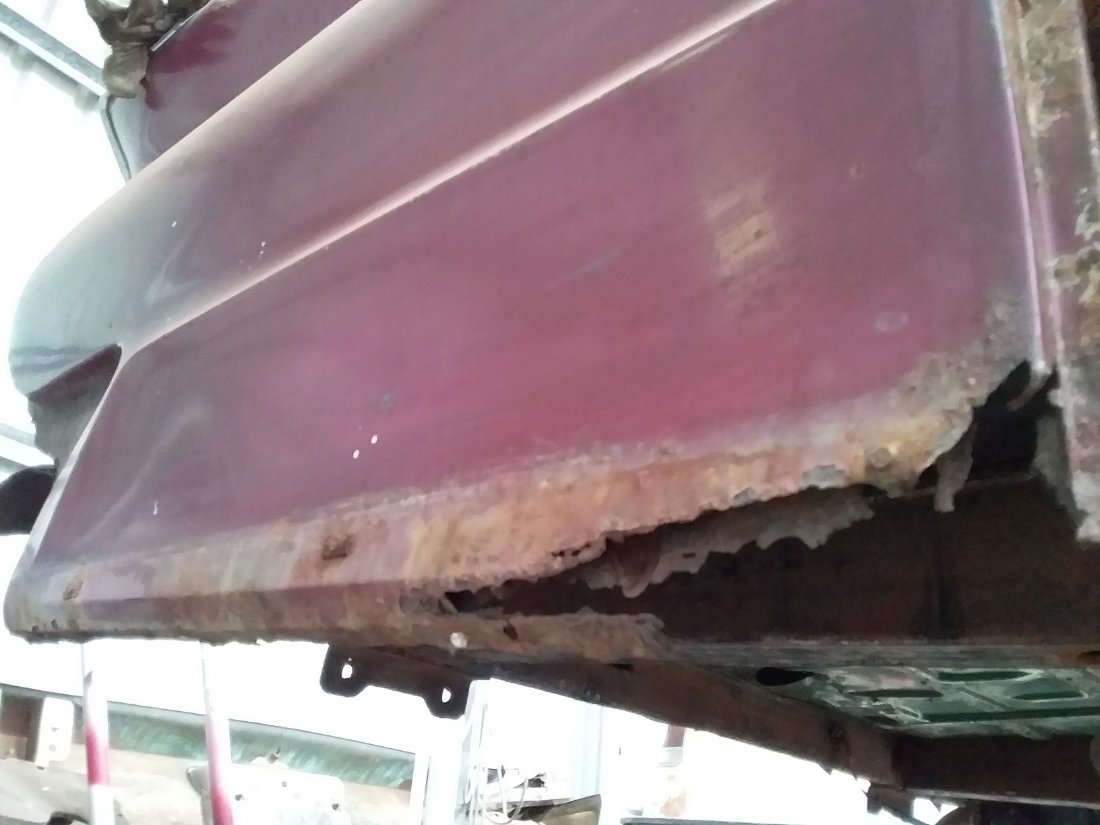

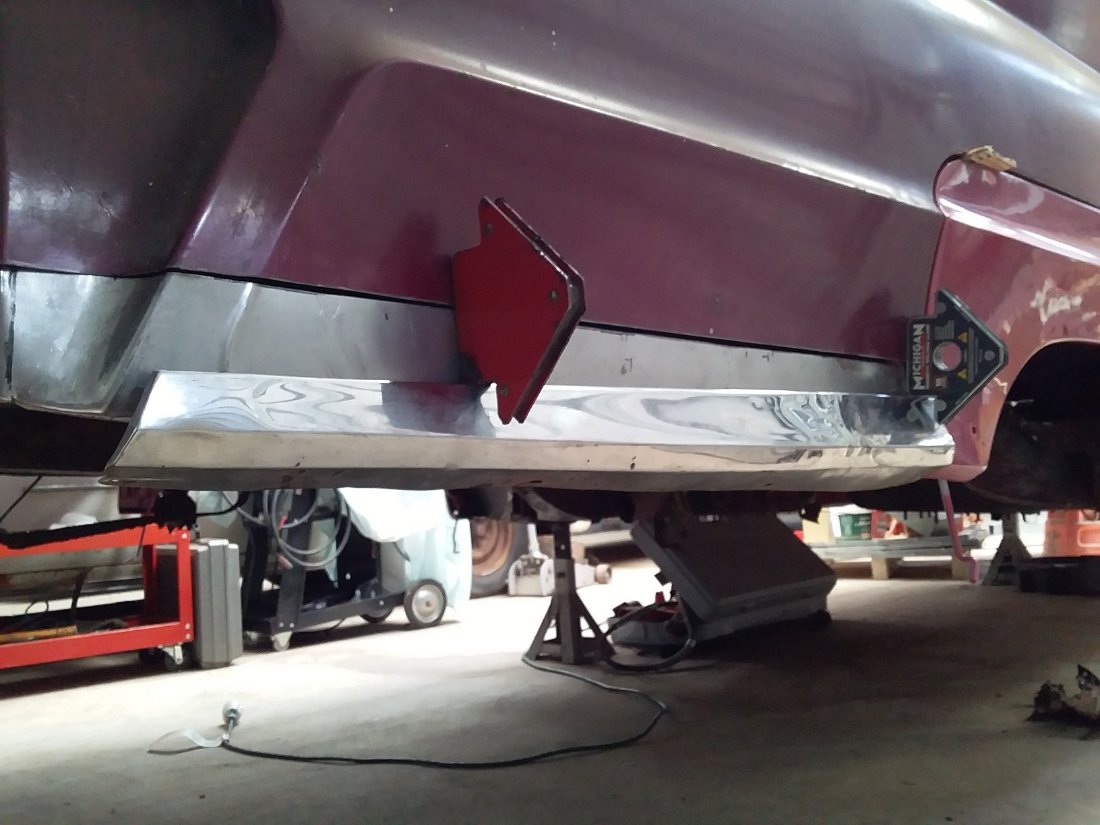

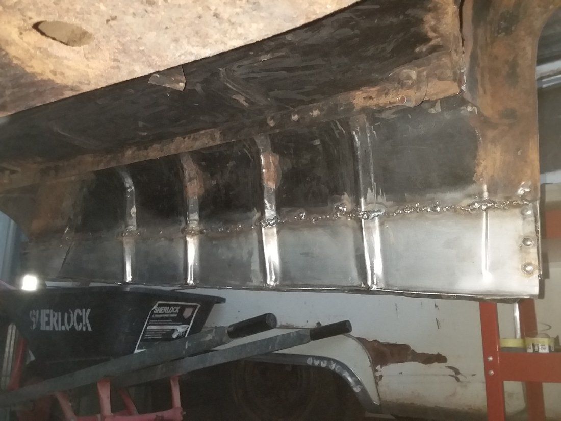

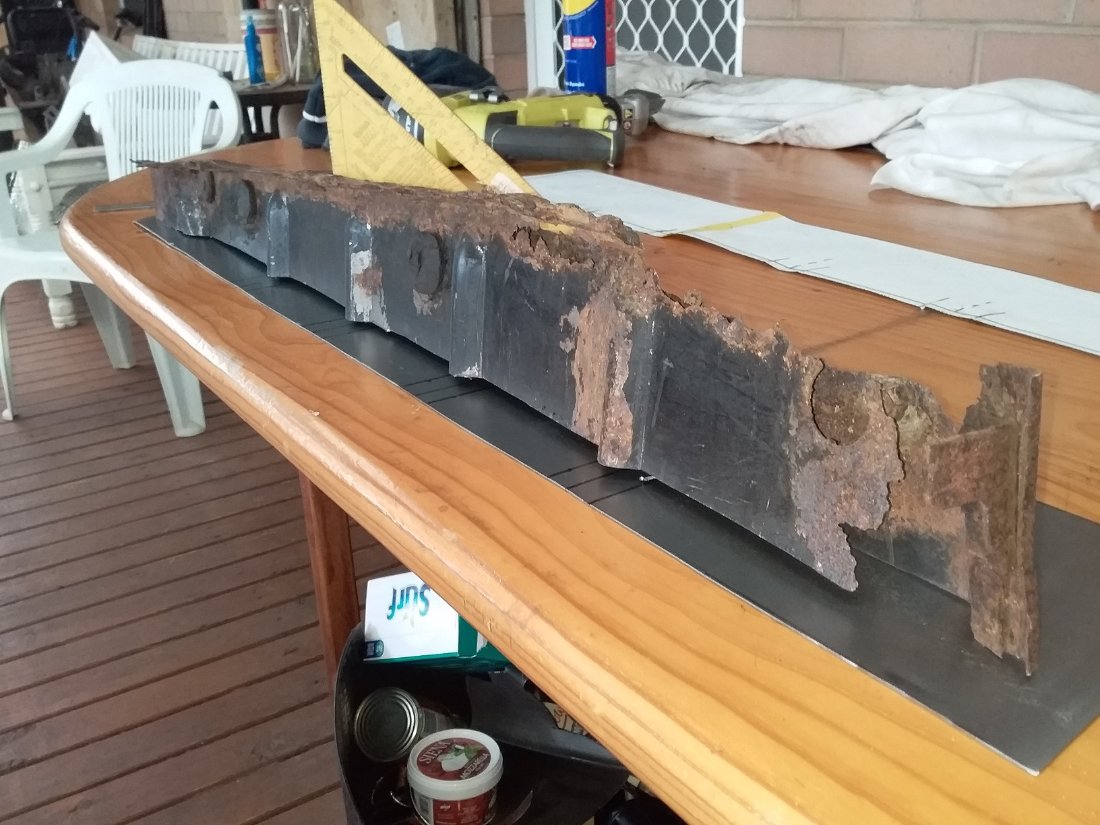

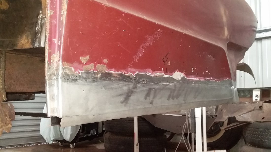

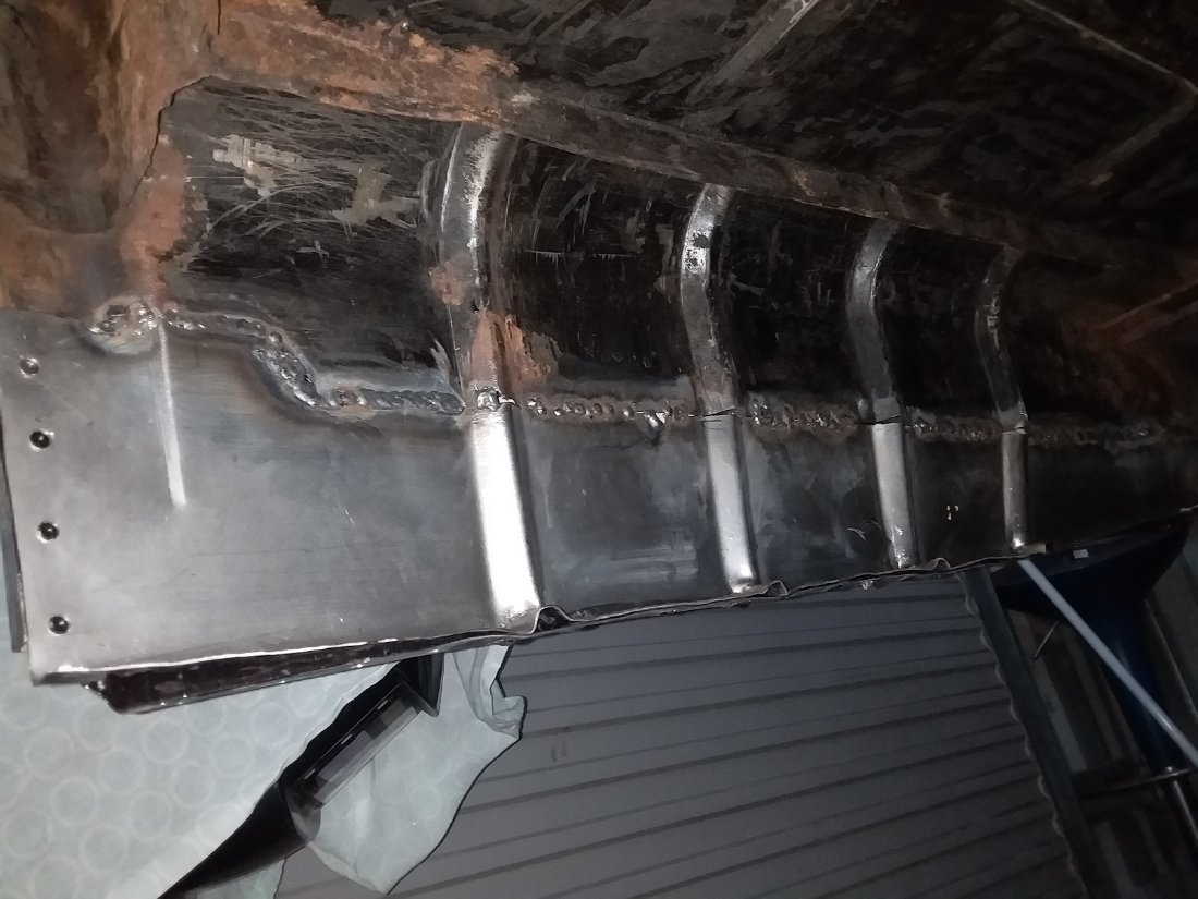

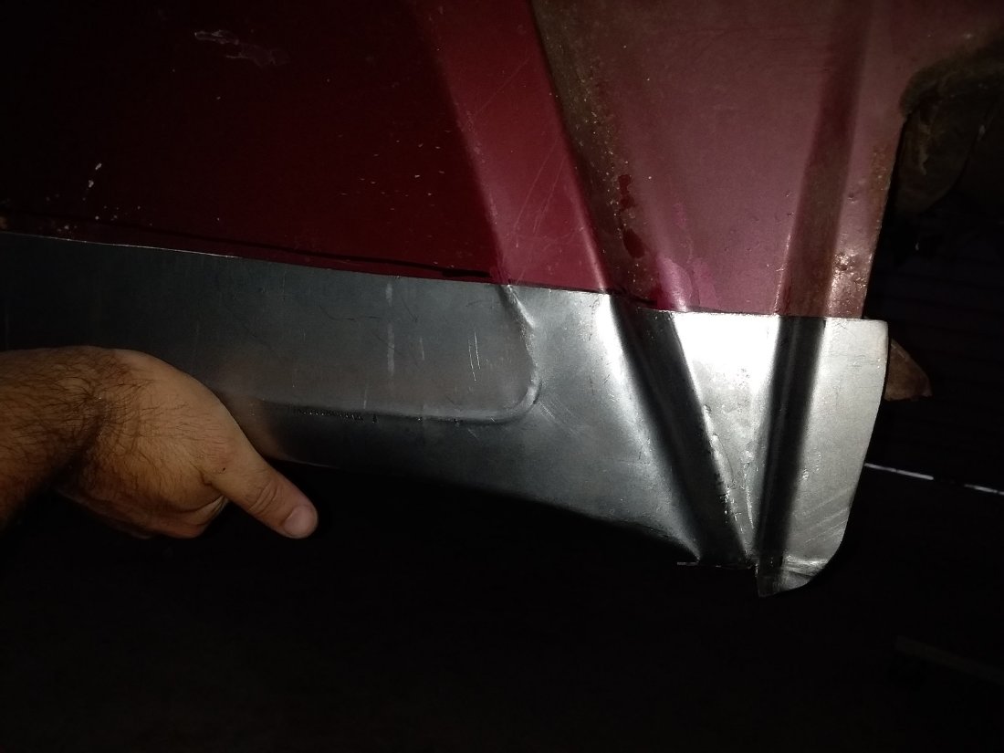

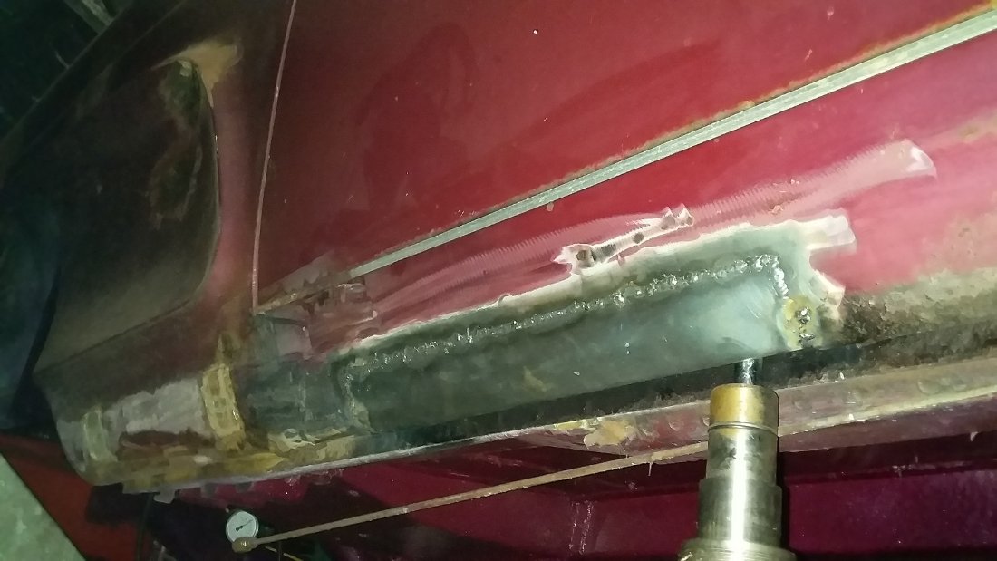

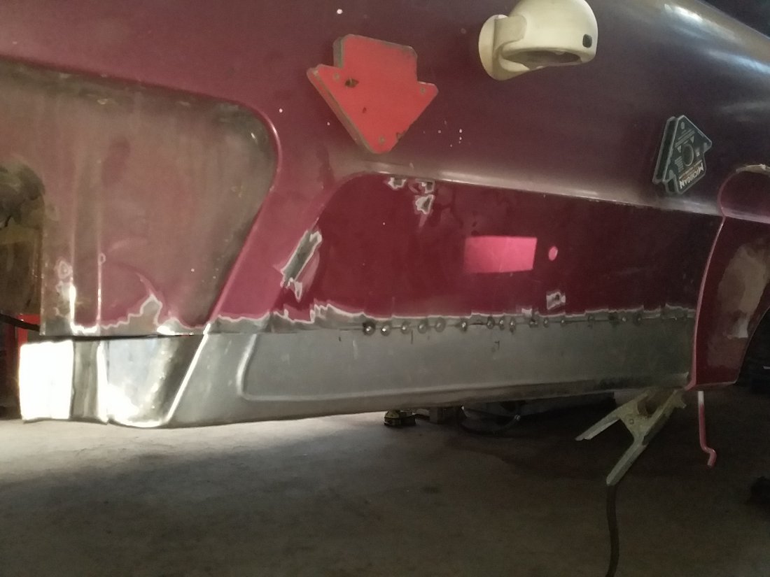

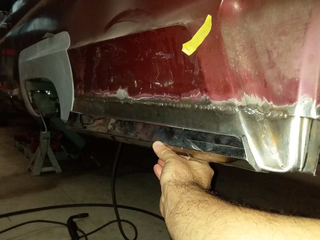

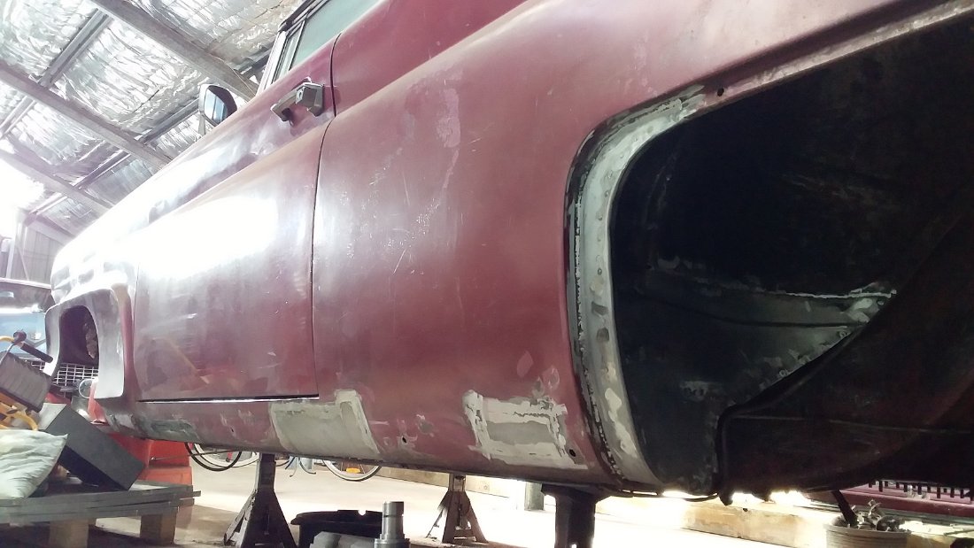

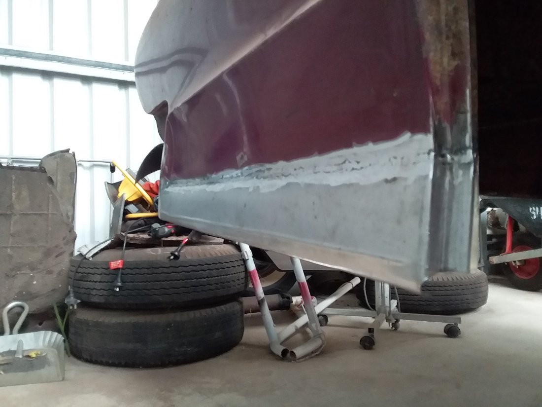

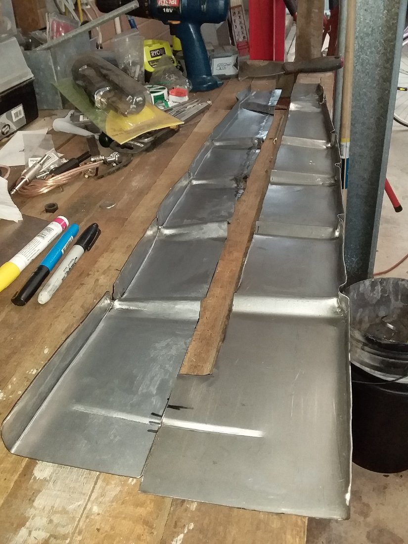

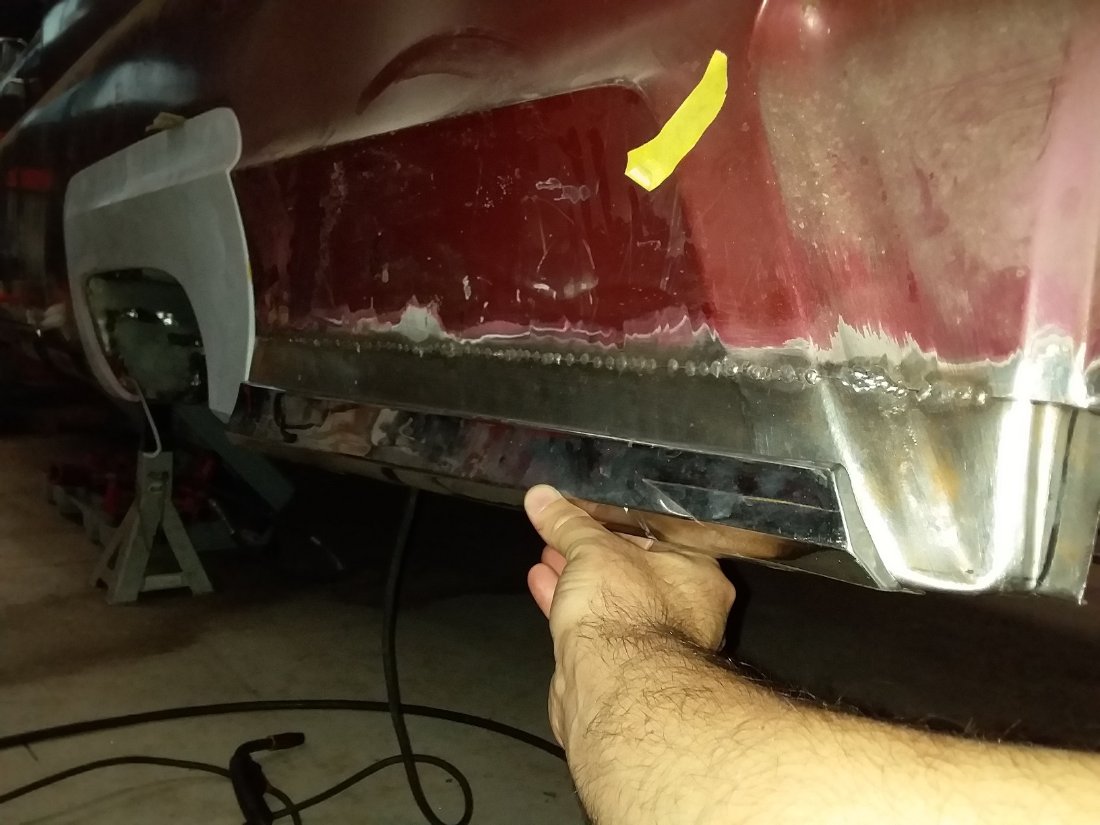

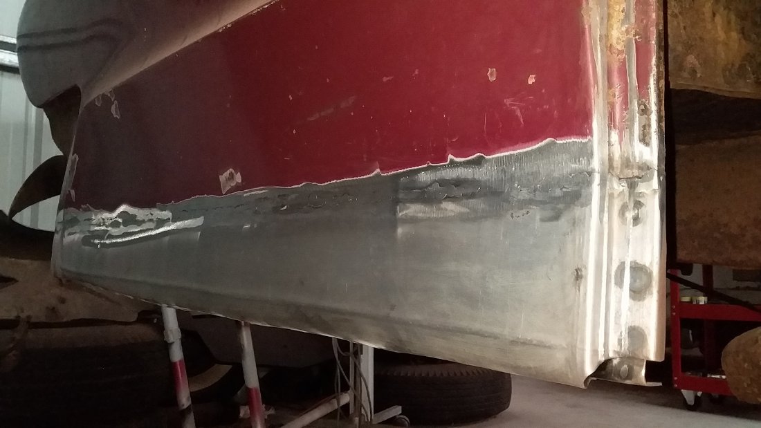

More Panelwork / Fabrication Updates
Outer bottom rear rocker sections here - Both sides
