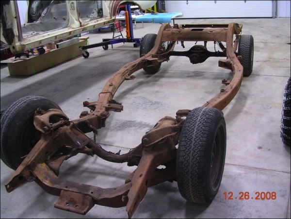

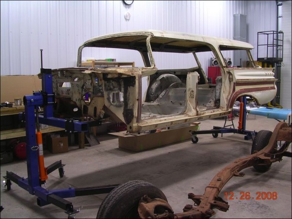

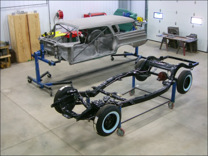

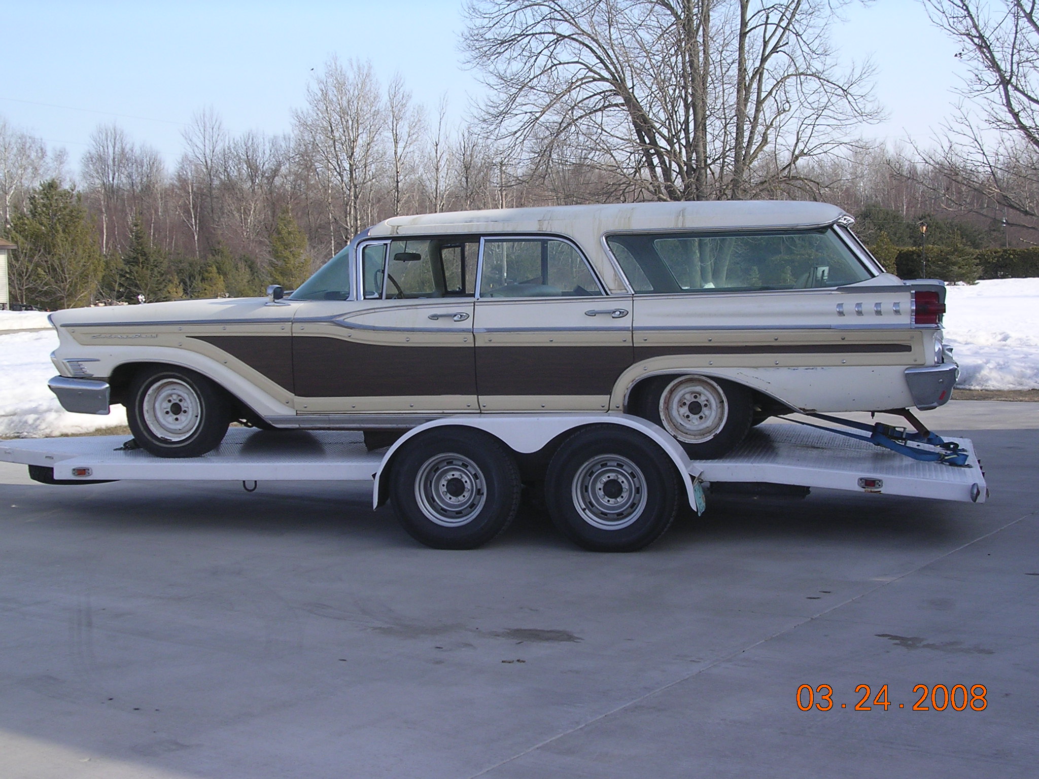

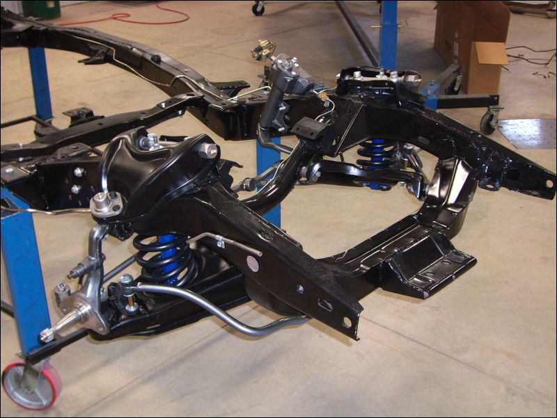

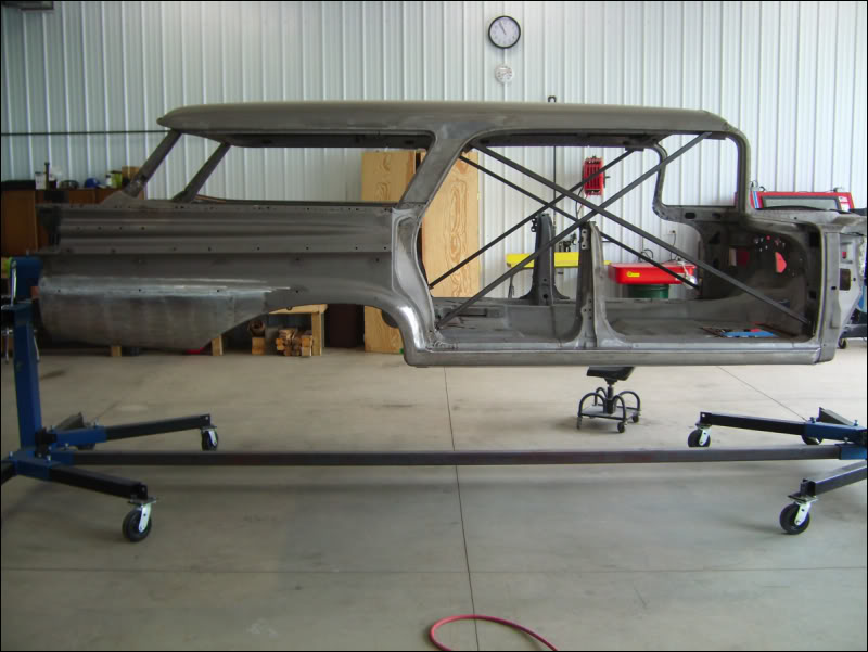

59 Colony Park Frame off Restoration

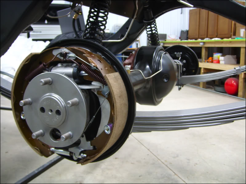

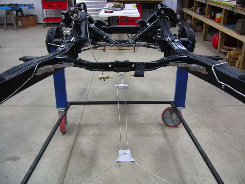

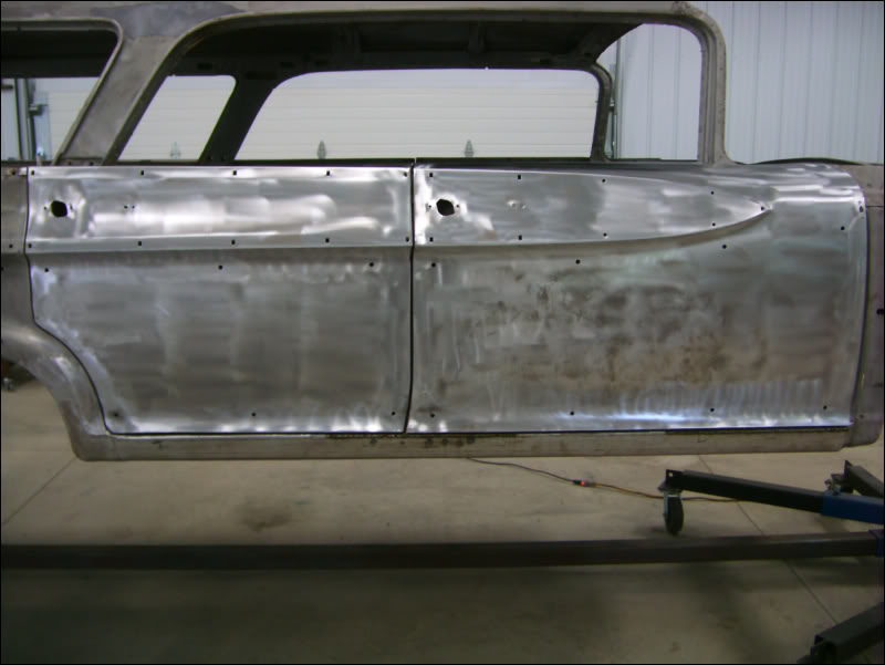

Here is the progress so far on the restoration. The engine should be done soon if the shop receives the correct pistons this time.
I'll have photo's of that soon also.

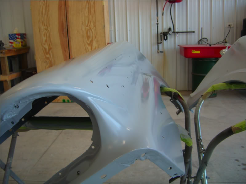

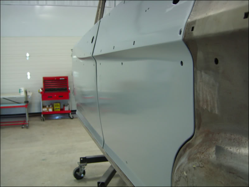

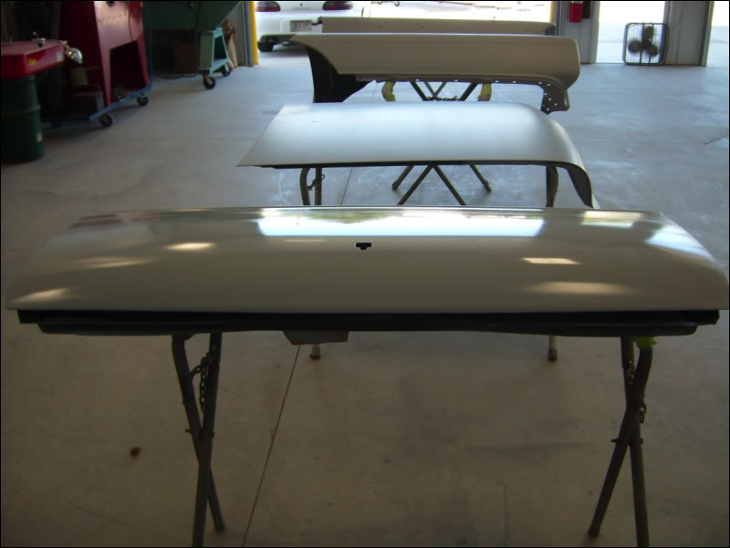

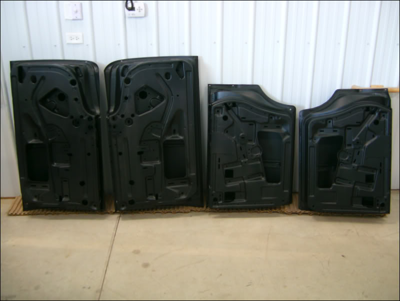

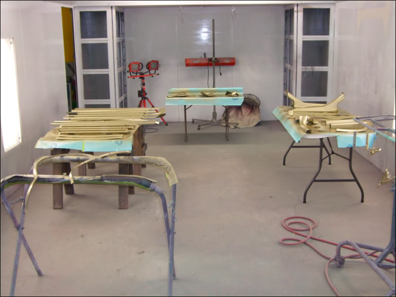

Updated photo's, and comments from my restorer.
Here are some pics of the panels in final surfacer primer. After the rest
of the car is in the same state, they will be blocked out once more with
320grit, then gone over with 600 to soften the 320 scratches, before being
sealed and painted. When they are sanded at that point and wet down, they
will really look like glass.

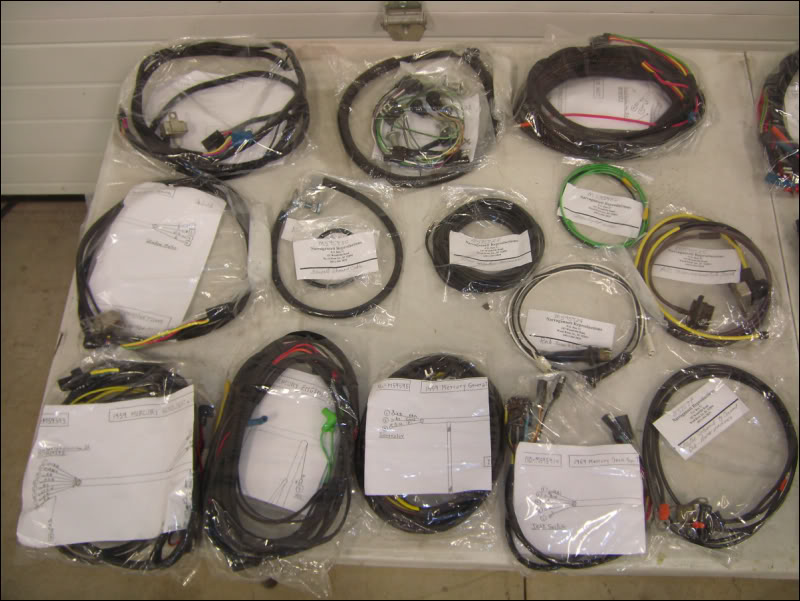

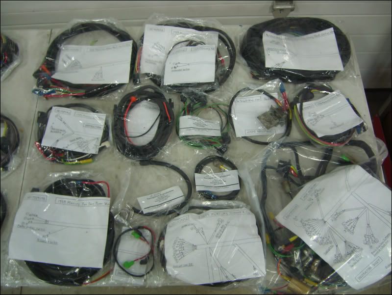

Your wiring also came in from Narragansett and I am thouroughly impressed.

Nice! All lovely new wiring...!

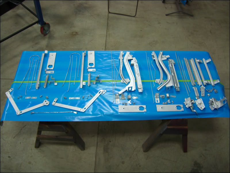

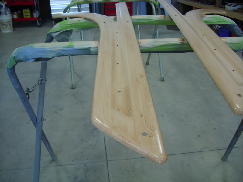

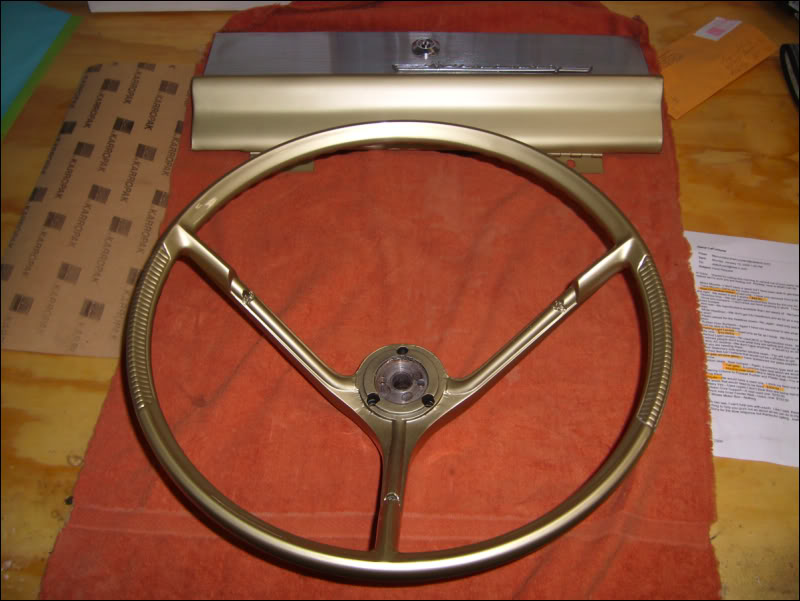

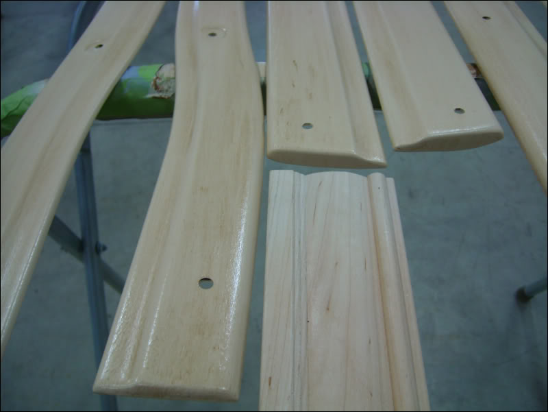

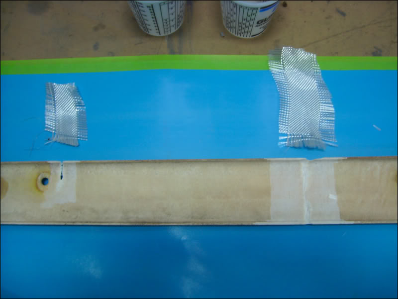

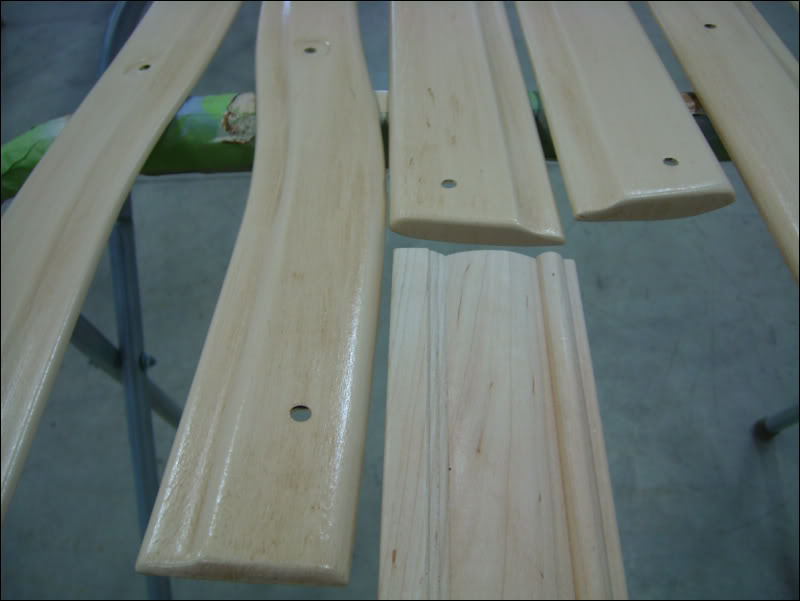

Restoring the most fragile parts of the car....
As my restorer states...
the pics just don't do justice to the graining effect. In person they look
very much like real maple.
