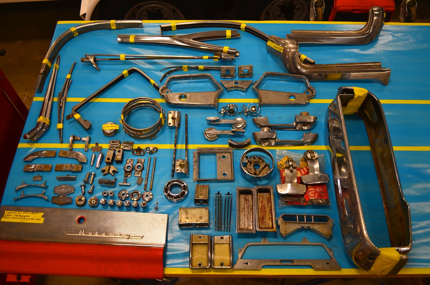

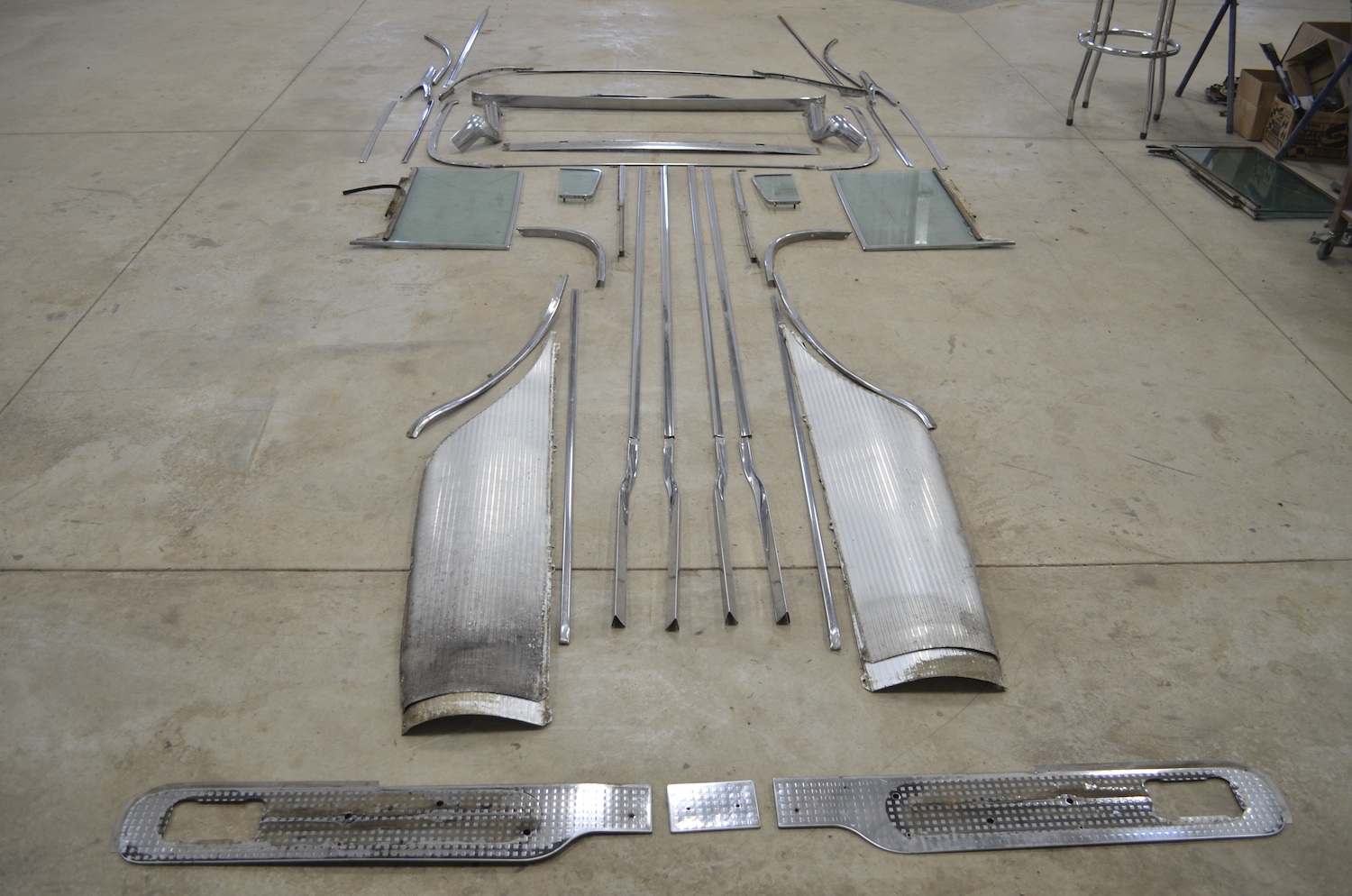

Lots of brightwork to get chromed / polished

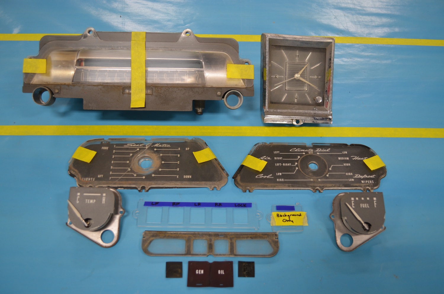

dash controls

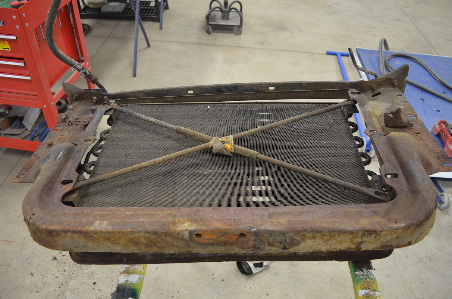

radiator support

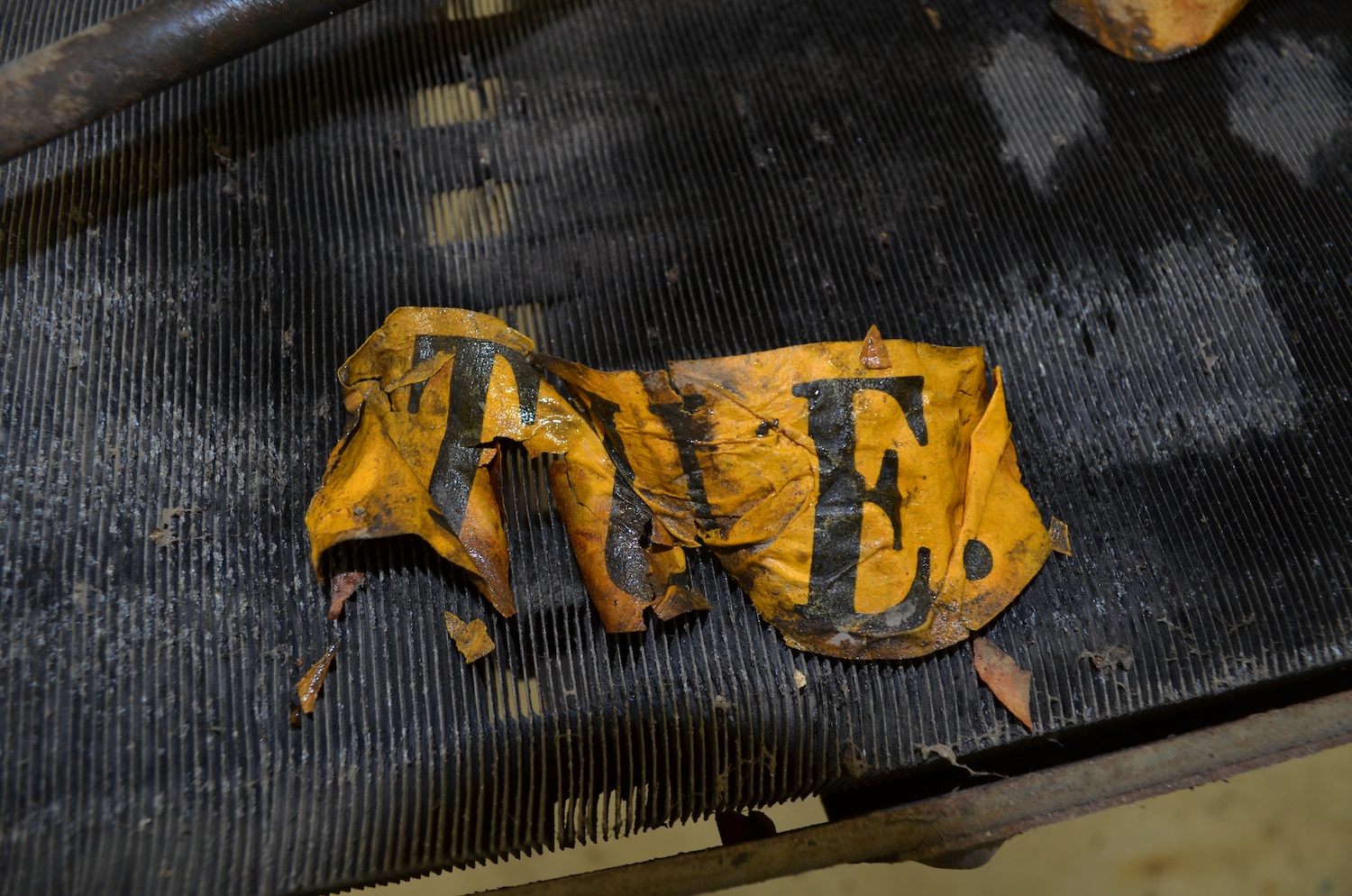

My guess is that it was done on Tuesday

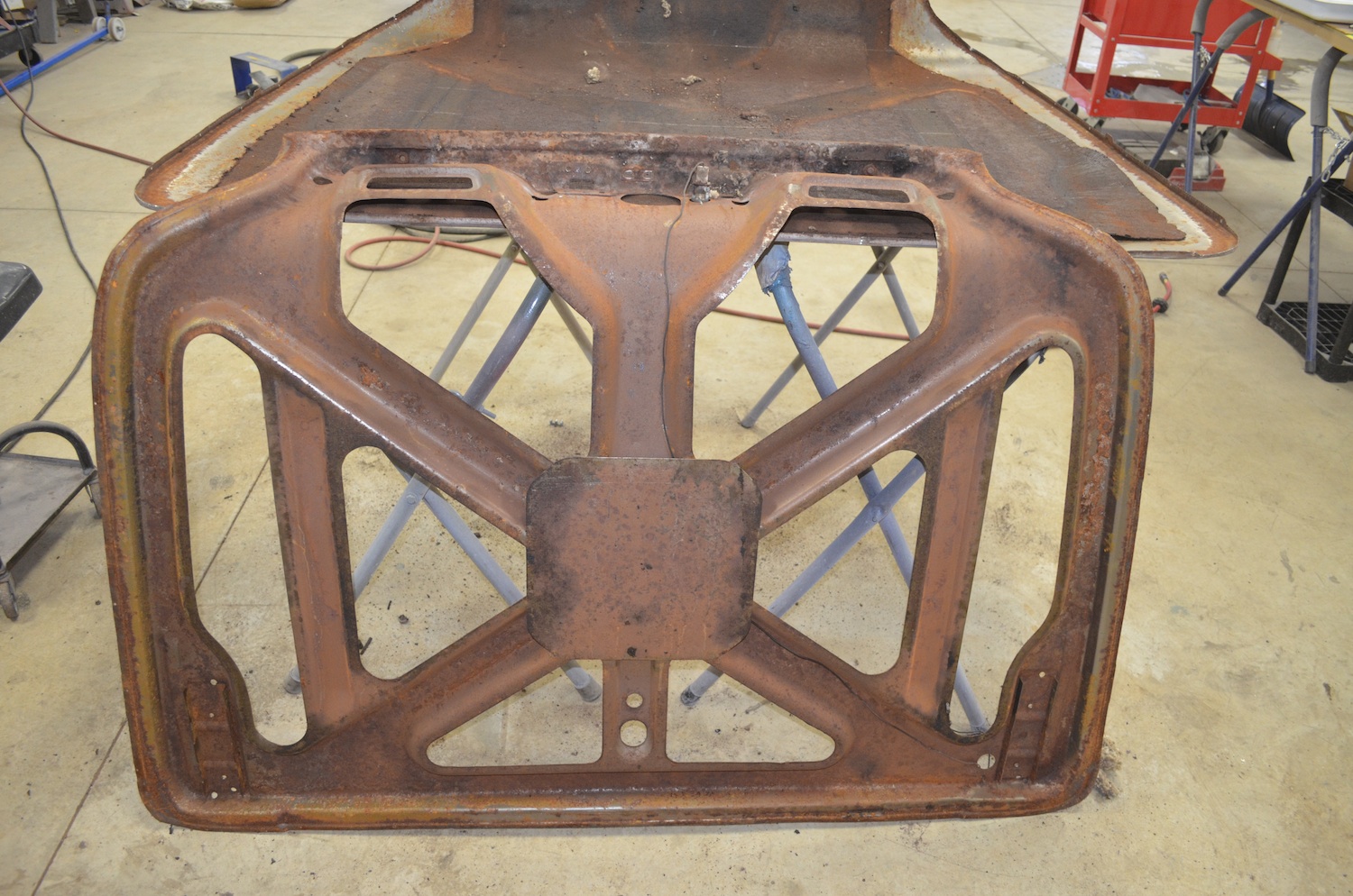

Skinned trunk lid, notice pad still on the lid.

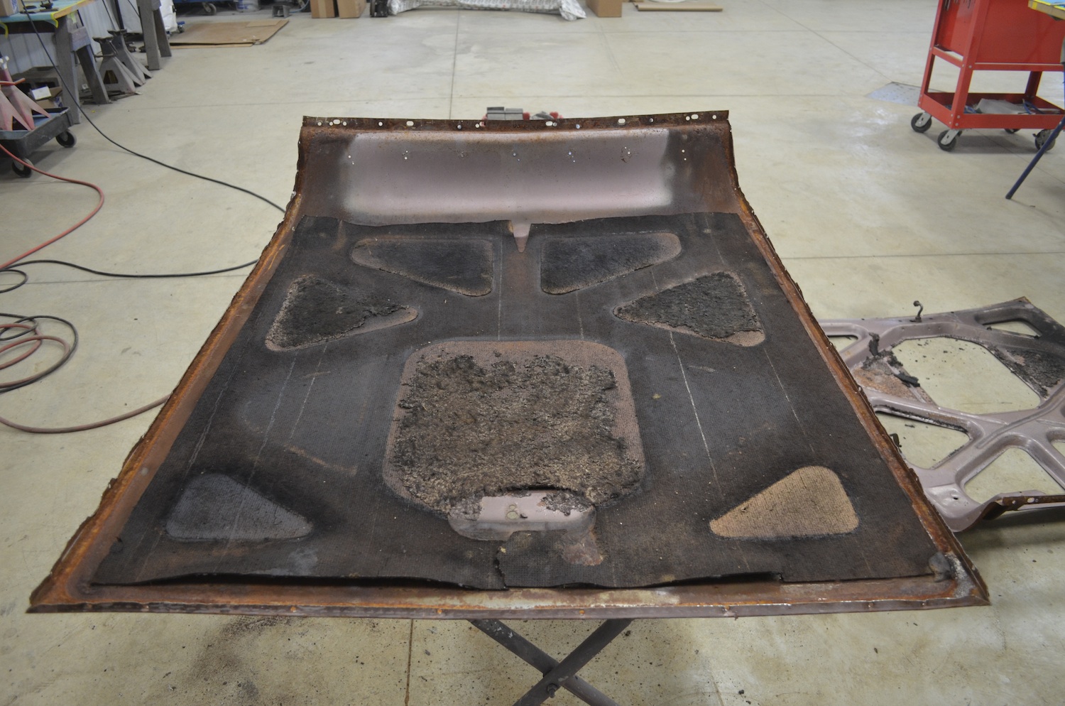

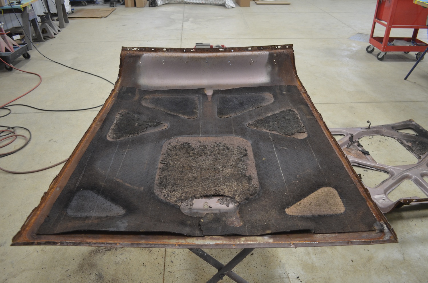

Skinned hood

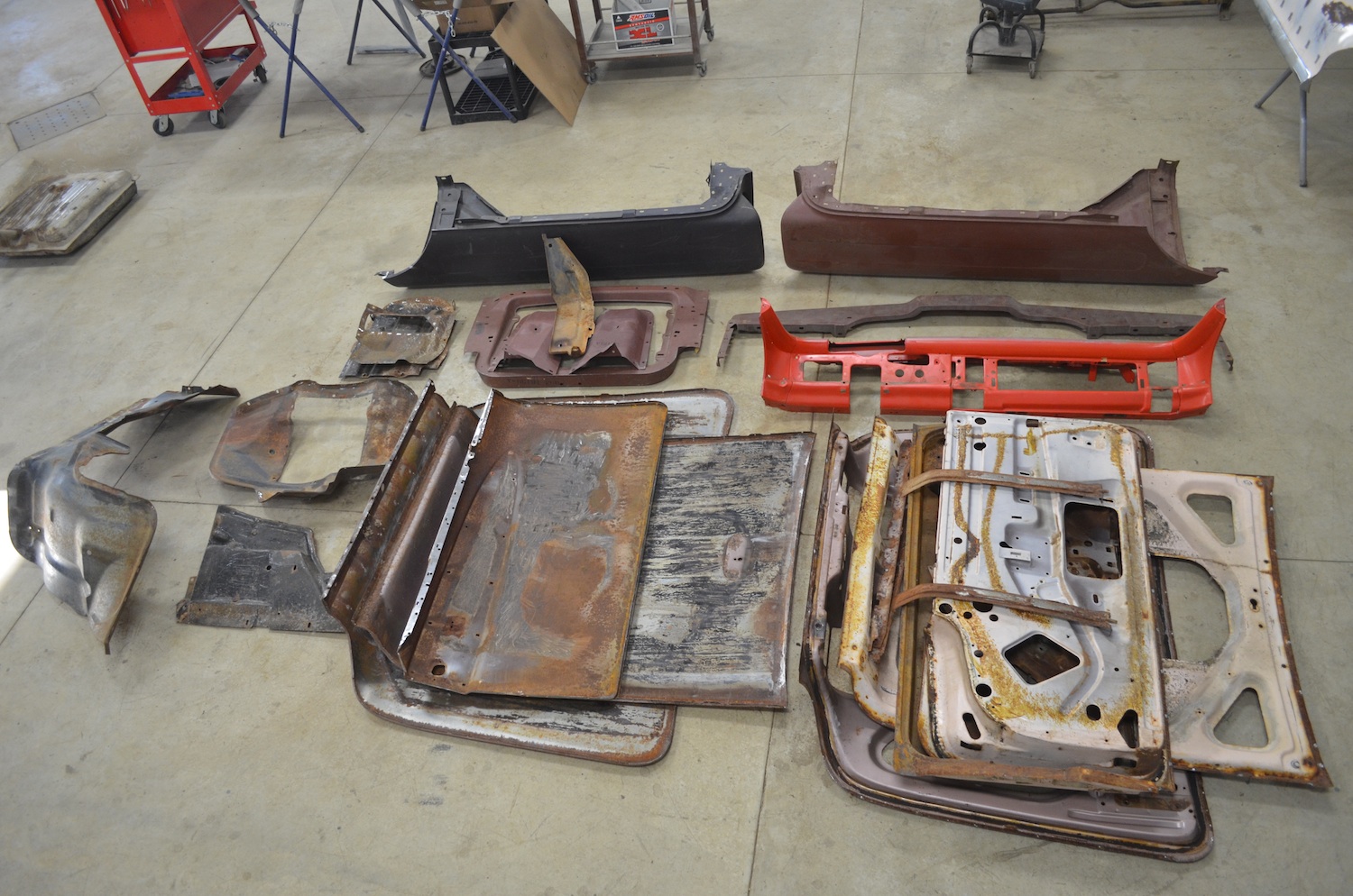

All the skinned parts.

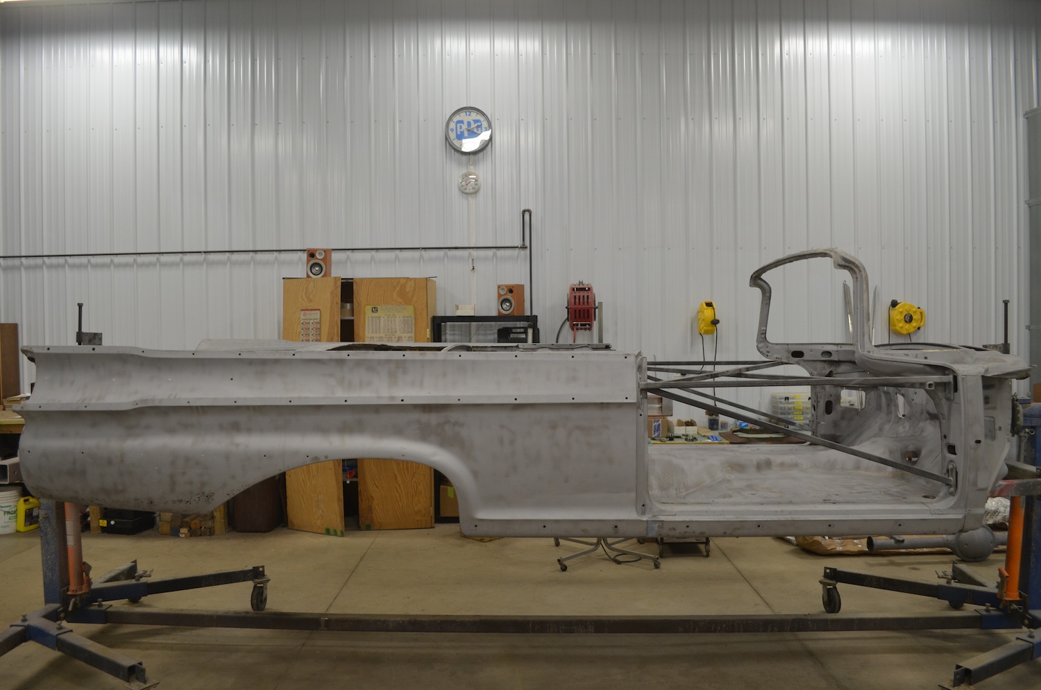

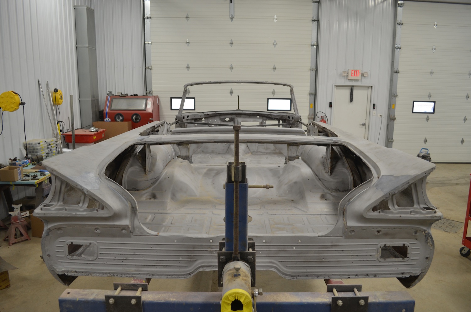

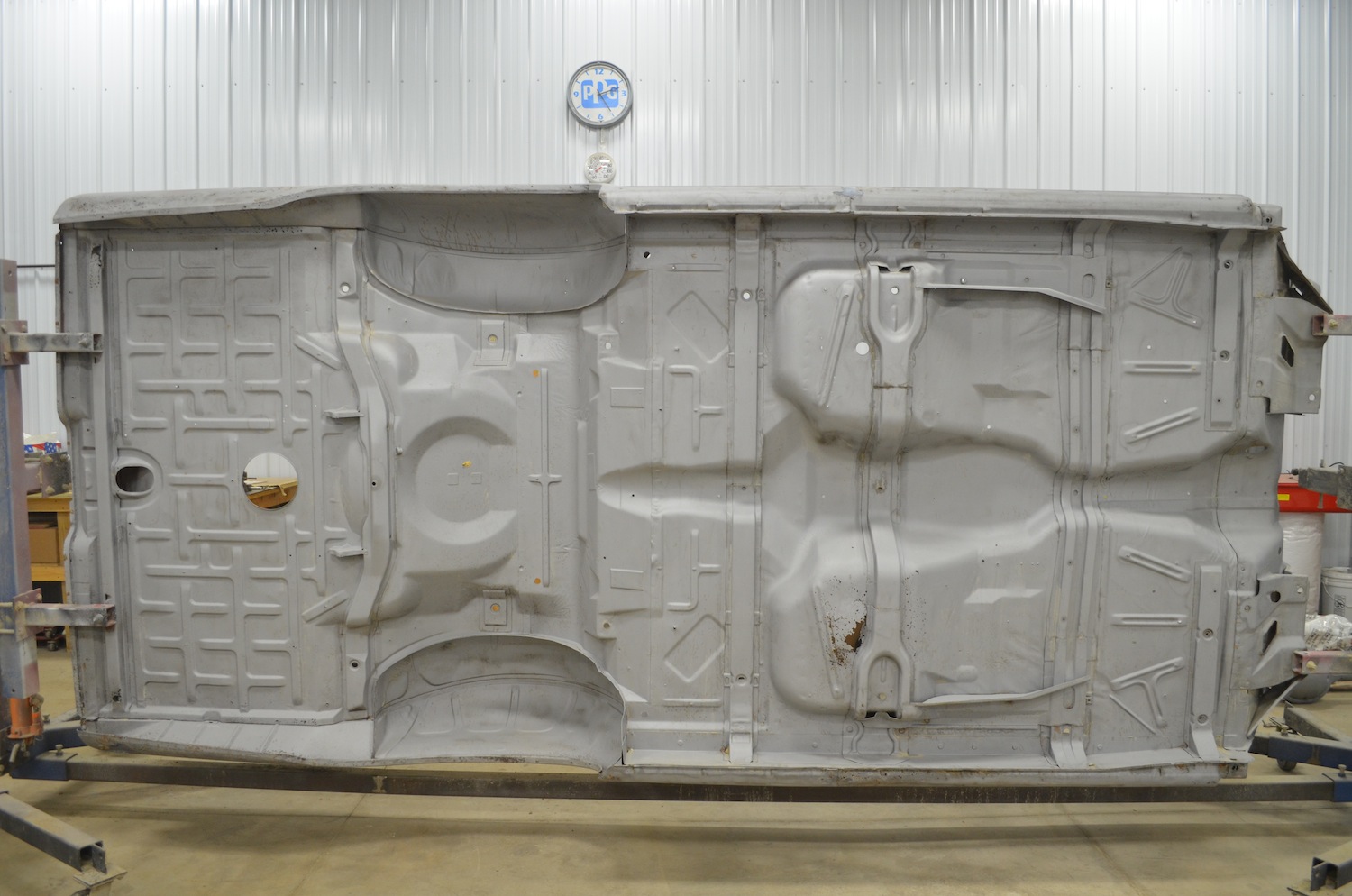

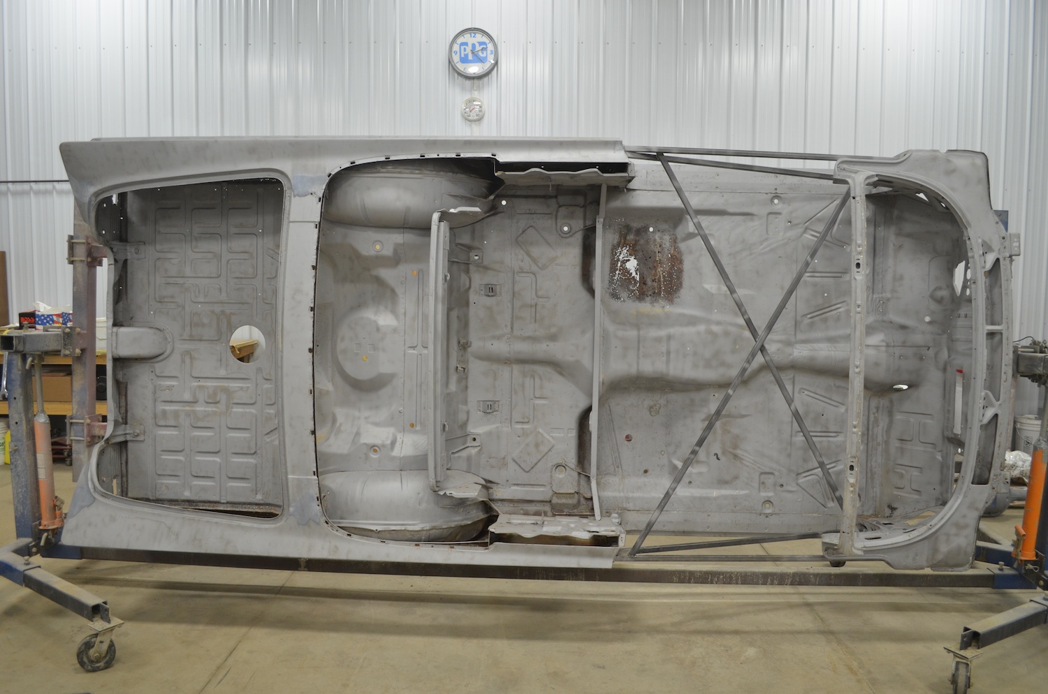

Blasted body came back today. We used a different method to do this car, and were very pleased with the results. Here is a link to what was used: http://www.rdsamerica.com/DustlessBlasting.htm.
On the wagon we used two different methods, soda blasting that doesn't take off rust and leaves it really smooth where you need to wash it with soap and water and rough it up before priming. The other, sand that was pretty rough and takes off more steel then necessary, so you have to really lay on the primer to fill in the profile.
Besides the pin holes, rust spot, and a crease above one rocker panel, this car was in much better shape than we hoped for.

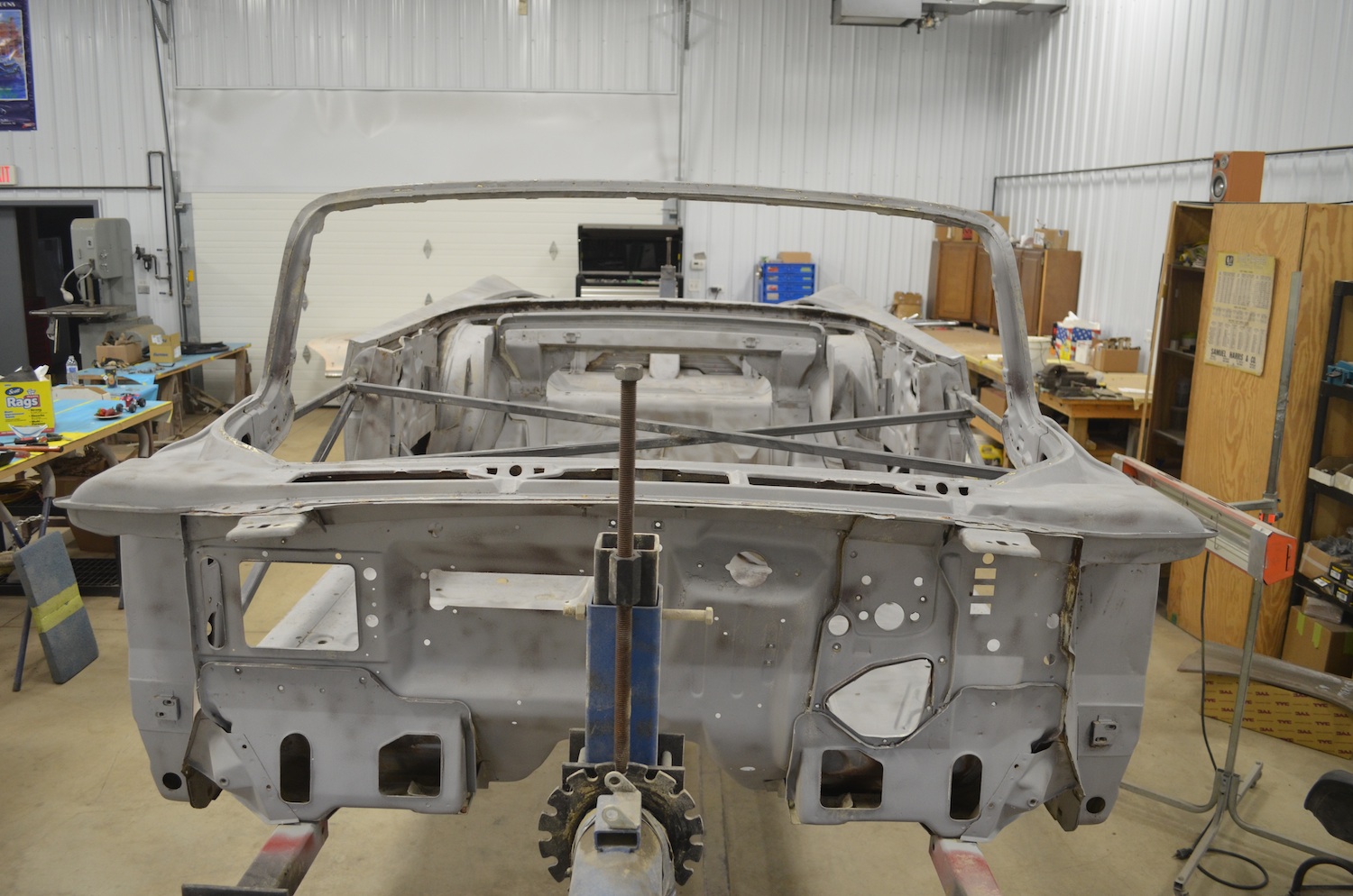

Blasted front view
Blasted overhead shot

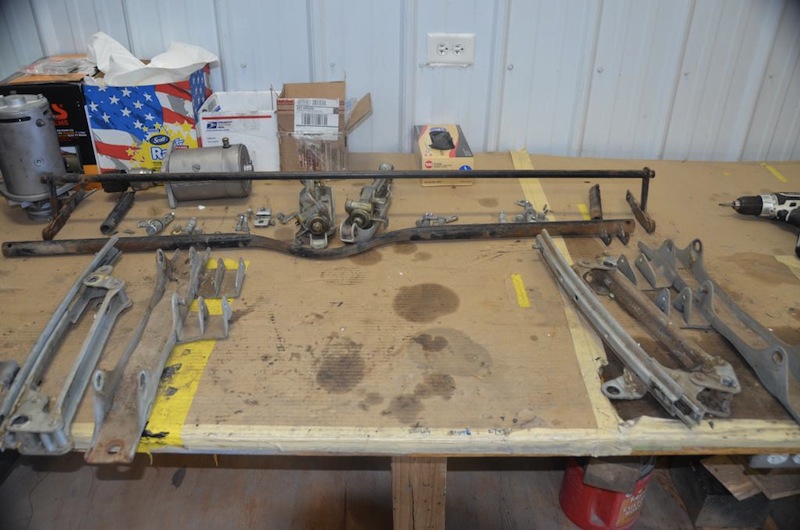

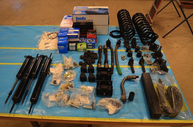

Suspension

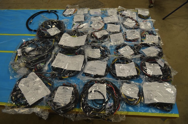

Wiring. As with the Colony Park wagon, very impressed.

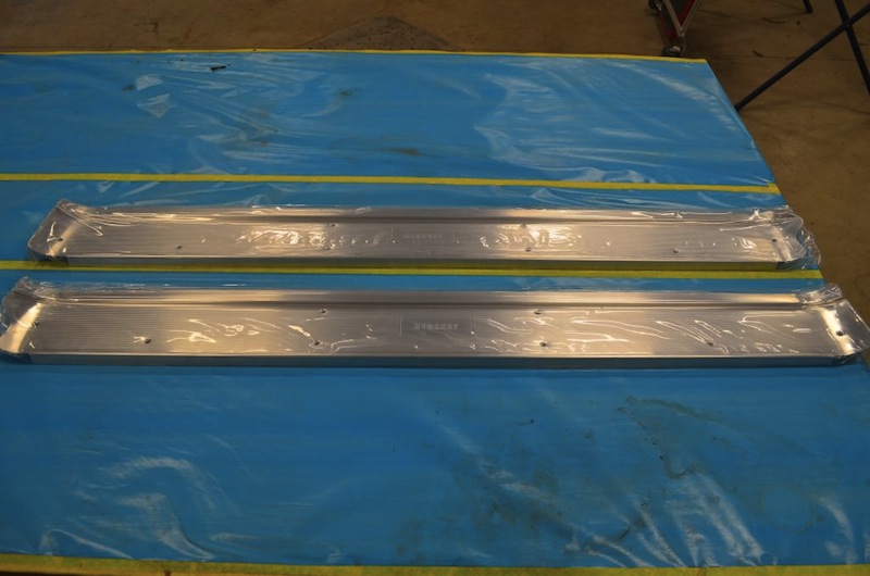

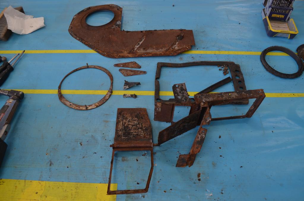

Door scuff plates

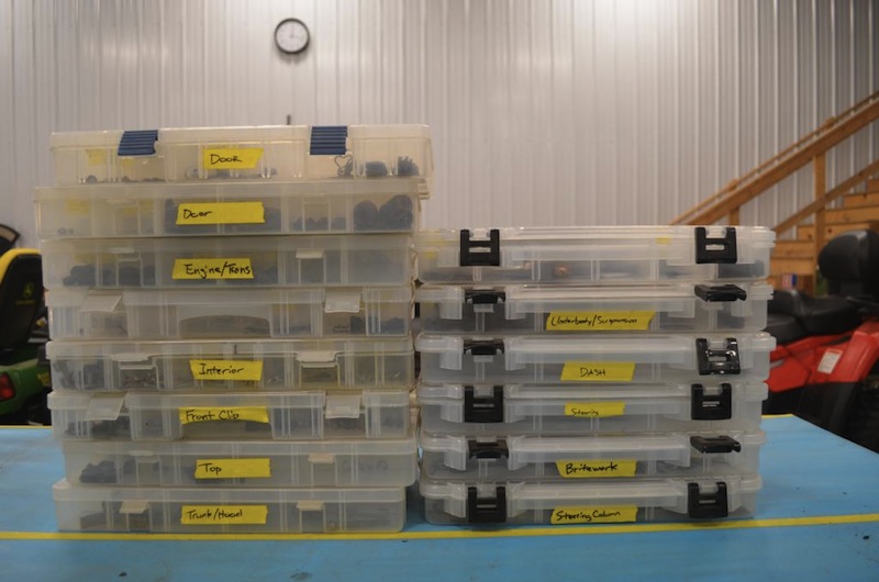

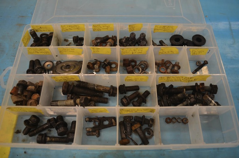

Misc. screws, bolts, etc. for plating. All nicely labeled.
A bunch of containers for plating

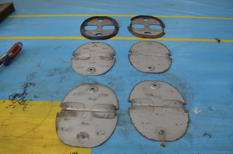

Disassembly of the memory seat mechanism

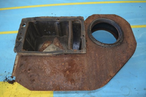

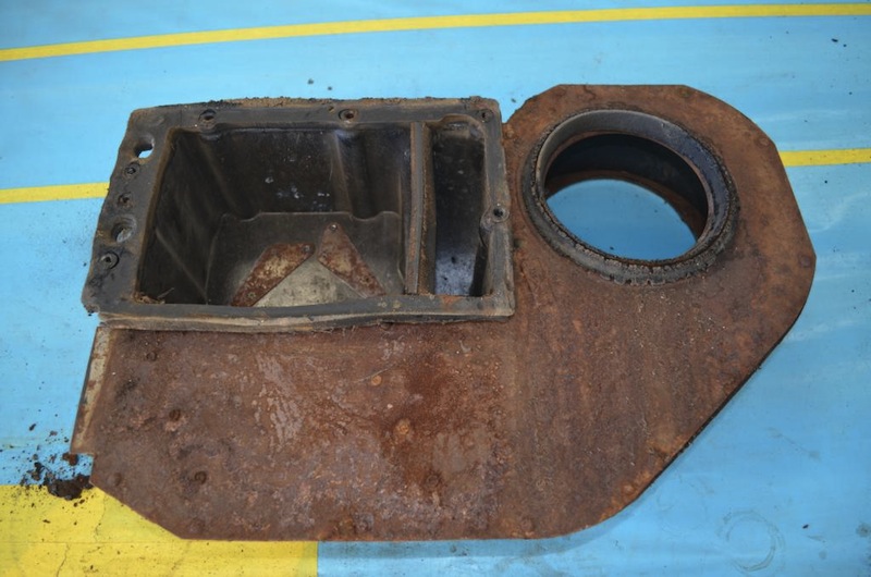

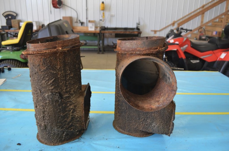

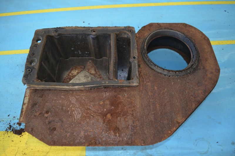

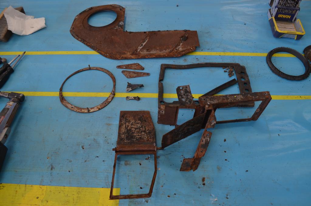

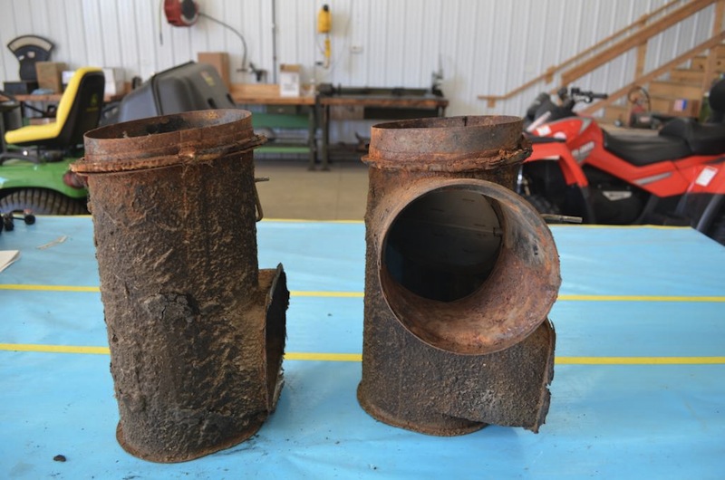

Venting / heating system disassembly

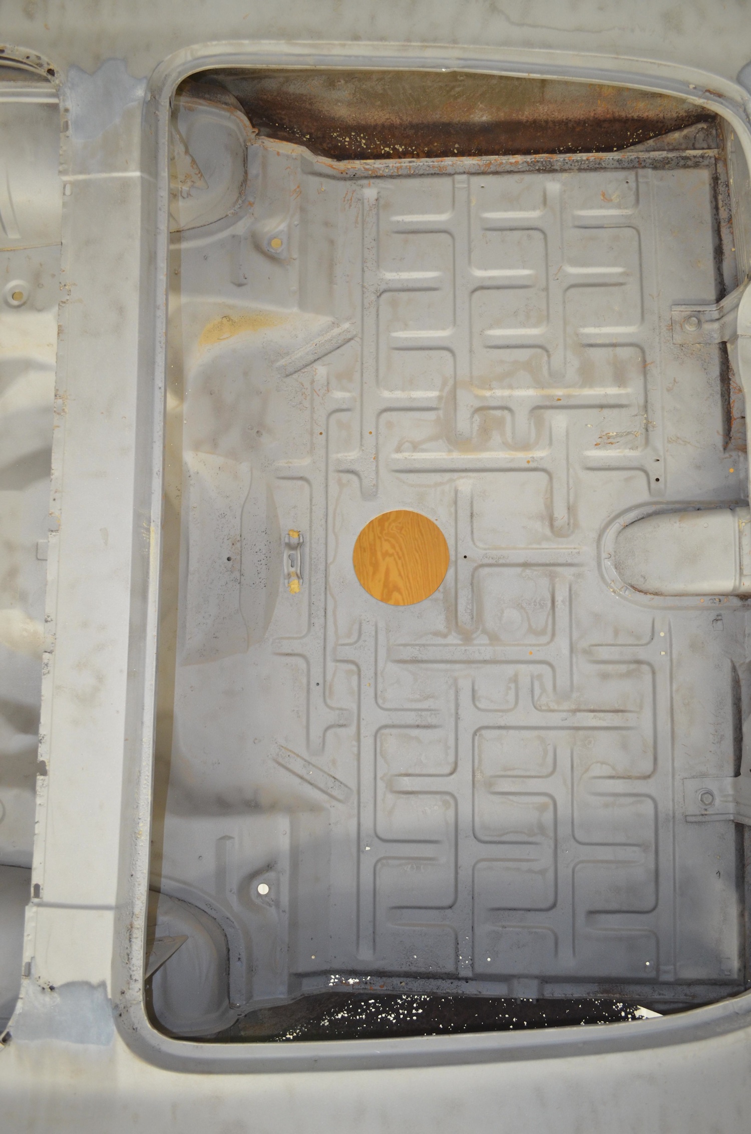

As mentioned before we tried a different blasting sytem for this restoration and were extremely pleased. Now we are using a different system to fill all the pinholes. Again we are very pleased with the results.

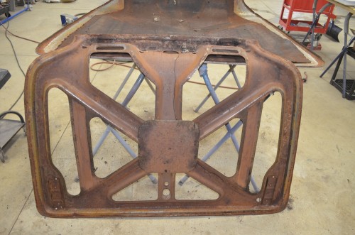

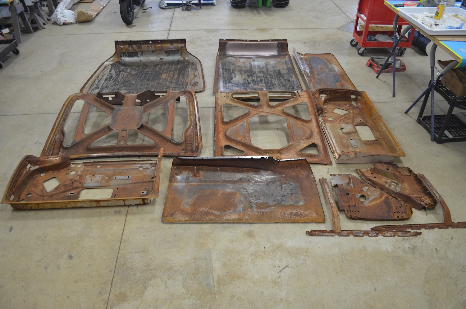

We did split the doors, hood, trunk lid, etc.. On this post we will show what the doors went through since they were the worst part of the car.
The inside of the door with dents, wrinkles.
Progressing with the repairs.Image
Some obvious pinholes.
After the Arc spraying.
PPG CRE Primer on the inside facing parts. And putting the inside split parts back together.
And the door skin. Which was first shot with the PPG, and then with rubberized coating for sound deadining.

BTW, where did you order the new wiring systems for your car?
