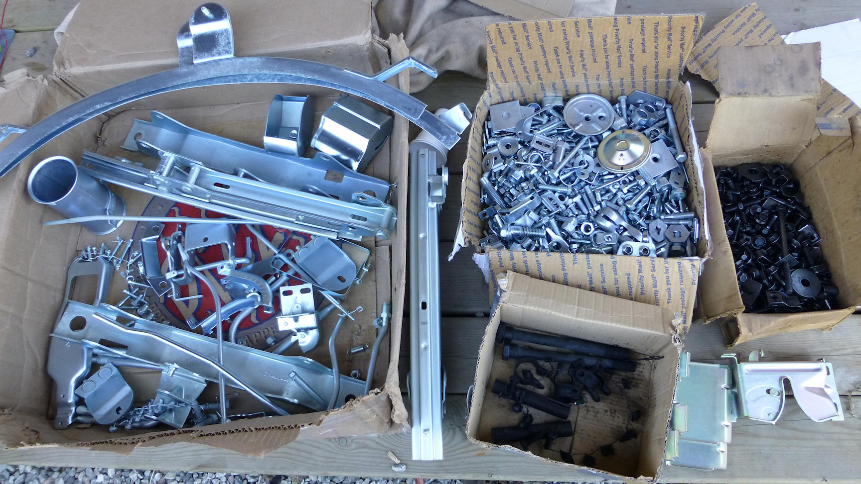

Oh well, talking about looking brand new, today I picked up 90 lbs bolts and nuts power seat parts, ash trays and all kind of hardware that has been at the plater to be restored and to get back that fresh new look. As usual they did a fantastic job and now it will be fun to put things back together.

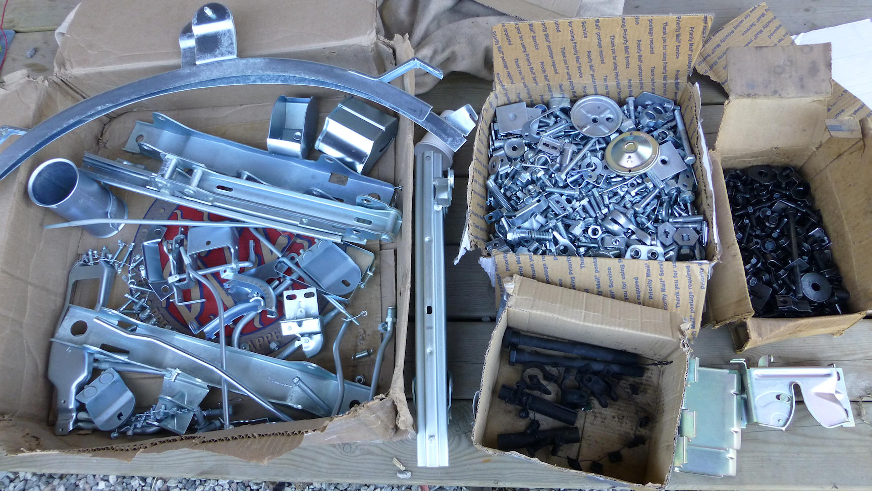

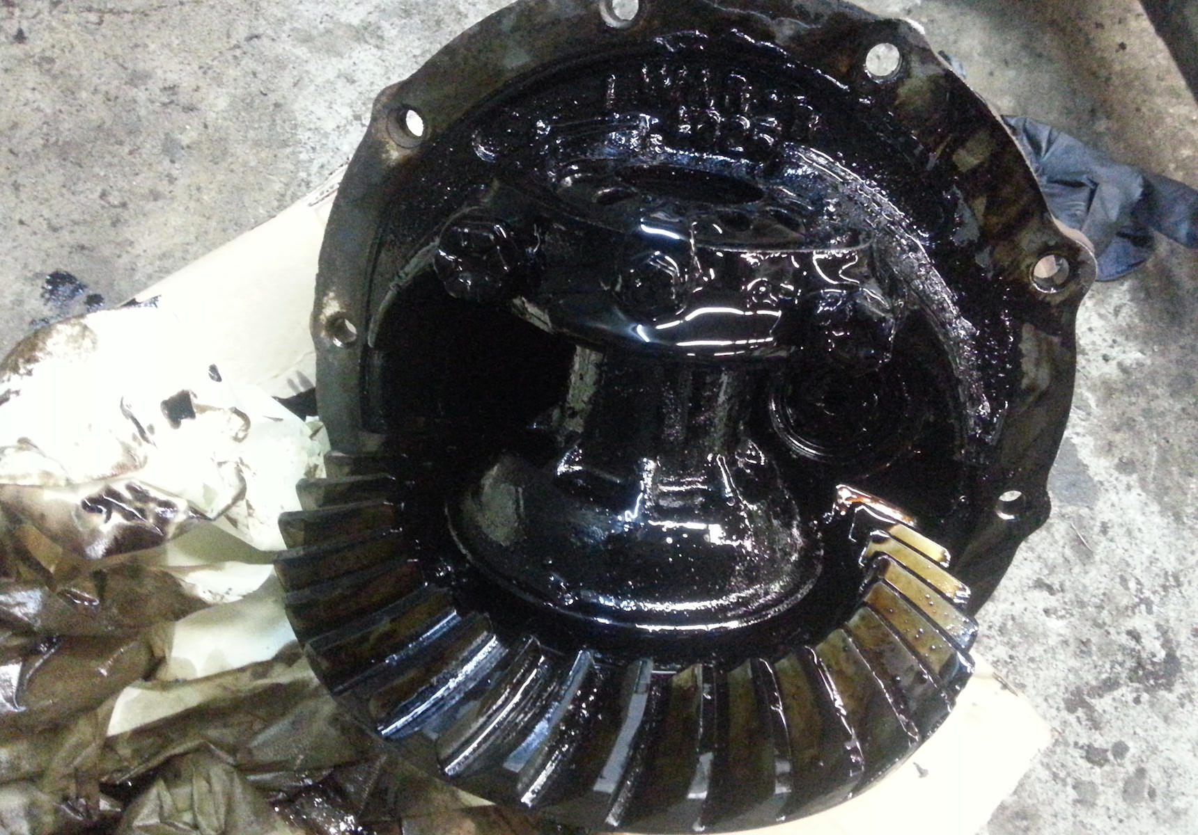

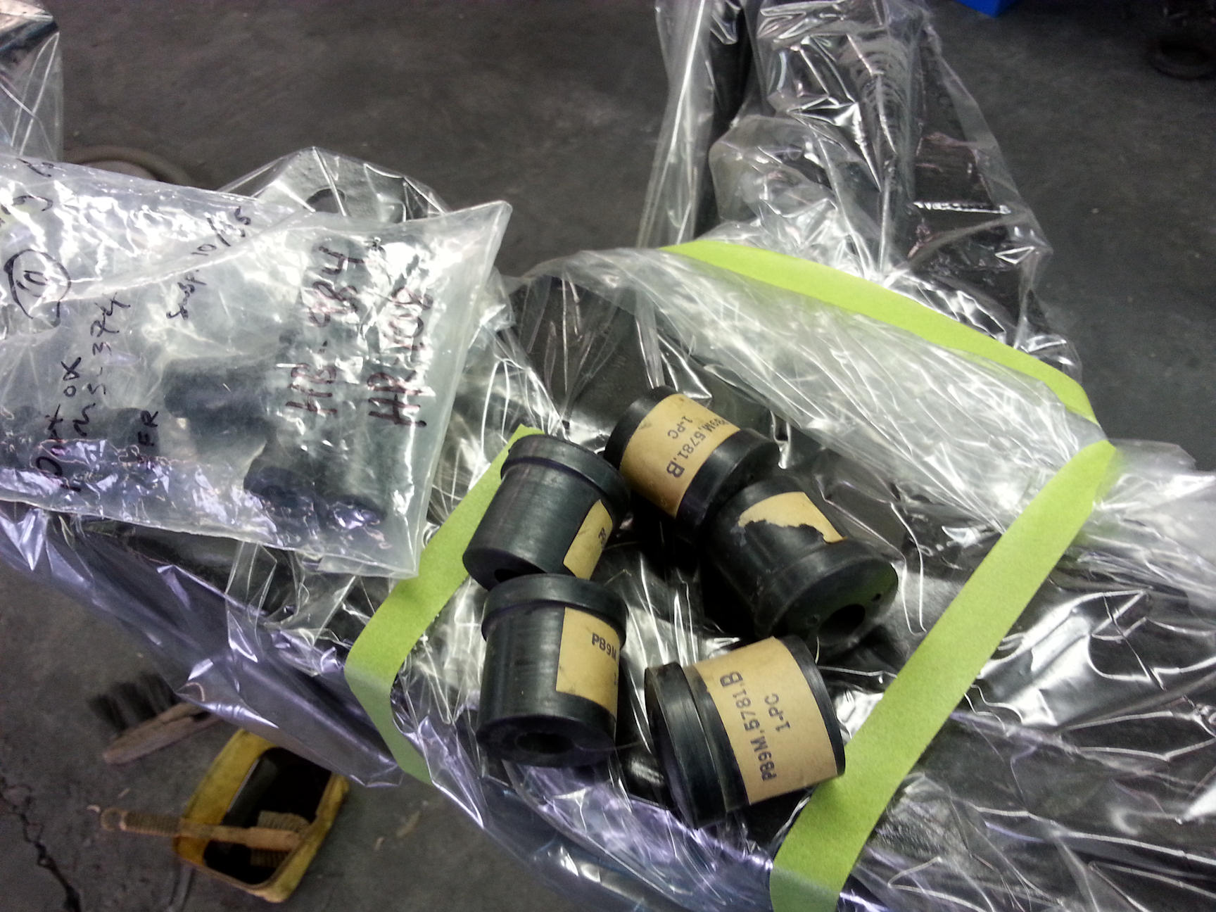

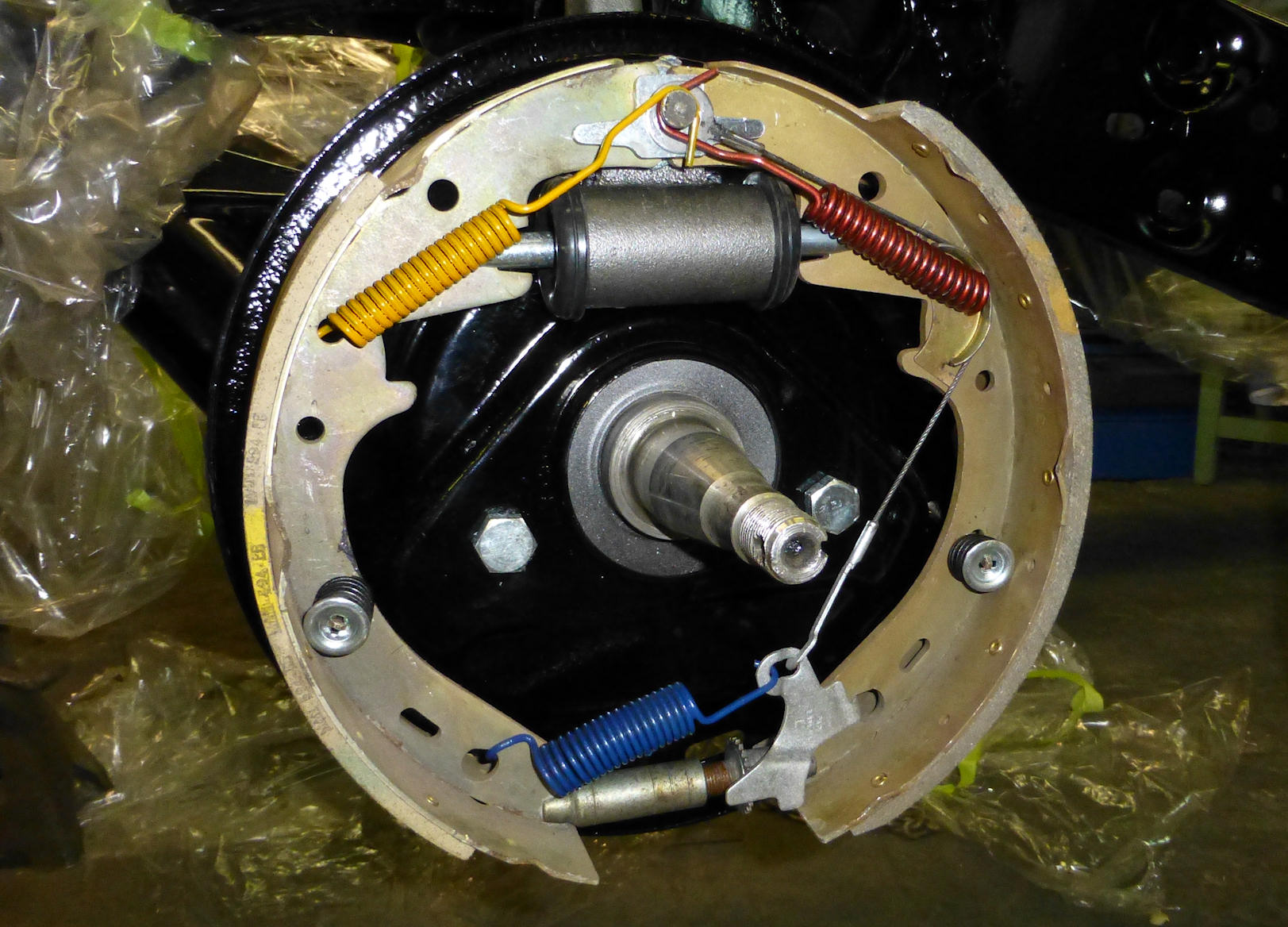

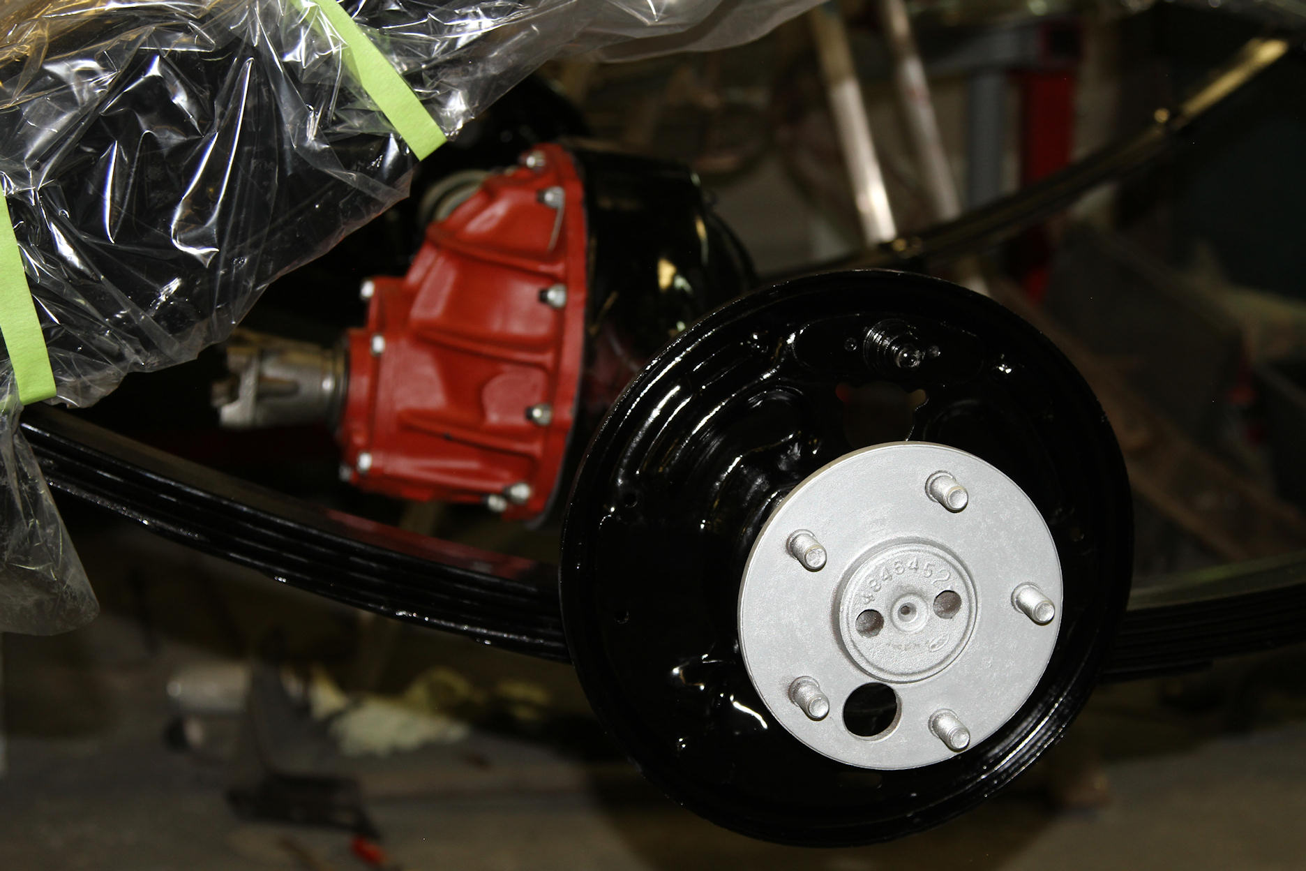

So with all the new bolts and boxes full of new parts it is time to get a few things back together. Before the rear axle housing was painted I removed all internal parts for inspection. Even if the car ran pretty good with no rear end or wheel bearing noise I found by closer inspection that I needed a set of new wheel bearings and seals. It also felt pretty good to get the 54 year old differential oil removed as it looked more like tar than oil.

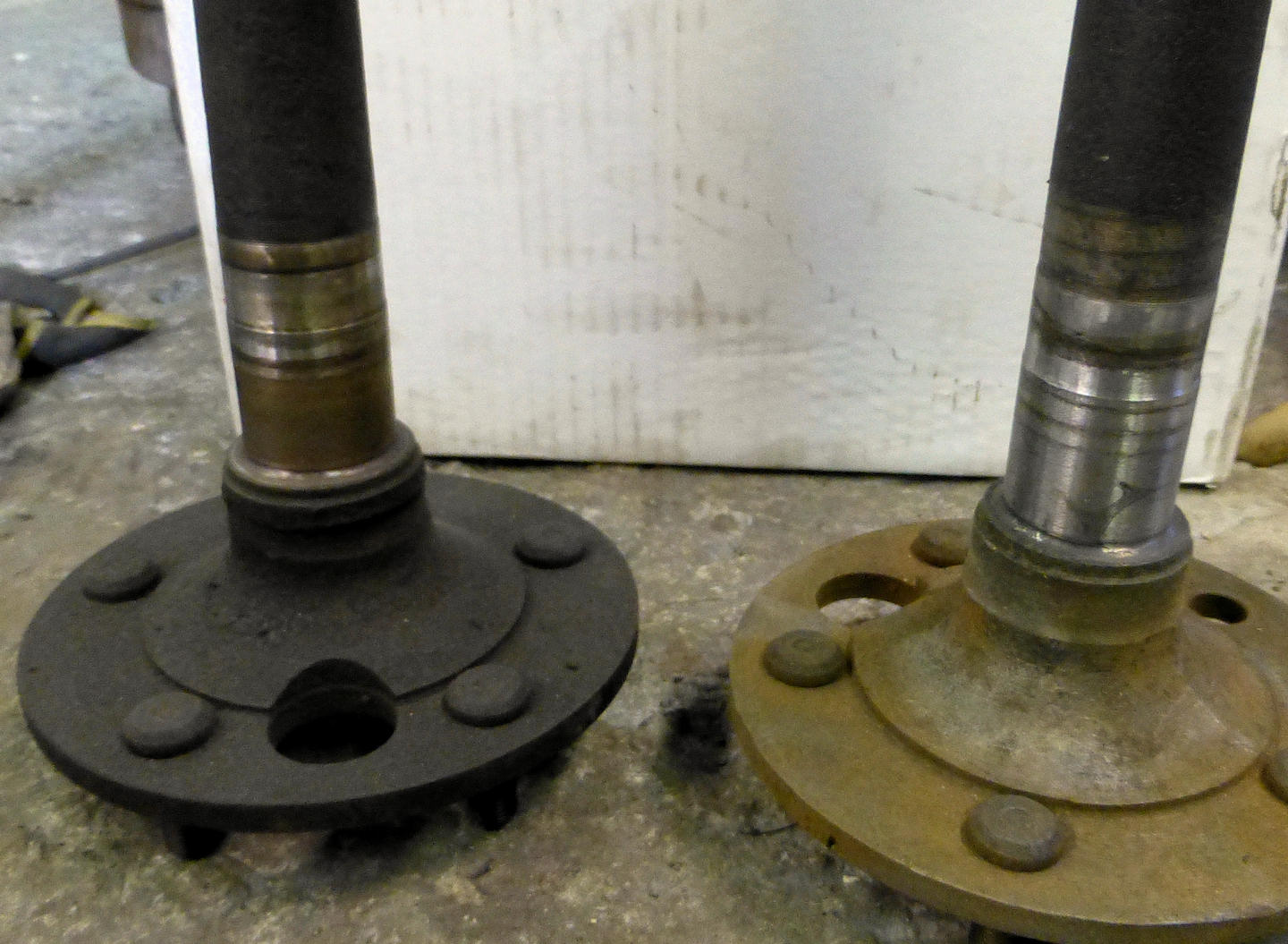

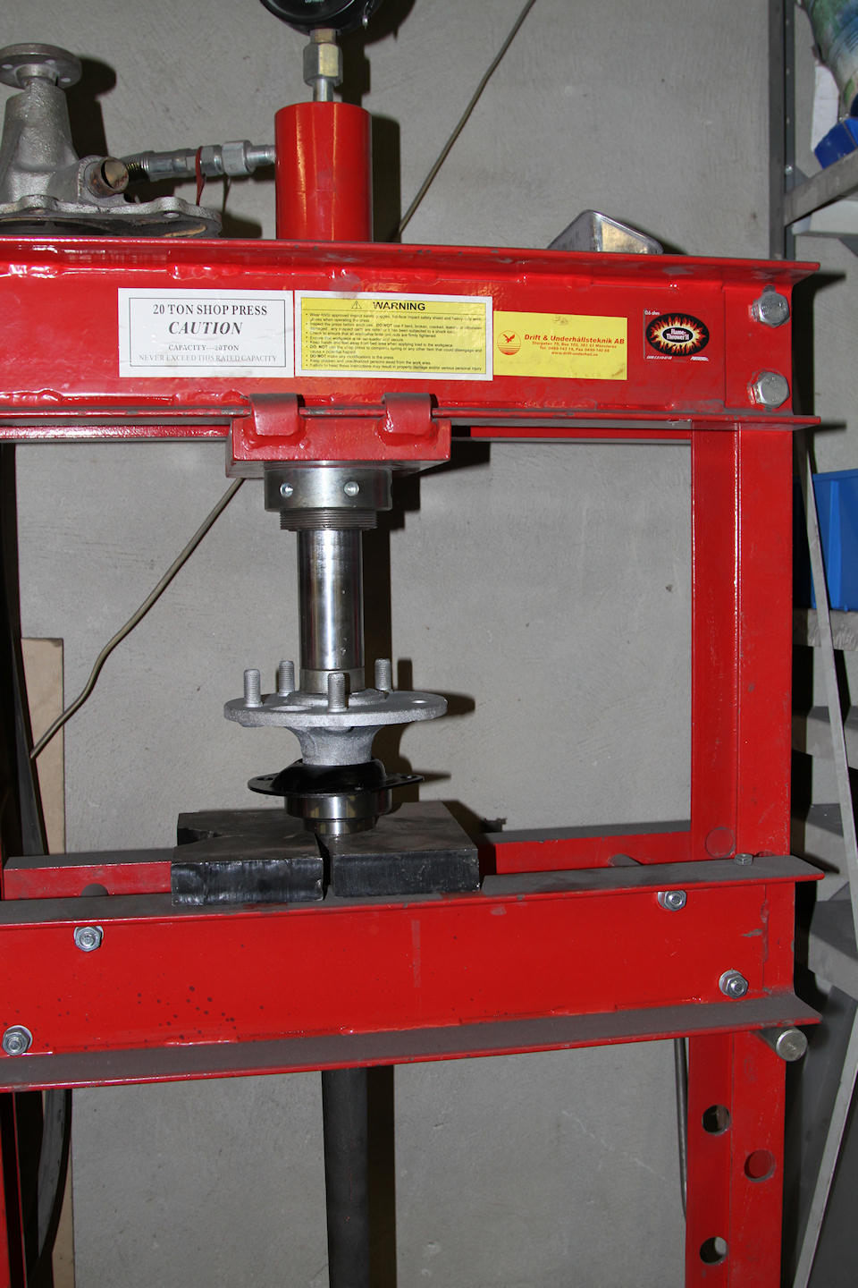

With the wheel bearings removed it became obvious that one of the drive shafts needed to be replaced too. The wheel bearing inner race had been spinning on the shaft and damaged it probably due to incorrect installation. Luckily I had a spare drive shaft here so I did not need to go far to find a replacement. Here you can see the damaged shaft to the left and the good one to the right.
A good hydraulic shop press is what you need to install the bearings as it takes between 5 and 10 tons of pressure to get them installed.
Before I installed the differential and the drive shafts I also replaced old seals and checked the alignment of the pinion and ring gear. The ratio on the differential I decided to use is 2.91:1 which is OK for mixed driving.

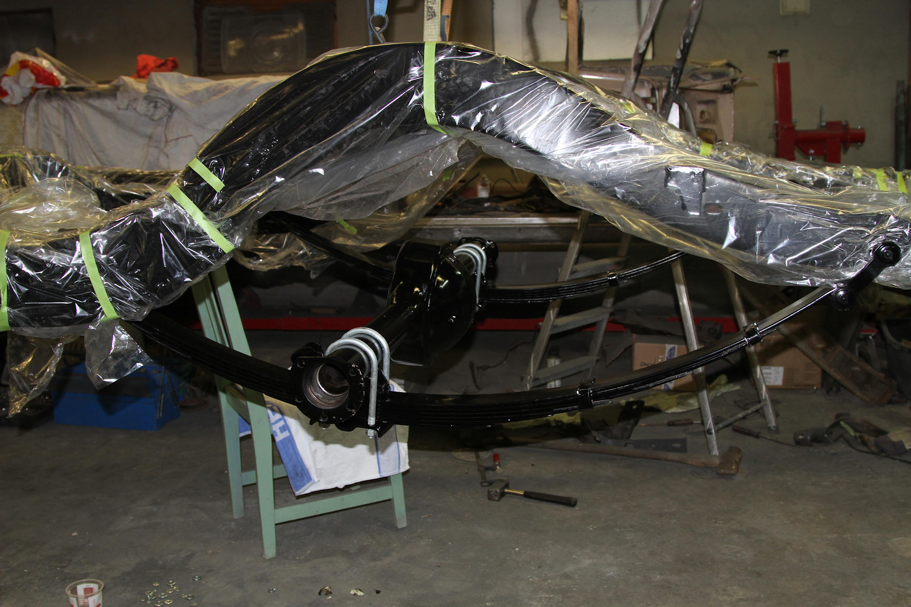

I decided to reuse the rear leaf springs that sat on the car as they were in really good condition. Before they went back on the car I had them sand blasted and painted them so they look like new. I had a full set of NOS rubber bushings for the springs, so they were installed before I hooked the springs on the frame. Then I installed the rear axle housing before I installed the differential and drive shafts. The reason I did it this way is because then I don't have to lift too much weight and my back will last a little longer
Finally here is the rear axle back in place.

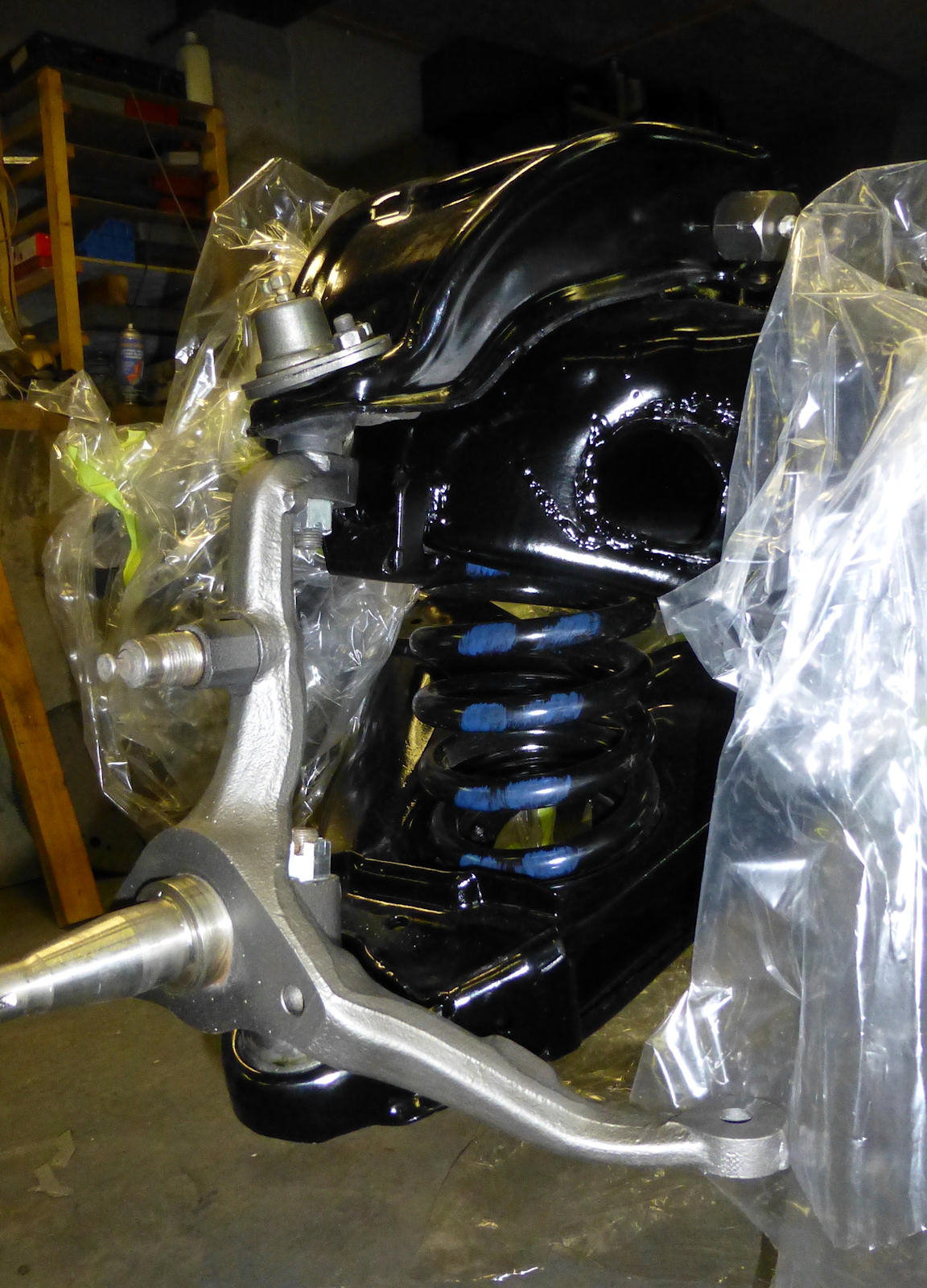

Moving forward is exactly what I have been doing as next up is to get the front suspension in place.

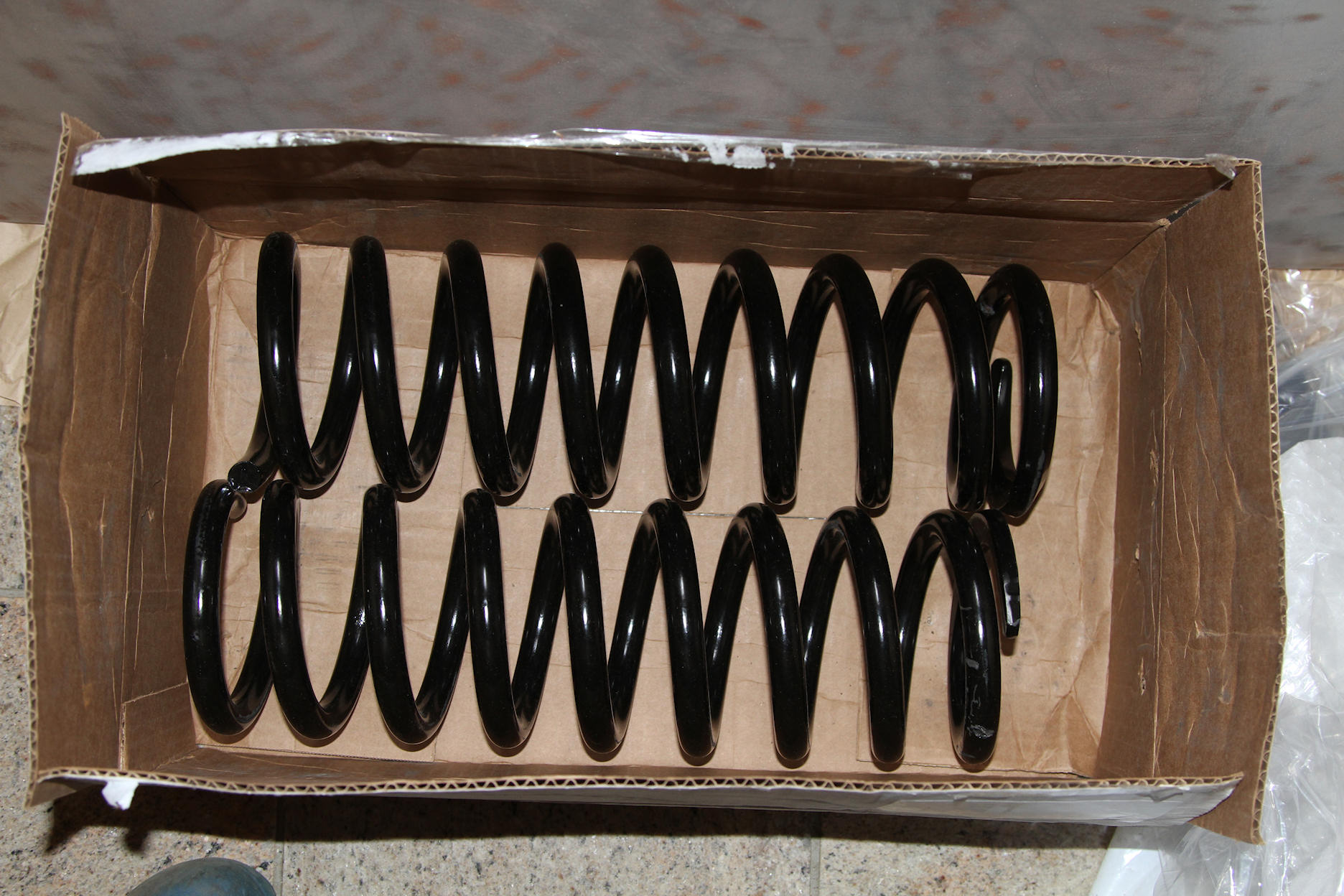

The old coil springs looked worn and the car was way too low in the front so I decided to get a new set of front springs. At first I thought I should go for the expensive hand made springs from Detroit spring, but changed my minds and decided to go for a set of TRW generic springs that is about 1/3rd of the cost. When I restored my 59 Park Lane I bought the more expensive springs but ended up cutting them down as they made the car ride far too high for my taste.
I am also replacing everything else in the front suspension and steering. New bushings, new upper shafts, new ball joints all over. Whenever possible I have been using NOS parts or old quality parts made back when they made these parts right in the US of good quality steel. I don't trust poorly ill fitting Chinese made reproduction parts
The result:

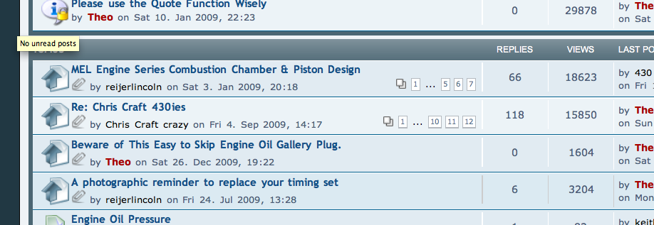

Theo, I can't get it, if there are thousands to read this tread why does the hit view counter as I write this show 373? Also the number of new posts the recent years shows more or less that this is a forum with extremely low activity. Most treads had their last activity 2 or 3 years ago, or even more. Compared with some other forums I frequently visit there is next to no activity here at all. Yes, the forum shows up in all search engines all the time, and that might also be the reason why you have so many hits, as a lot of people are likely pointed to this forum without the intention to be here. Long before I became a member this forum showed up in my searches for information not even remotely connected to what I was looking for. Very often when I am here there are usually 2 or 3 users visiting, now and then a couple more. Unfortunately most of these "visitors" are google Bot, Yahoo bot, and other search engines scanning the forum.
I am not writing this to make you feel bad or because the forum is no good, as it is a fantastic place for highly valued information about the MEL engines, I just want you to know how I see it. Maybe the problem is the extremely vast amount of sections and treads that makes it hard to actually find what you are looking for? I don't know, but I used hours on this forum before I found the mercury restoration section, which I found interesting just because of Rick's posts, and which also made me want to share what I am doing with my 60 Mercury.
So Theo, It 's not a dark nowhere, but it's for sure lonely here.

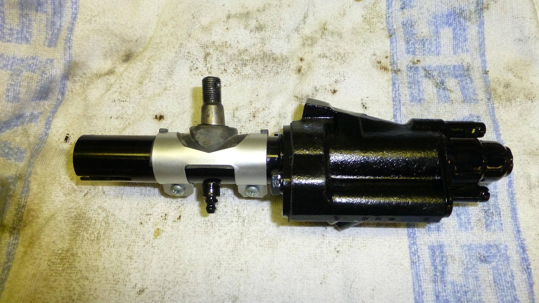

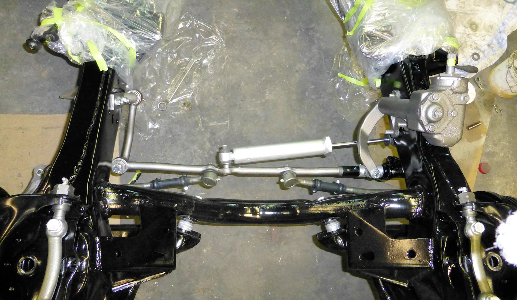

Time for a few updates on the progress again. First out is the steering.
The steering components on the car seemed to work all right back when I last drove it about 10 years ago, but since I think that a total restoration deserves all new parts I decided to rebuild or replace everything. First out was the power steering valve. Luckily the large rebuild kits for a 60's Mustang (there are at least one large and one small on the market) has everything you need to bring these back to new condition. Just to make sure I had all the correct parts needed I also had a NOS kit with the original seals at hand, but these are getting old and I would prefer to use newer seals, and that worked out fine this time. BTW, the 59 and 60 valves are not the same, and the seals from the Mustang kit does not fit a 59 and earlier valve unit.

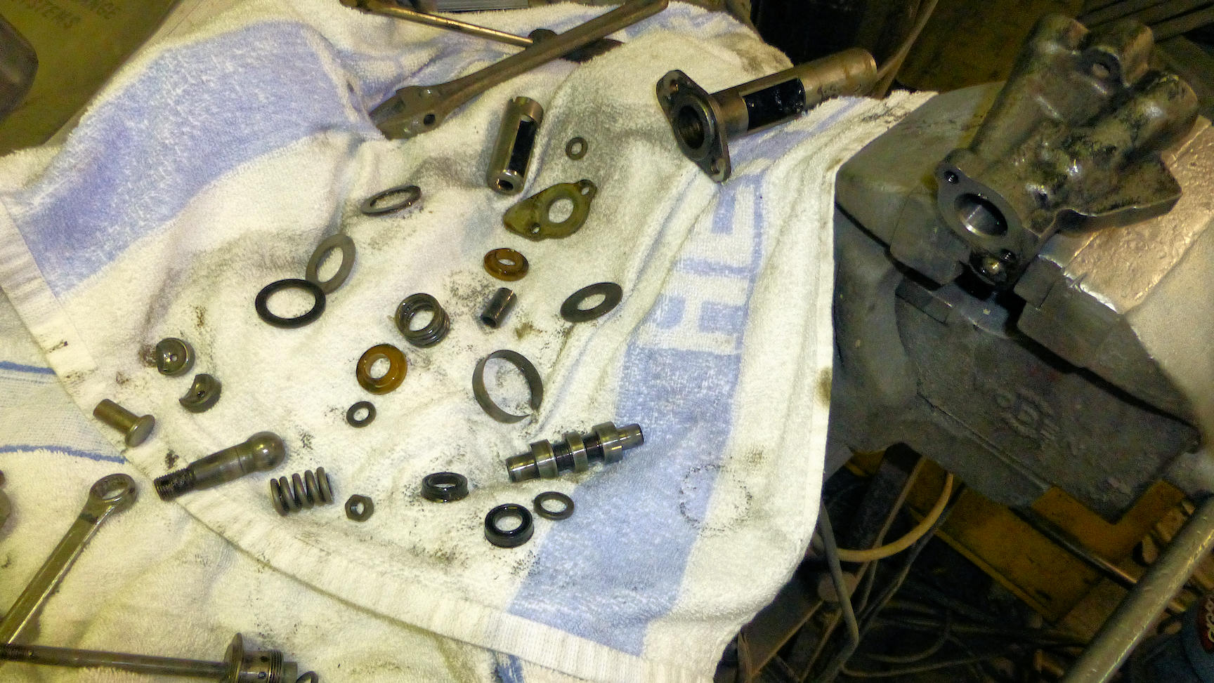

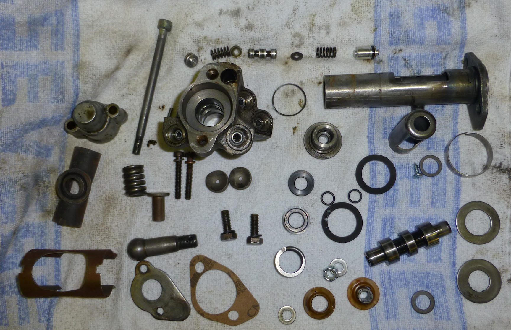

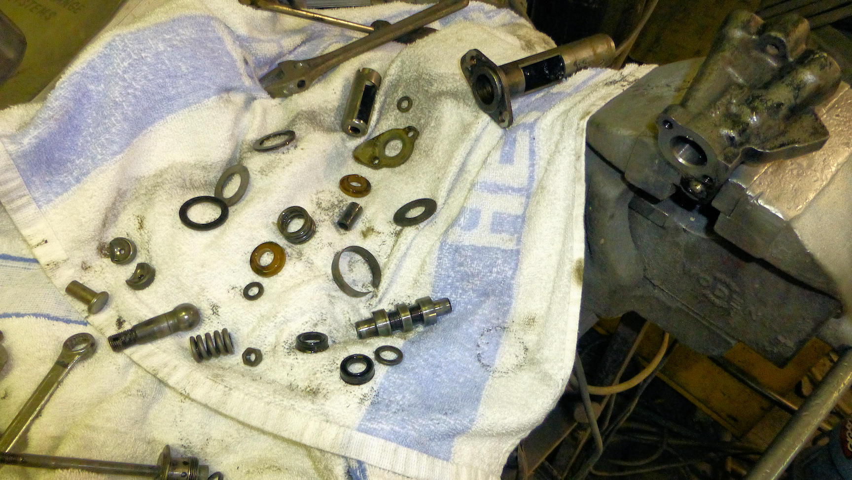

Her I have just disassembled the unit.
After a good cleaning and inspection I laid everything out on the blanket and replaced the old seals and parts with new ones. Now its ready to be put back together. the seals for the piston might be a little tricky, but it all came back together nicely.
Done.

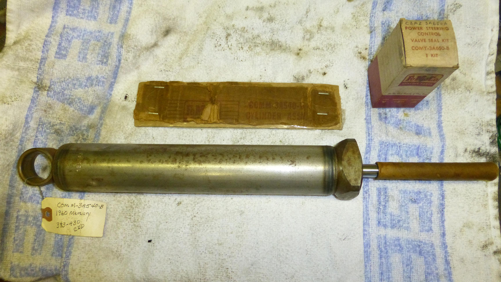

The power steering cylinder is NOS so I just painted it and otherwise decided to let it be as it is. I should probably have replaced the seals in it as well, but I am out of those seal kits right now.

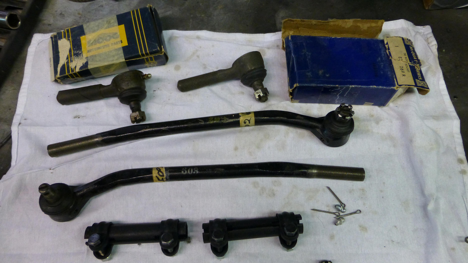

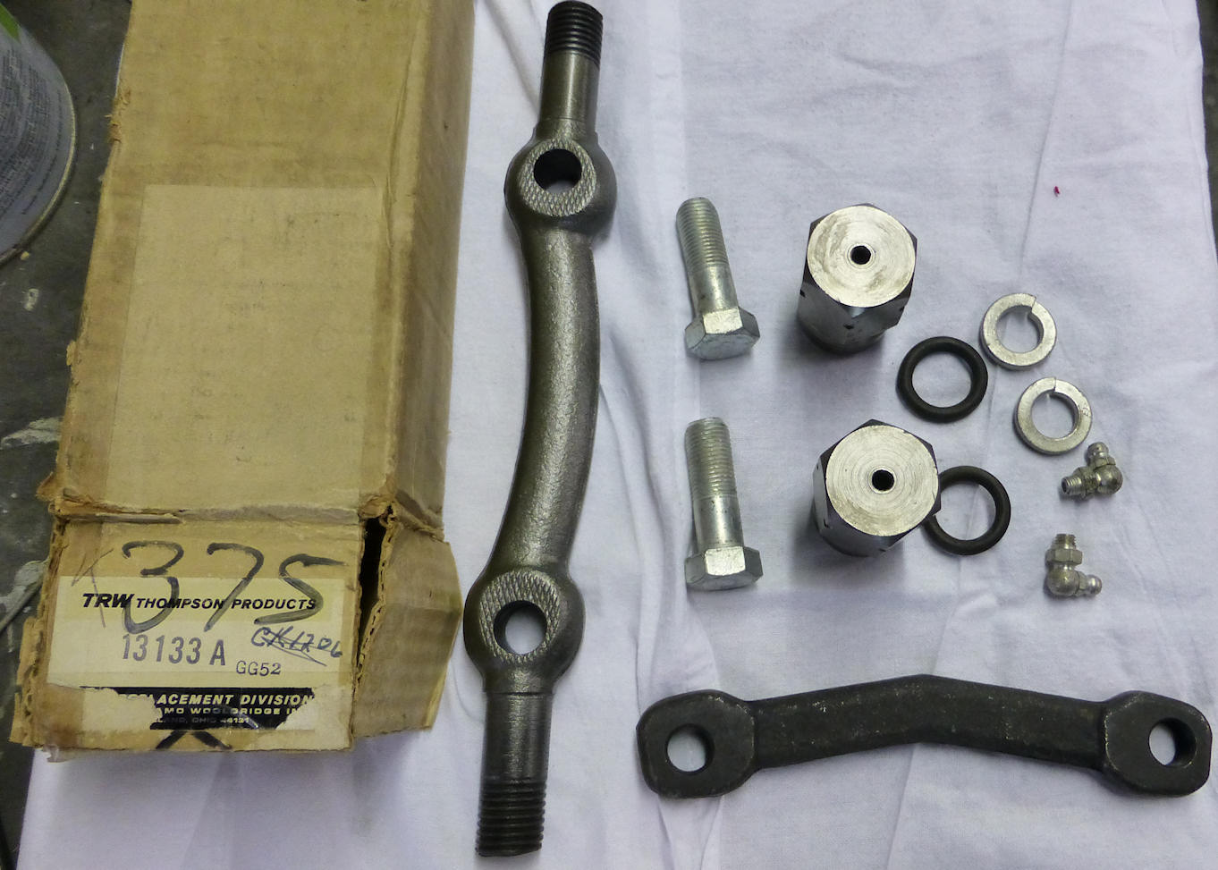

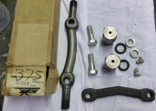

Fortunately I also had a set of NOS inner and outer tie rod ends that I wanted to use. I have seen some of the reproduction steering parts some vendors sells today and they look incorrect and the quality is so and so. I am so glad I don't have to use any of them.

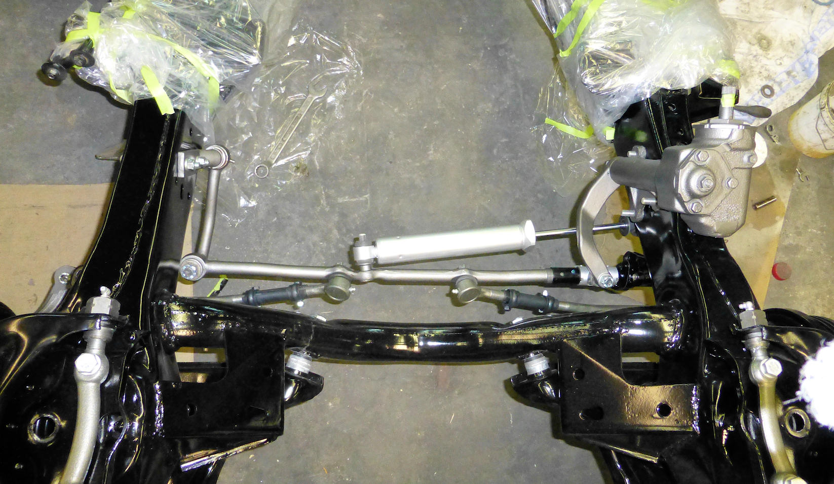

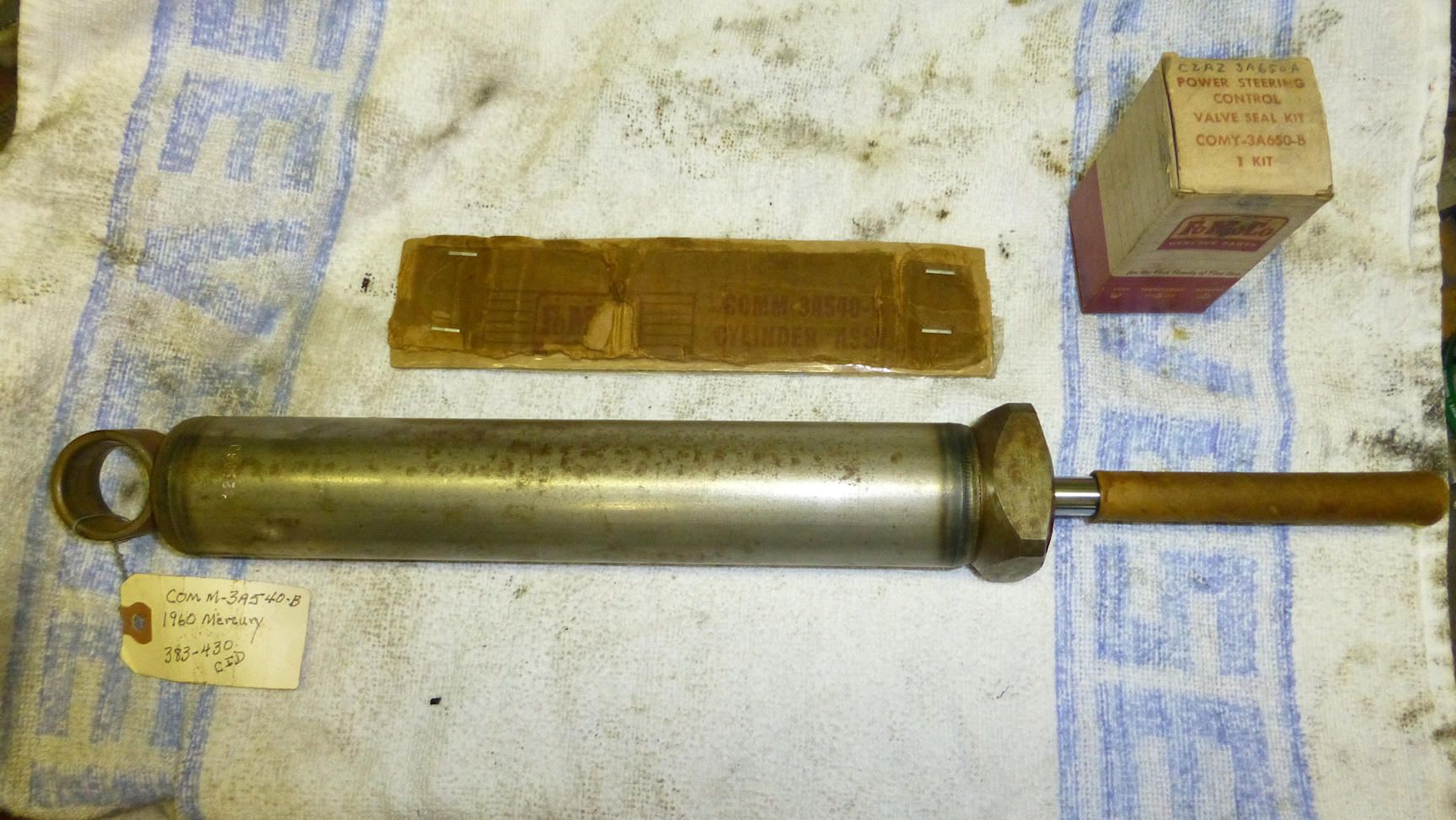

So here the steering parts are back in place. That means almost all, as the most sharp eyed and detail oriented reader will notice that I forgot to put on the clamp on the power steering valve
Later I will also add all those small markings here and there with yellow and green just like it came from factory.
