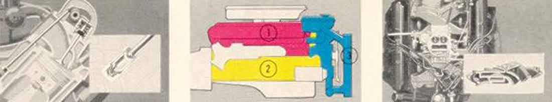

MEL Lower Block Thermostat
In-Block Combustion Chamber uses aluminized oversize valves with zero- lash hydraulic lifters; gives longer valve life, better intake and exhaust action, and smooth even combustion.
3-Stage Cooling circulates coolant in three stages: (1) to intake manifold and cylinder heads; (2) to block; and (3) to radiator. Provides fast starting warm-up and progressive temperature control utilizing three thermostats.
Fuel System Advances feature exclusive preheated carburetor air system and water-jacketed intake manifold to keep the fuel-air mixture at proper temperature for maximum combustion efficiency.
Broken link to photo (Kultulz can you edit?)
This is a set that I found on e-bay a while back. I have not come across a vendor that services them. The members at the LCOC Board leave them out regularly and I have heard no adverse comments. The diverter(s) is more important as it directs coolant to the heads and intake and that coolant heat is needed for the carb pad warm up as there is no heat riser provision engineered into the MEL engine.

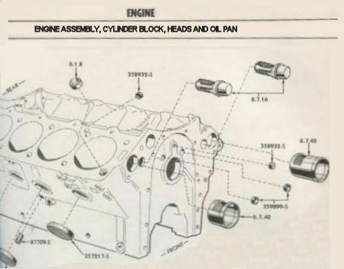

Block Thermostats Update
65/72 LINC-MERC MPC
The use of the block thermostats was discontinued in the 1963 model year. The notation is under PN C3VY 6009-B (cylinder assembly).
They are no longer available for service and the particpants at the LCOC Board have not noticed any changes in performance or operation without them. The diverters are still necessary though.
The block thermostat is assembled in reverse from a normal thermostat in that the temp sensing bulb is on the opposite side of the opening/closing spring.

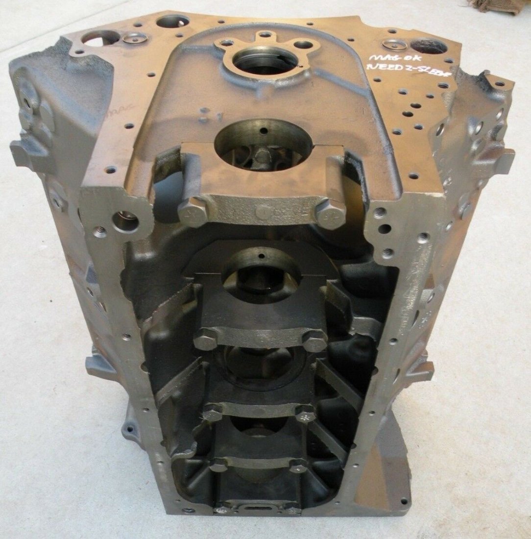

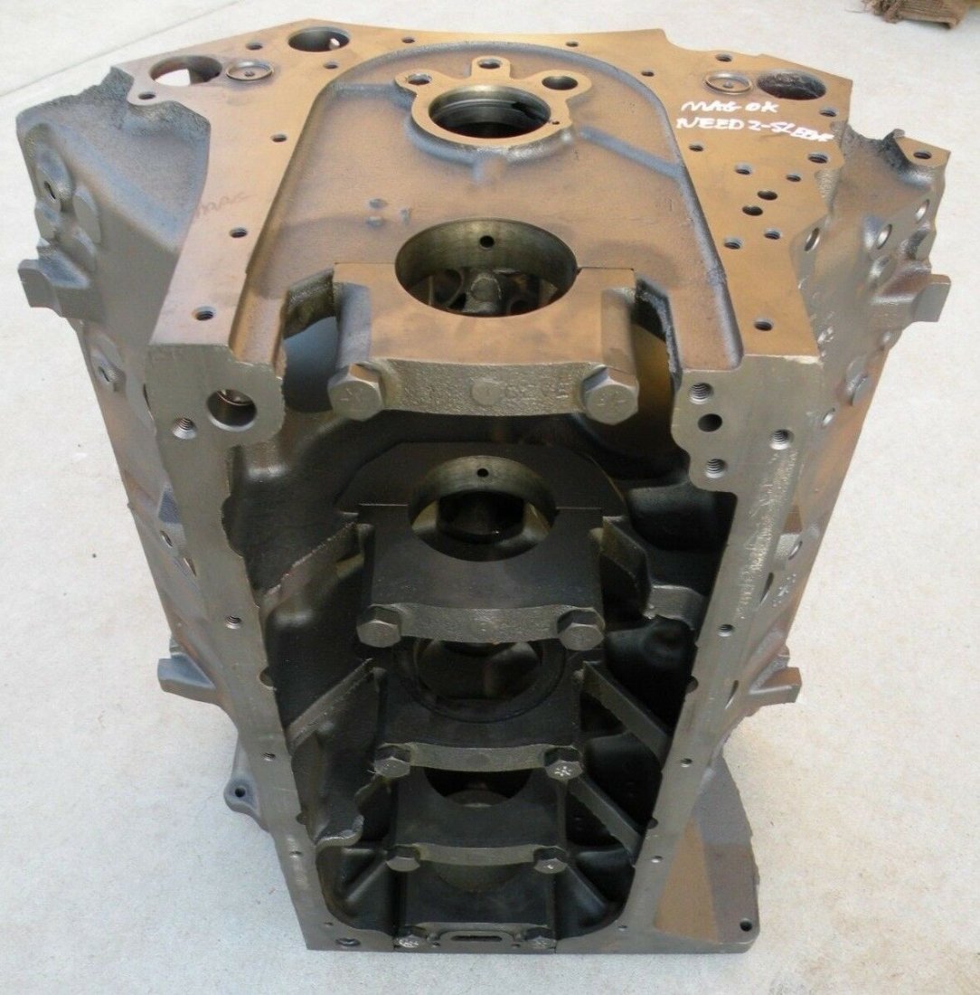

I recently purchased a 1956 Continental with a 1959 Mercury 430. Haven't pulled the water pump yet to see if the block thermostats are in there. Given that old thermostats are generally unreliable, I plan to remove them if they are there. My question is on the best configuration. The video on Engine Masters shows a blanking plate over the head diverter location and pumping water into what would be the thermostat location. I have seen used block photos that show the thermostats in place and also with what looks like a brass plug.
Anyone have thoughts on the best overall configuration?
23 seconds in:
download/file.php?mode=view&id=4308
Brass Plug?
Ford block thermostats
Shows block thermostats

A local builder turned his dividers to the block. This forces coolant through the back of the block up through the rear of the head and forward to the front intake crossover. The large intake coolant passage was filled from the rear to front stoping at the crossover leaving it open. It is "plumbed" like most other engines. I'll let him post and reveal himself if he wants. I sent you a PM.

Turns out, that is not a brass plug but the newer thermostat design.
