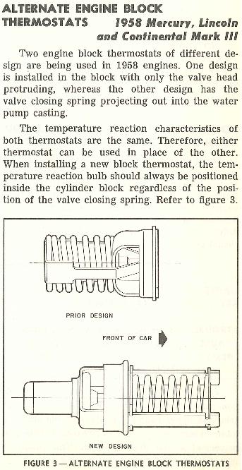

I thought someone installed the block thermostats in my 1958 backwards, but then I found this bulletin indicating the factory made a change in 1958 and flipped them around. An interesting fact if you have a 1958 but obsolete.
Re: MEL Engine Unique Cooling System
That's an interesting detail on the issiue. Thank you very much sbakar for your contribution.
