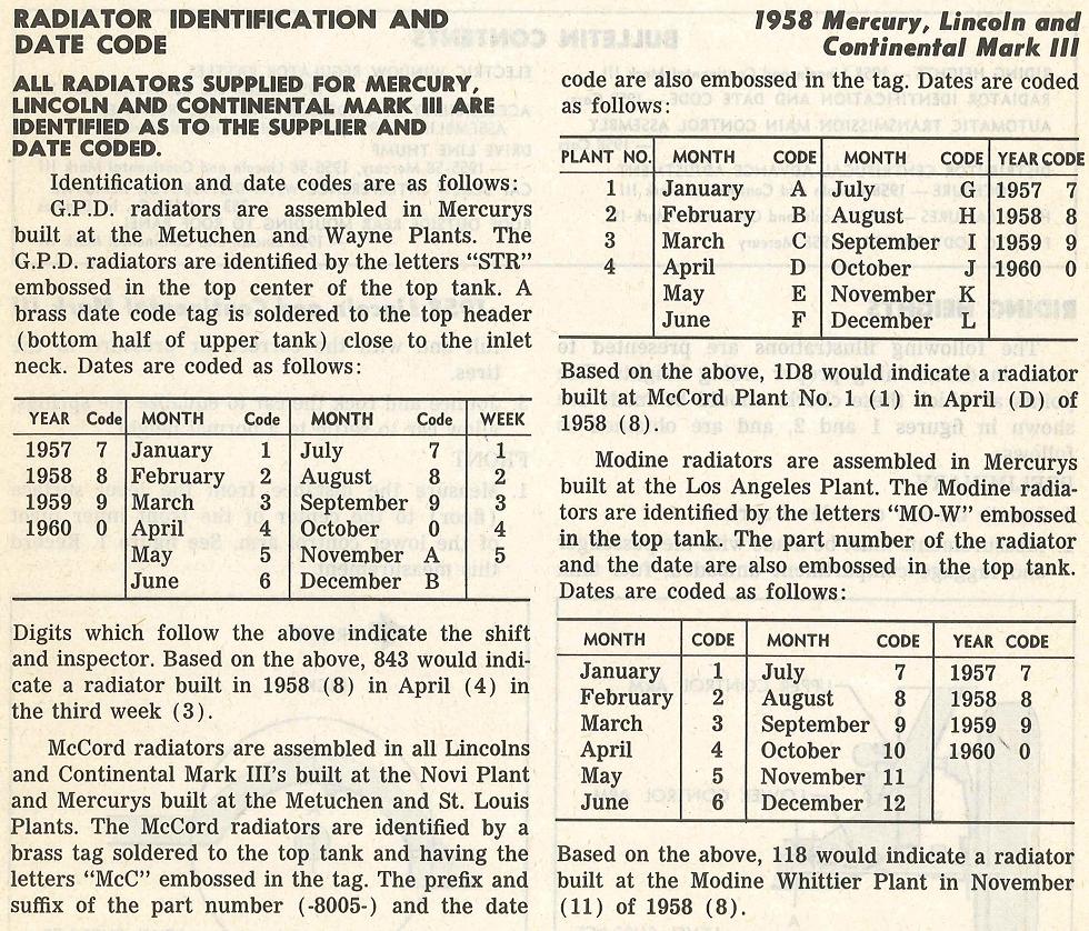

For anyone else interested, I thought this was a cool chart to decipher your radiator's build date. My observation on the few that I have checked is that they were built in the same month as the car's build date and not several months in advance like the engine or engine components were.
Decipher Your Radiator's Build Date
