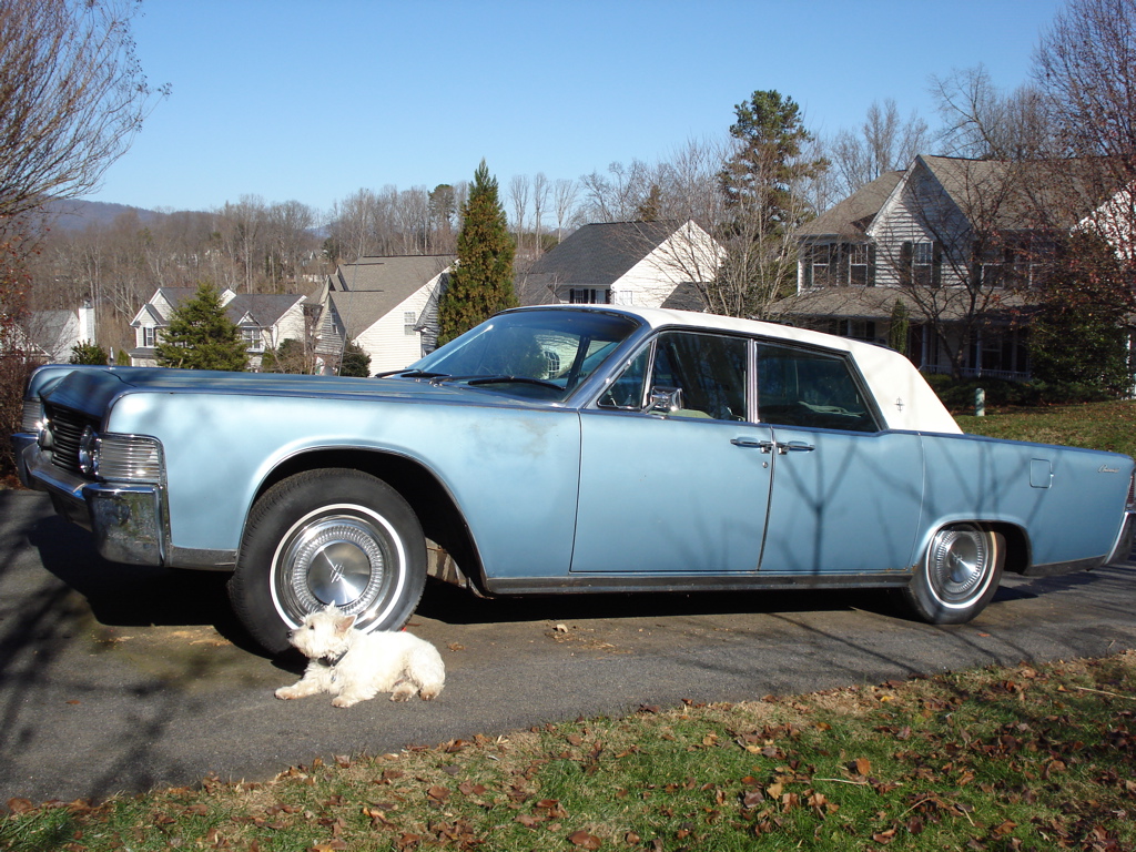

Anyways, pics of the ride (forgive me if they don't show, I'm a FNG as they say on the HAMB):
The car in VA, where I got it:

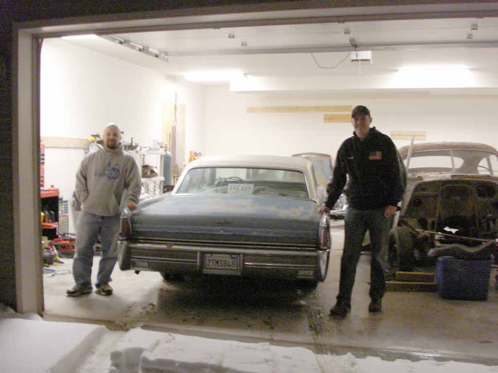

Here it is in my shop in WI. Little cramped in there now:
Anyways, it needs a new paint job, and I plan to keep the original blue. The car has about 105 thousand miles on it and I don't know much about the condition of the engine, so I'm guess I'll start tearing it down to see what I find. First thing to check looks like the timing gears, right? I plan to spend a lot of time on this board asking questions, so please bear with me!
