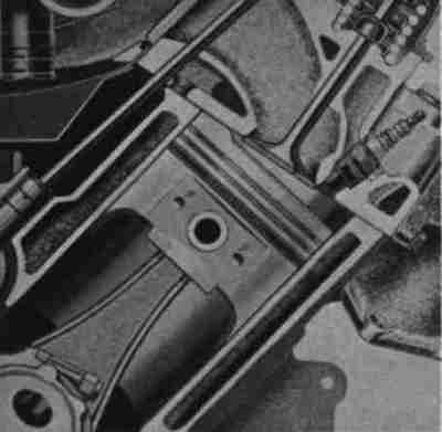

As for your choice of generic replacement pistons, you have negated the unique MEL Combustion Chamber design on your engine. There is TECH INFO here covering this subject.
MEL COMBUSTION CHAMBER DESIGN
MEL Combustion Chamber Early.jpg (9.91 KiB) Viewed 12211 times

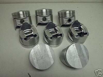

Reijer actually sourced correct OEM shaped pistons for his 462 from EGGE. I don't know if they have changed the 430 generic design. The only other alternative(s) is NOS or forged aluminum.
The problem here is that the MEL is a very unique engine design and very few (including machine shops) actually understand it.
GENERIC BUICK BLANC FLAT TOP
MEL 430 Generic Replacement Pistons_1.jpg (17.55 KiB) Viewed 12190 times
