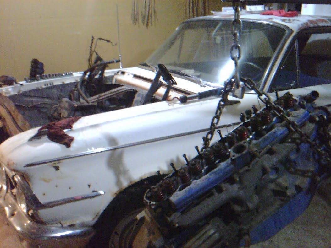

This is the grungy '63 430 that started it all. I've since sold the Edelbrock intake and found a Hilborn MFI.

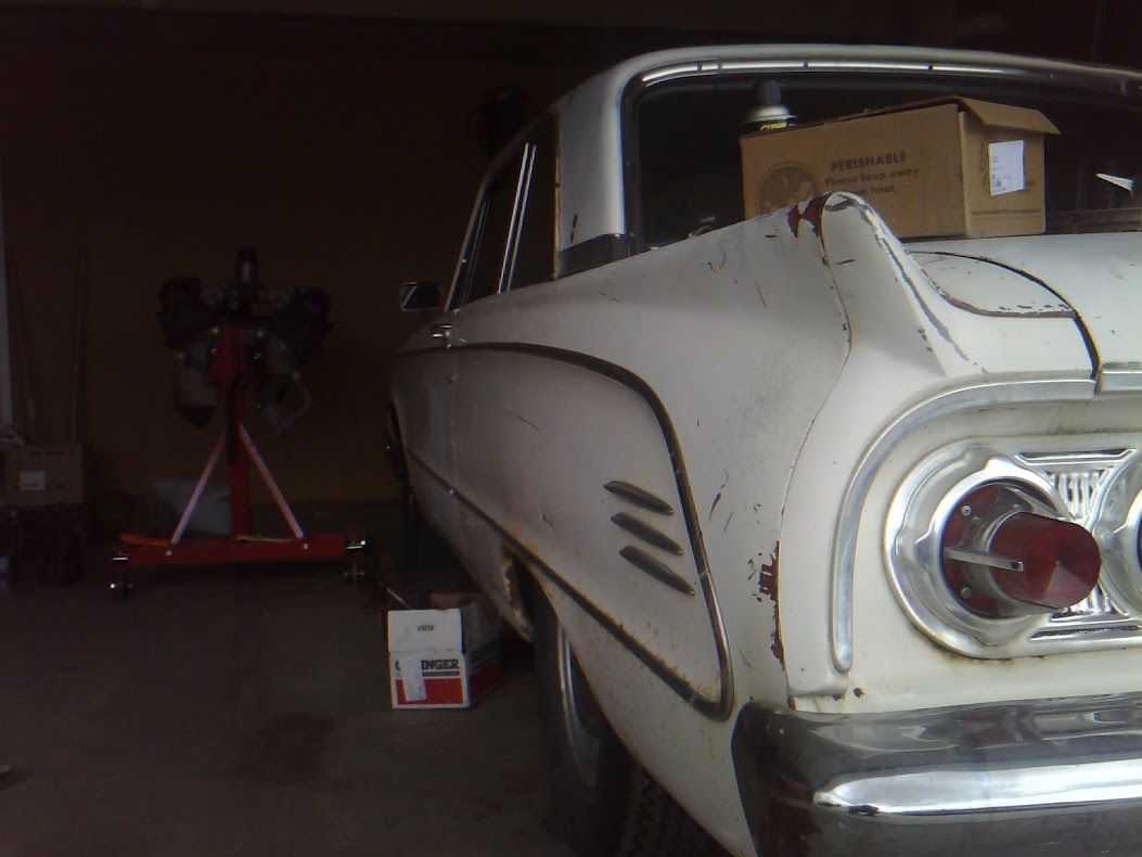

Here she is, from behind.

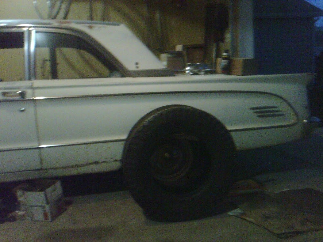

It's my new drag slicks. Looks like I'll have to radius the wheel wells!

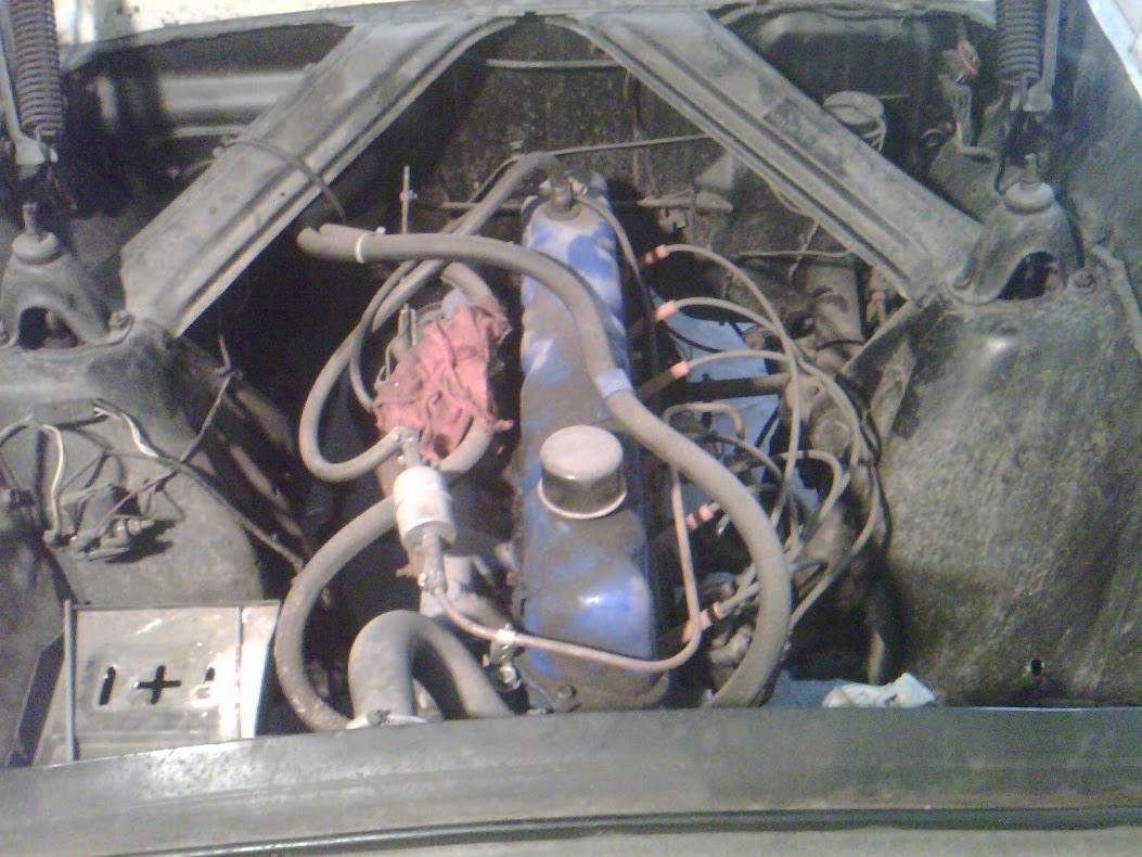

The stock inline. This little guy will pull the Comet around pretty good. Can't wait to see what the MEL will do...

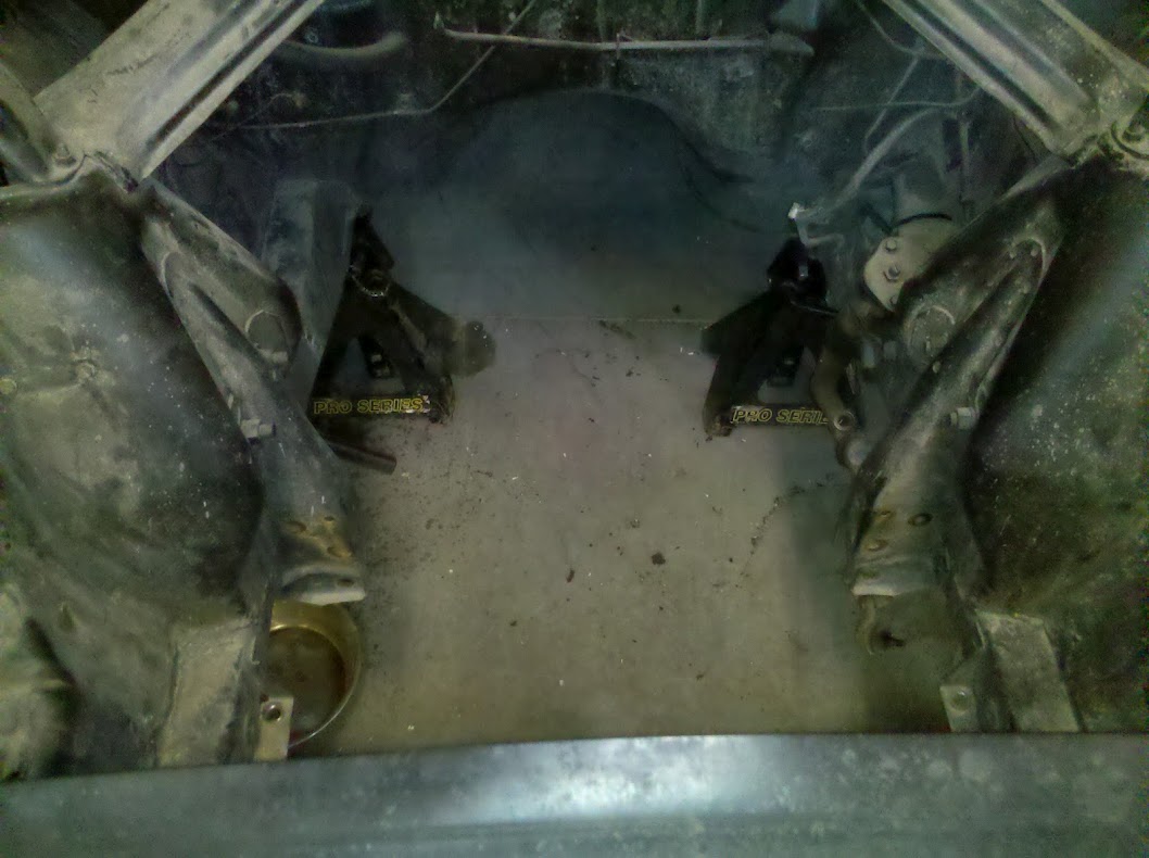

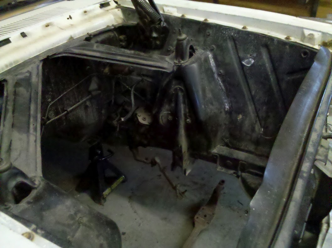

The engine bay sans engine and front end.
Looking straight down into the bay. The shock towers will be going soon, along with a big section of the firewall

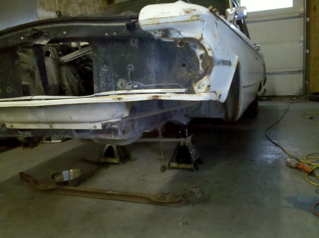

From the front. That's the '61 Ford Econoline axle in front. It will have to be narrowed ~6 inches to give the car a reasonable track. How much exactly depends on several things, including the structure of the subframe and where the springs will mount.

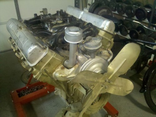

This is the new '59 430 I drove all the way the Great Falls to pick up.

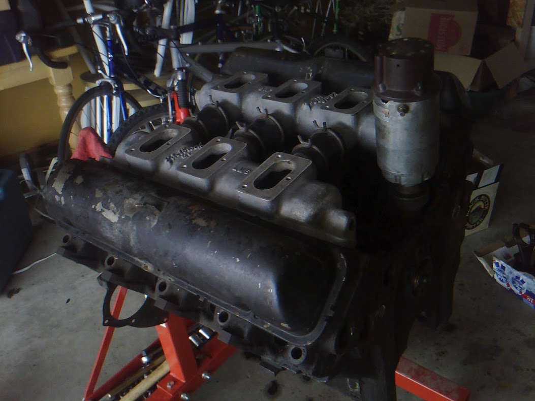

Interesting, the later intake doesn't fit with the early valley pan.

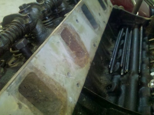

These have seen better days for sure.
Someone should have sealed off these intake ports...

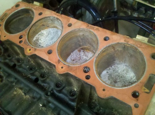

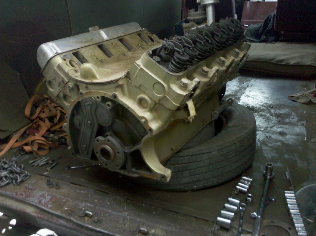

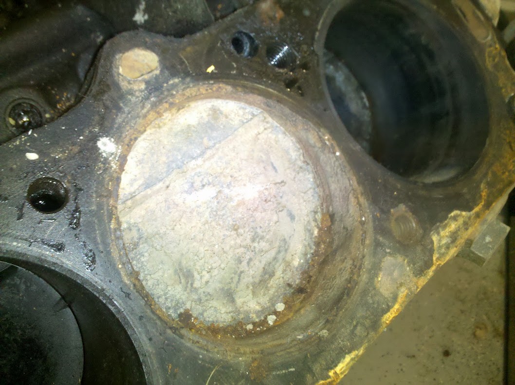

Number 2 cylinder is pretty crusty. Looks like a little water pooled inside.
Driver side bank. Not looking good.

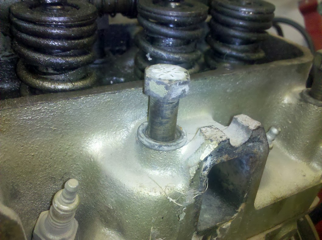

There's an exhaust manifold flange broken off on each head. Damn.

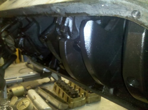

At least the bottom end looks good.

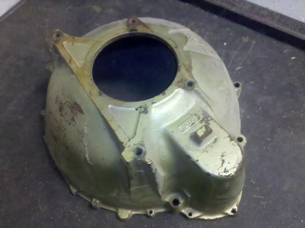

This is the best part of the new block--an FE pattern bell housing. Now I can put a 4 speed toploader in the drag car.
