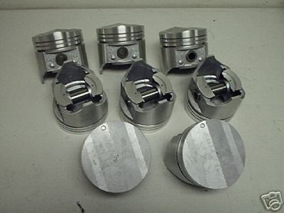

Post by KULTULZ » Sun 24. May 2009, 05:33
medic31a wrote:
It was poor education on my part at the time. I have little choice at this time but to learn to live with it for now. What have I lost as far as horse power and performance?
One would have to take two identical builds (w & w/o proper piston design) and have them dynoed to see the difference(s). I can only assume you will loose some top end power.

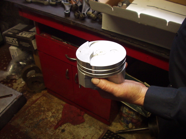

Reijer actually sourced correct OEM shaped pistons for his 462 from EGGE. I don't know if they have changed the 430 generic design. The only other alternative(s) is NOS or forged aluminum.
The problem here is that the MEL is a very unique engine design and very few (including machine shops) actually understand it.
GENERIC BUICK BLANC FLAT TOP
MEL 430 Generic Replacement Pistons_1.jpg (17.55 KiB) Viewed 12180 times
