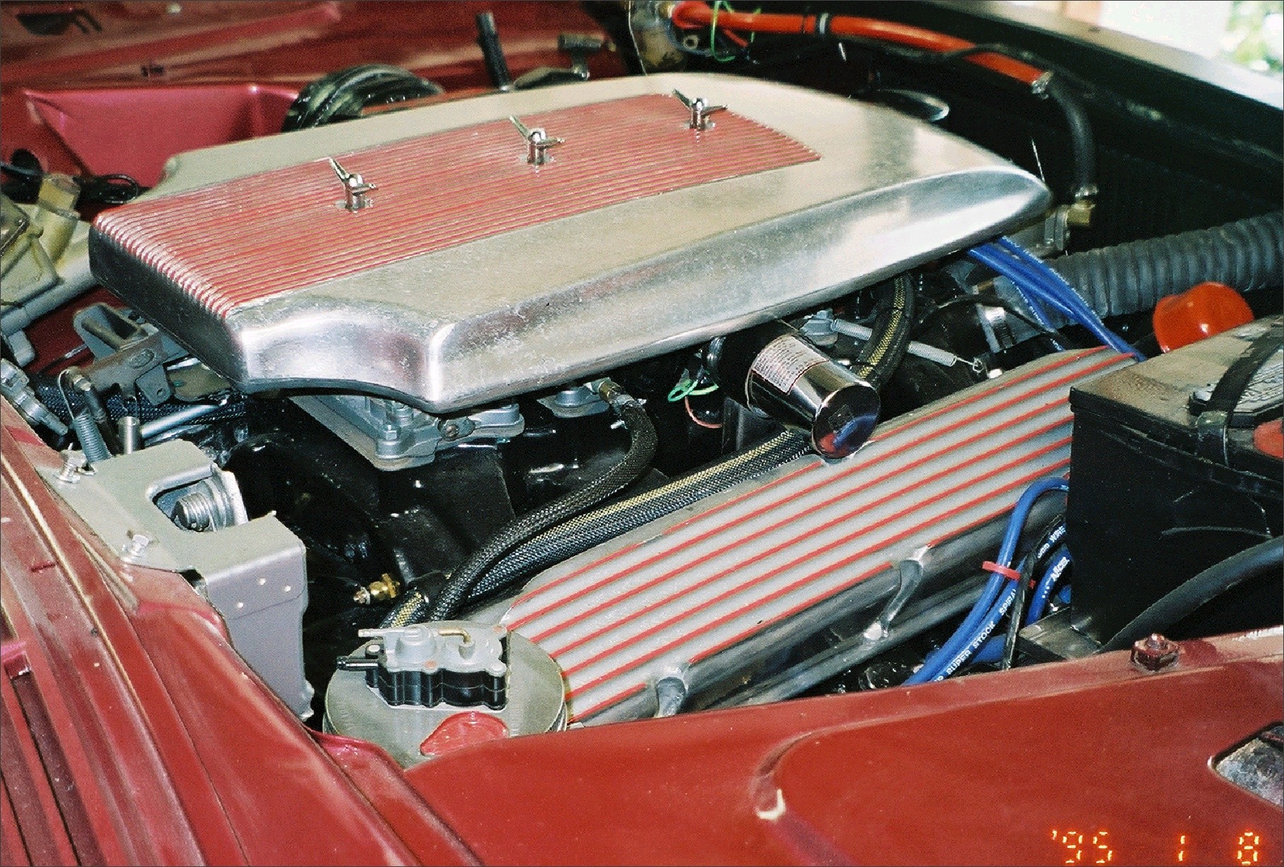

Here is a SUPER MARAUDER install in a LINC with decorated origional MOON covers-
Re: valve covers
From all the literature I've read, the Lincoln set up was only offered by the dealer,and the valve covers were not offered in that kit. So I would presume that the valve covers for that car were purchased separately from a Marauder.Here is a SUPER MARAUDER install in a LINC with decorated origional MOON covers-
Re: valve covers
The covers shown are not OEM, they are MOON covers (similiar to CAL CUSTOM).Shelby#18 wrote:From all the literature I've read, the Lincoln set up was only offered by the dealer, and the valve covers were not offered in that kit. So I would presume that the valve covers for that car were purchased separately from a Marauder.Here is a SUPER MARAUDER install in a LINC with decorated origional MOON covers-
The LINC came through with BRITE ROCKER COVERS.
Re: valve covers
O.K. that clears it up for me. Are there any photo's available of the O.E.M. covers?
