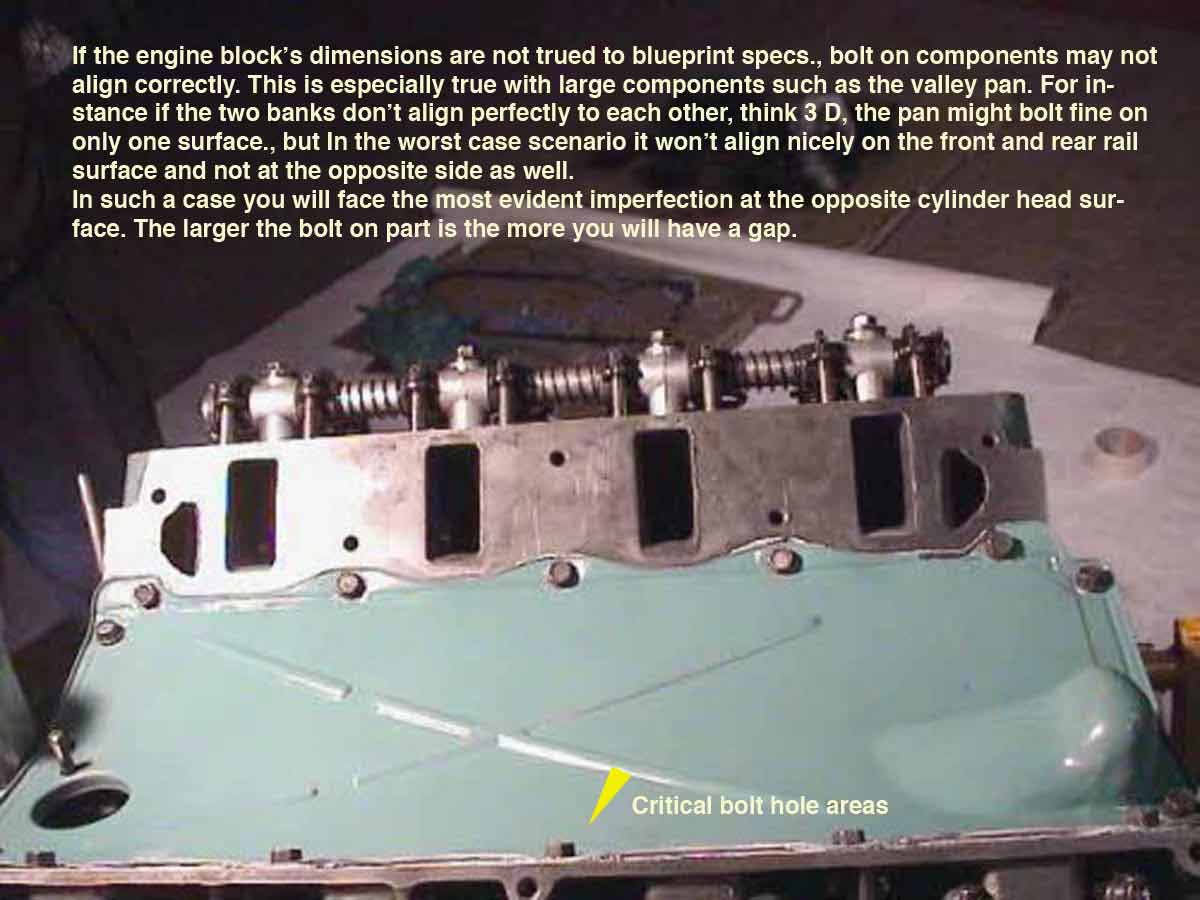

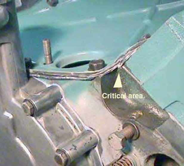

Please allow me to write down a few thoughts that come up each time I read about alum. valley pans.
They sure look fancy, but they're probably tricky in combat.
Unless you are working on a perfectly blueprinted engine block with all geometries ideal, installation will need your close extra attention. In most instances irregularities at the block's mating surfaces, such as not being perfectly parallel or situations were you have stepped surfaces between block and cylinder heads etc. the good old flexible steel stamped pan did fine. It's flexible enough to compensate in those areas and at stress points such as the bolt holes areas .
With an aluminum pan I'm not sure if the gasket thickness is gonna compensate enough. In the worst case you'll probably take chances to crack your investment.
I've been working on blocks that were not "block trued" and I can tell you, it was a mess. Especially when the intake manifold didn't mate those twisted surfaces.
I don't mean to spoil the thread and your drooling in aluminum heaven. That thing will sure look great on your engine. Just a few thoughts in a discussion board to throw in.
BTW will the v-pan be finned?

Yep, I agree that could be a problem, although working out a thicker custom gasket might help.
Re: MEL aluminum Valley cover project proposal
I think the aluminum valley pan should be of a thick and sturdy construction. It should have extra meat at stress points and at the gasket surfaces in general. On a trued block those aluminum pans can be superior to the steel pans, but if the blocks are not true, they will be problematic to install
