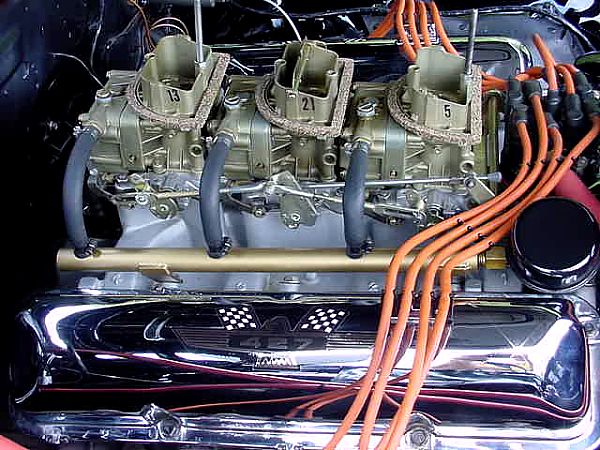

You will need a fuel log to distribute fuel delivery to all three carbs-
This is a much safer system over the origional SUPER MARAUDER setup as the fuel lines (rubber) are not stretched over the hot intake manifold...

Re: tri power fuel pump
This is the typical set up. It looks classy and nicely in order. I don't think that it's much safer than rubber. The metal tube will probably absorb heat more than good old rubber and like allways it depends on how you route the rubber lines. It's easy to keep them away from contacting the engine. The intake manifold is usually the least hottest part in the bay.
But all in all the common rail fixture keeps things nicely in order and looks good.

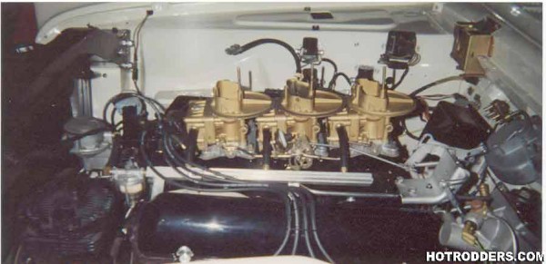

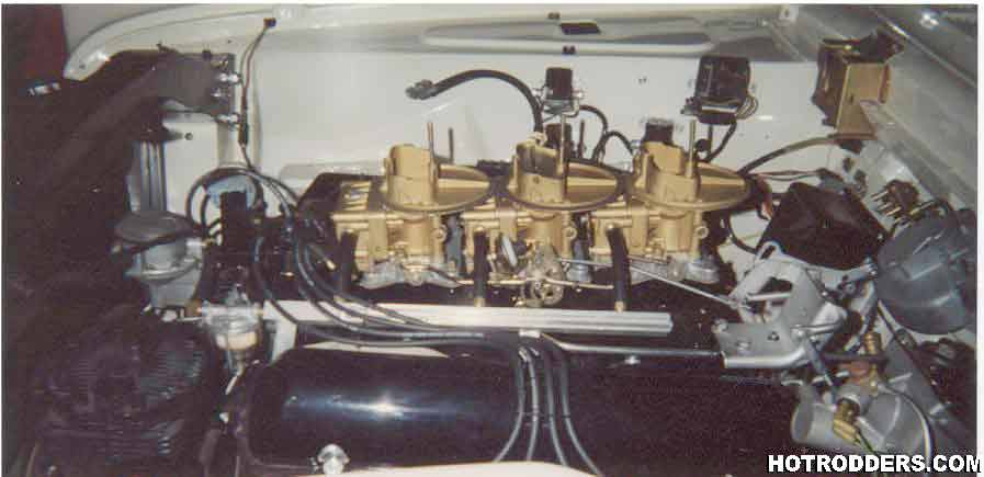

FE Style Fuel Log On 430-
It appears to be made from EFI aluminum rail.
They are 2300s with 2100 Autolites to make it look original. He had them changed. The list numbers are all messed up too since he was turning this into tri power from non tri power carbs. They should be '58-'62? regular 2V carbs. I think it will work, I have to call the guy in IL by the name of John Bunetic. He was referred to me from a guy who had the Ford 6V website. I also saw his name in the archives yesterday on the old MEL site. He does this all the time I suppose. Looks like that set up in the photo is in a 60s Lincoln. I wonder if he needed hood mods? I do believe the earlier 60's Lincolns had lower hood lines than the '66 and up. Too bad we cannot come across anymore photos of that. Thanks for the help.KULTULZ wrote:Are the carbs that came with the manifold FORD 2100's or HOLLEY 2300's?

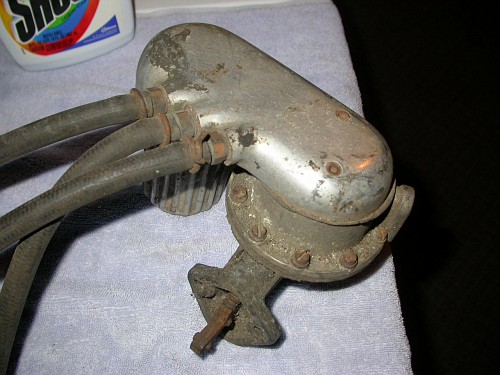

John here is a pic of my pump ....its really not much ..... Just an adapter that mounts on top..
You can mill an adapter with 3 outlets ...radius the ends add some fins on top for the cool factor ... and you got it!
