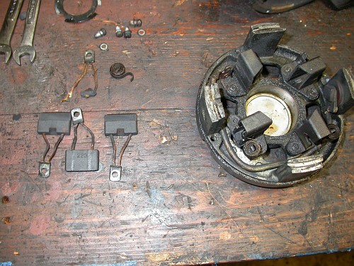

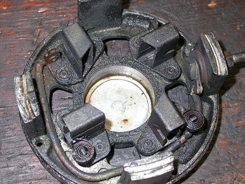

Hello all,
Im looking for any information on a Generator, 50 AMP Bosch unit. I need brushes and springs.
This unit came as factory equipment on Air conditioned cars.

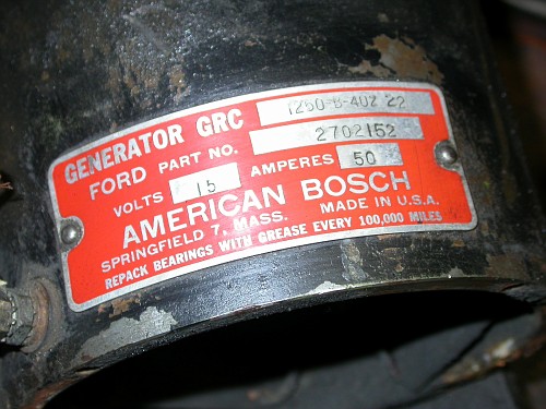

Ford part number 2702152
Generator GRC 1250-B-402-22
15 volts 50 AMPS

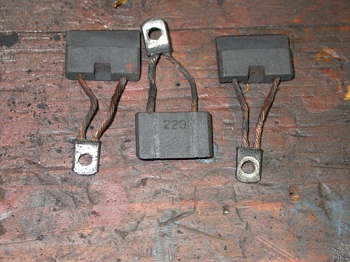

Brush Measures
1.100 in w
.314 in thick
steps down to .210 in thick
1.125 length when new
springs are 16 -18 oz.
Thank you
Anthony

Thank you Rick .....That is very helpful .....
I found replacement bearings ...still looking for brushes and springs.
Cut the armature on the lathe .....just a whisker......so the armature assembly is ready to go.....
Will post results soon....
Thanks
Anthony
