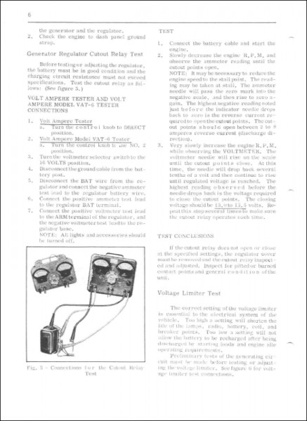

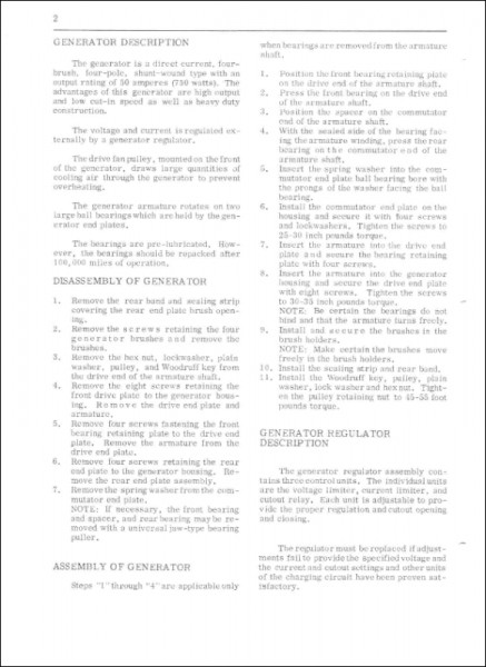

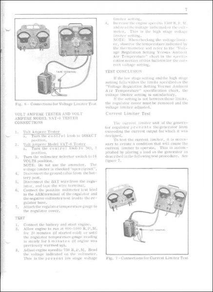

Re: M-E-L Generator 50 AMP Bosch
Post by Shelby#18 » Wed 29. Apr 2009, 16:40
I hope this helps! ;)
All the best....
Rick
Post by 59lincolnrag » Thu 30. Apr 2009, 04:50
Thank you Rick .....That is very helpful .....
I found replacement bearings ...still looking for brushes and springs.
Cut the armature on the lathe .....just a whisker......so the armature assembly is ready to go.....
Will post results soon....
Thanks
Anthony
