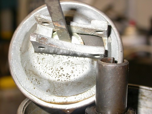

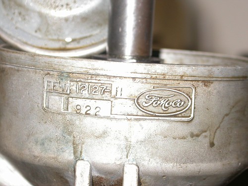

Here is what I have. Part number for the distributor. #FEW 1212 7-H (922)
I also found this part number of the actual part on my parts car....#FEK 12378-E
THIS PART HAS A STRIGHT ARM AS OPPOSED TO
......ANOTHER PART THAT HAS A CURVED ARM??.....tHIS IS ALSO A 1959 LINCOLN

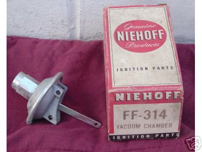

The NIEHOFF PN is on the box. The FORD P & A PN is below the photo.
FORD PN B7AZ 12370-A
B7AZ 12370-A.jpg (21.98 KiB) Viewed 97142 times

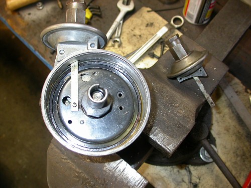

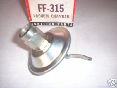

In the third picture, my other 59 430 has a curved arm ....would this be a replacement unit?
I have not looked at the part number yet...Maybe a distributor out of a 462 motor?
There was mixed production during that period. The straight arm is early design, the bent arm later design. That is why the DIST I.D. NO. is so important in ordering the correct service parts.
