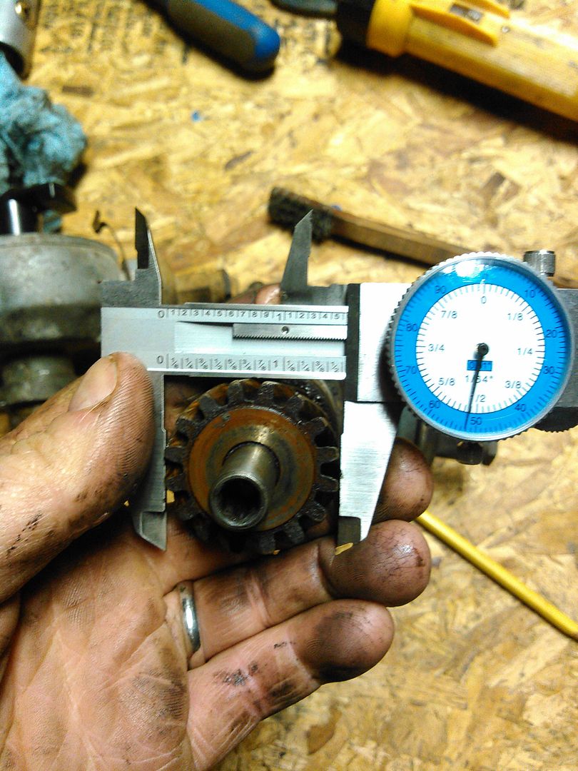

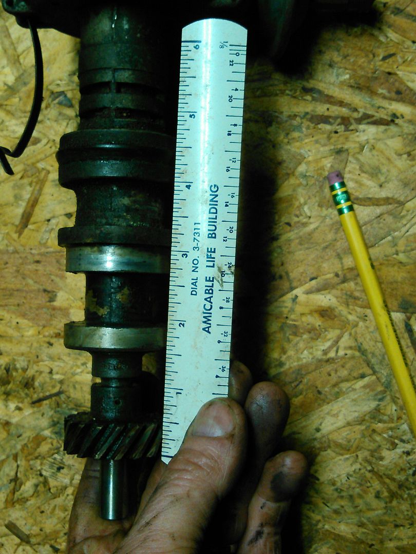

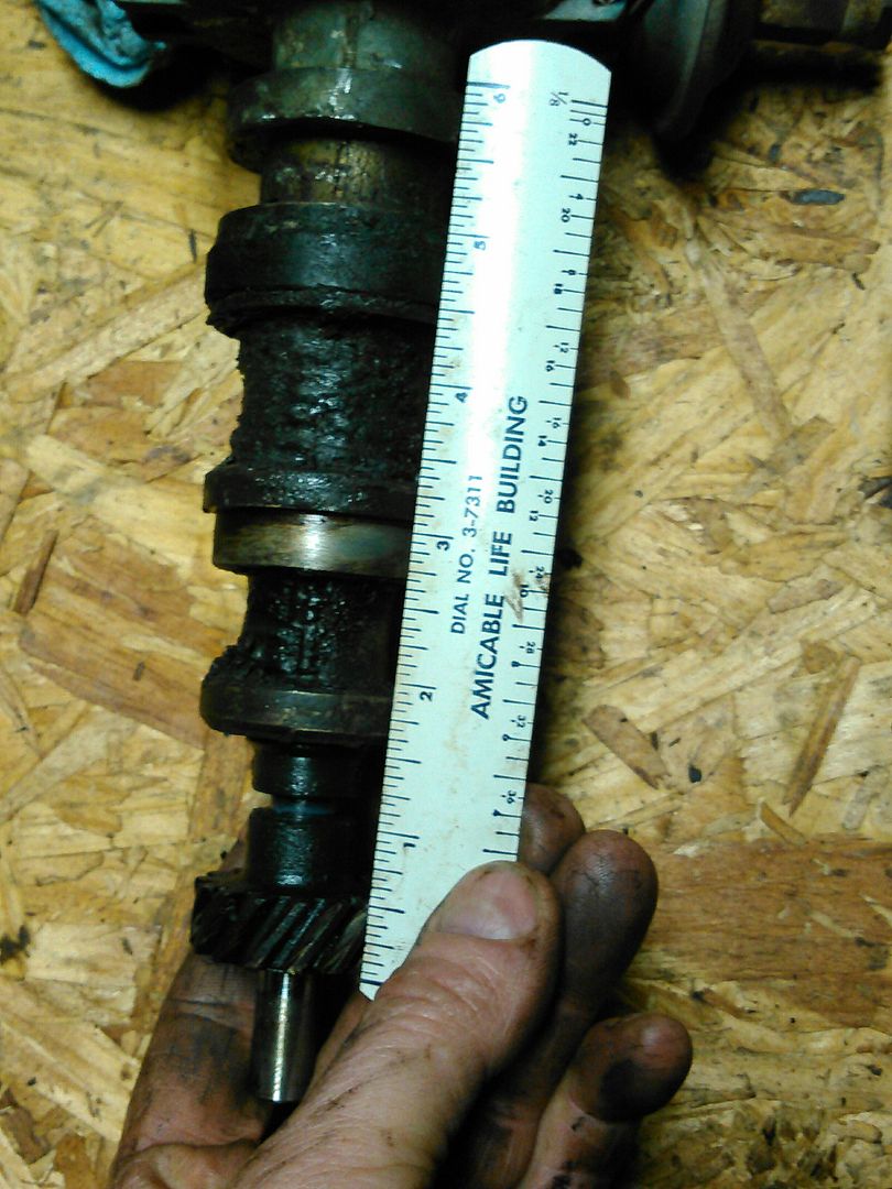

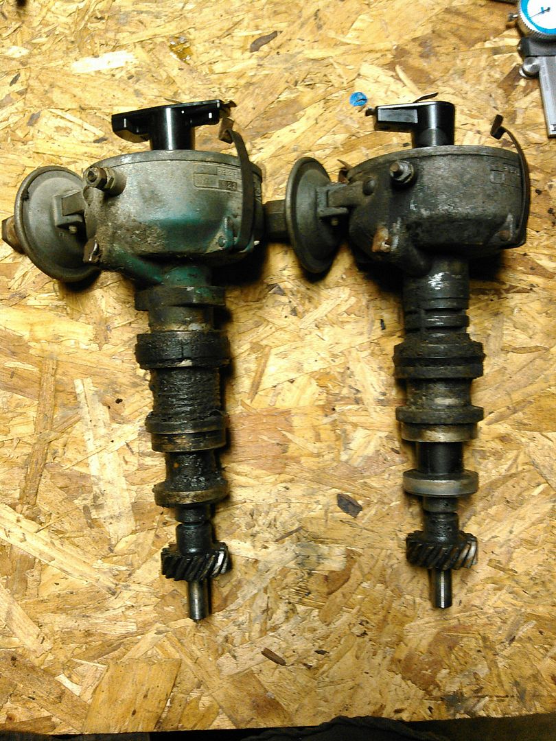

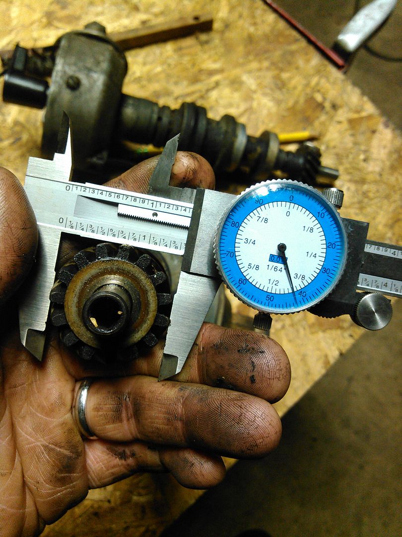

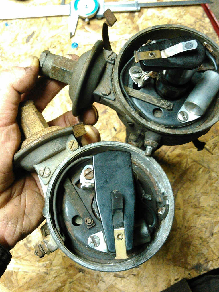

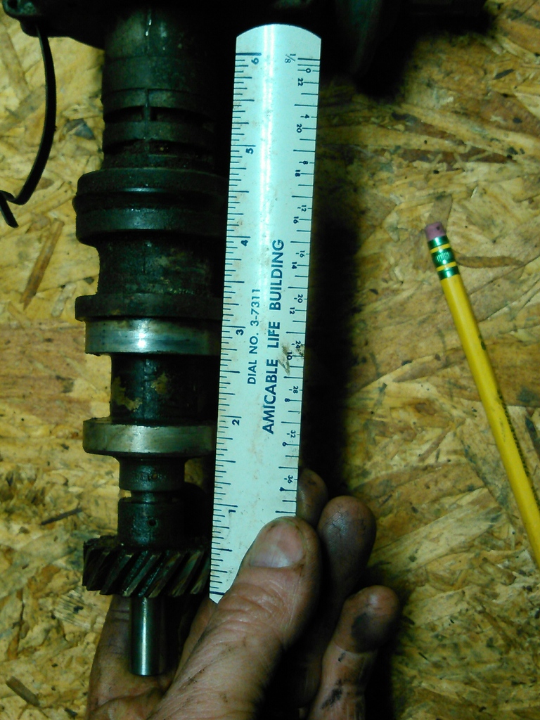

I have a couple of distributors out to compare. The left distributor is FEU-12127-J from a 1958 332 FE, the right FEW-12127-H from a 1959 430 MEL. They use the same FEK-12378-B vacuum advance and seem to be the same internals. There is a difference in gear to seal distance with the FE being greater. The 332 gear is 1.042 o.d. The 430 gear measured 1.052. The shaft diameter was different by .0002, I don't know if there are different shafts or they are just on extreme ends of tolerance.

In the comparison of distributors, one thing that was not mentioned is the difference in the number of teeth on the gear. The top one has 15, and the bottom 16. FWIW

Checked this out about a year ago ,found that the machined housing diameter is also different .
