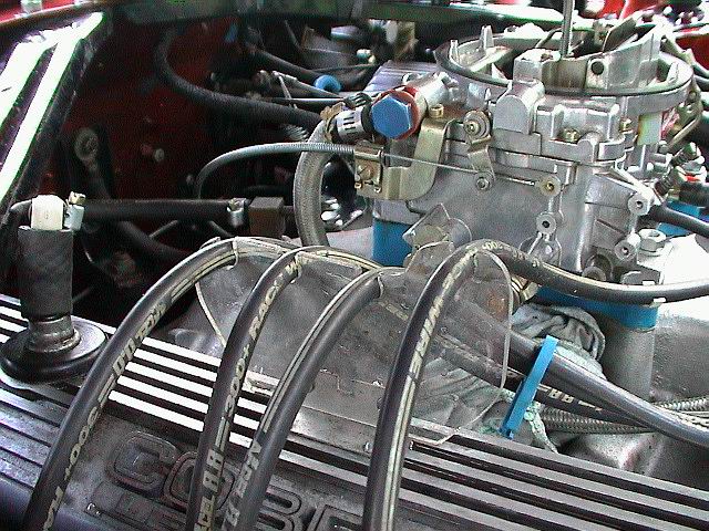

Here's my 600 cfm E-Bock w man. choke. It's set up for neck snapping responsiveness.
