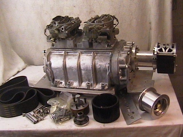

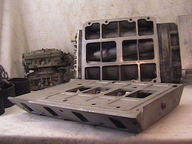

Here is a blower set up for an MEL from a listing on ebay..
- Posts: 238
- Location: Ontario Canada
Re: Supercharger setups
The buy it now on this set up was 2000 dollars... it needed some work, but a reasonable price for a rare item
- Posts: 238
Edited to add: This setup is the only one I have seen, and it sold within one day at the buy it now price of $2000.00
The Intake is the rarity of course.

Ahhhhhhh, now that's what dreams are made of...as far as MEL speed parts go $2000 is a pretty awesome deal for everything you'd be getting. If I had that money lying around when that listing popped up I would have pounced myself.
On a side note, I've never seen a setup w/o the aircleaner on it and it's interesting to see the carbs reversed. Makes a little sense now that I see it

The fun thing with those manifolds is the distribtor is covered by the intake.
Have to run a dummy for oil pump function and a belt or cam driven unit for ignition.
