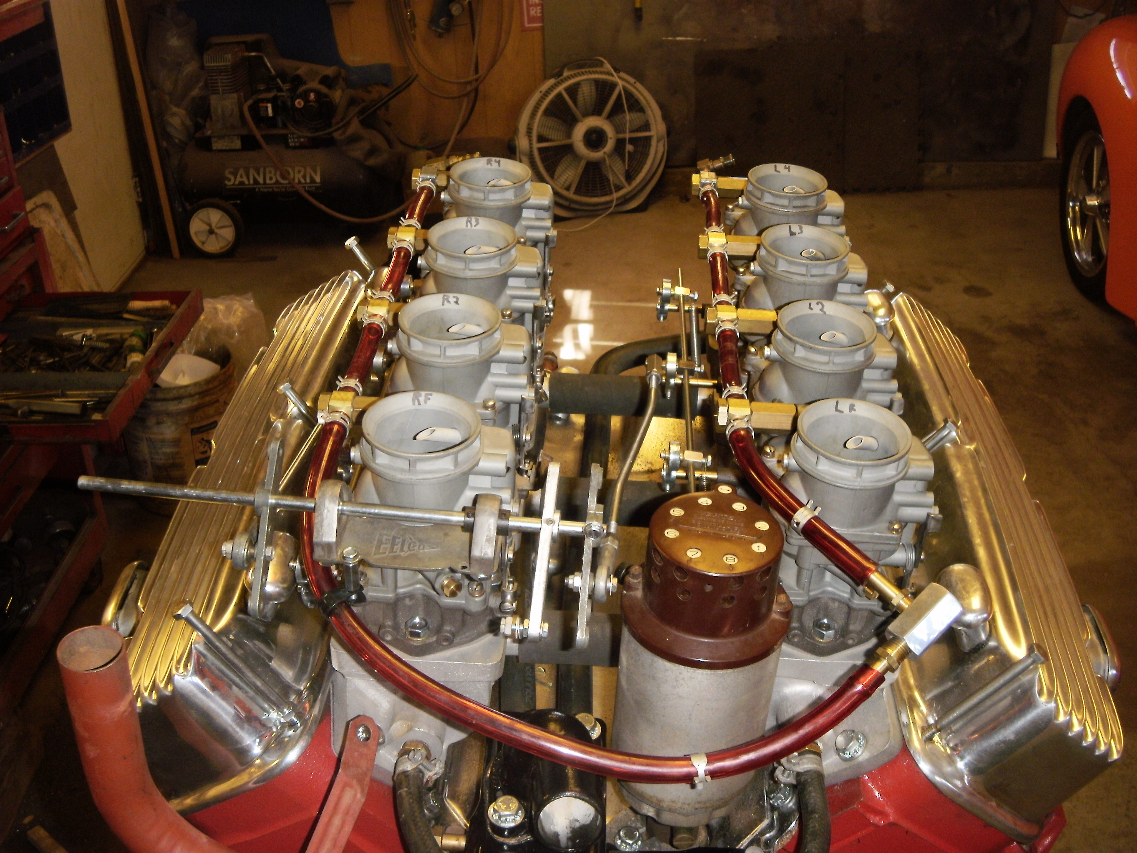

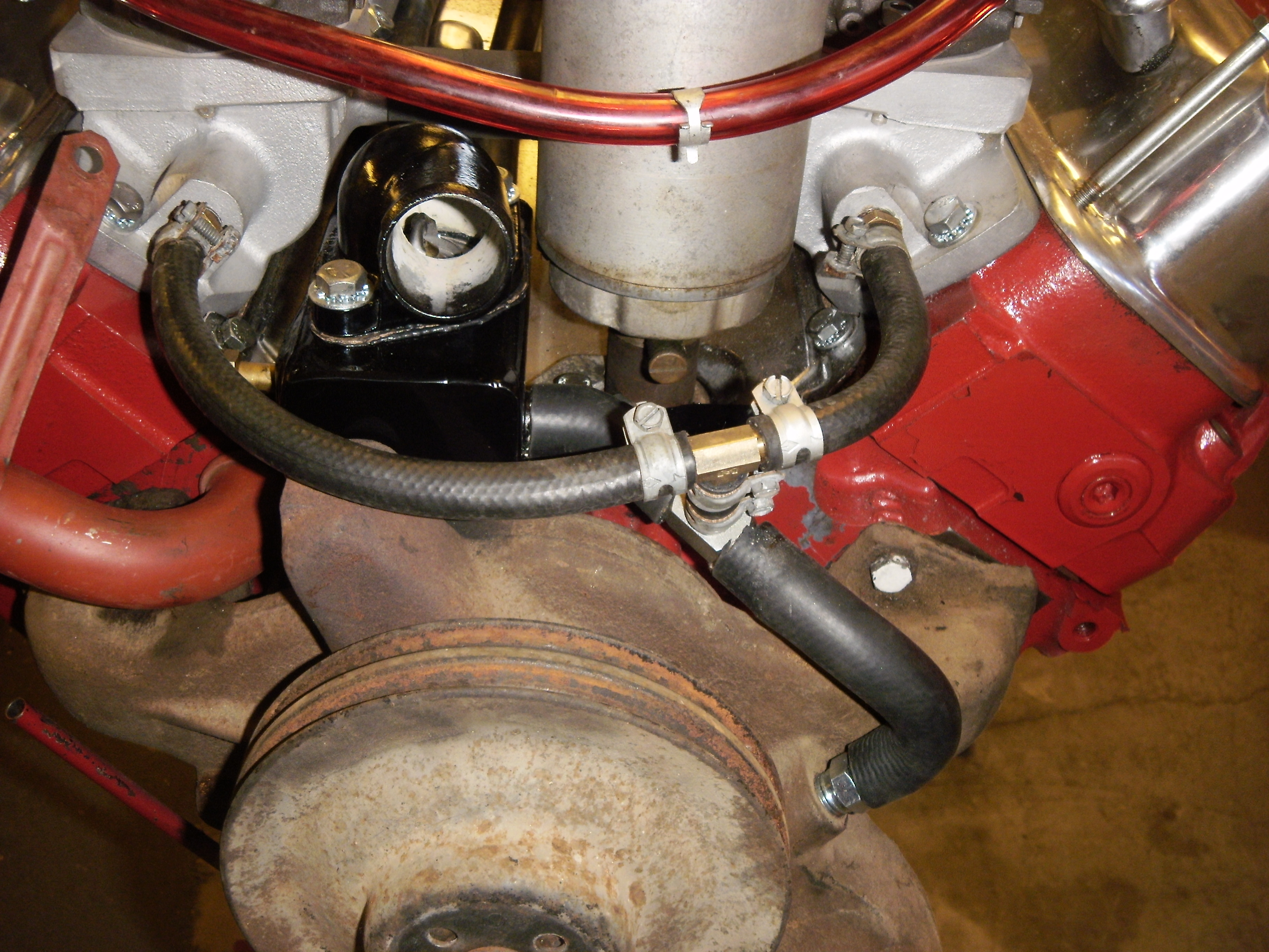

mock up of "race motor for lil abe 2 59 430 grooved crank main journals, precision blueprinted HV oil pump and drive rod NOS crankshaft co beamed and heat treated "nitro" rods 075 over 10.3 forged pistons re-ground isky roller cam int 9-49 ex 63-3 @050 int lift 604 ex lift 626 lunati roller lifters smith brothers 3/8 push rods mondello ported and polished heads stainless steel valves titanium retainers harland sharp roller tip rockers joe hunt magneto weiand drag star 8x2 stromberg EAB 94's NOS eelco ball bearing linkage note have since moved fuel line behind mag and will trim cross shaft
