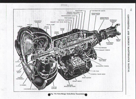

MEL Transmission Manual and Basic Specifications
Please help adding, correcting, discussing and completing data to this section. This specification run down is provided by participants of this MEL Engine Forum and me. To have it clearly arranged I constantly keep merging the info into this single post. The contributor's original post will remain below. I'll start with these copies.
For a larger view please klick the photos.

1958-1960
The TURBO-DRIVE was actually a MERC-O-MATIC (1955-early 1958) while the TWIN TURBO was a newly designed DUAL RANGE LARGE CASE for LINC specific.
The TWIN-TURBO was again redesigned in 1961.
