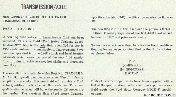

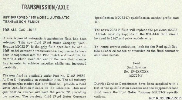

the TSB I finally found puts to rest (to me) the use of TYPE "F" fluid prior to the 1968 model year. It just simply was not available/released prior.
I need to make a progression chart (as enough here have shared enough info) as to the progression of TYPE "A", TYPE "A" SUFFIX "A", DEXRON (FORD went to it's use soon after GM introduction), TYPE "F" and the change where FORD went back to DEXRON (including H and CJ callouts).
FORD used TYPE "A" SUFFIX "A" and DEXRON to the 1968 model year. TYPE "F' was then used to about 1980 when they changed the friction materials and reverted back to DEXRON.

Service Bulletin
Transmission Fluid 1958-59-60
