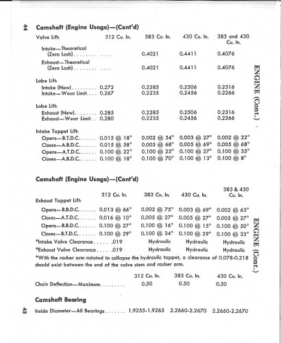

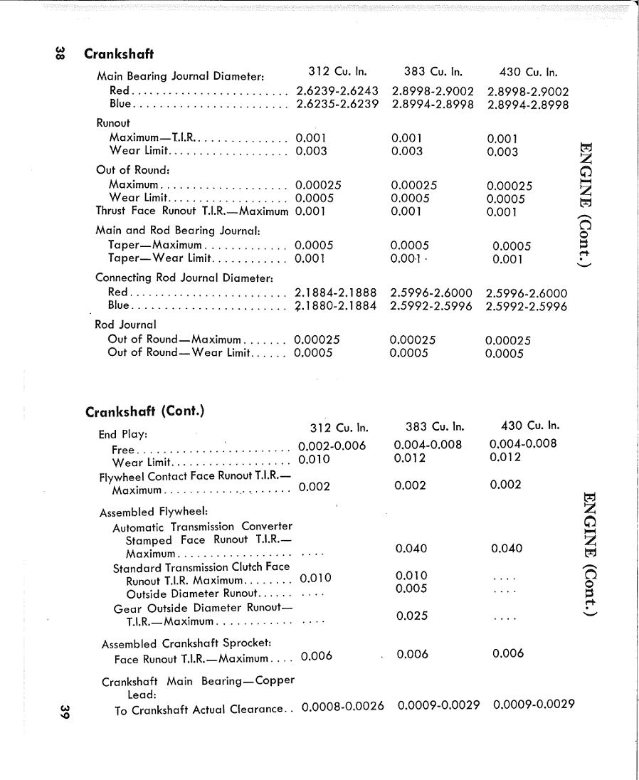

1958 LMC (MEL) Specs Handbook- (4) Engine
