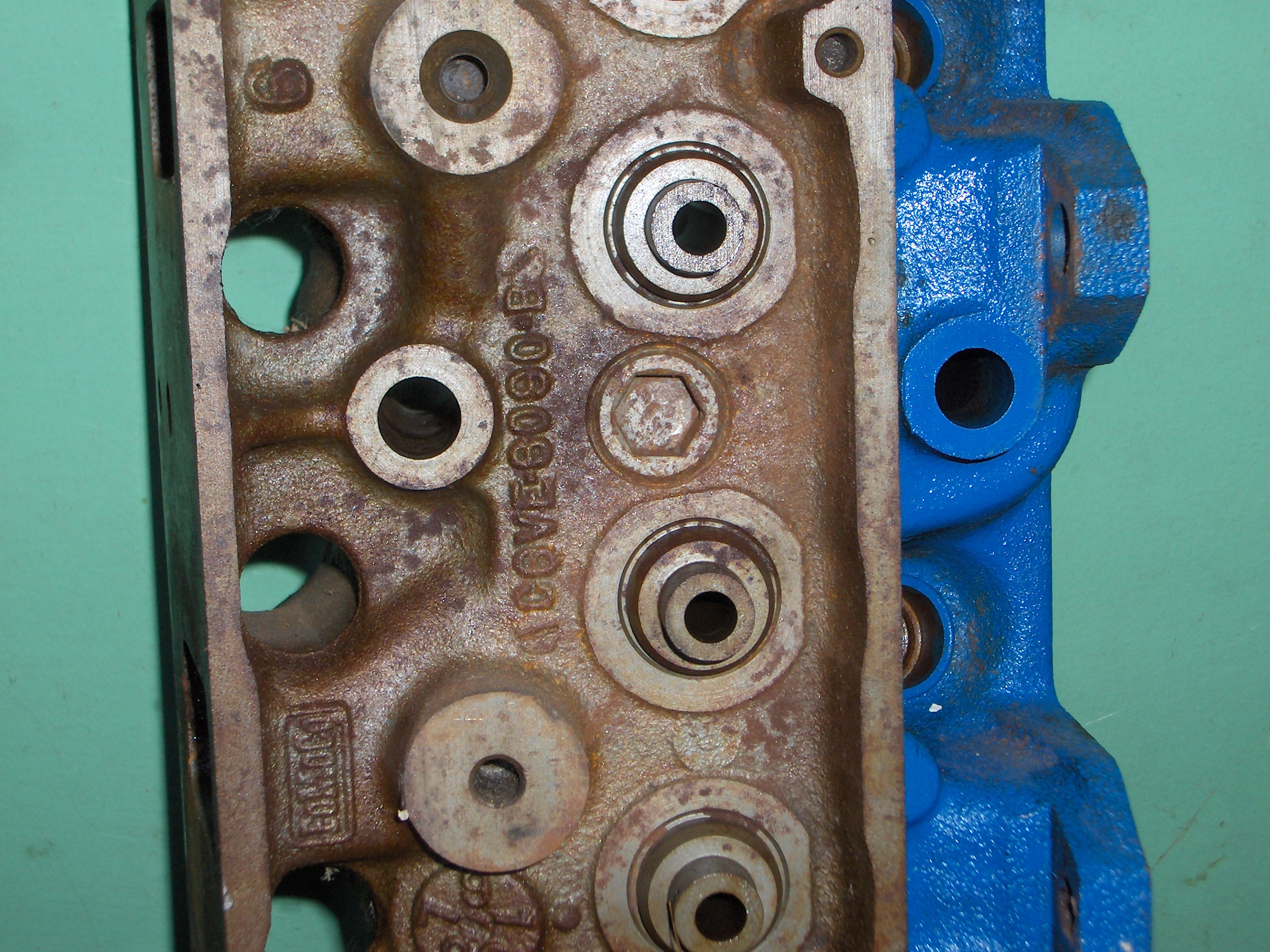

462 CYLINDER HEAD CASTING NUMBERS:
C6VE-A....1966-68
C6VE-B.....1966-68
C6VE-D....1966-68
