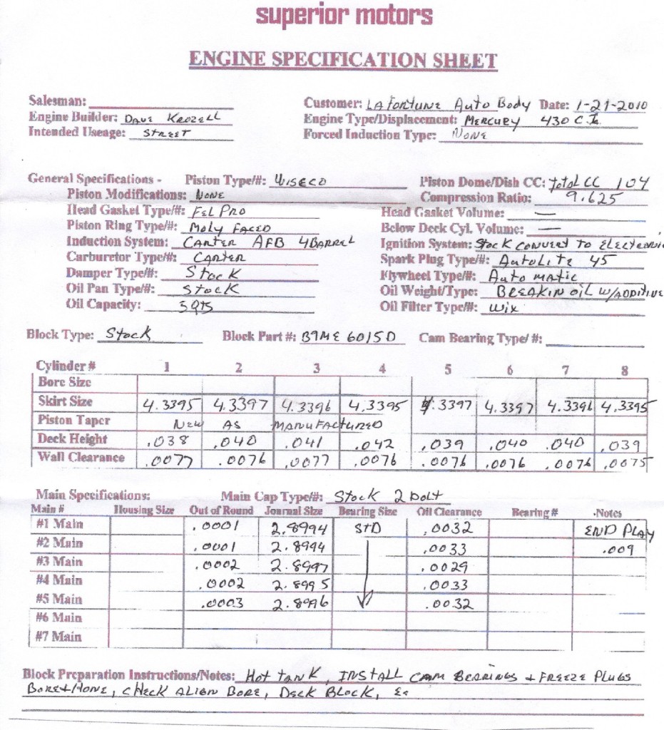

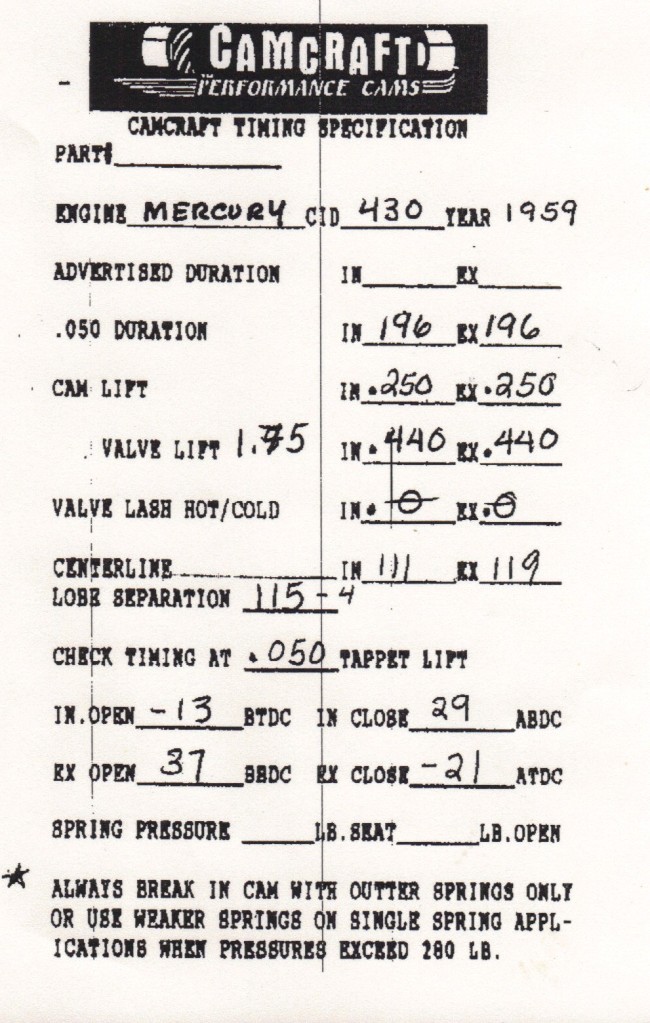

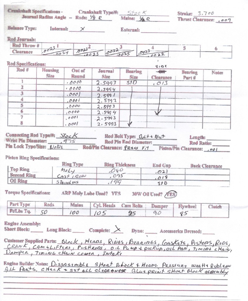

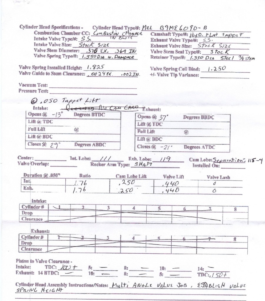

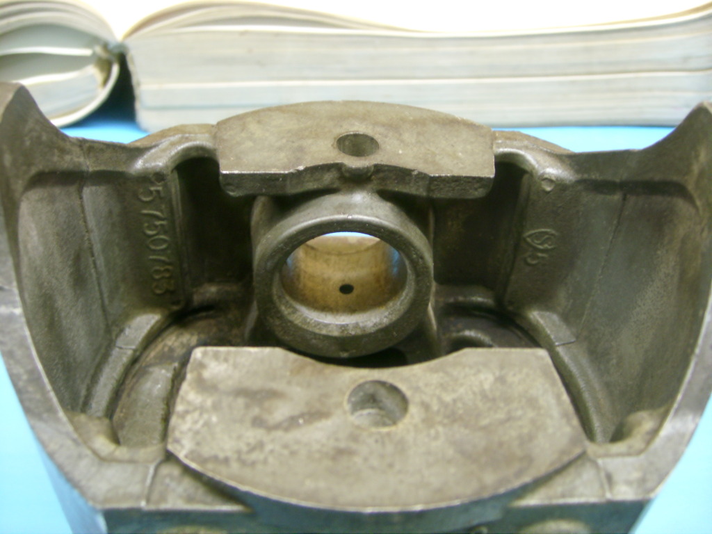

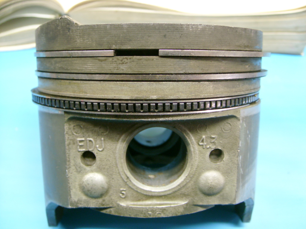

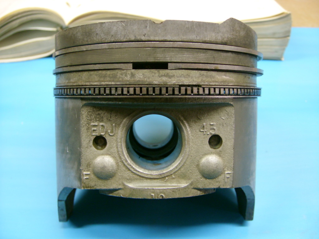

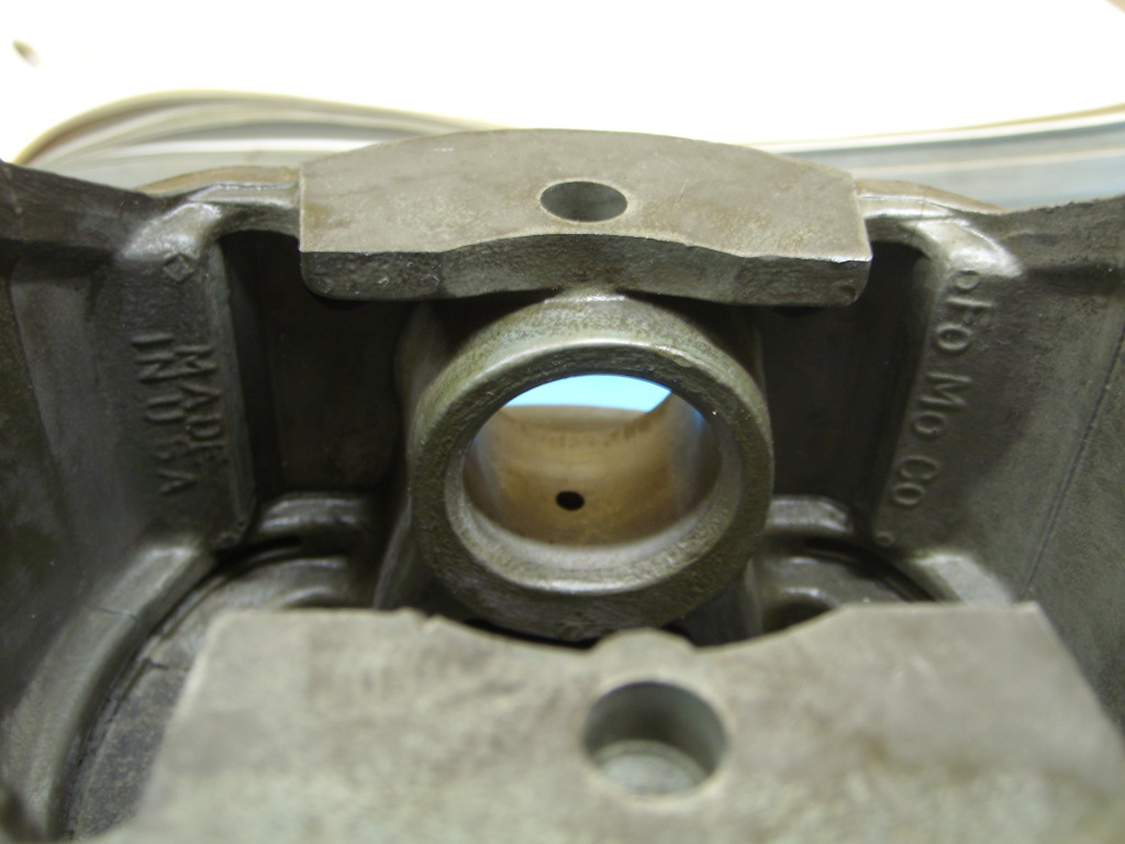

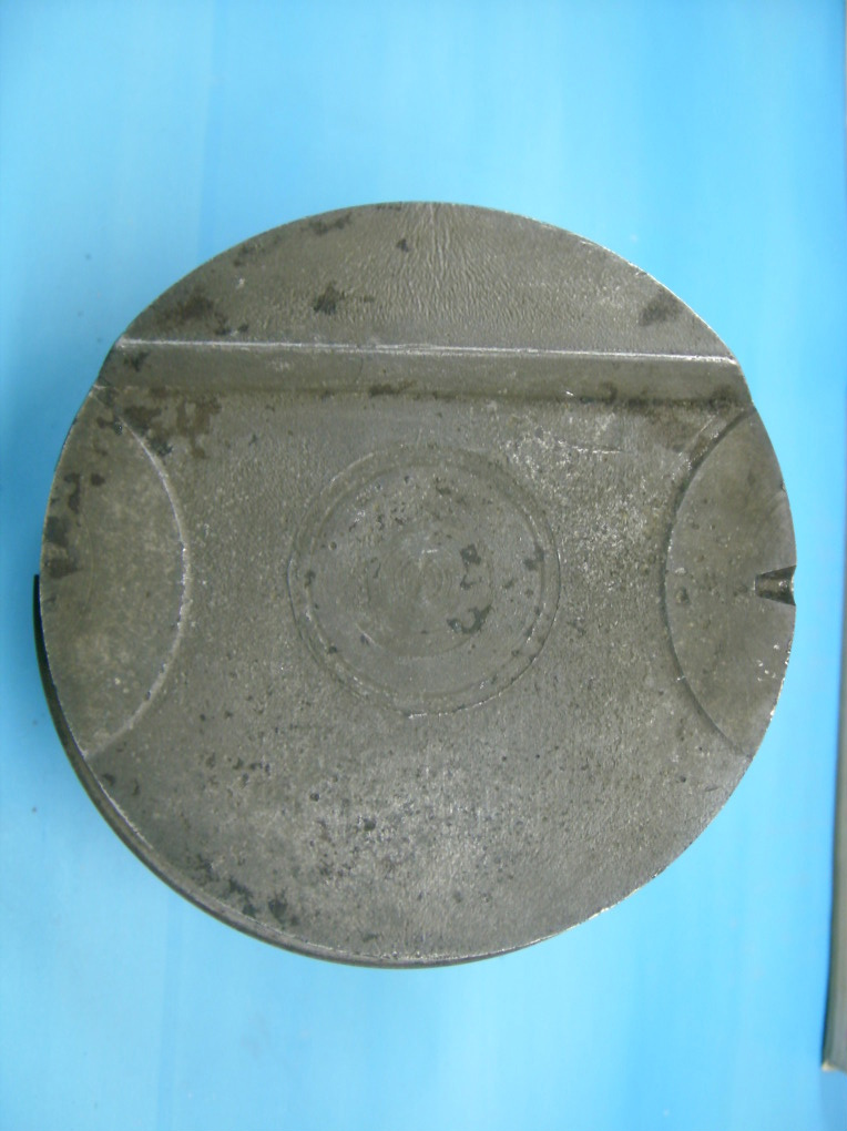

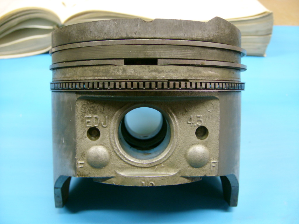

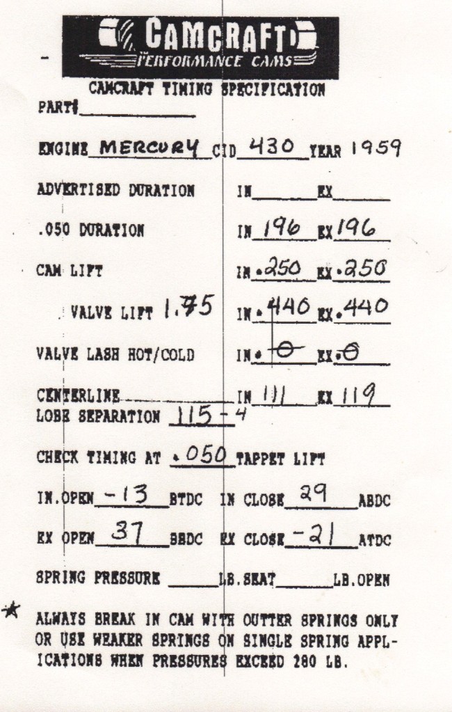

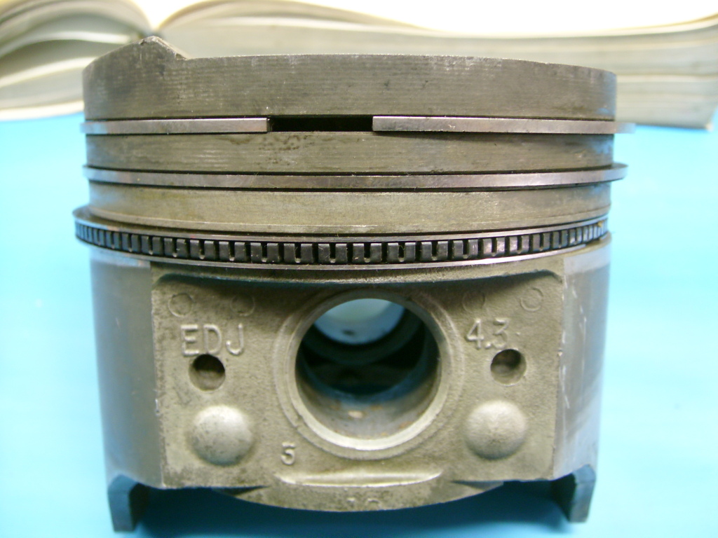

Piston photo's and First Engine Rebuild / Cam information....I expect a 10.1 CR for the next time and will post that build sheet when completed.

Awesome Rick, good info.
Re: MEL 430 Engine Specifications
Ditto.
I will take a closer look on the data tomorrow. Just came in from a gig. It's 4 in the morning.
Seems they skipped the align honing. Good to see a cam chart. I might feed my old dyno software with the cam data.
Thanks for sharing this valuable info.

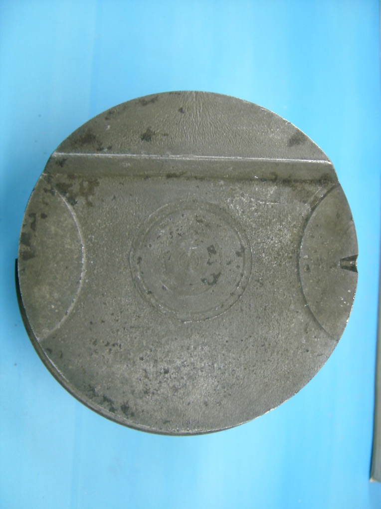

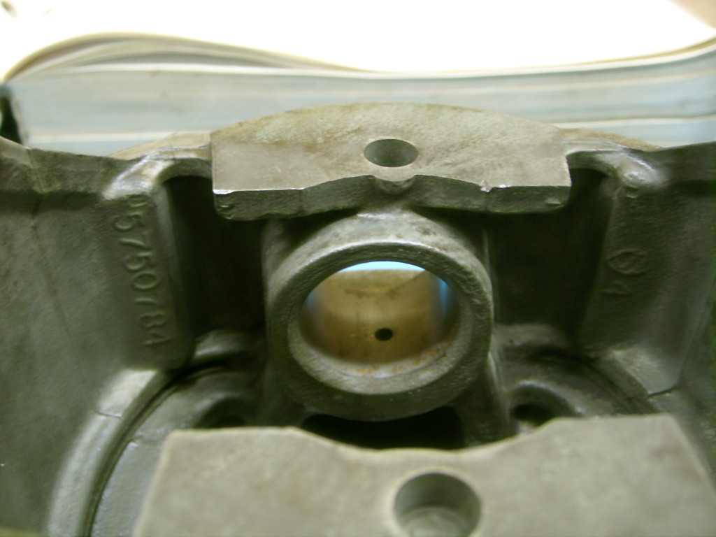

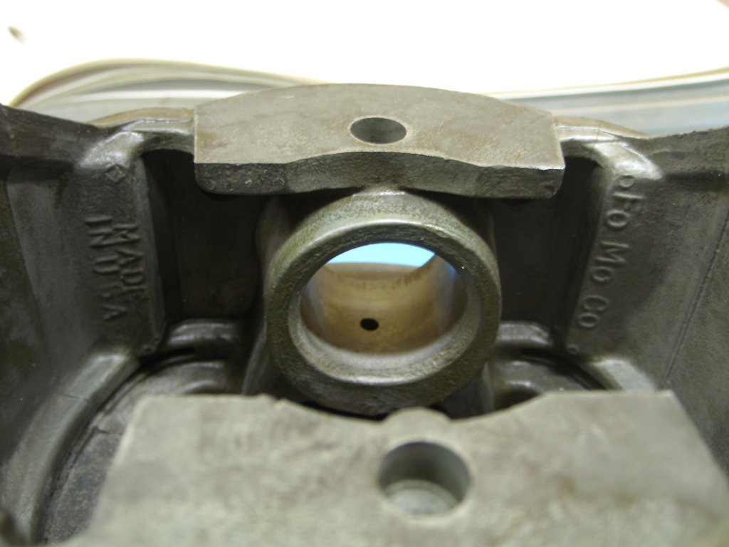

Rick I'm a bit confused. The above photos of the pistons, are they your original used ones that were sitting in your engine or are they NOS pistons that you're going to use?
As far as I got it you are shopping for custom made pistons. It's not them right?
Theo,Theo wrote:Rick I'm a bit confused. The above photos of the pistons, are they your original used ones that were sitting in your engine or are they NOS pistons that you're going to use?
Since ChrisCraft was posting photo's his original pistons I thought I would do the same from every angle to show part numbers, etc. since they do not look alike. And yes, we are shopping for custom made pistons.
