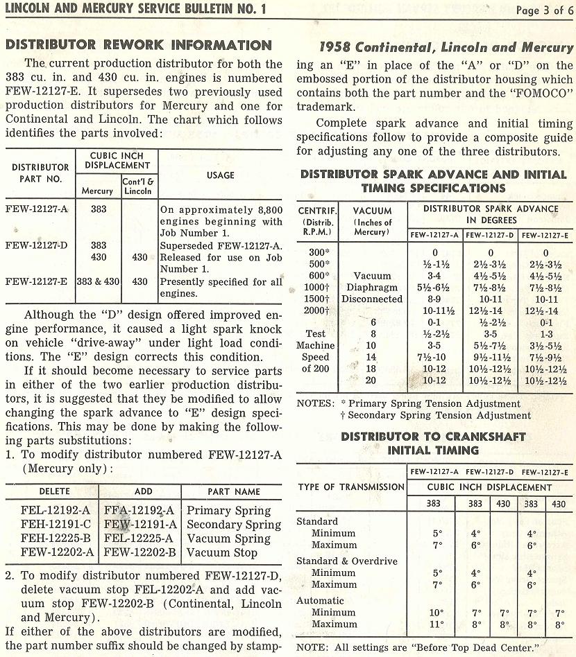

Prior to the above releases, the distributor had been re-worked to correct for light spark knock that was noticed under light load drive-away conditions:
#1 11-1-57

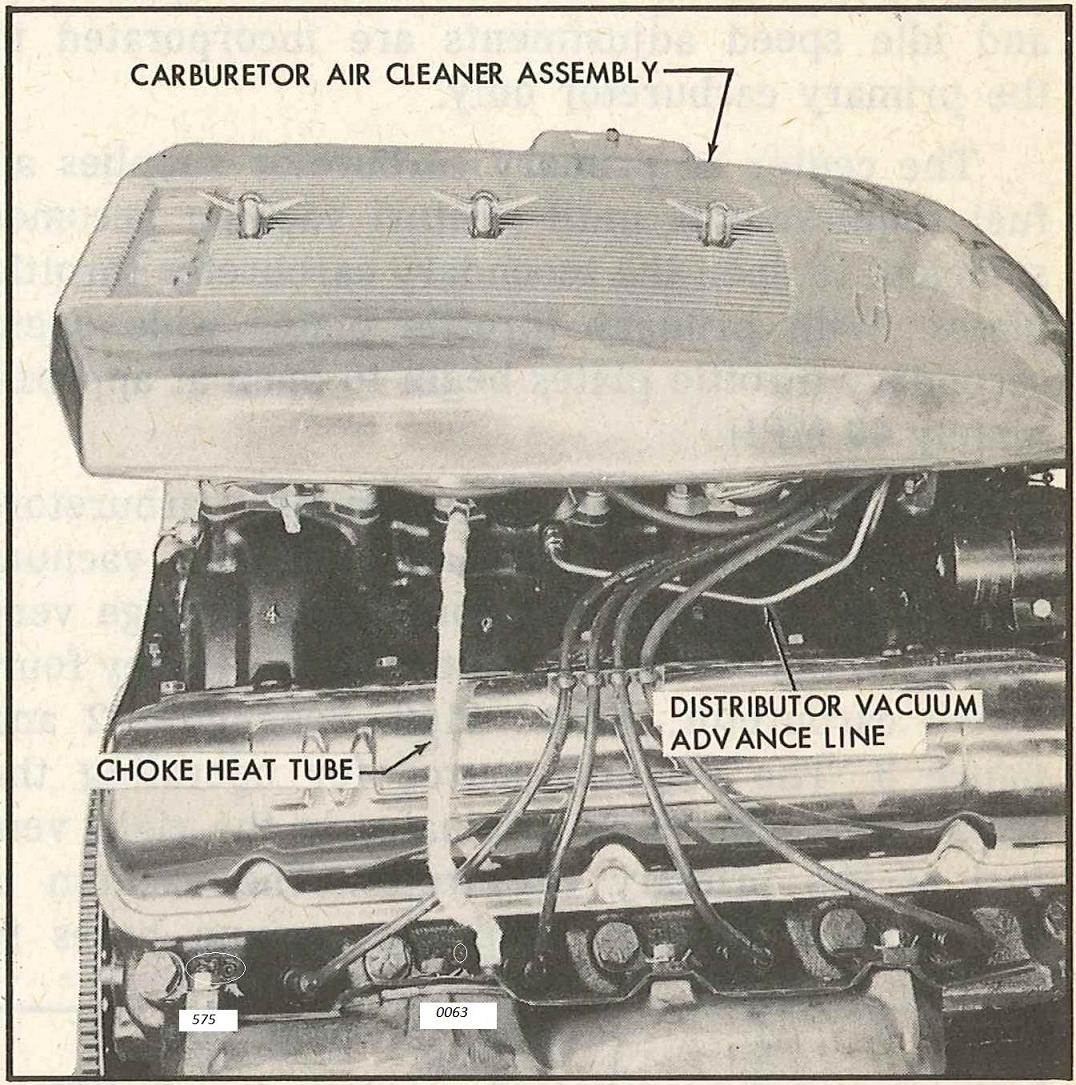

This is a treat to behold- pics of factory installation for the 3x2 Super Marauder, but I direct your attention to the valve covers which are well-illustrated here. Thanks to Mr. Kraft for pointing out the difference between 1958 valve covers from 1959 and onward... 1958 has the "fingers" affixed to the cover to hold the spark plug wires, and note the small grommets on the spark plug wires too. 1959 and on uses a removable clip to secure the wires to the valve cover.
1958 Valve Covers
